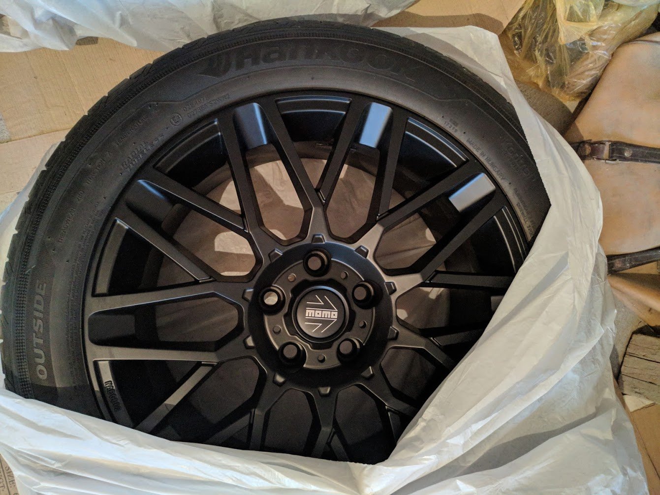

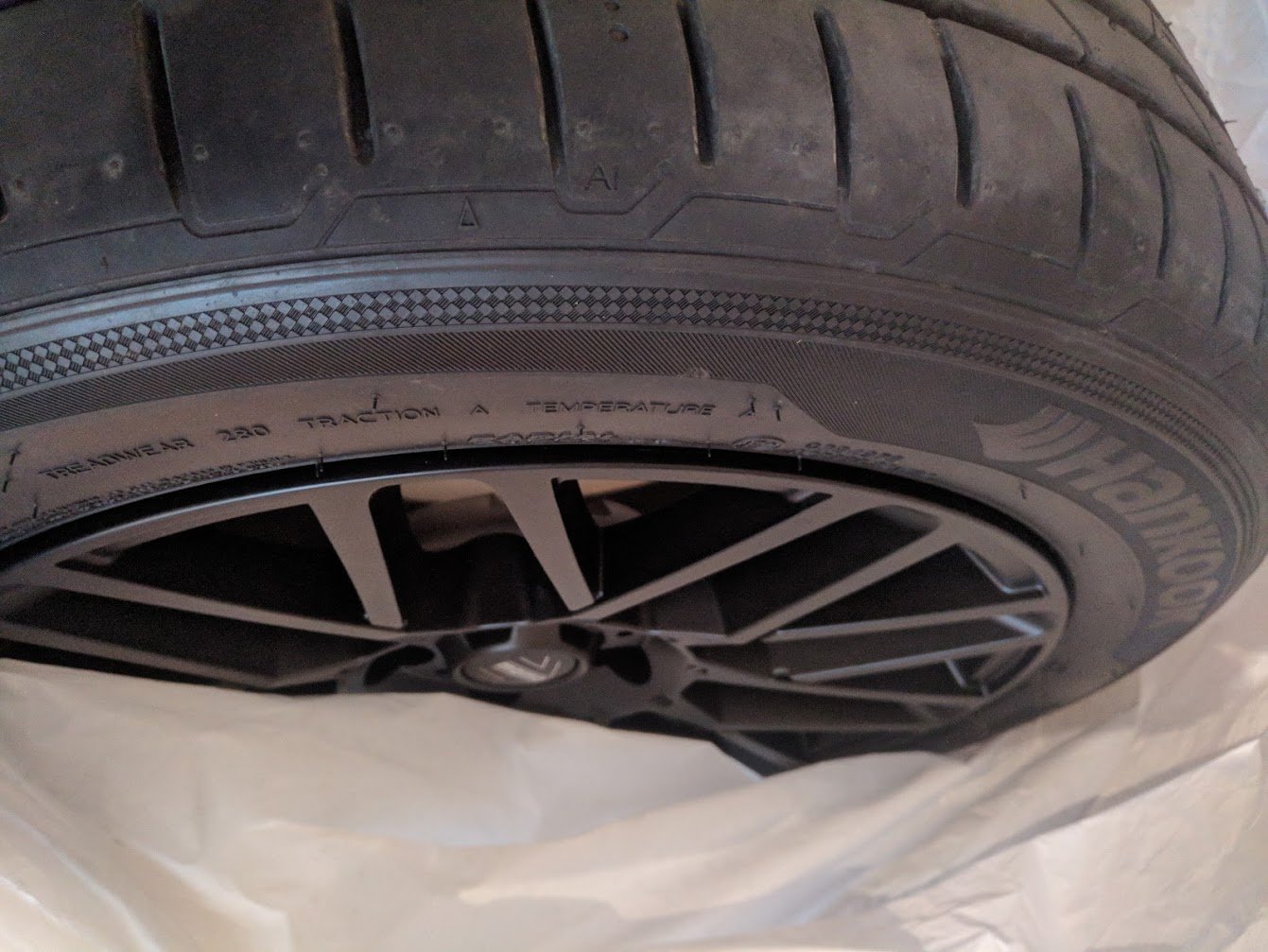

I have a dilemma so I thought I should ask here for opinions and help. I have fitted new winter wheels on my factory Triton rims and went and bought MOMO Revenge wheels for the summer Hankooks.
My worry is that perhaps it could cause issues because the MOMO rims are 8J x 17 ET35 5x112 (factory size is 7J x 17 ET45). I should probably also mention that the tire size is 215/55 R17.

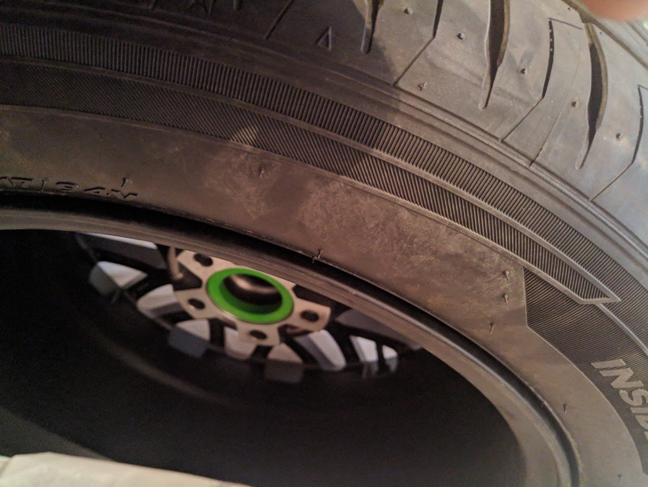

Visually the tires fit alright although the rims protrude by about half a centimeter on both inner and outer side. Its visible on the pictures. The green thingy is a spacer cause the MOMO is wider opening than the stock is 57.1mm wheel center hole.
My tire service where I bought the wheels said that there is no need for worries with this setup yet I am feeling uneasy the more I think about it.

I see at last two, maybe three problems with those wheels:
1. The off-set is 10 mm less than the standard 45 mm - this means the wheel ccenter is 10 mm closer to the car.
2. The rim width is 1" more than standard for the tyre - bringing the rim  ½" (12.7 mm) closer to the car.
3. The use of a spacer to match the center locating hole is basically a bit of a worry. It looks like plastic, which will not stay dimensionally stable for very long.
Was kinda hoping you'd reply Agerbundsen :)  Thanks for your input!
The spacer is made out of plastic but they showed me that it is normal to use it for custom wheels since no one makes wheels for every center hole.
