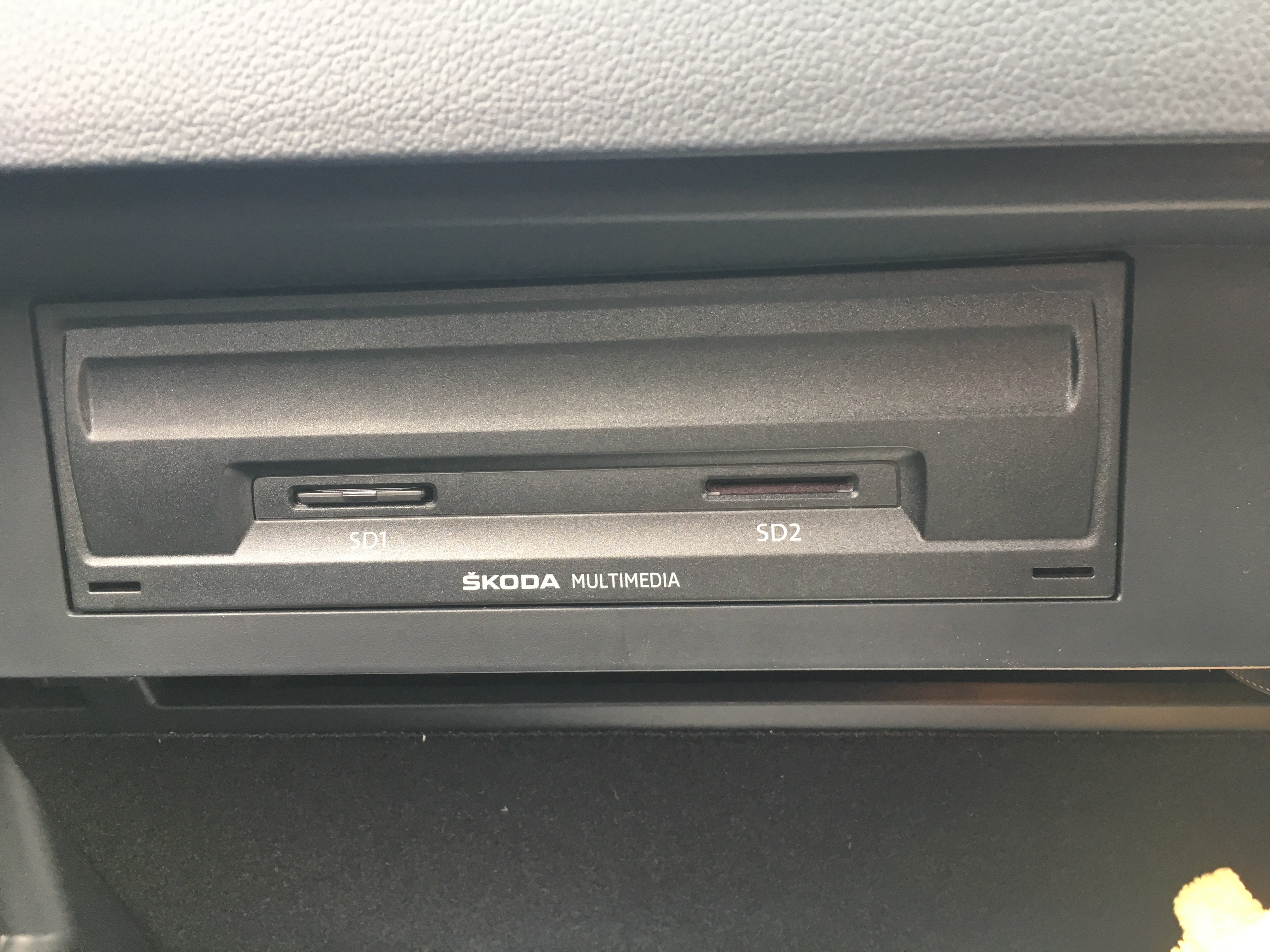

Looking to upgrade my stereo so the standard Amundsen MIB2 will be surplus to requirements. What would it be worth?
Its from my 2016 Octavia VRS and has 2 SD Card Slots.
