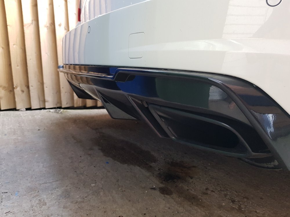

So today me & a friend went about fitting the Rieger rear diffuser B) & it was quite a simple job :thumbup: no jack needed, I did re-watch the Hollowman YouTube video just to refresh my brain "on how to fit/install it" the Rieger diffuser completely changes the look of the vRS & 100% agree with @Jaco2k that you do really need to see it in the flesh B) as pictures can't really show how much better it actually looks.
Note: There are 2 holes that you have to drill either side of the diffuser in-order to keep the diffuser up properly (1 hole either end/side) we used speed fasteners (u clips) to secure above the hole & insert the black round clip(s) you get in the bag & then use the screw.
Here's a few pictures I quickly snapped but will post up a few more tomorrow or Sunday, once I've washed the vehicle but definitely a big thanks to everyone who's shared their experiences with me on this thread :thumbup:very much appreciated.
I will quickly take a few pictures now for you :thumbup: you will need a couple of this speed fasteners (picture below the gold clip) 1 either side of the end of the bumper (closest to the rear wheel arches)
Edit:
Other than that, it really is simple to fit/job, everything comes in the box, all the screws, black round plugs etc...
The instructions are actually very decent, easy to work out & not like Ikea instructions :D If you get any probs just post in this thread & I will do my best to help you out :thumbup:
Edited by BATVANVRS
The speed fastener clips don't come with the rear diffuser, you will need to buy a few, 1 each side so a total of 2 but the garage mechanics should have these to hand in all honestly.
Here is the pictures & these are the only 2 holes that need drilling as it explains in the manual you get with the diffuser :thumbup:
Right Side
Left Side
