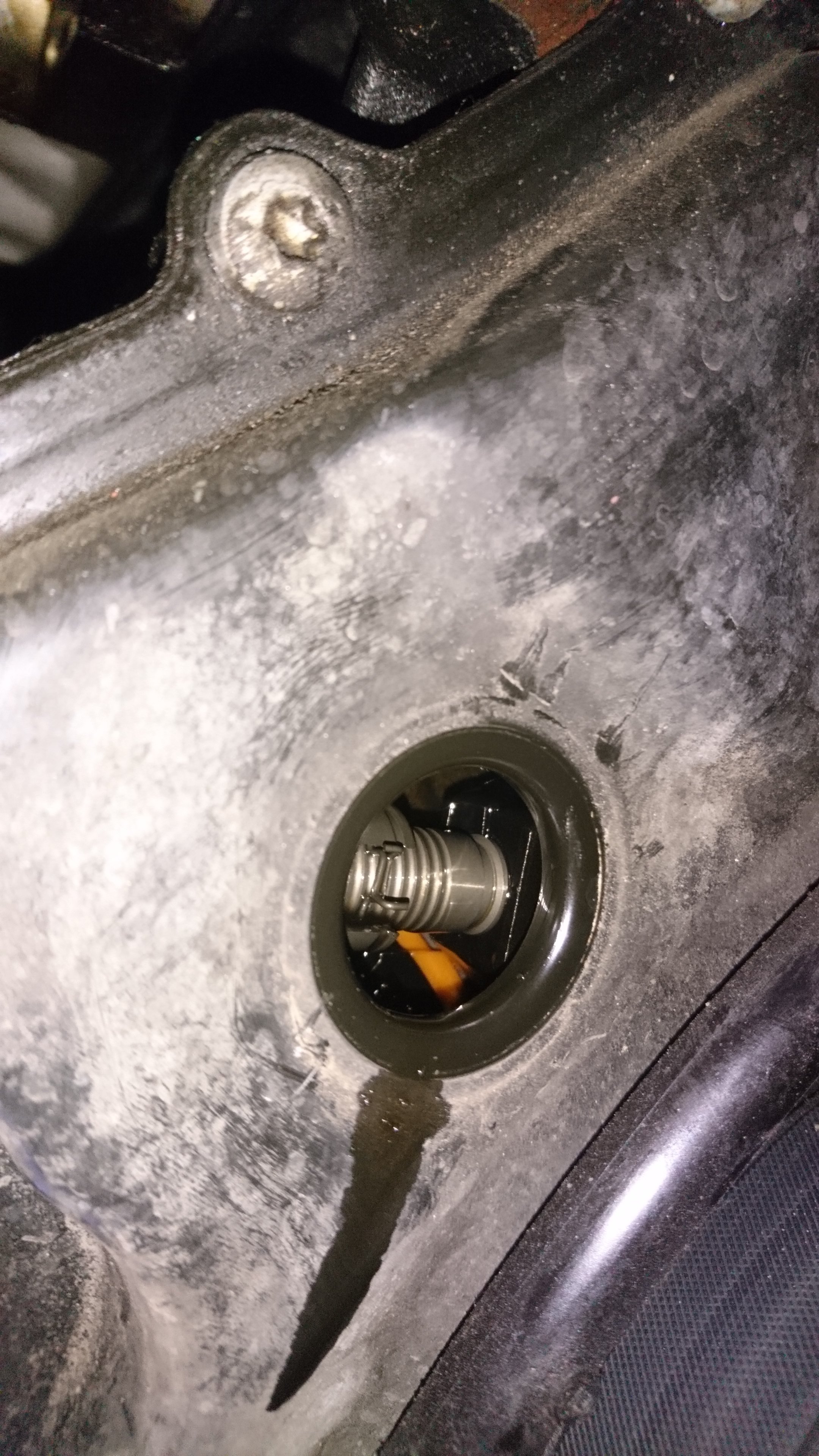

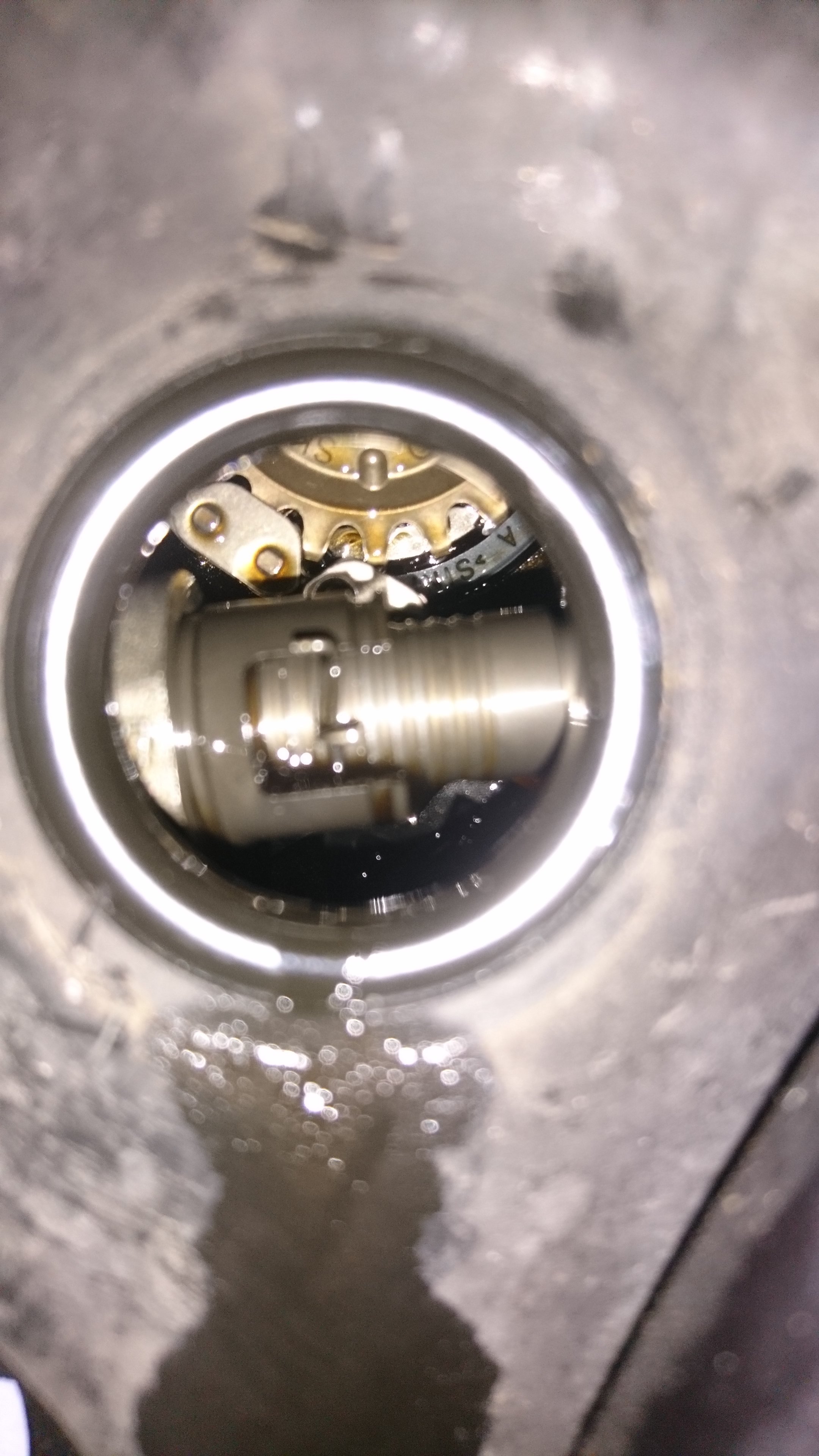

I looked through my inspection hole today and looks like I've got the revised tensioner fitted, that's on a 63 plate car.
What does this look like.... I assume with mine being a 67 plate i should have this....

Best photos I could get. Looks like the revised tensioner from what I can see on Google.
Issue apparently was resolved in 2012 so you'll be fine.
