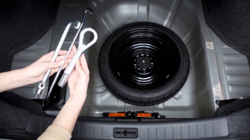

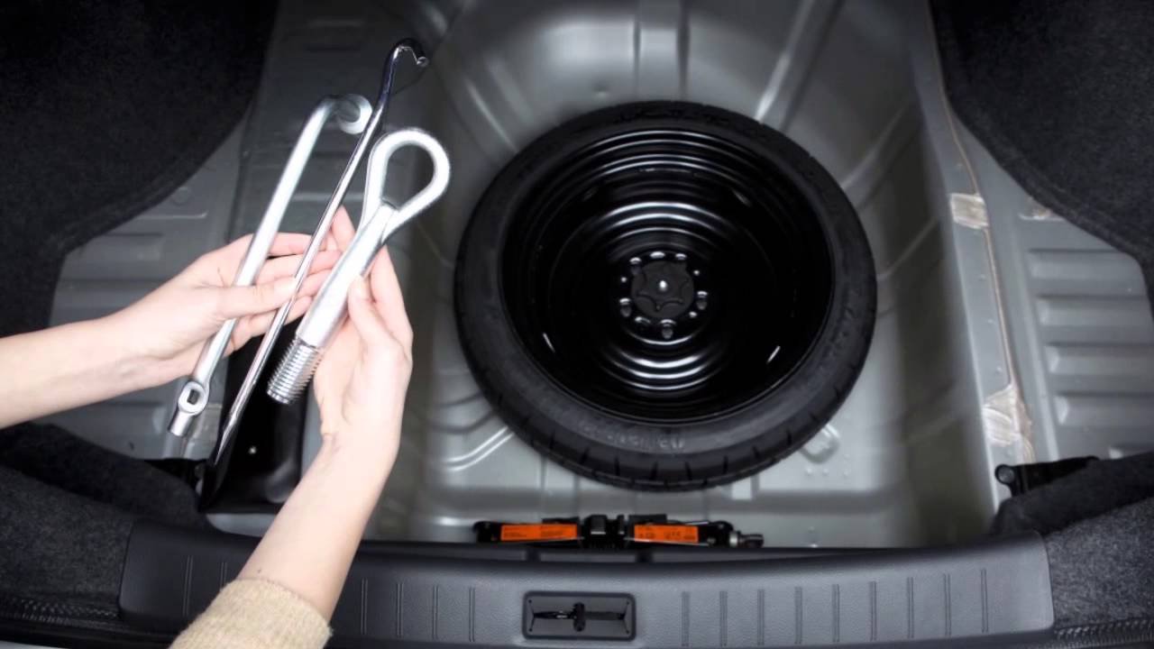

space saver spare tyre:-

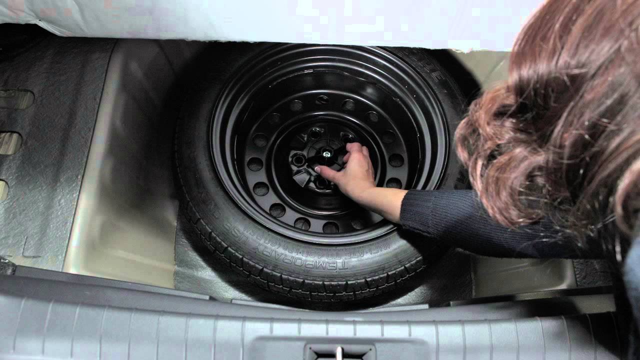

"proper" spare tyre:-

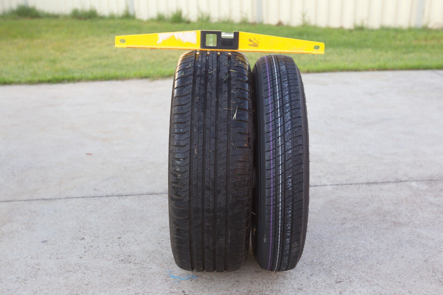

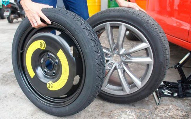

comparison.  proper (left) vs space saver (right):-
Some space savers are real but smaller/narrower than the normal wheel, my "space saver" spare is narrower.
