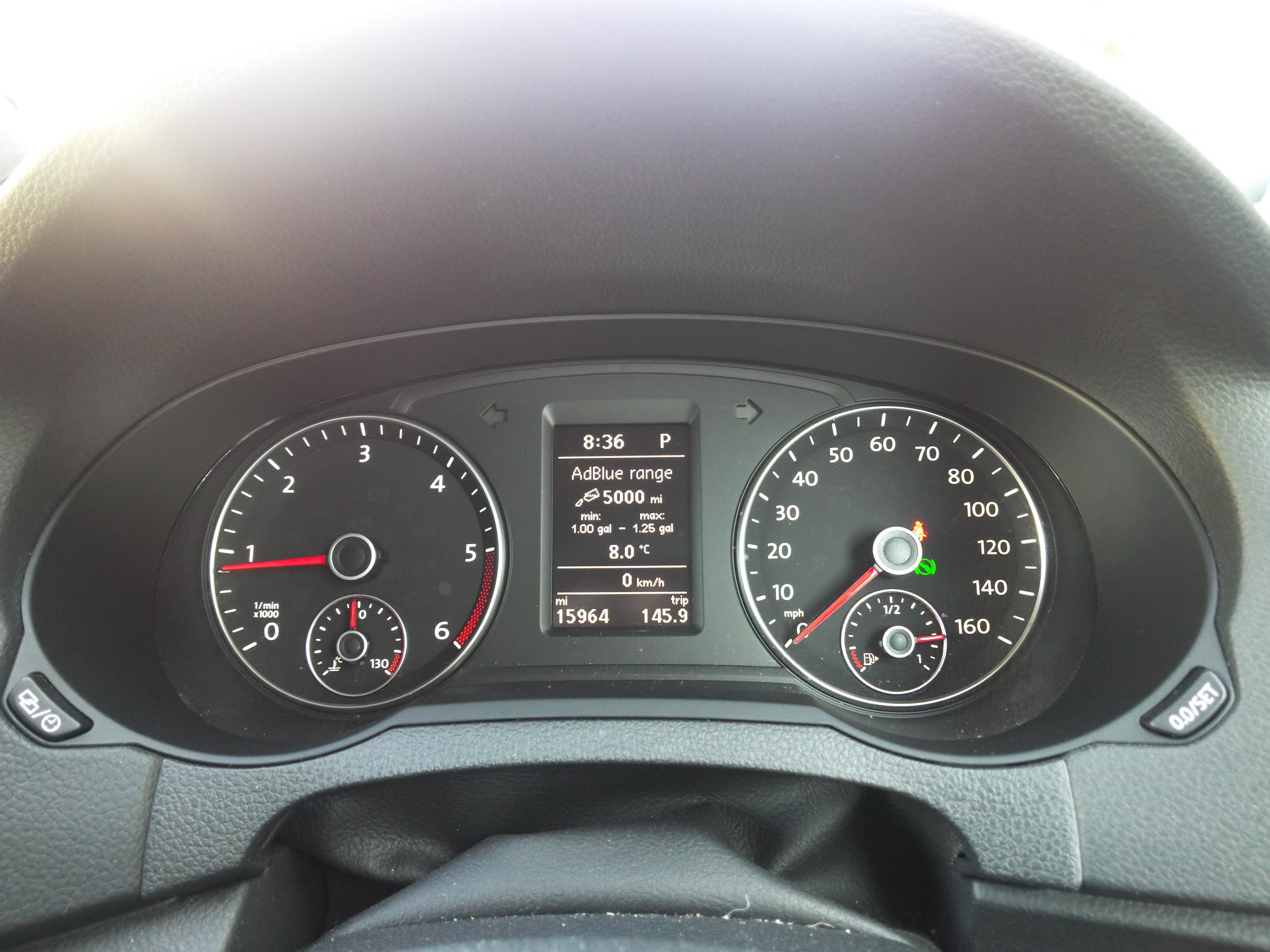

@WPUK - not trying to teach you to suck eggs, but are you sure it isn't showing gallons rather than litres? Mine shows gallons.
Imperial Gallons, 4.546 litres none of these US Gallons or Litres as the Adblue is sold in,
as nobody sells Gallons anymore in Fuel or Ad-Blue.    VW Group are European & Global so why did they go back to the future with 'gallons'.
So rather embarrassingly I most likely believe I was being a bit thick here!
I put the remainder of my 10L container in and it has now reset so can't see if it was saying gallons now but that is the most logical explanation.
Good old case of user error!
Thanks all
In settings, if you've selected in the units options miles per gallon to be shown and your display shows mpg rather than litres per 100km, your Adblue refill quantity will also be shown in gallons.
You can have MPG and Litres for refil quantity :thumbup:
Thanks, I didn't realise this.  I'll have a look and see where I'm going wrong, though I won't change it as I much prefer gallons to litres.
