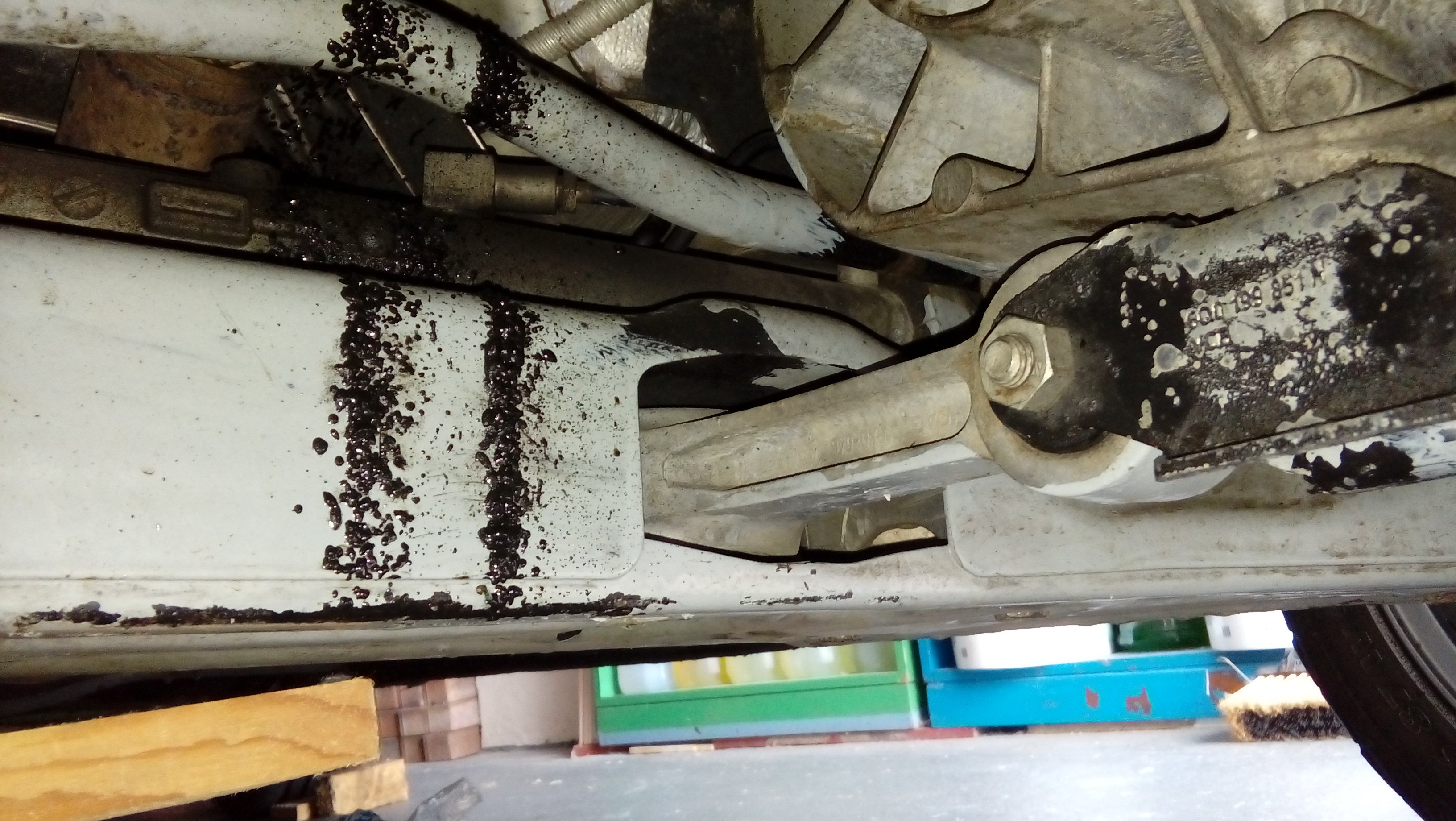

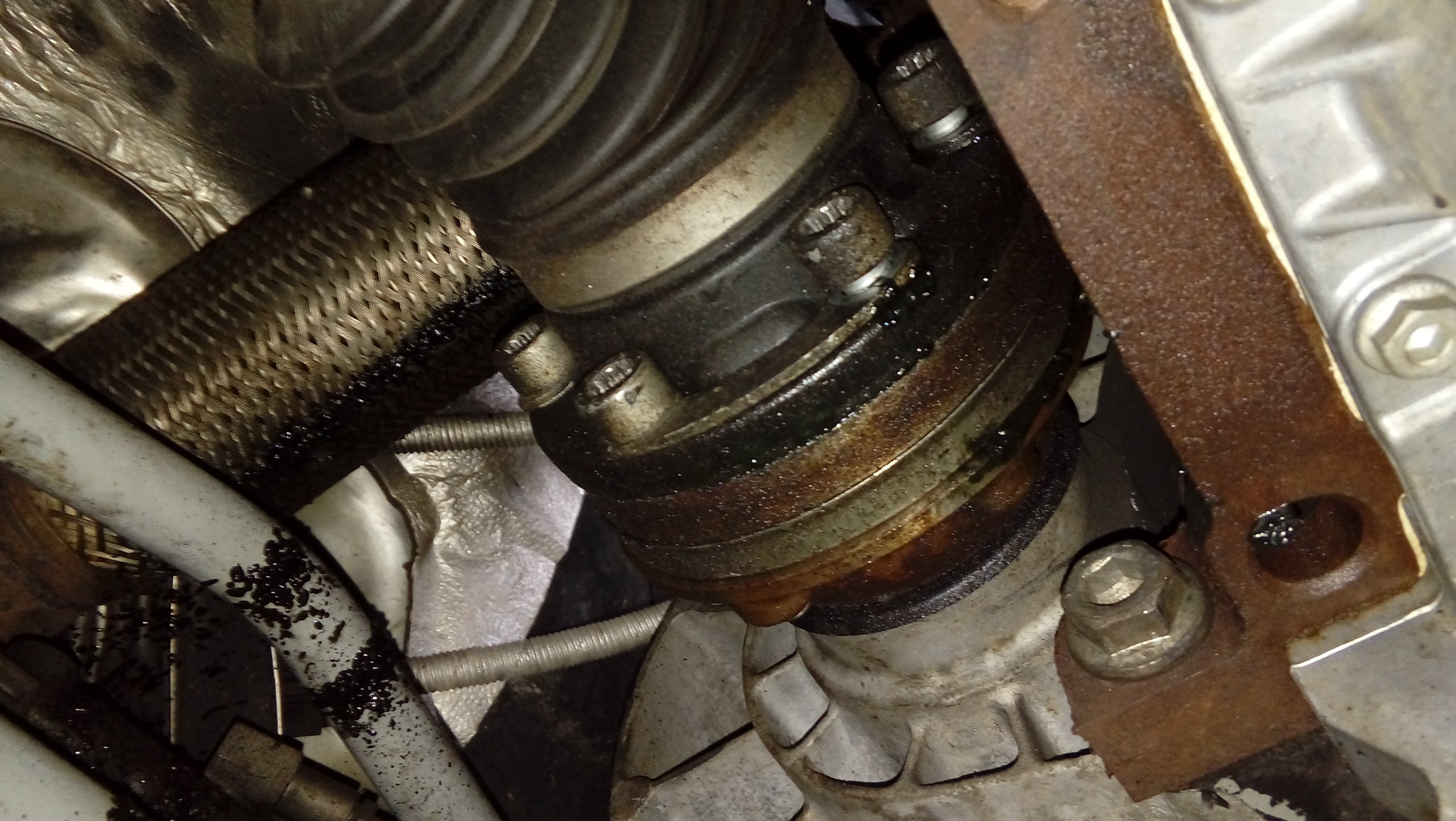

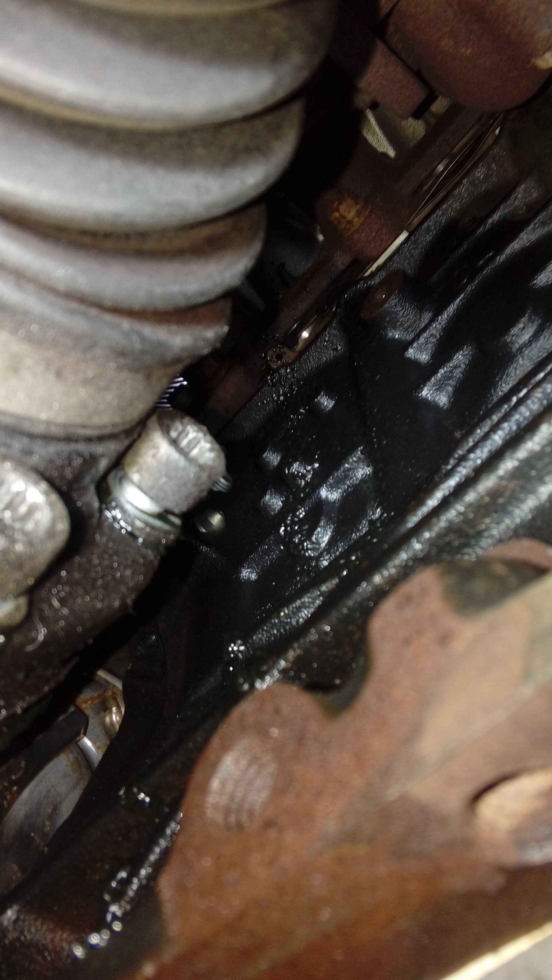

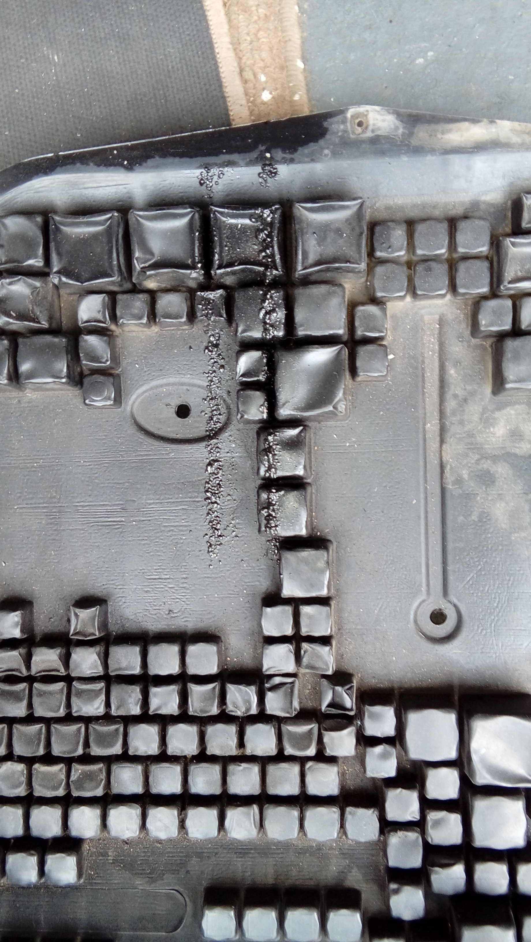

I ask this because I discovered the inner CV joint bolts had not been tightened up by garage or at least 2 were obviously thread showing. A black grease had been thrown out onto oil tray, arb and back of engine block, catalyst etc.
See photos.

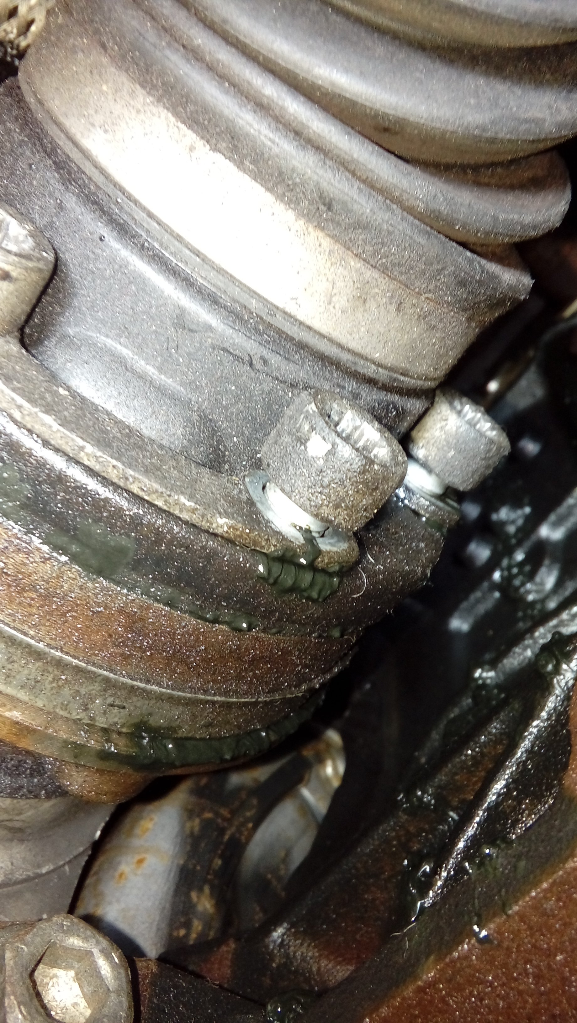

PS whilst uploading photos the grease looks dark green.
That grease can't be from inside the CV joint, the boot is still sealed and does not rely on the flange being tight to be sealed, only the clip.
I've never heard of using two different types of grease on identical CV joints simply due to fitted position. CV grease is CV grease, it's all the same.
I wonder if the mechanic packed some extra grease into the drive flange before refitting the driveshaft and when he forgot to finish tightening the bolts some of that grease centrifuged out of the flange.
It doesn't matter anyway, just tighten the bolts to the correct torque and you're good to go.
