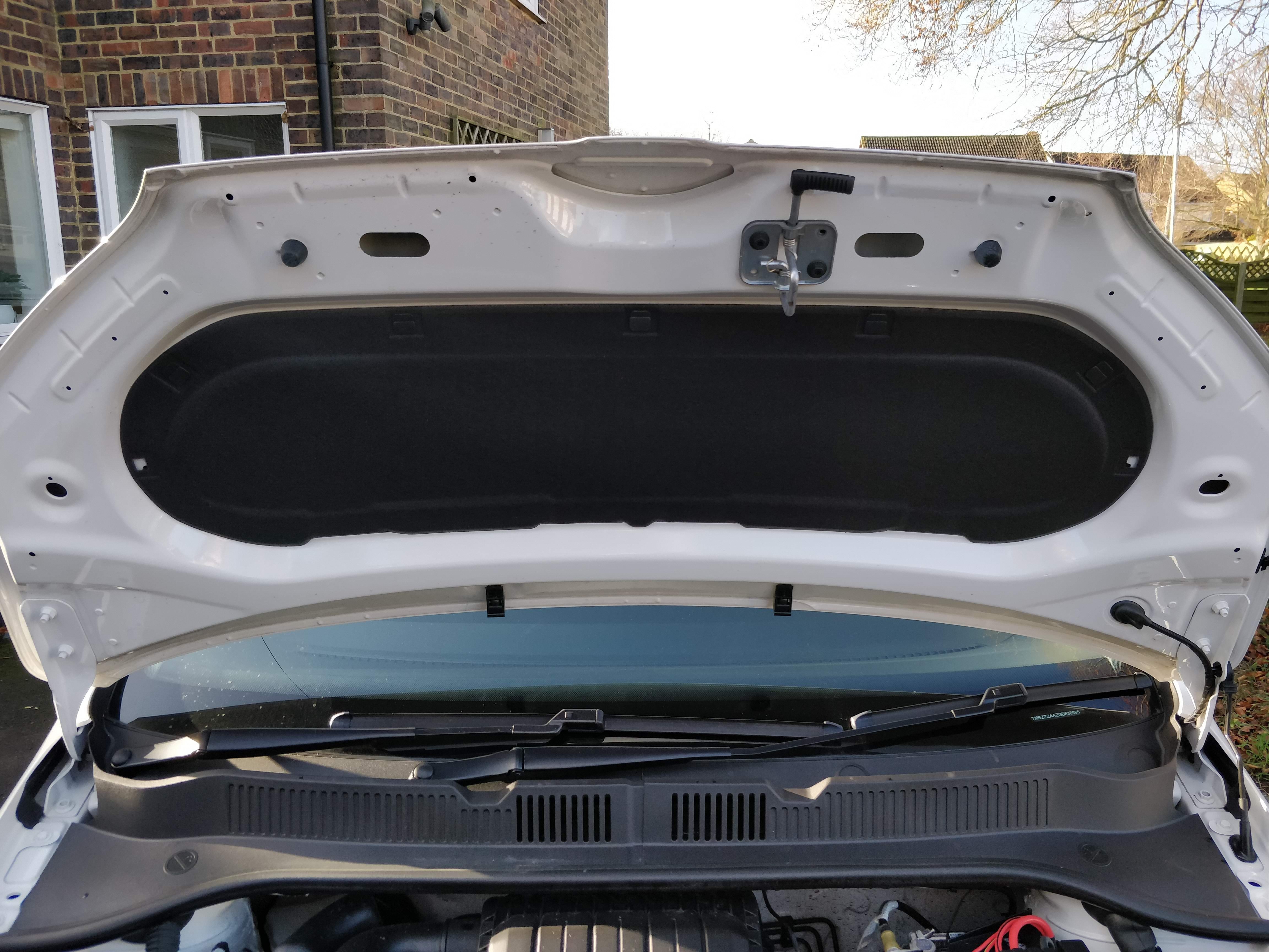

As the Bonnet liner cannot be bought from Skoda UK and shipping charges from mainland Europe for this part are just ridiculously high I've decided to enquire with Volkswagen UK. To my surprise i have received reply from Skoda UK with my full registration number quoted in a reply although I never given those details when sending my enquiry?!
I have discussed your query with our Parts Support Team and they have confirmed that the part number 1S0863831A cannot be used for your vehicle.  The reason is that this part would not fit your ŠKODA CITIGO due to there is a different bonnet on your vehicle to what is on the Volkswagen UP!
So can someone explain to me, how it's possible that THIS part is available for Skoda's in Europe?
Bit of an update.
Visited one of my local VW dealers, gave them the part number for the bonnet liner and following day, my order was ready to be collected 😁
NOTE: Part number 1S0863831A already comes with necessary clips, so there is NO NEED to order them separately.

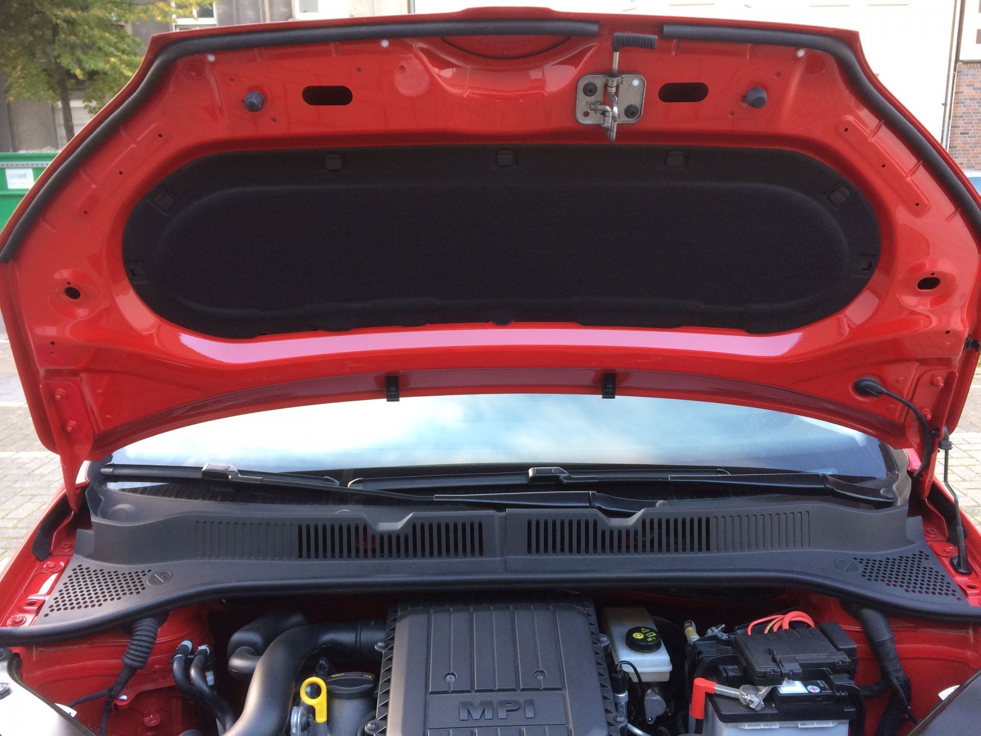

I've just bought a 2016 Citigo for getting around town. I wanted to put a few mods in so I'm planning on doing the rear wheel arches when the weather is a bit warmer, but the bonnet sound absorber seemed like an easy place to start. The part number is W1S0 863 831 A and it comes with the clips already in place. The part was about £33.
Note that there are seven clips but the Citigo only has space for five. You can see in my photo that I took the other two clips out so they didn't vibrate loose and fall into the engine compartment.
Overall the fitting took about 2 minutes and the engine noise is reduced and a bit more muffled. Good easy mod.
