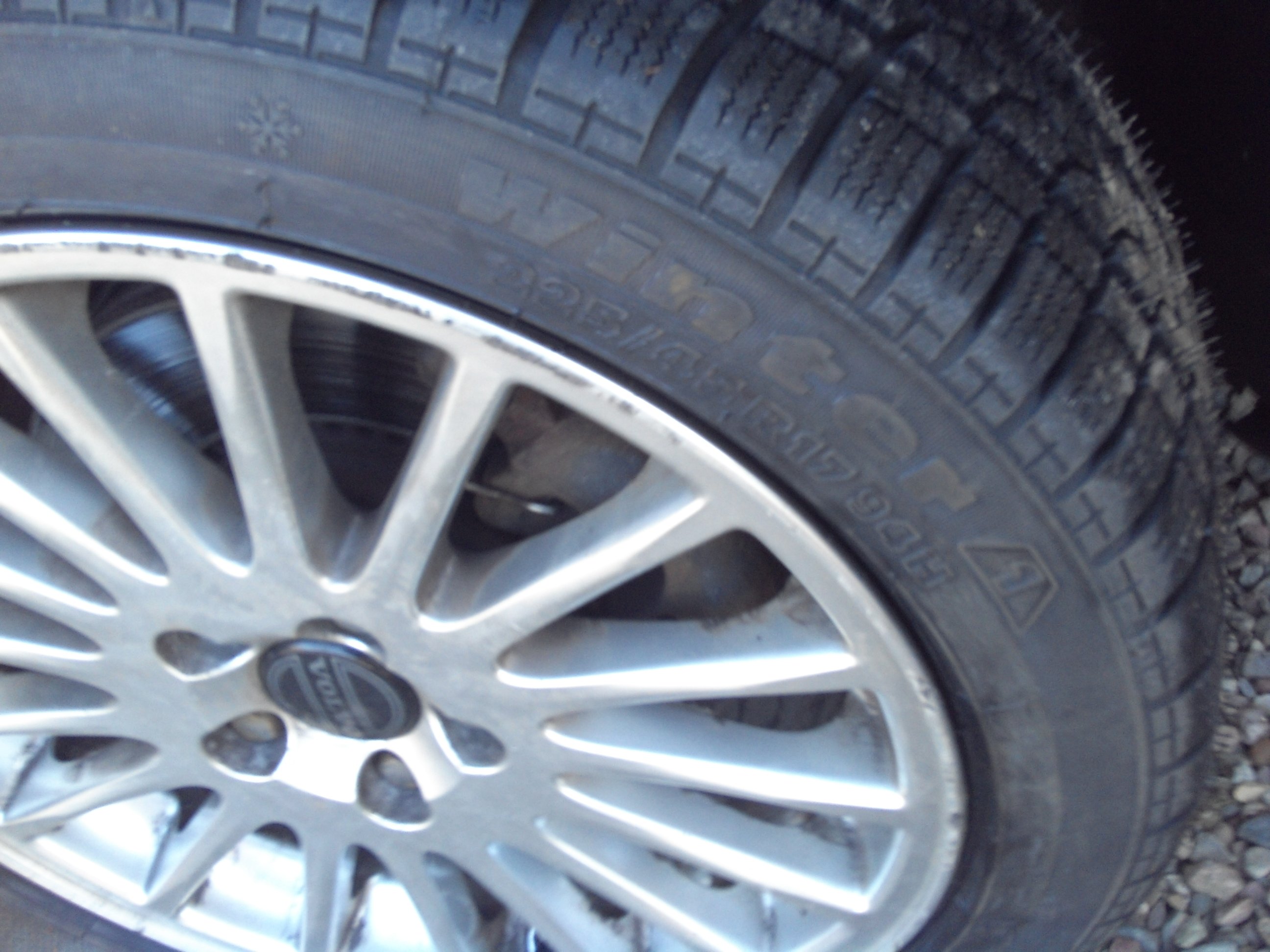

DSCN0331.JPG.5487eb8ac8c1f58c4646869245f2588a.JPG.2dbbca9254cd222861cc1fcdbf03fb5d.JPG
5a2eec64e0886_compare2252c45R17..2152c40R17..2052c40R17026(1).JPG.ca86991f8e2e068d25e5d70ff0559866.JPG

5 minutes ago, Offski said:
I like Goodride, and TIGAR Tyres.  ATS Euromaster have them.  Michelin own TIGAR Tyres in Serbia.  & ATS Euromaster.
TIGAR M&S & TIGAR Winter, used both.
That first one is directional I see - is that the M+S?  And is the Winter one directional?
