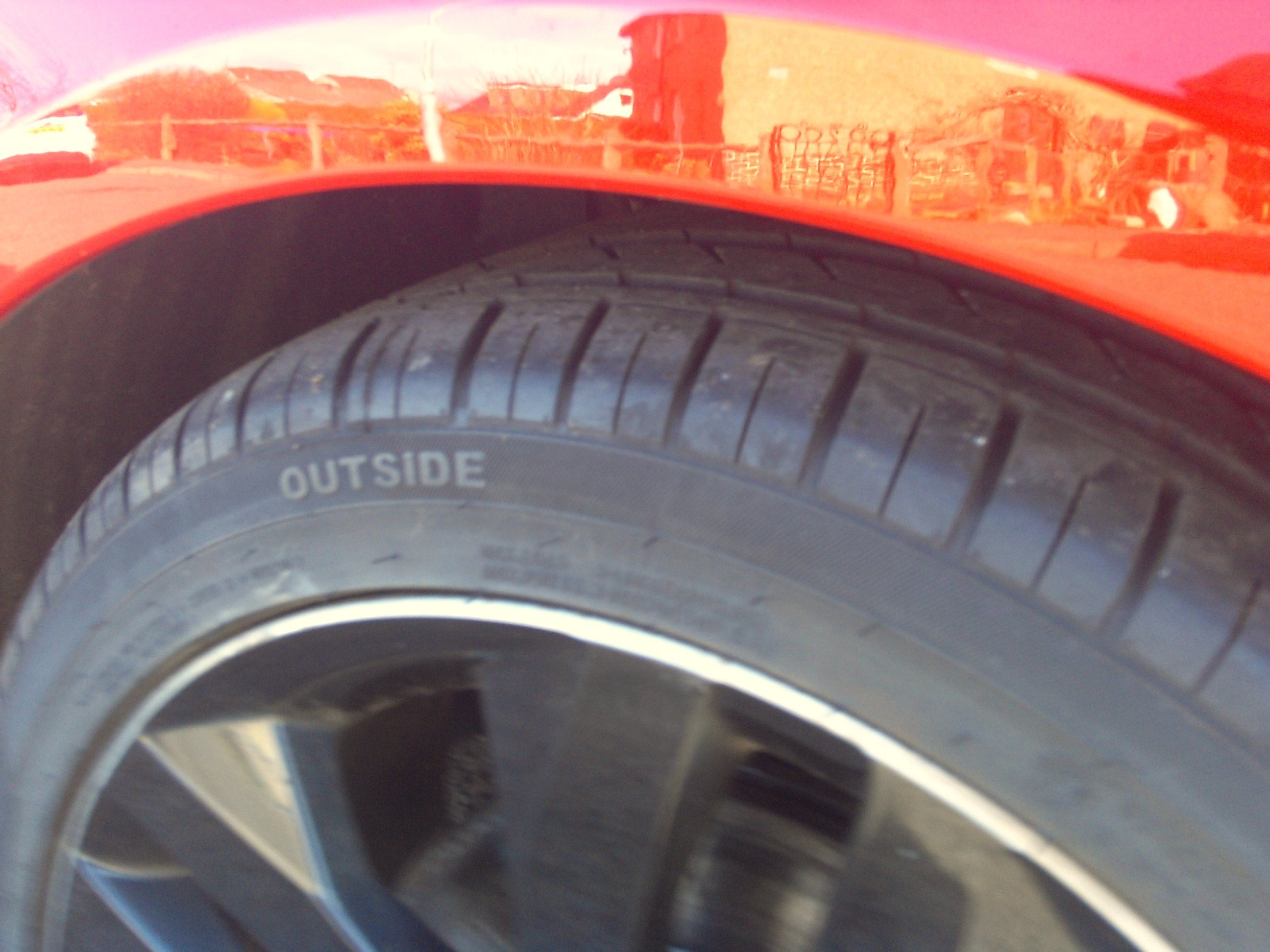

  • I looked and most are (but they never say, you have to zoom over the pic and see if you can see "rotation" anywhere).  But on these I can only see "outside" - but I still don't believe it looking at t
  • I agree that they *look* like they'd prefer to roll in one direction but it's only marked with inside/outside and they only make one tread pattern.   If it were directional and asymmetric, i

@aka_pseudonym - Any tyre marked "this side out" or similar is non-directional. Anything marked "Rotation ->" or similar is directional.
Apart from rare asymmetric directional tyres which should have both a rotation direction and inside/outside markings ;)
Directional tyres have an arrow in the side to show which was it has to rotate.  They can only be swopped front to rear on the same side of the car, asymmetrical tyres can go on any corner

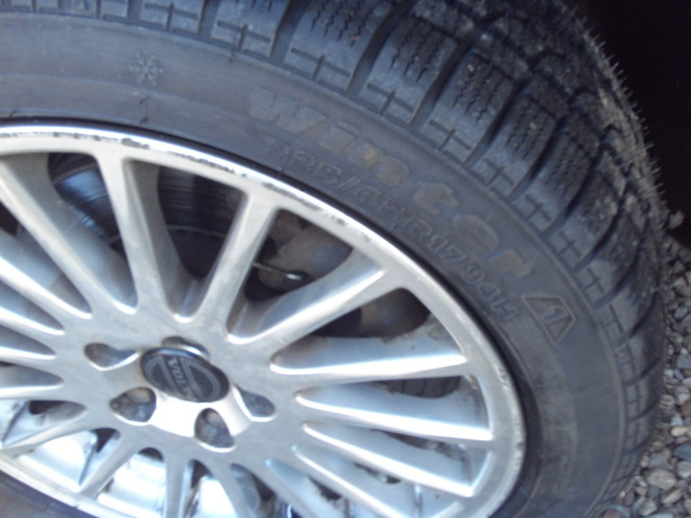

I used to use Winter Remould Van Tyres on heavier cars & because i got them free.
Stirling Remoulds were a favourite of mine.
These were All-Weather Van tyres i was using on a not heavy pickup.
Goodyear Cargo Vector 2.
Edited by Offski
Snow has made a nice little circle in that wheel!  All ready to get at the bolts.
I wouldn't do 118mph on that van tyre!
You do not have to do speeds though do you, the tyres have to have a safe margin with a speed rating.
