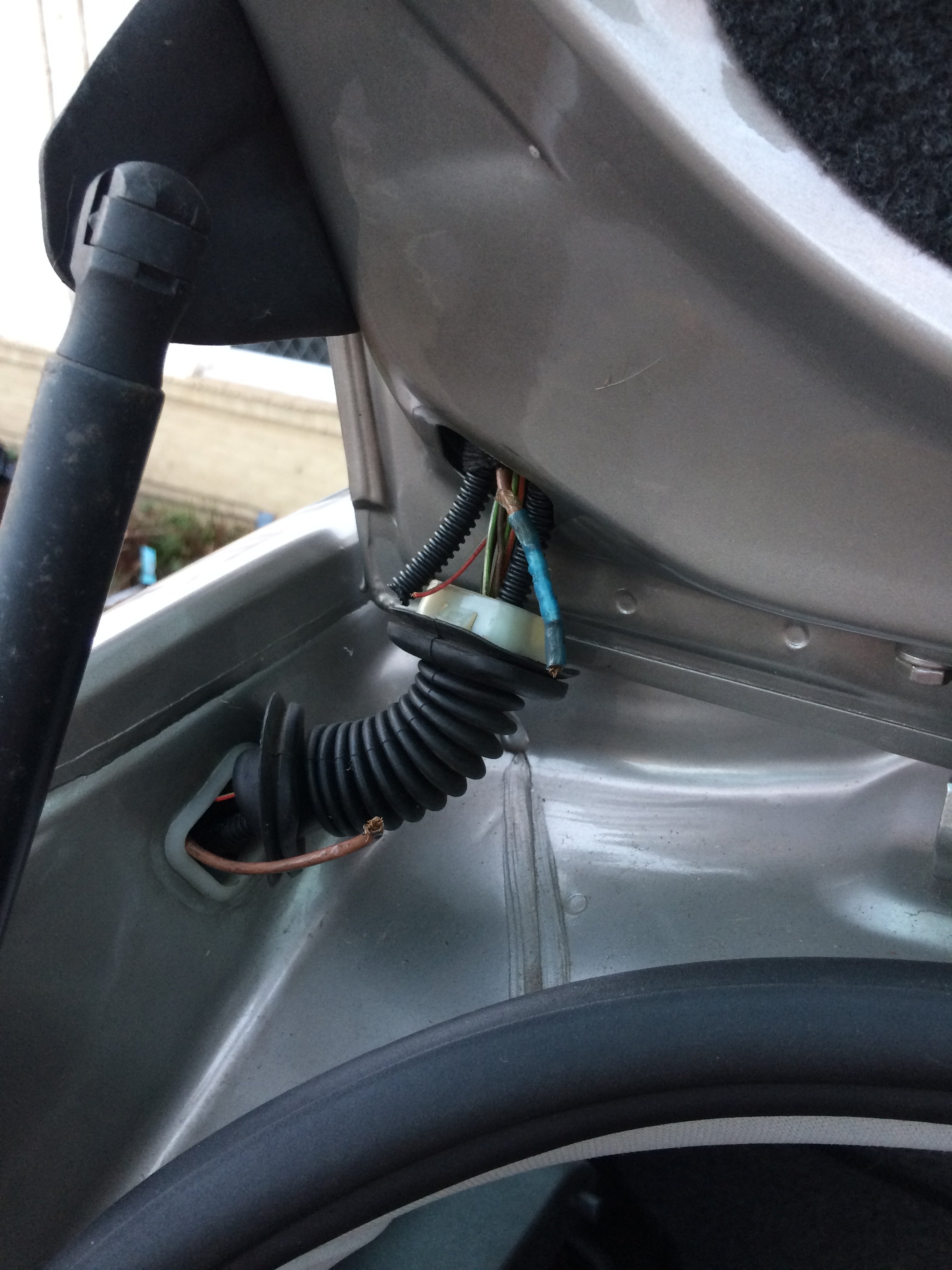

Hi, we just got our Roomster second hand a couple months ago and recently we descovered our boot unlocks when the headlights are turned on. Doesn’t matter if the cars parked in the driveway or we’re driving. As long as the car is on the boot unlocks when the lights are switched on. Has anyone ever encountered this problem?

I had a similar issue with a 2009 Superb when the fog lights were turned on. This was caused by the wiring into the twin hatch wearing with the constant opening / closing cracking the sheaths and shorting. No further issues after stripping it out and soldering in more flexible wires.
We figured it out yesterday!! After a massive hunt of all the wires we could find going to the boot we discovered on the top passenger side of the boot door a rubber casing full of wires. After removing it we discovered 2 broken wires. We stripped them, soldered them and wrapped them, replaced the rubber casing and problem solved! Turned out the other split wire was the rear windscreen wipers we didn’t even know were broken. So happy we saved ourselves potentially £100’s from an auto electrician.
Nice work!  Sadly, a common fault.
