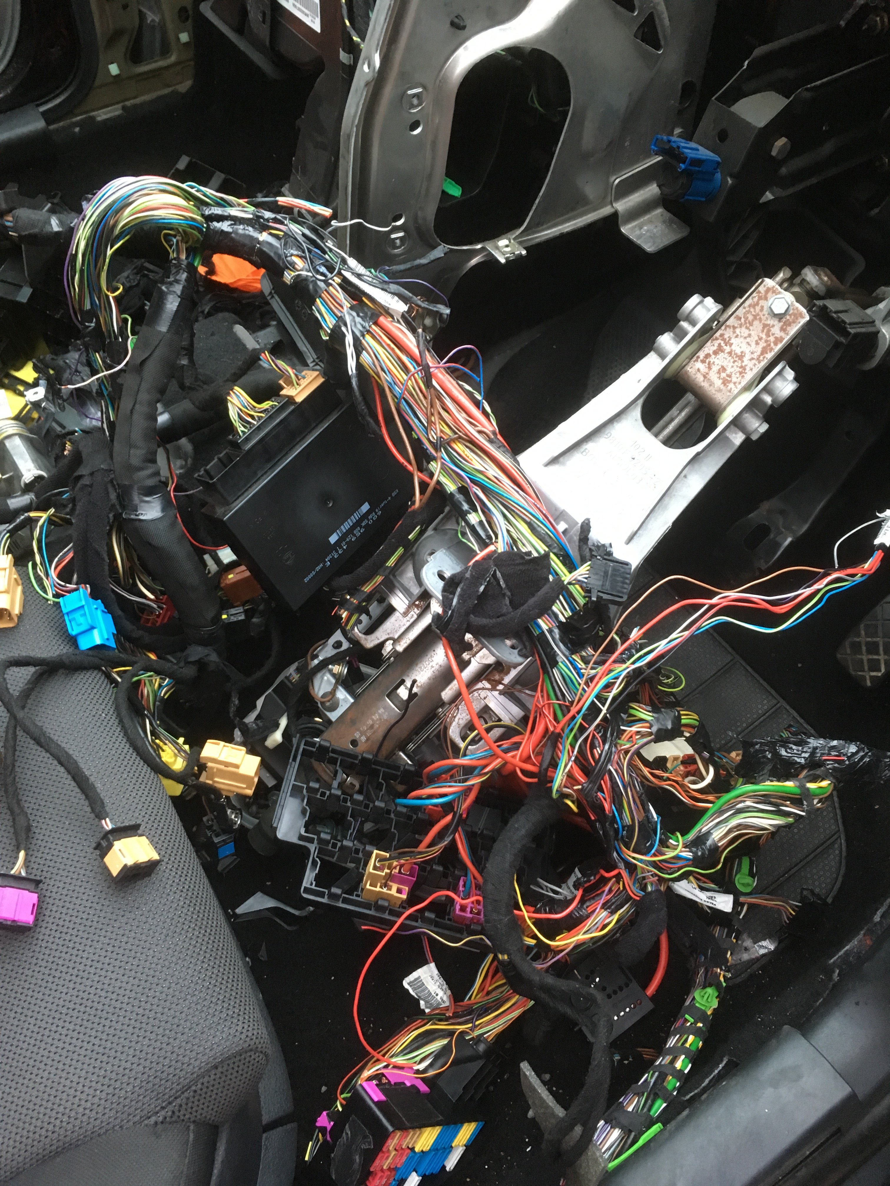

Made a start on stripping dash out of Ibiza to get the wiring to swap

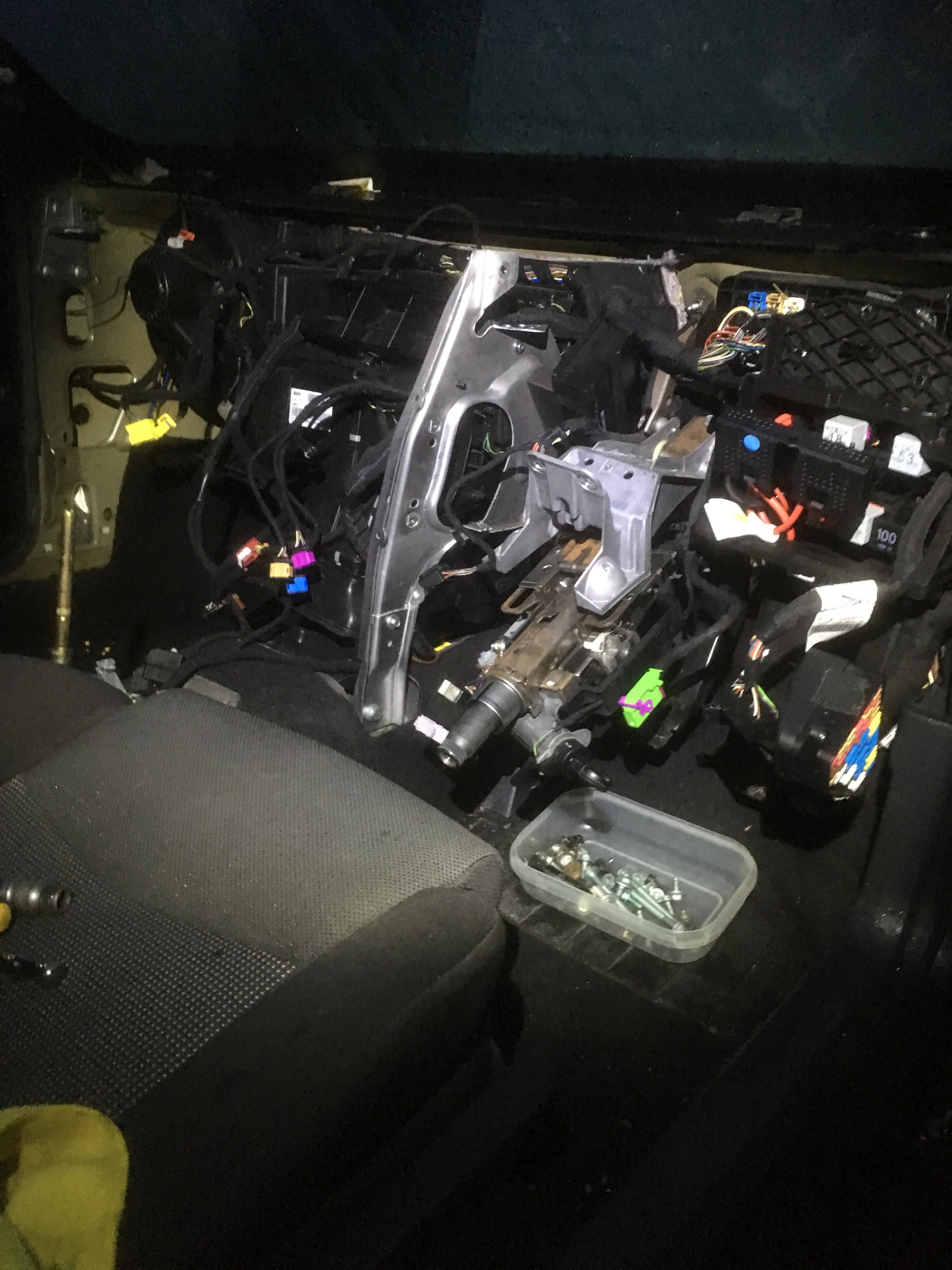

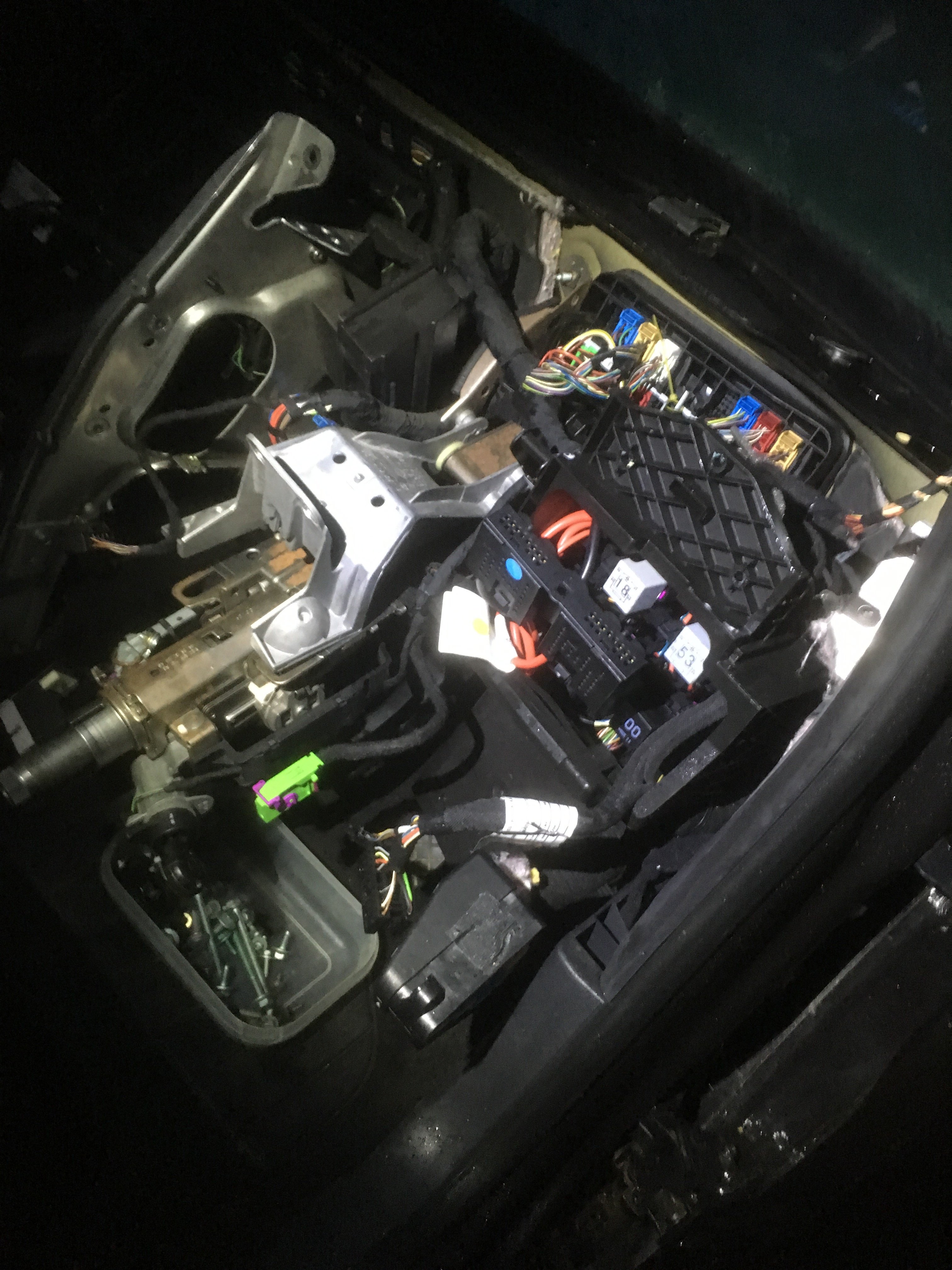

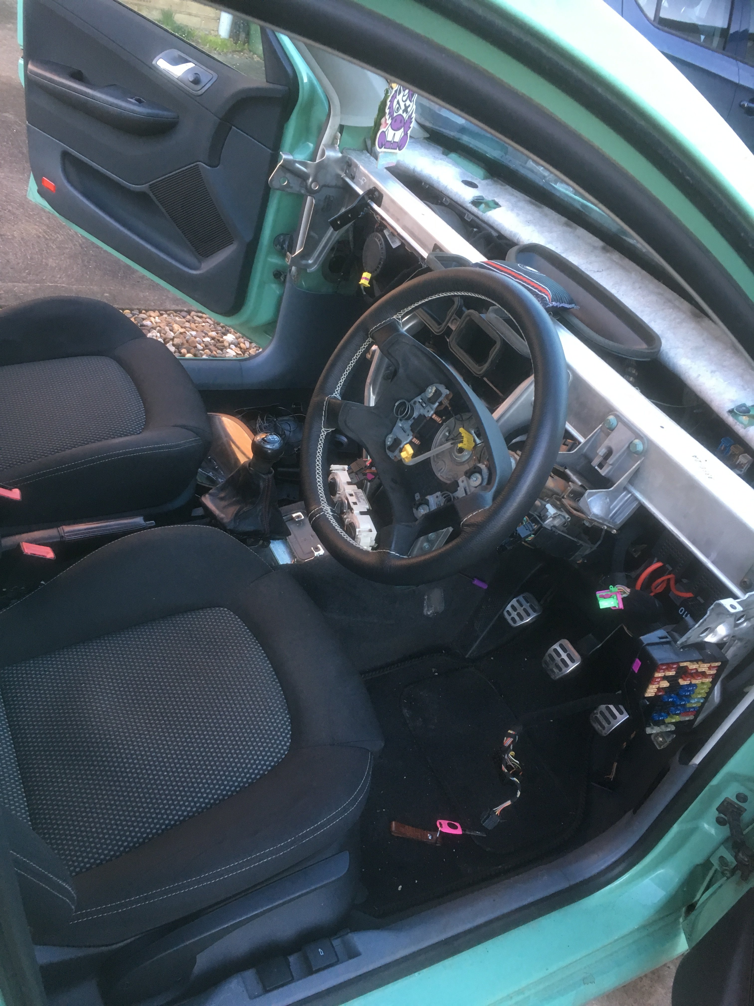

Got the Fabia dash out this afternoon, need to spend a hour or so stripping the relay/fuse/wiring out of the ibiza required to run the ecu, and then swap it into the Fabia, it’s a horrible job getting the old insulation off especially in cold weather. Job for another day.
Tempted to do something with the Fabia while it’s all out, I might look for a facelift dash or get this one flocked or something

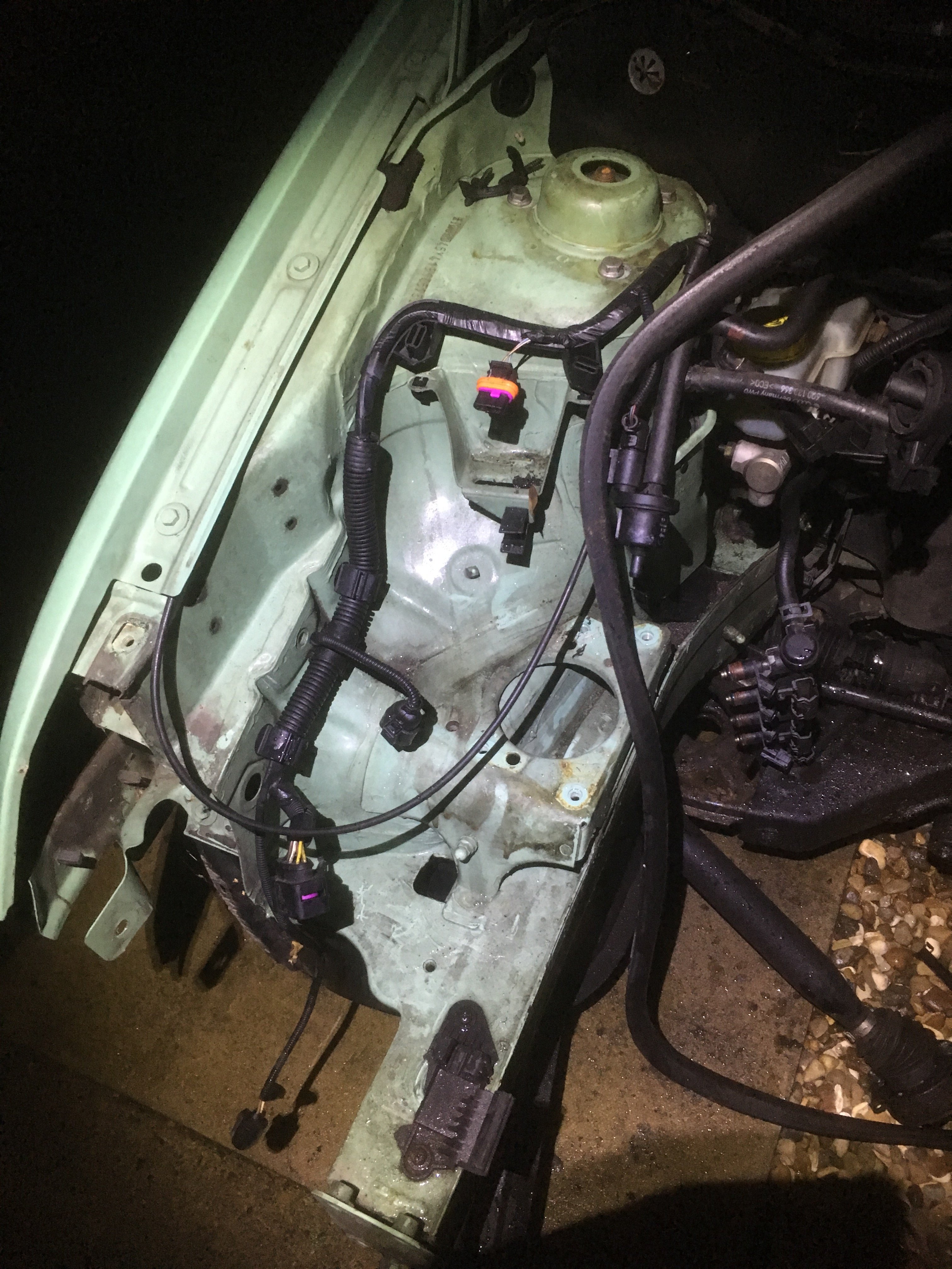

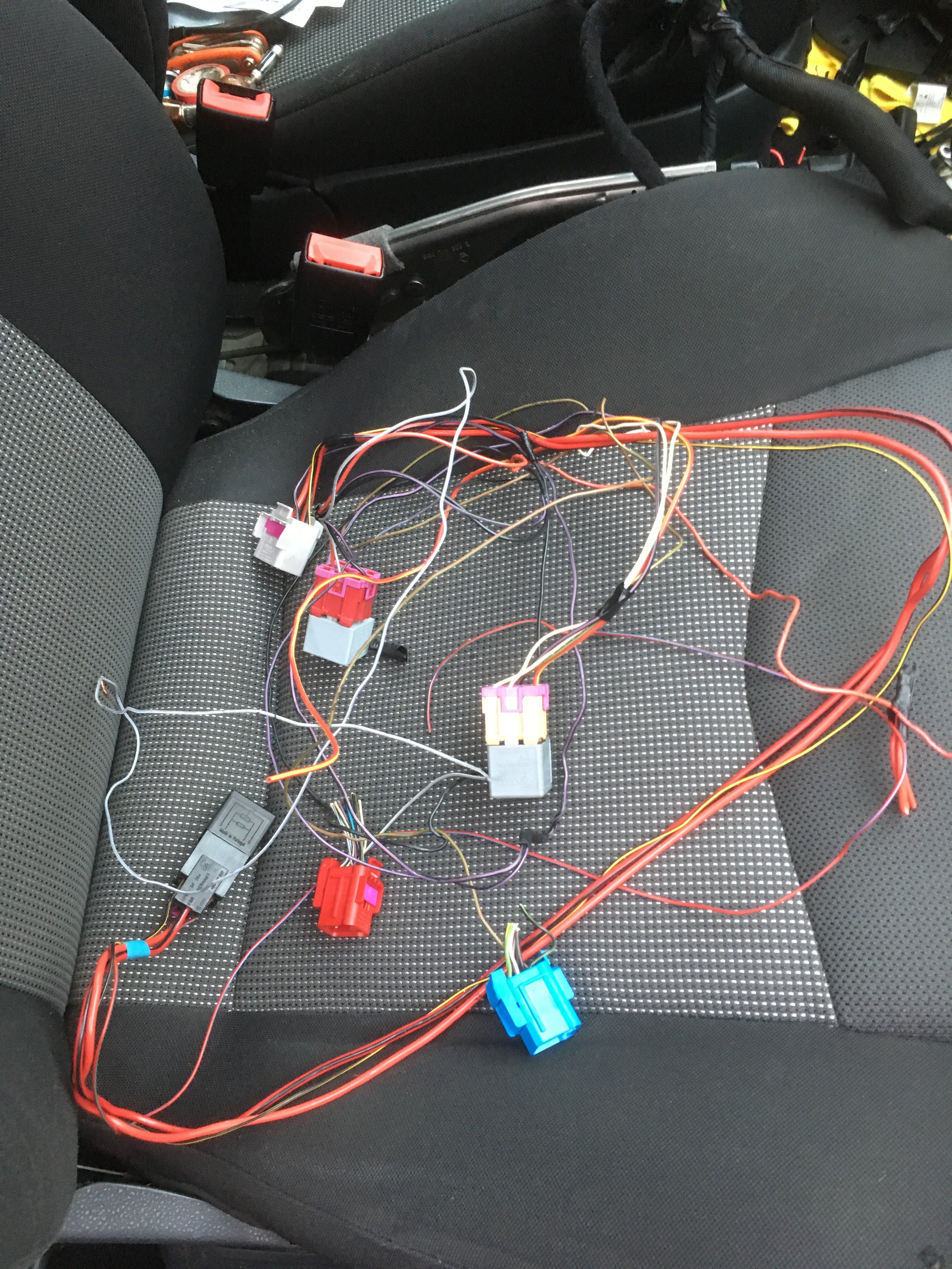

Required relays stripped from Ibiza loom, horrible job with the sticky insulation :x, still that’s the hard part. I’ll get it installed maybe this week sometime. Then I can get the Fabia interior back together then it’ll just be the mechanical stuff left.
I don’t envy you doing all this wiring work Trevor, I hate it! Will everything function just as it should when back together or are you removing lots of things as you go?
Fabia loom will remain original with these relays added in so everything will stay oem central locking/windows/heating etc, looks worse then it is, these will be run separately so the Fabia loom doesn’t need to be opened up

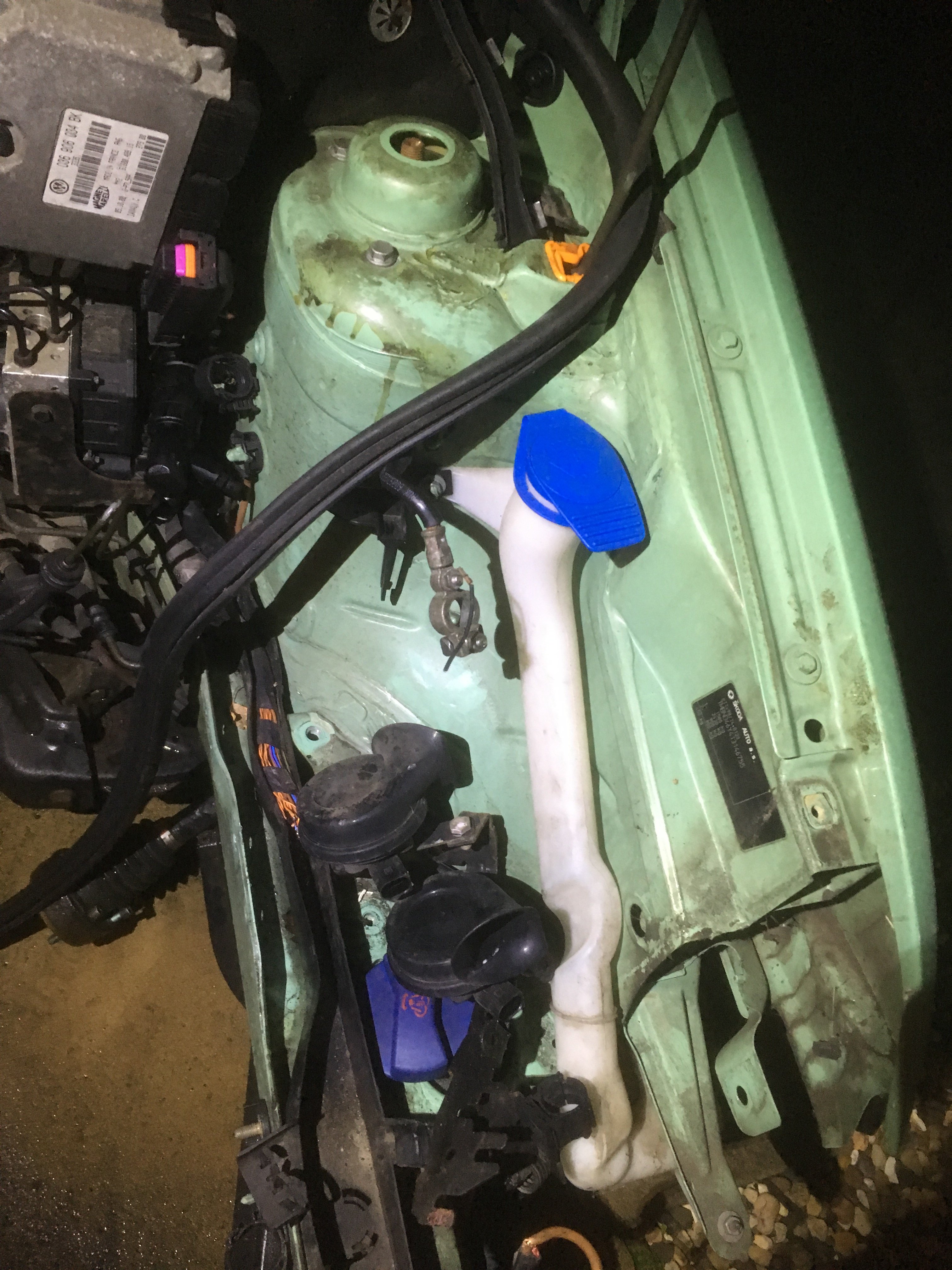

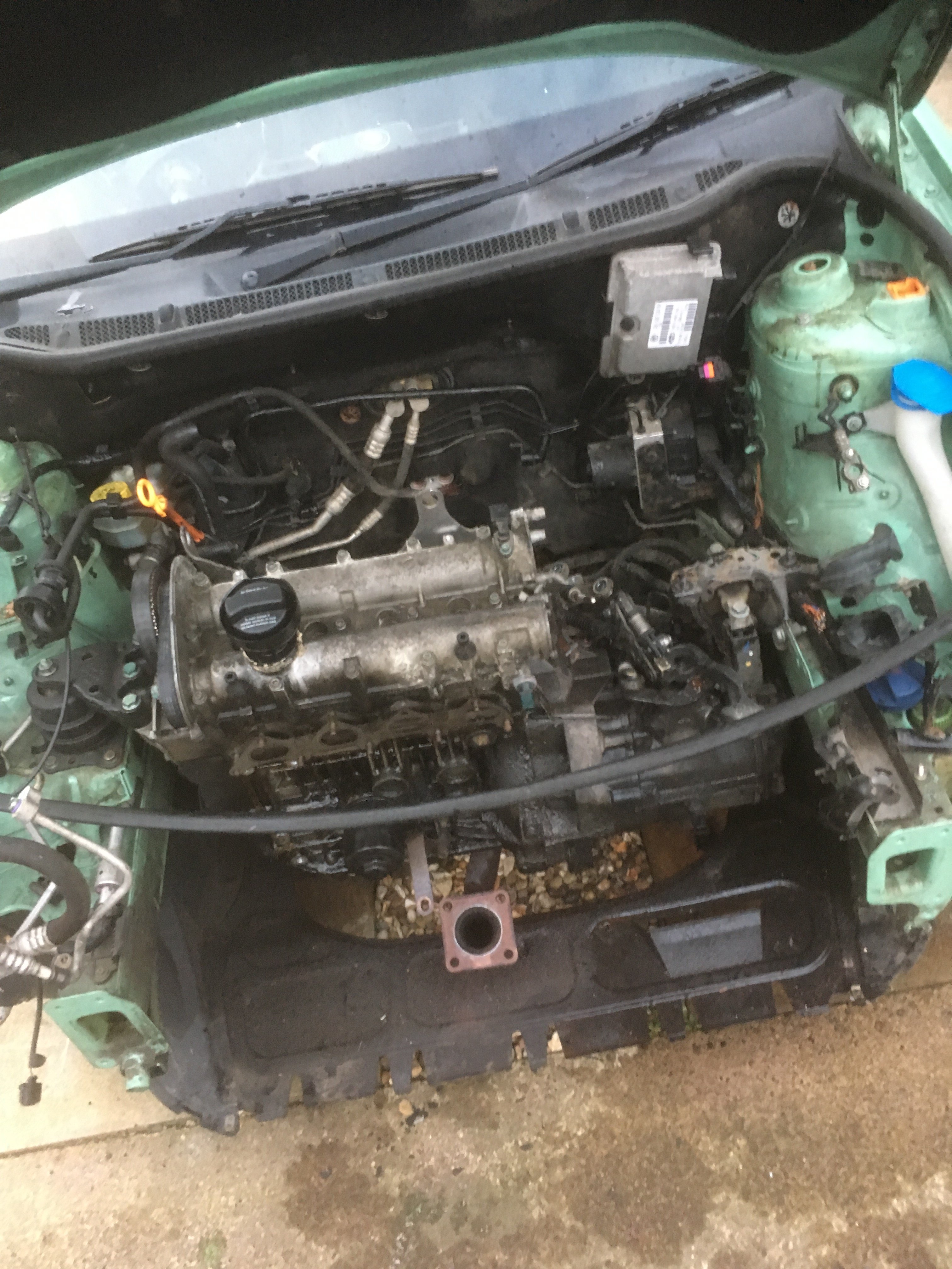

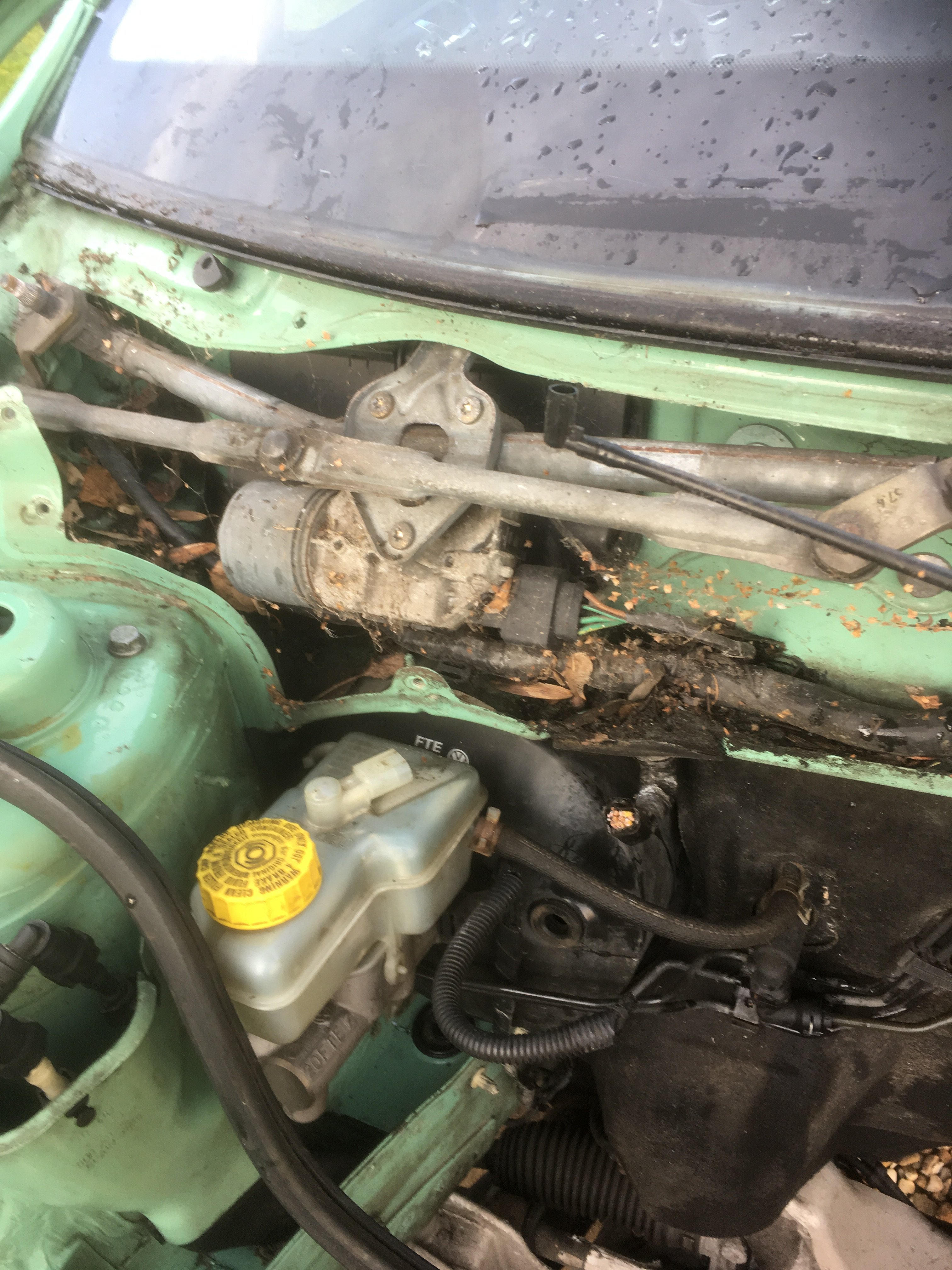

Made a start on stripping engine out of Fabia, I’ve got next week off so should get it virtually there. Just driveshafts slave cylinder and mounts and she’s out

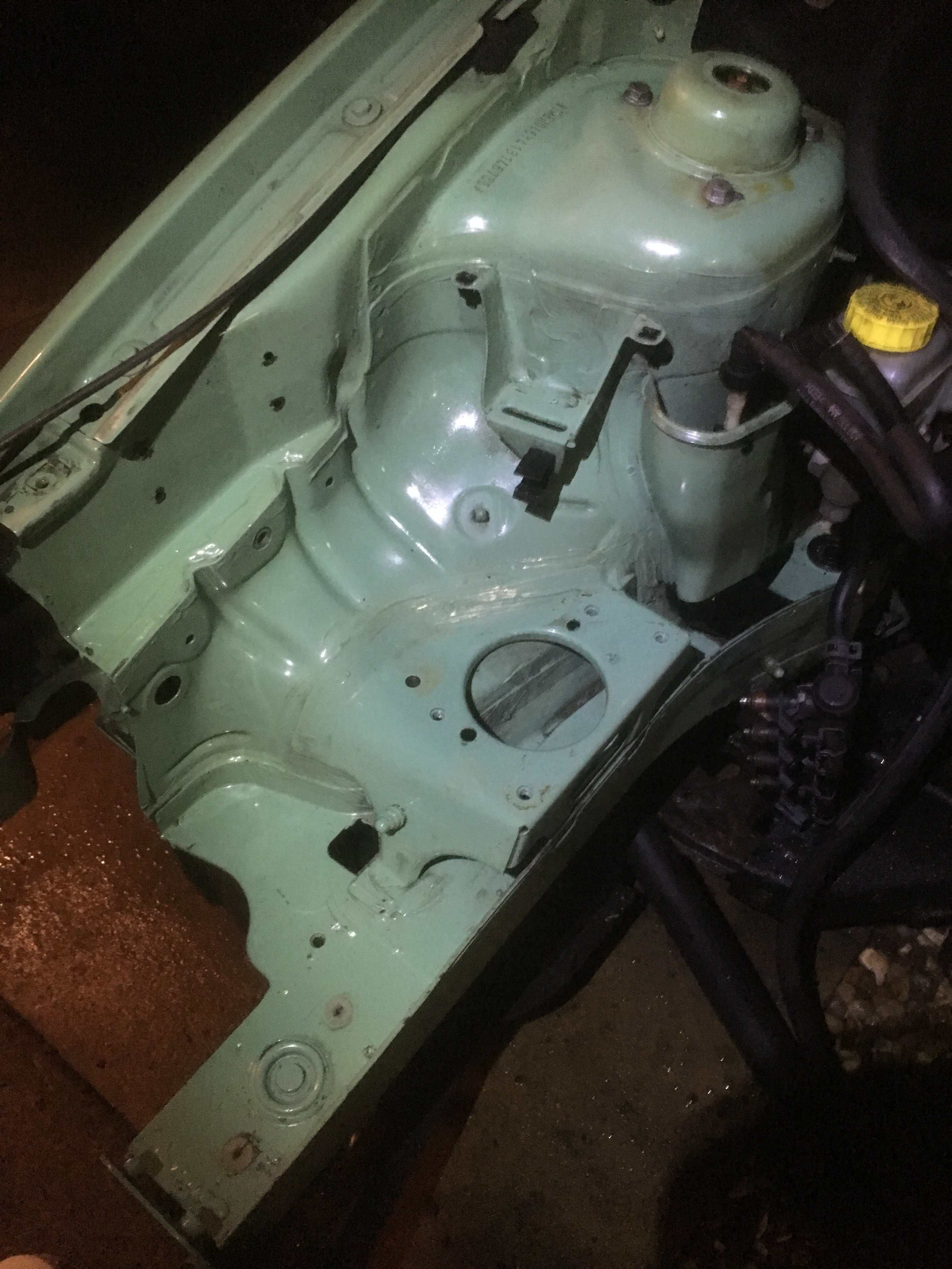

That last picture Trevor, it makes me want to get into the empty engine bay and clean/polish everything up, will you be going down that semi-bufty route?

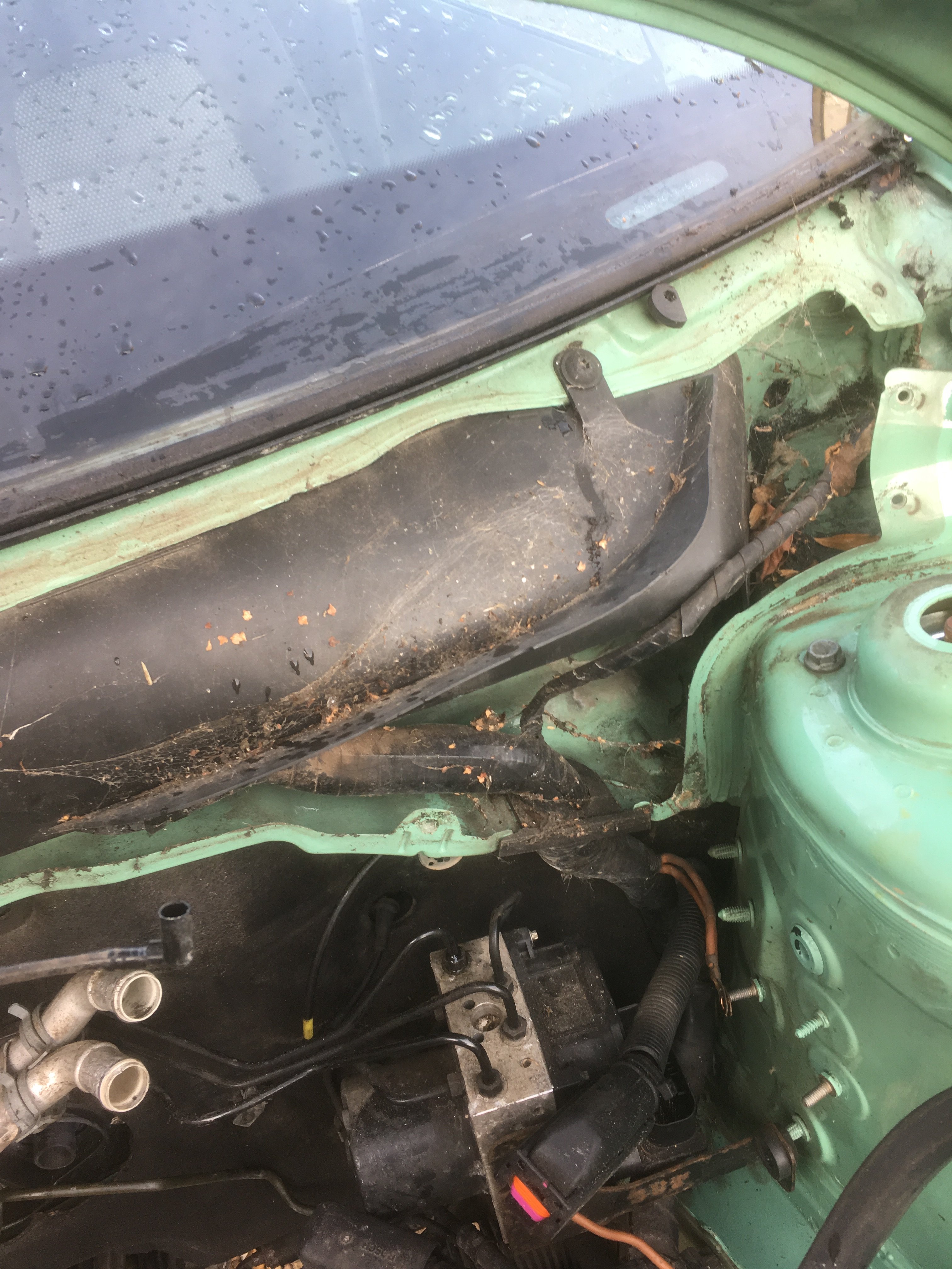

The old engine had leaks pretty much everywhere, it’s certainly grimey :tongueout:,  I’m not in a major rush to get the other engine in so I should have a coupe of hours to give the empty bay a good clean. I’ve actually got a steam cleaner that should do a pretty decent job too, I’ll just get hold of some degreaser. It’s never going to be show quality at the end of the day it’s a £100 17year old Fabia lol

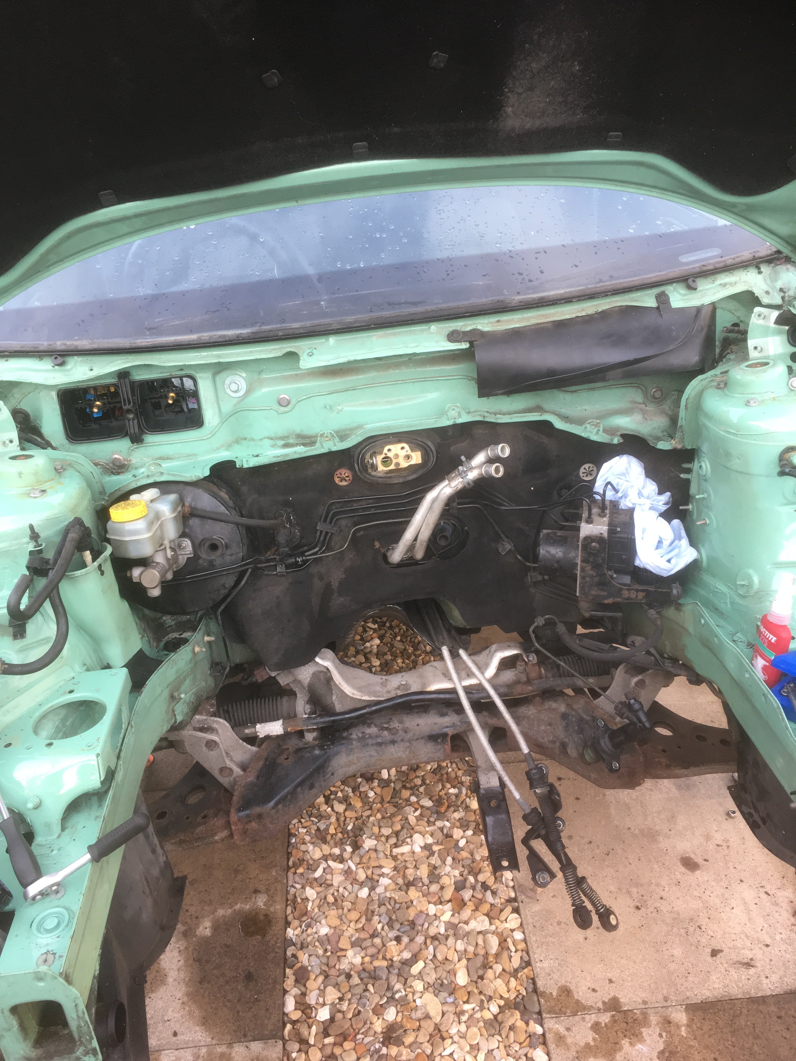

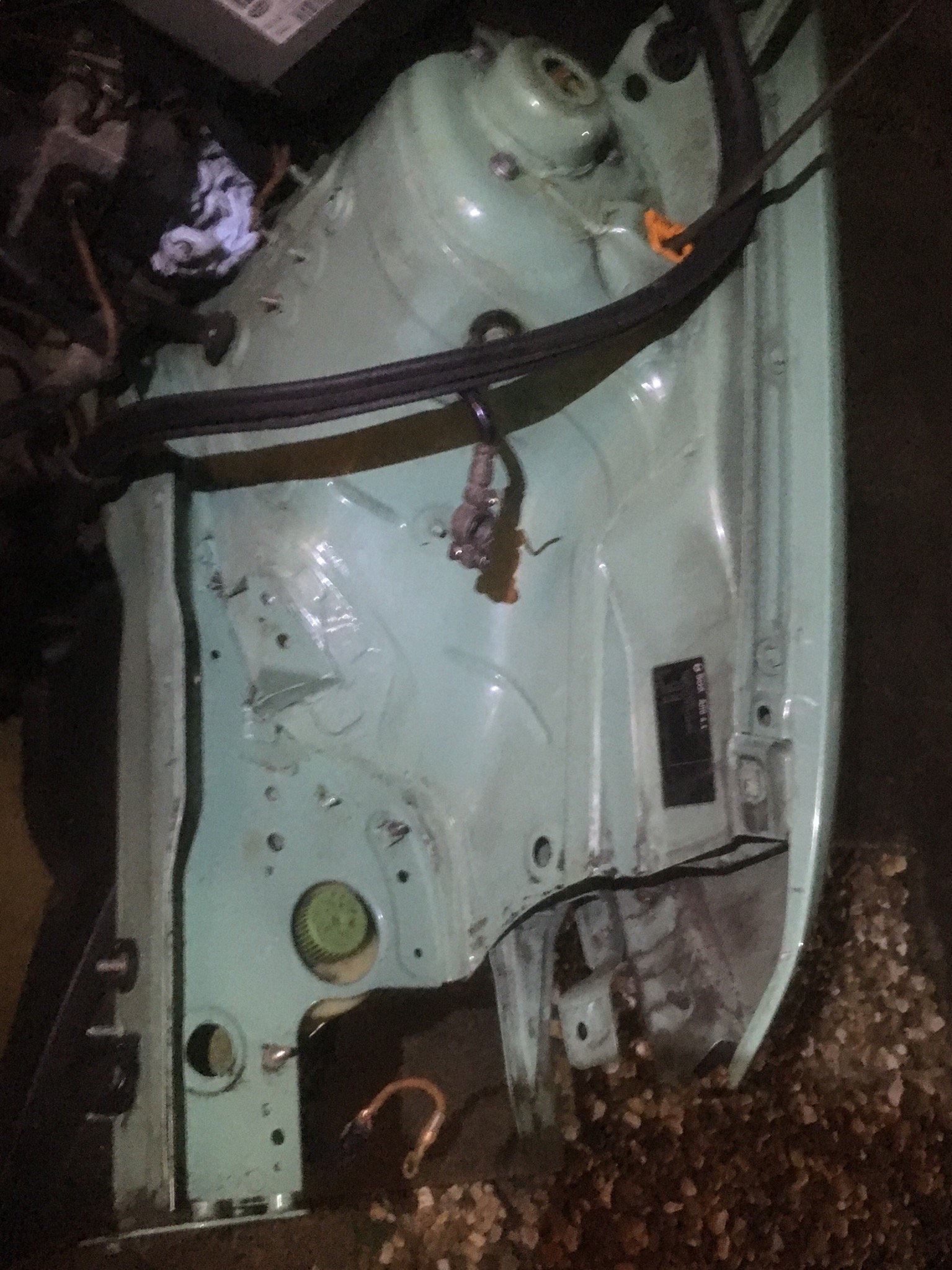

Engine out the fab tonight and cleaned the bay a little
Looking good Trevor!!

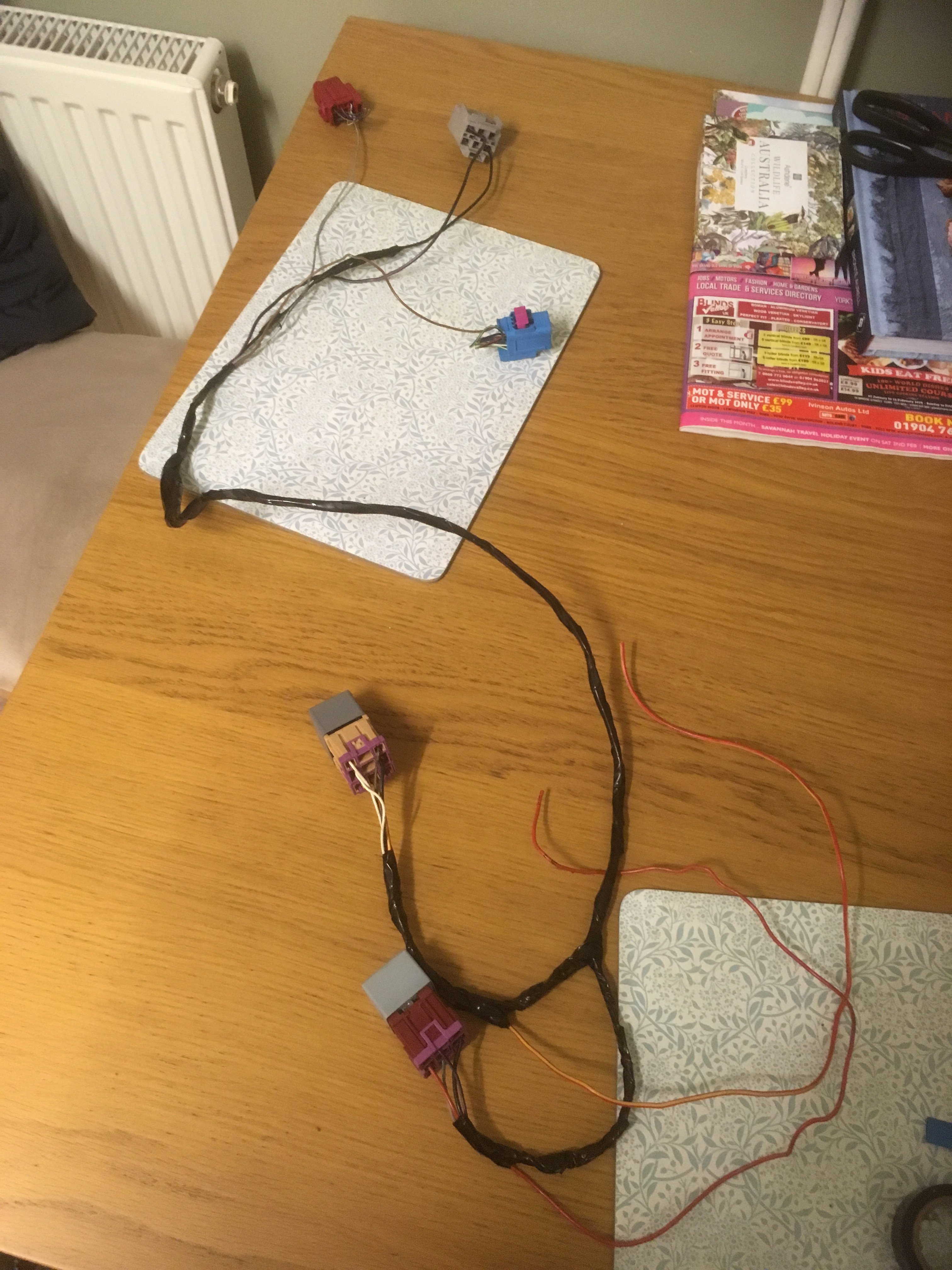

Been tidying up the interior loom ready to fit, binned off the Sai relay as it’s all removed from the Ibiza bay anyway

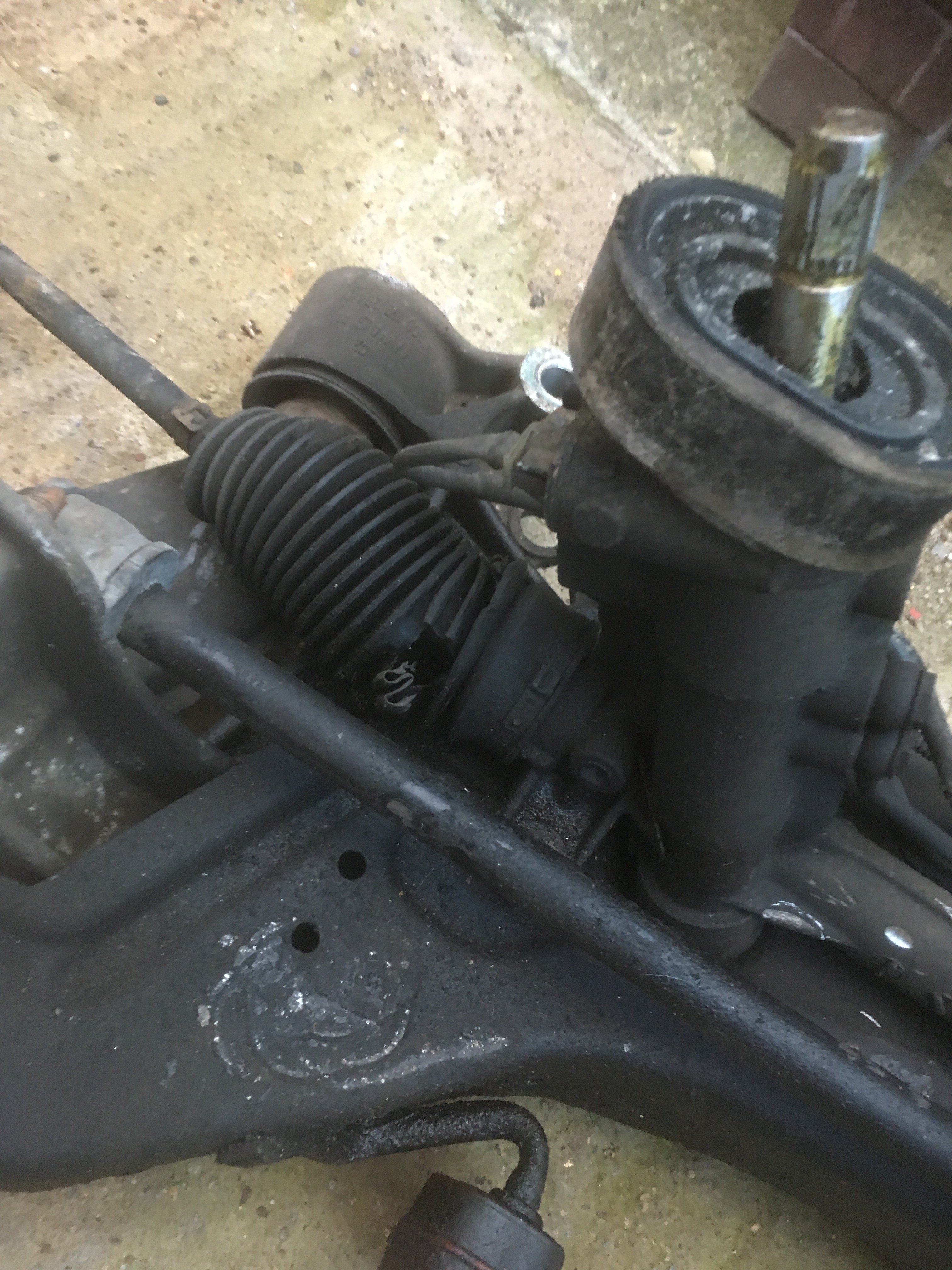

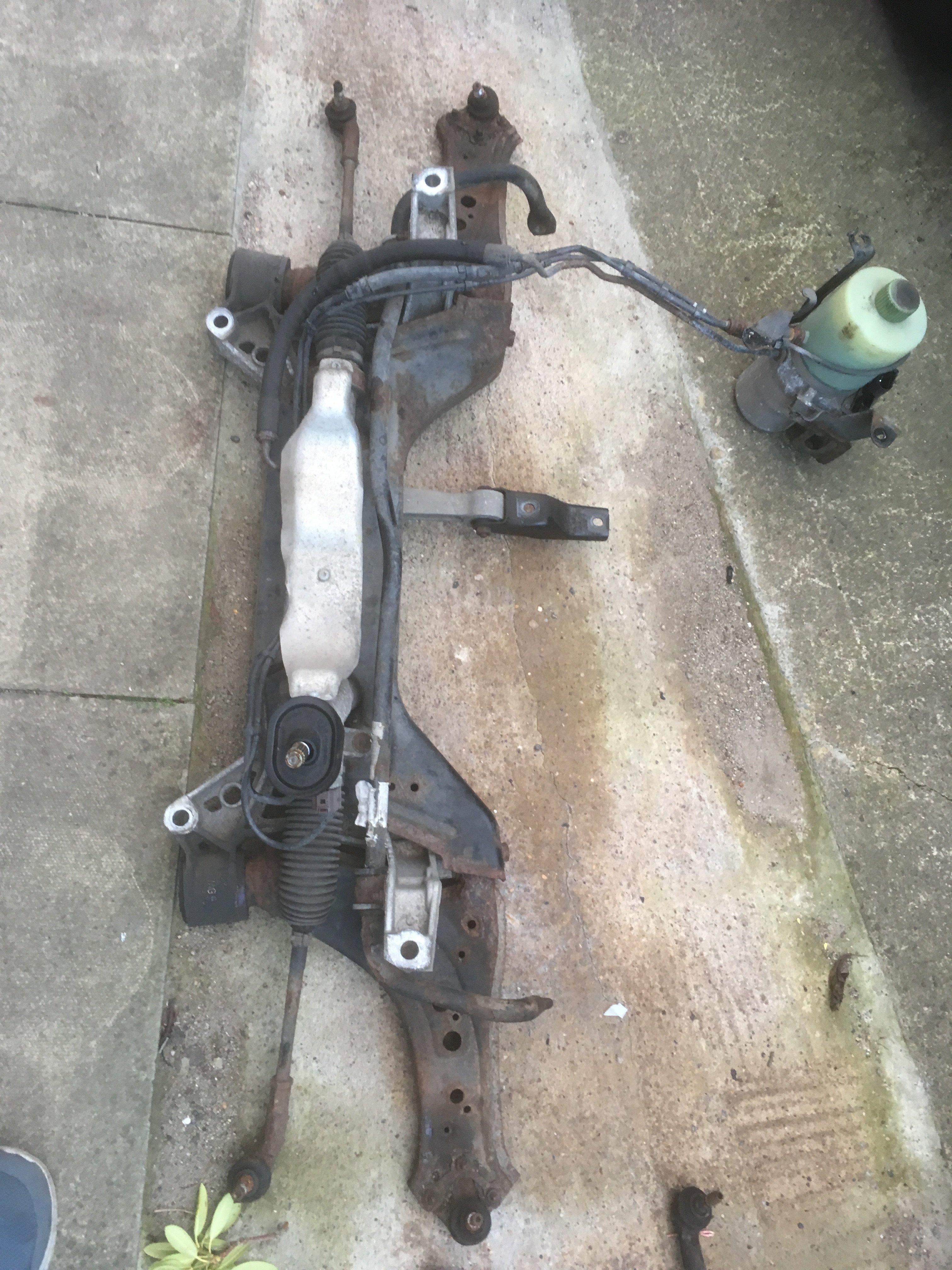

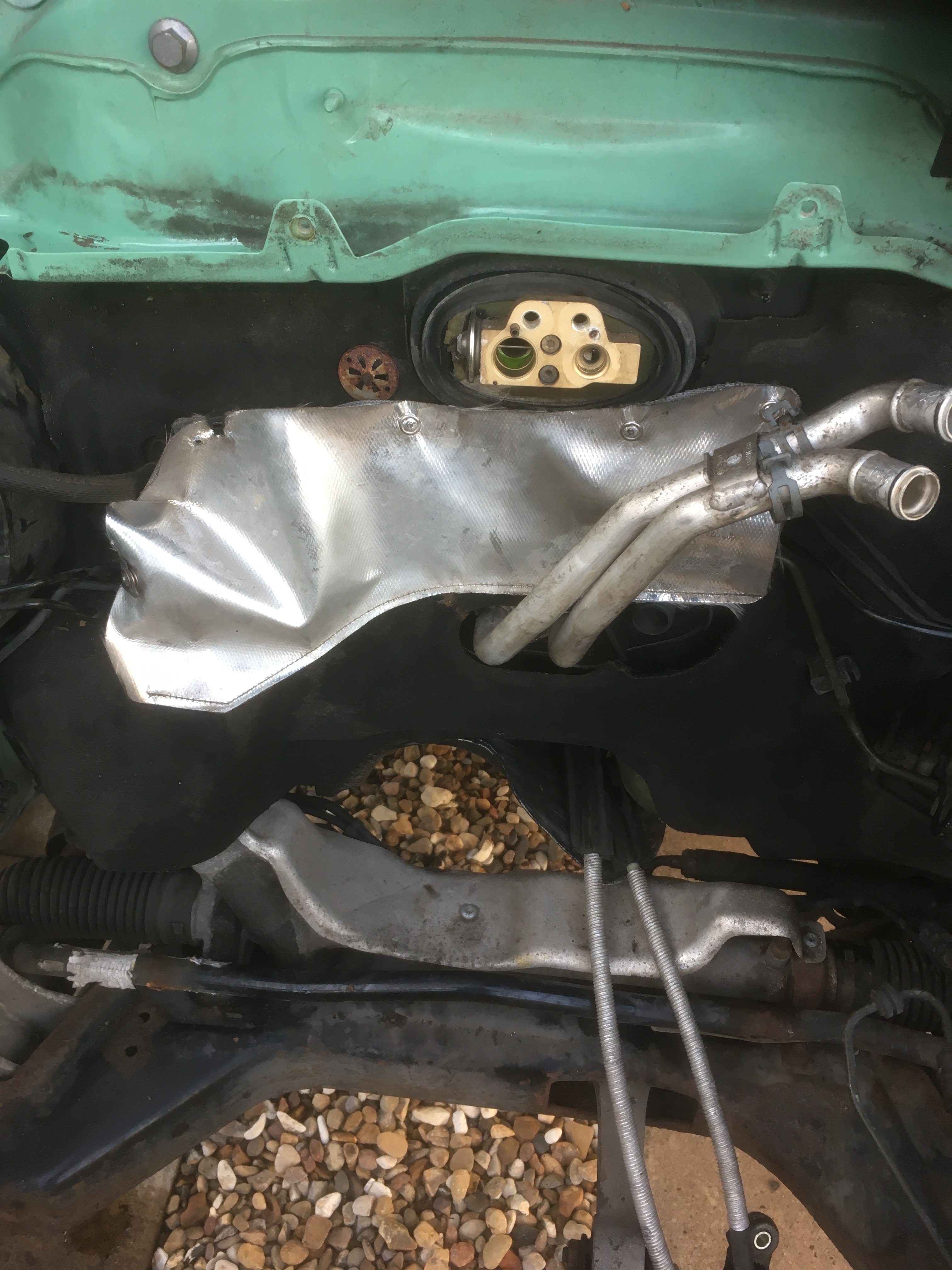

Exhausts off both cars, Fabia was still original and in one piece lol amazing, subframes and power steering pumps removed off both, the steering rack was in poor shape on the Fabia and steering pump was original so swapped the lot including pump as it’s all five years newer.
Shifter mechanisms swapped.
intercooler fitted up to Fabia,
heater matrix pipes fitted to Fab.

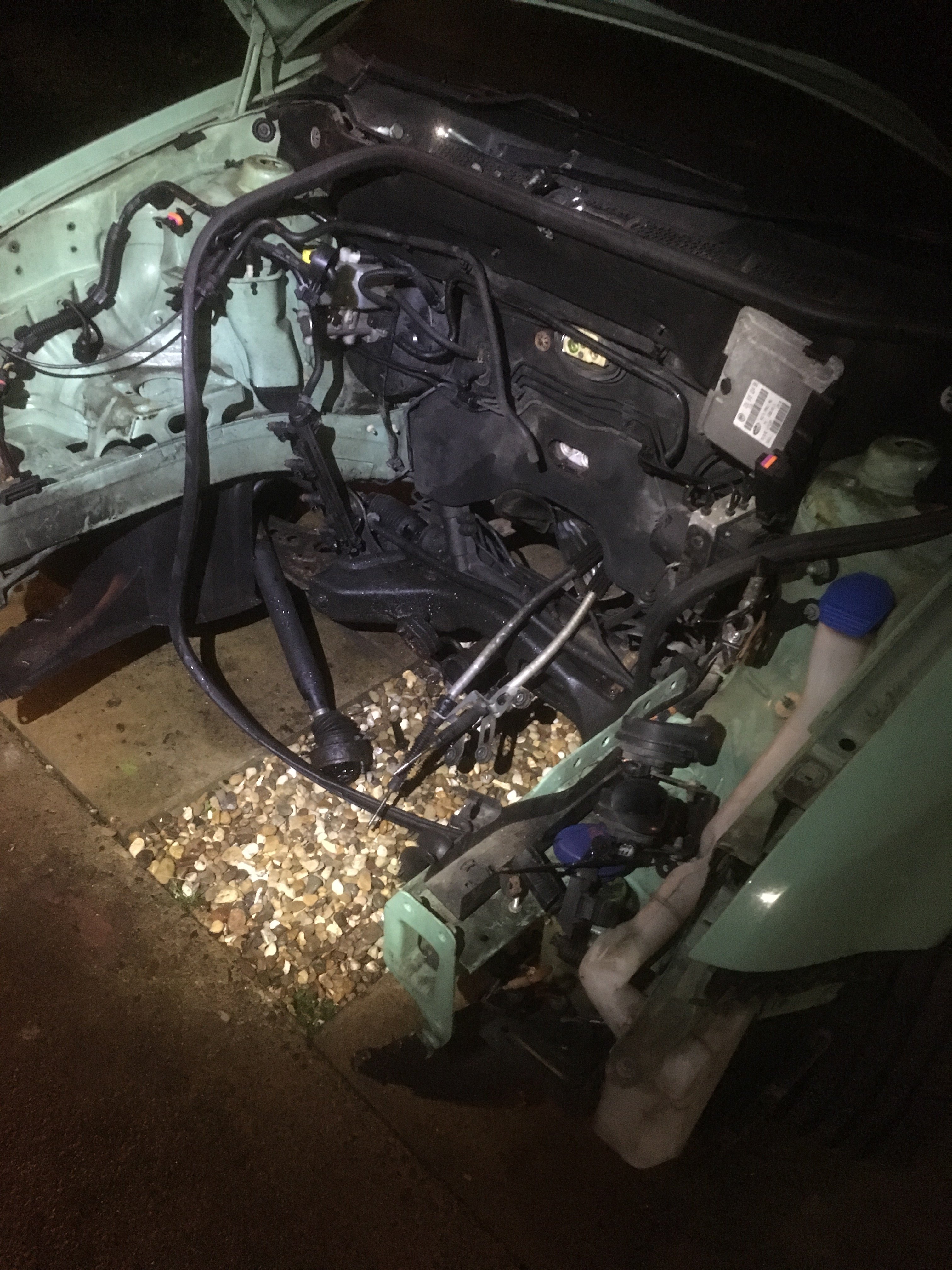

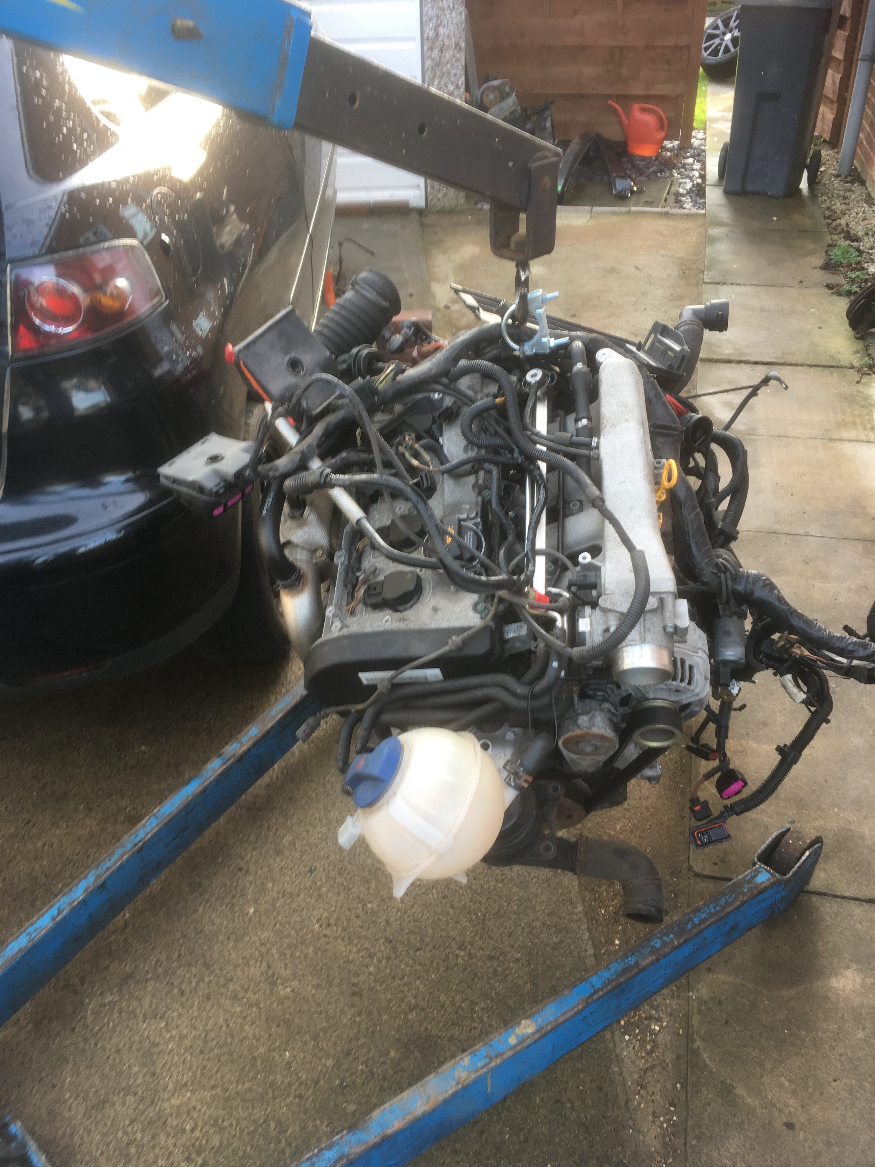

wirings all loose on Ibiza so it’ll be slave cylinder to undo and swap tomorrow and then engines ready for out
Slave cylinder swapped and bled, cleaned out the Fabia under the scuttle as it was filthy, engines out of the Ibiza, should be in by this afternoon, then buttoning up everything

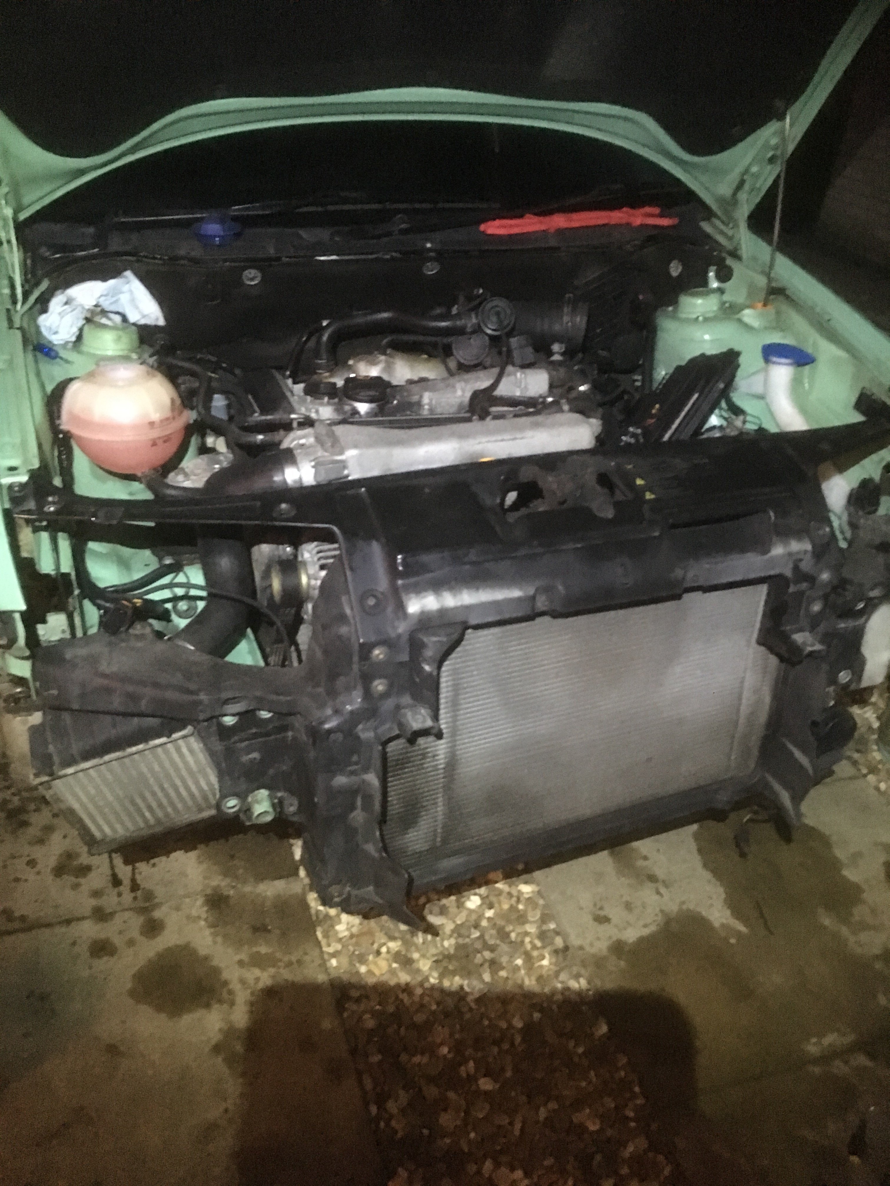

She’s in, slave swapped and bled, insulation swapped around brake lines, driveshafts on, wiring buttoned up, rad on. Holding its own coolant. Just exhaust tomorrow and interior wiring, bolt front end back on
