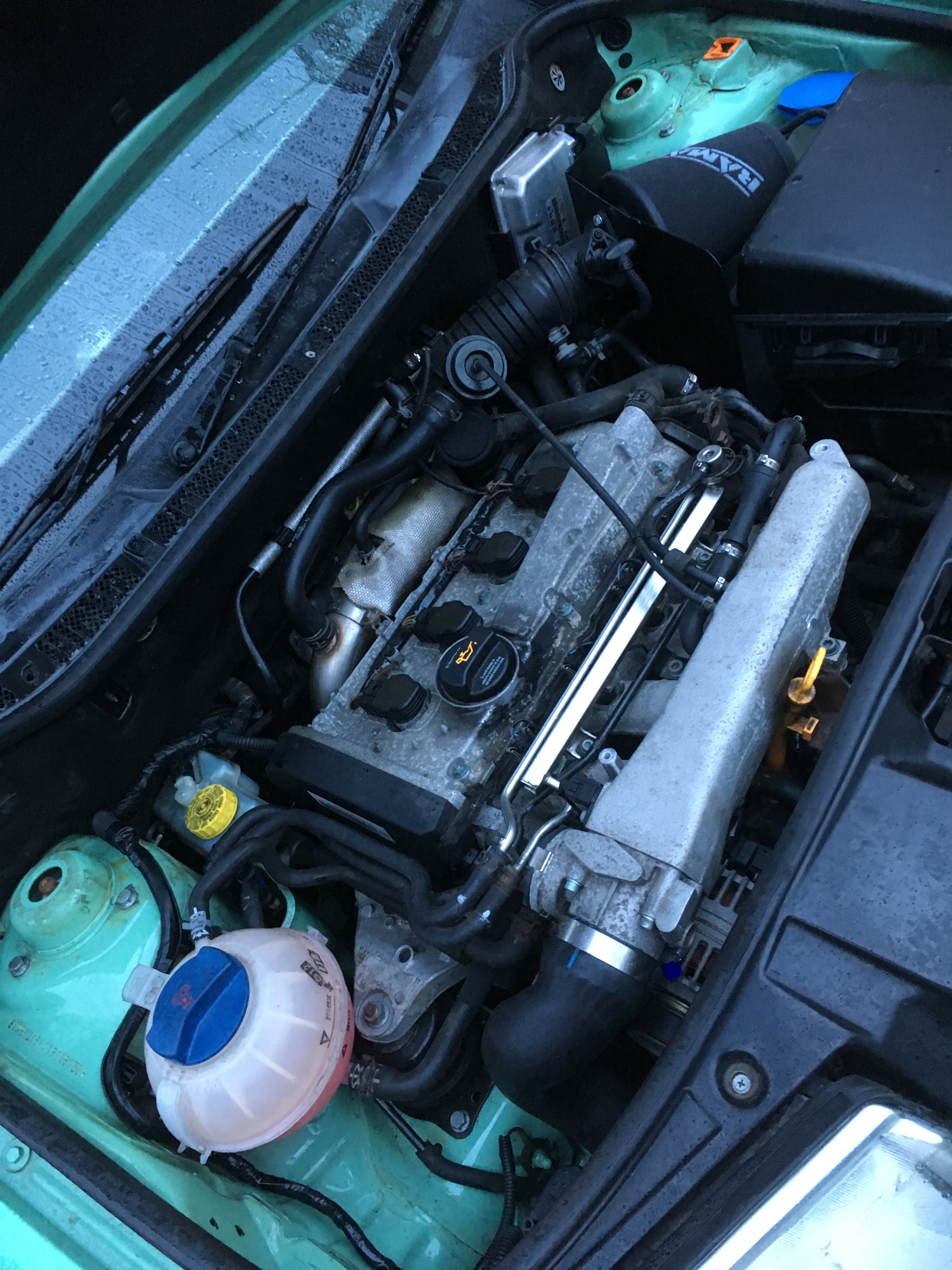

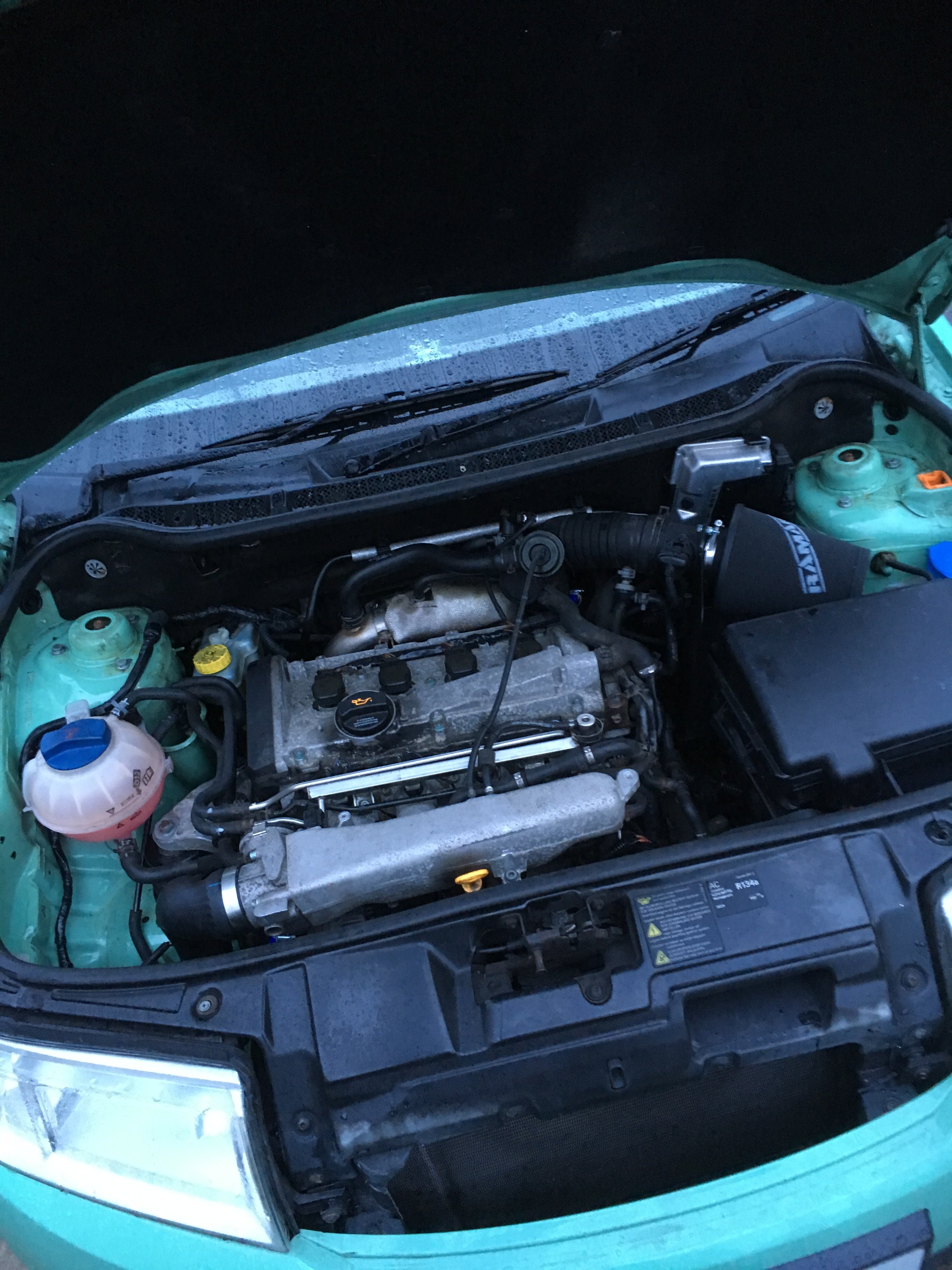

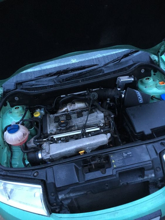

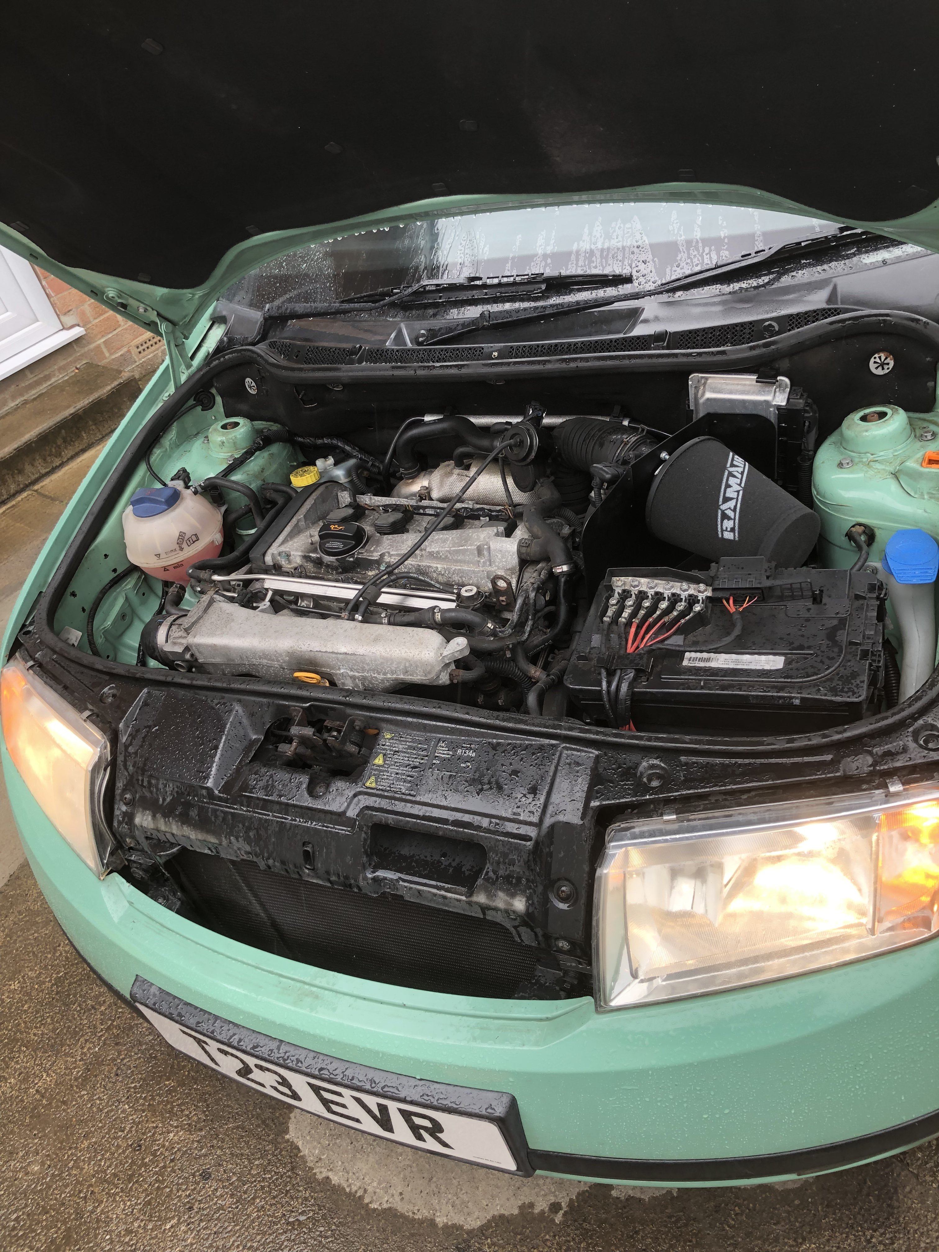

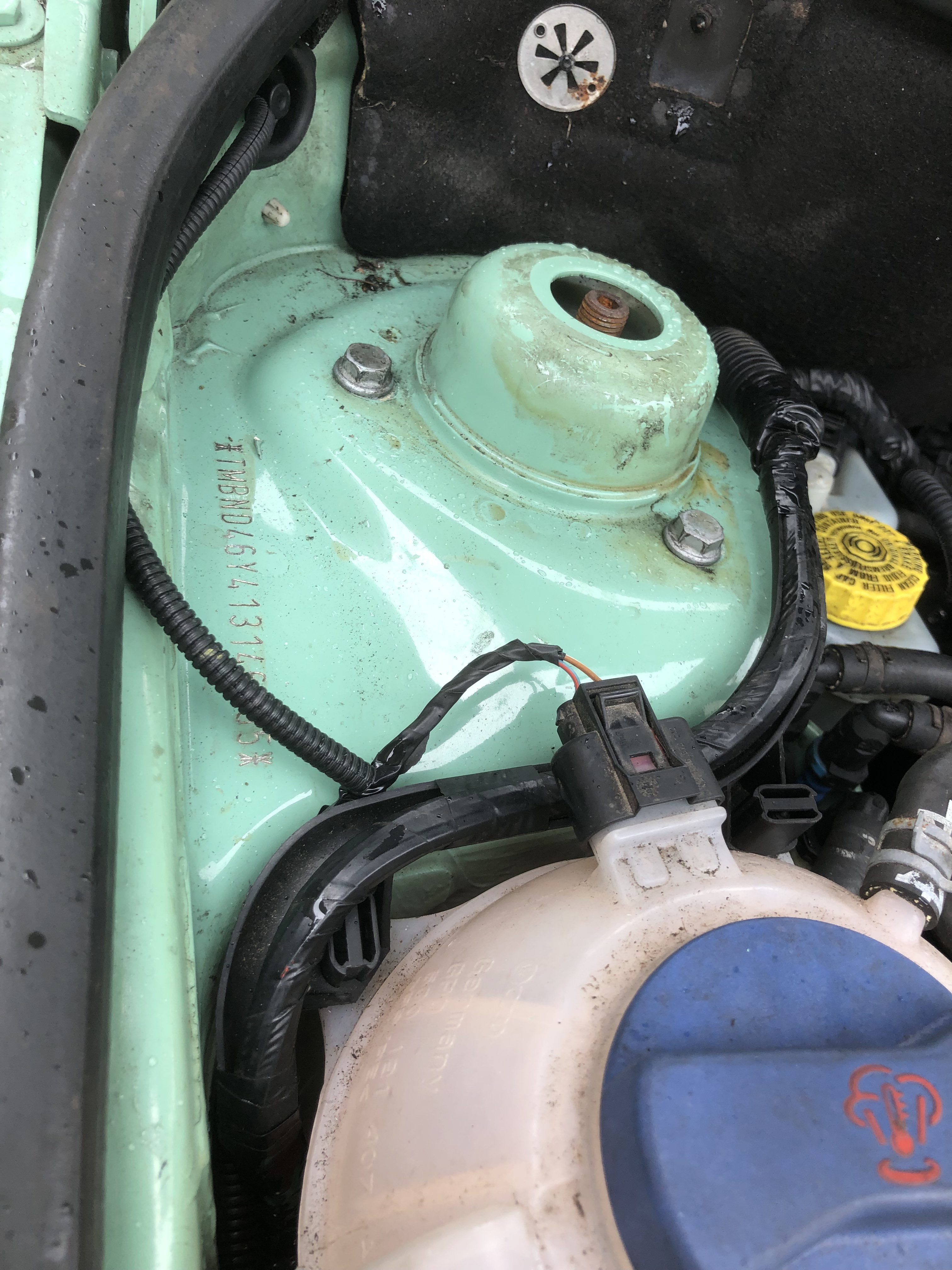

It moved round the block under its own steam today, just needs speedo wiring in and low coolant wiring to bottle, not a major heartache. All seemed well it’s holding coolant fine and heaters are lovely and warm. Coolant run on pumps working perfectly too :). Coilovers have been rIsed on the front too as it would have been stupid low with the extra weight of the engine. I’ll get some more pics tomorrow now it’s finally back on the floor
Looks great Trevor. The engine bay looks like it was meant to be there.

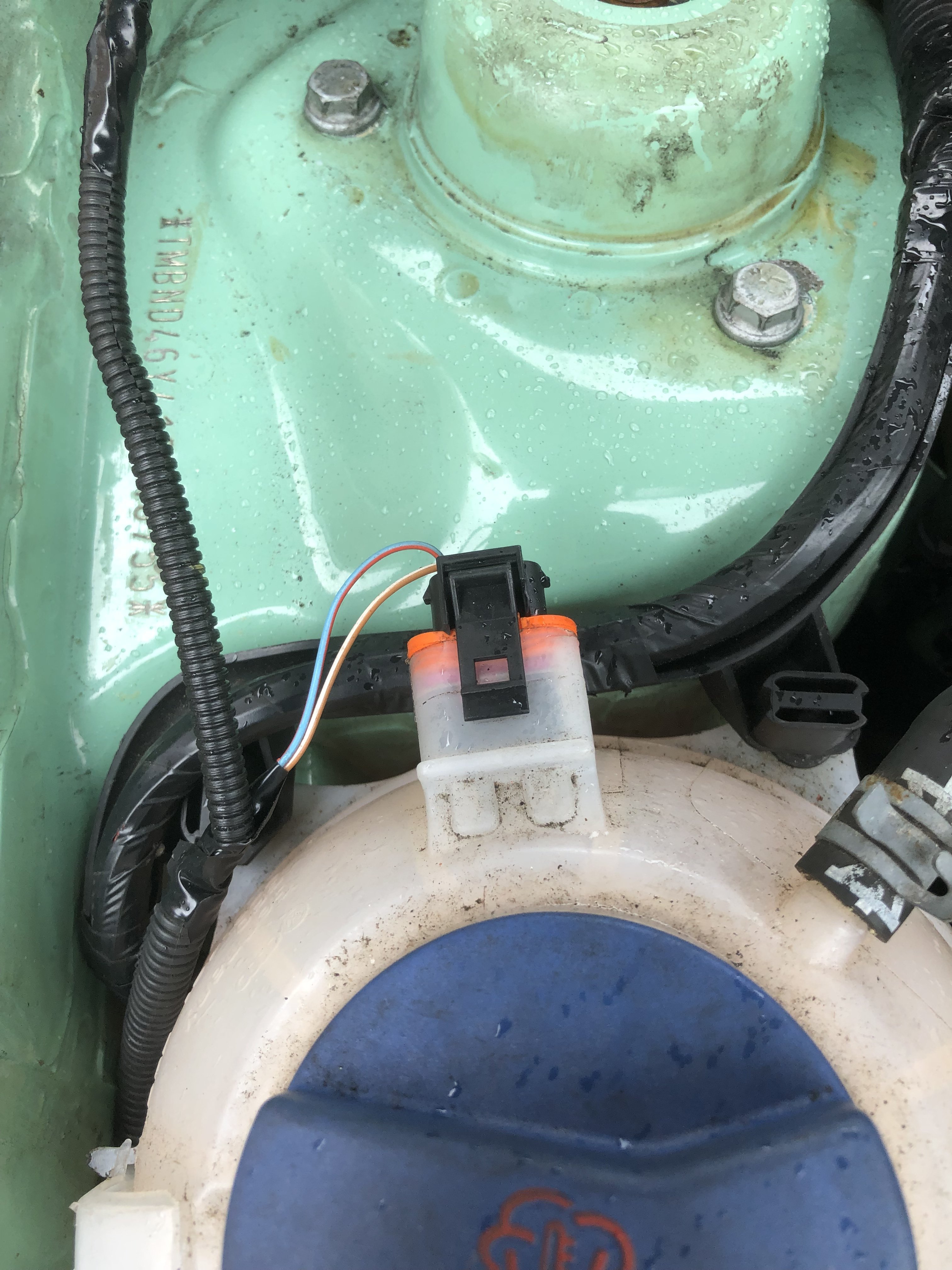

Wipers sorted and low coolant connector wired in to header tank. Been for a run to the petrol station and back circa 8miles and all is well. Just speedo to sort and dash to fit back once it’s done B)

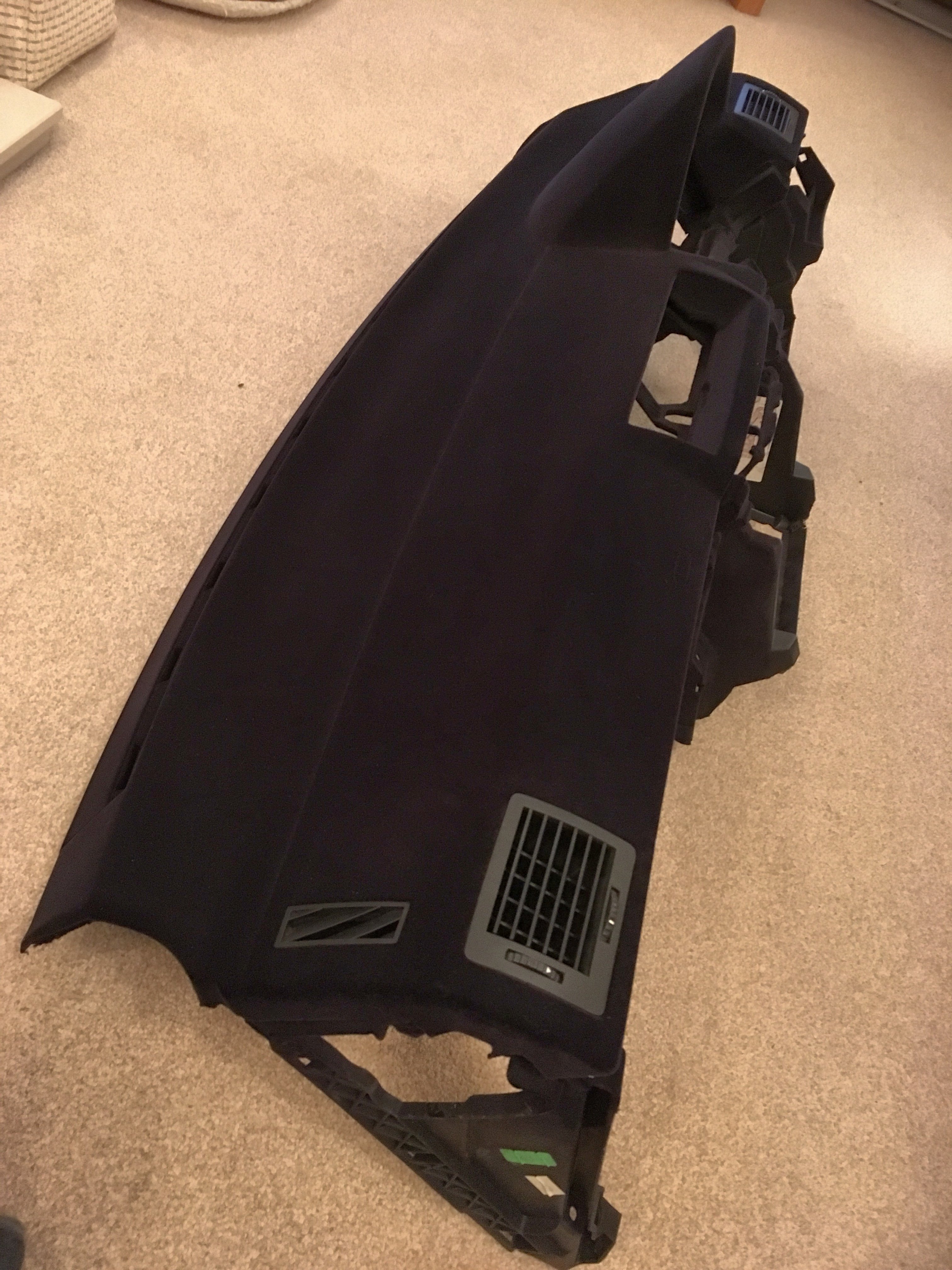

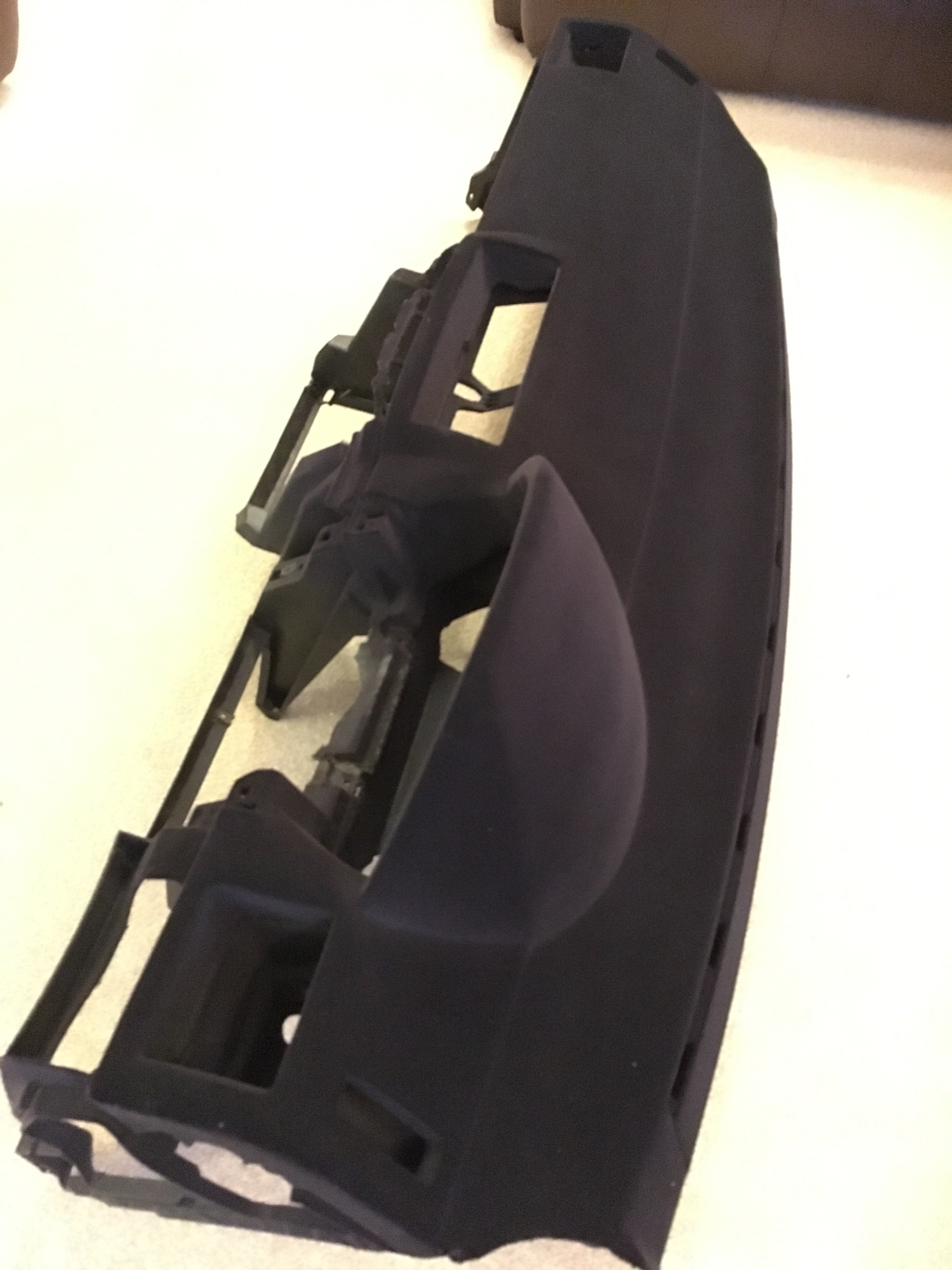

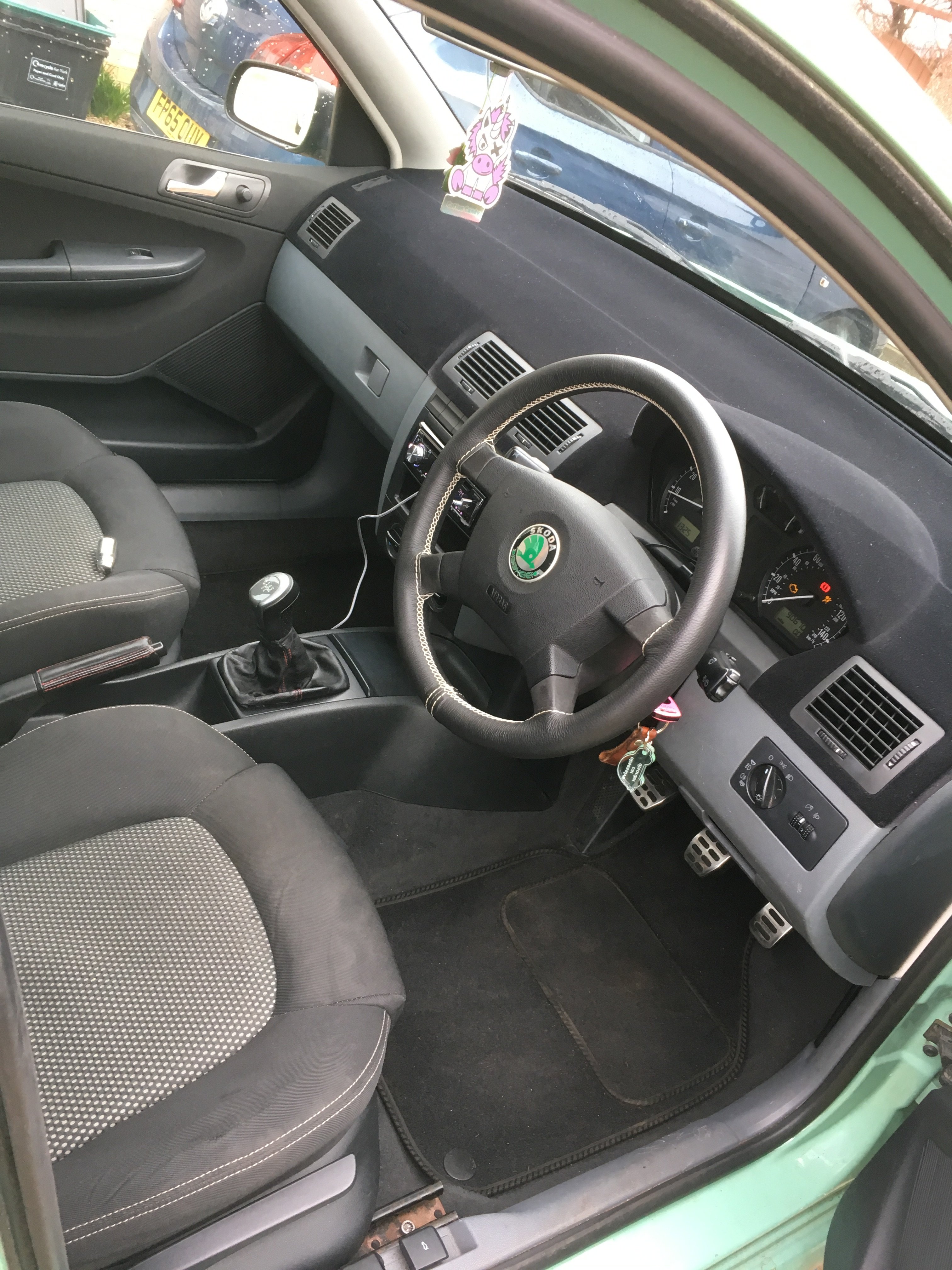

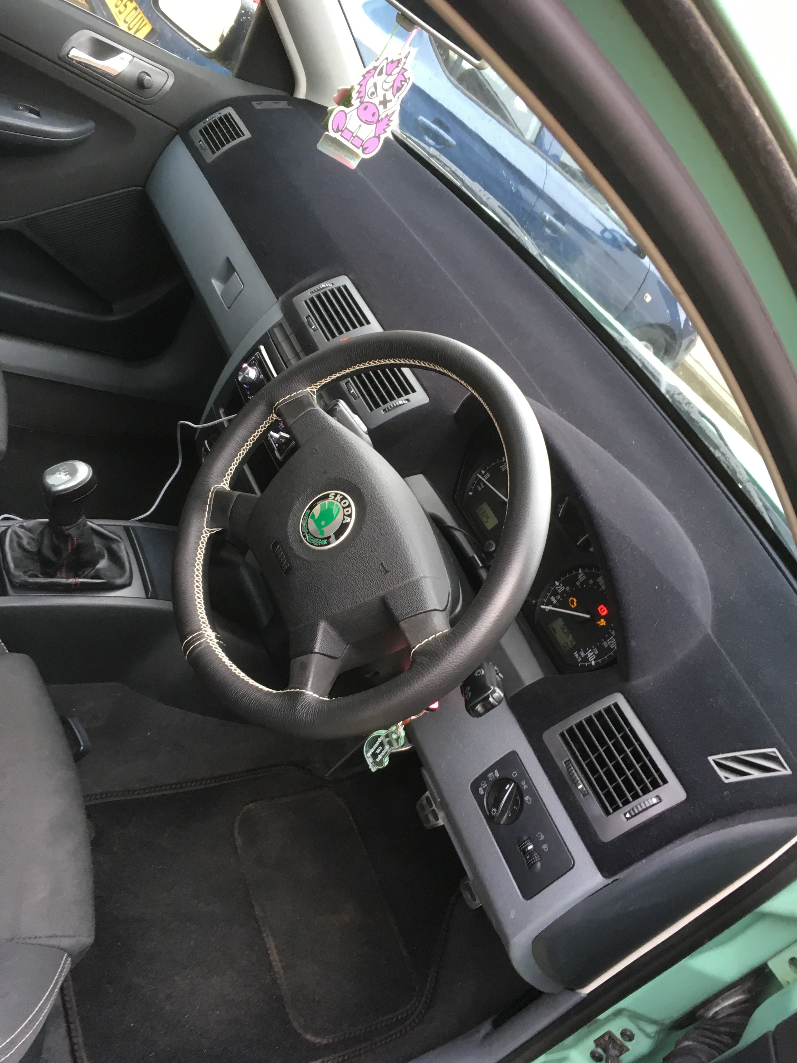

Dash is done, picking up Friday hopefully, used it today and did 60miles, all went well except the o/s cv joint appears to have shat itself as there’s cv grease everywhere. Strange it’s gone so quick, job for next week
Love the dash Trevor, you getting anything else flocked?
Cheers buddy, I’m really impressed with it tbh. And I Wasnt really planning any more on it but I’ll see how it goes with the grey bottom half of the dash, I’m hoping it will be a nice contrast otherwise I might have to source some black trims or get the bottom bits flocked too

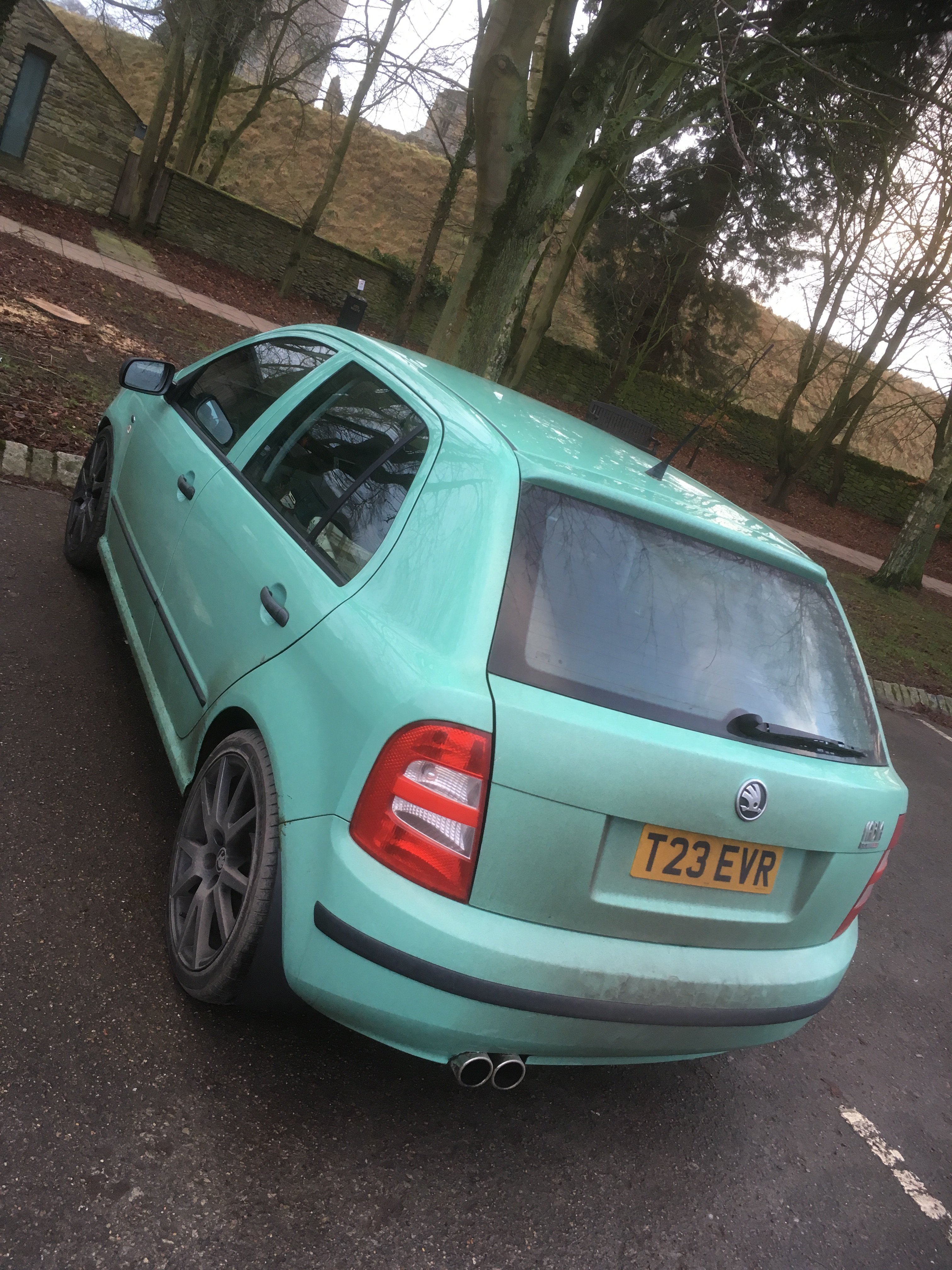

Great project Trev!! Glad to see you back in a Fabia and with a great engine now to boot!
I did miss my Fabias :)

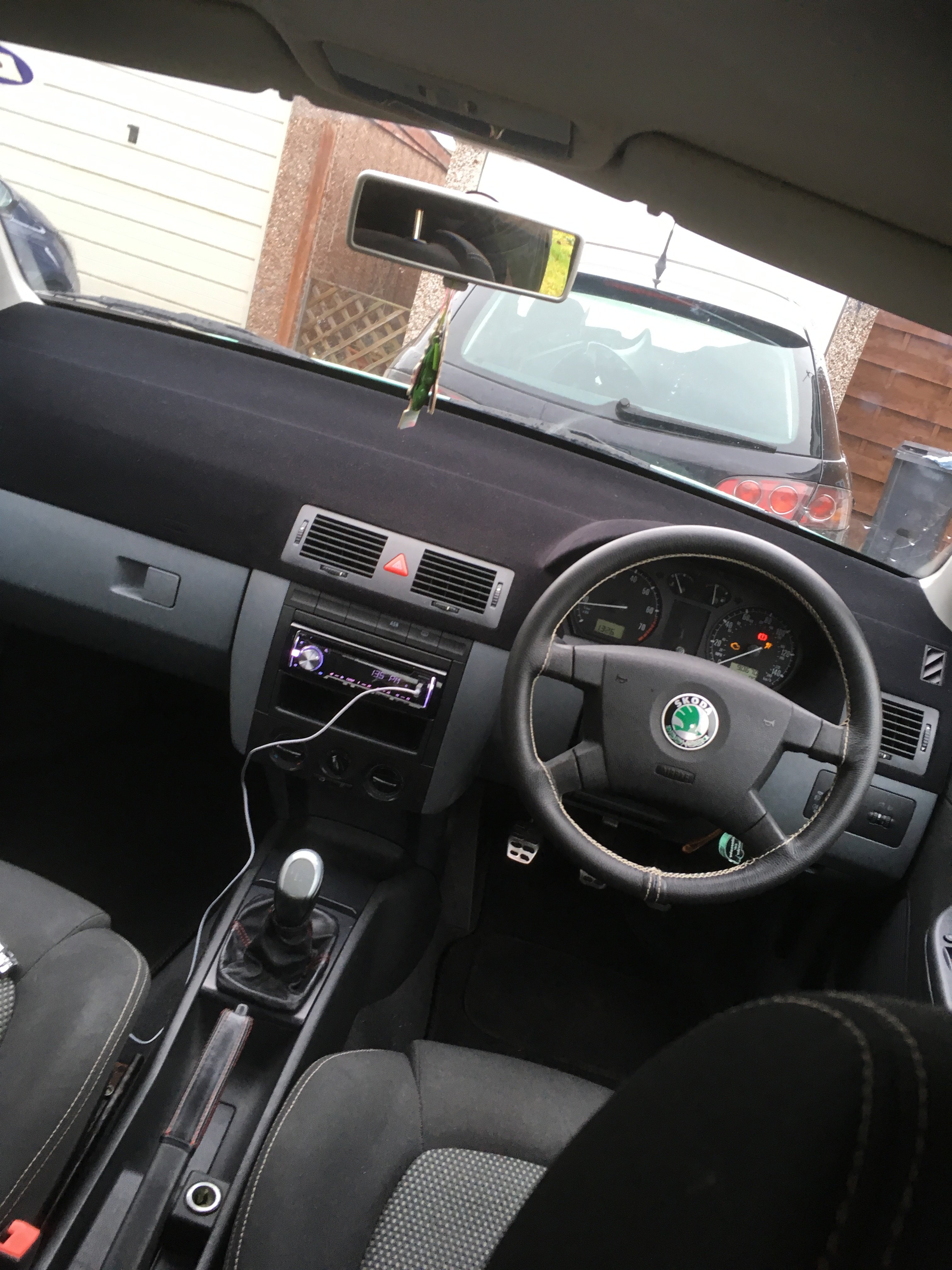

I reckon the dash colours work, what do you make of it @TrevorB33?
Looking good pal, can't wait to get mine over to him now lol
did you fit the leather cover on the steering wheel - looks a neat job - was it an ebay special?
I think it kinda goes, I may swap it all out for black but I’m in no rush
Previous owner stitched it on, it’s a good job tbh and looks decent in person too, she said it took hours to stitch which is believable. I definitely wouldn’t have had the patience lol
Indeed mate I couldn’t wait to collect it, i May or may not stroke it while I’m driving :rofl:

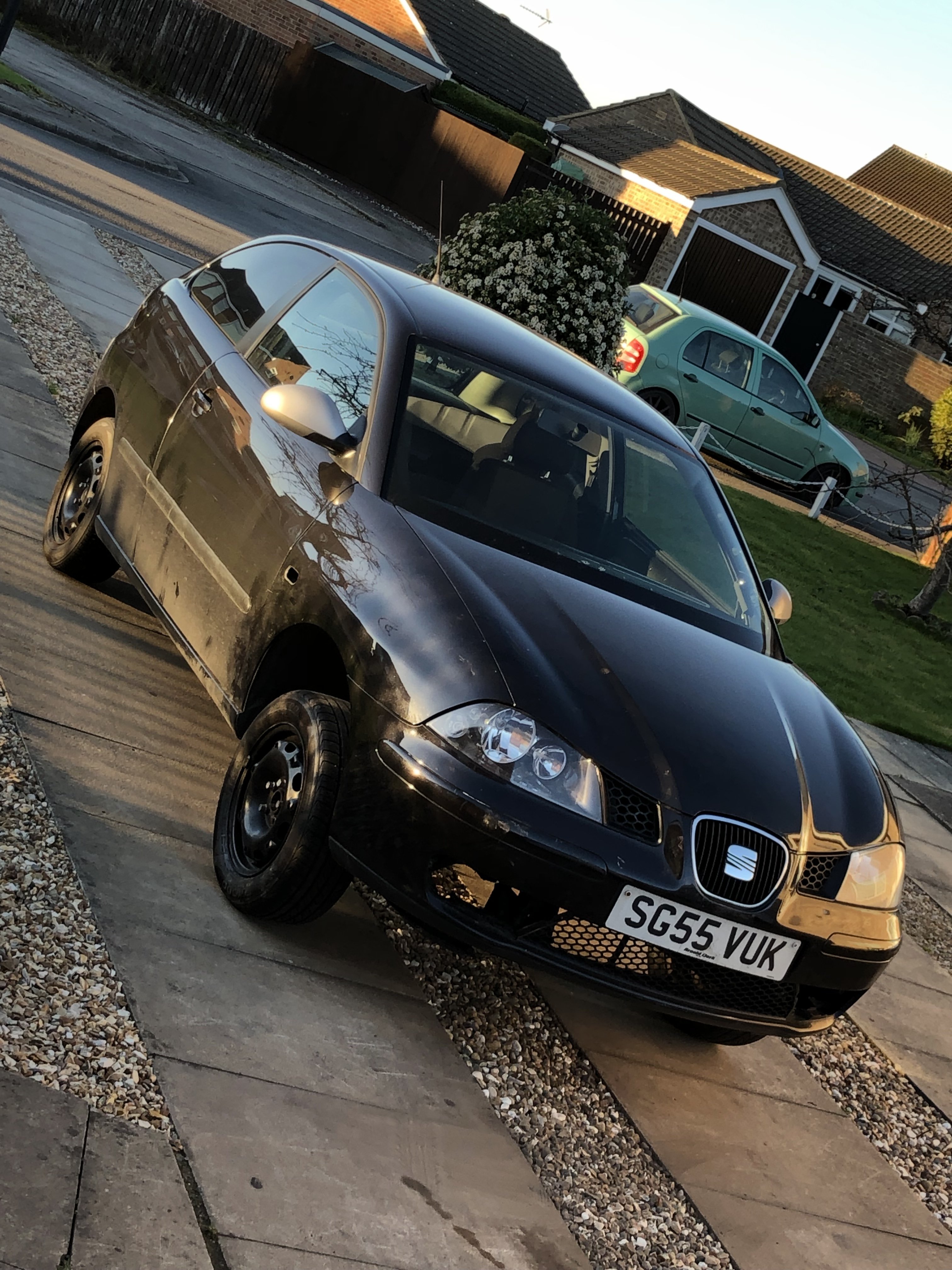

Update time: now one of my other cars has gone I’m able to use the fabia again, mot is due and it needs a couple of headlights and the remap tweaking to cater for the various deletes, but I’m confident it’ll fly through once there sorted. So time to sort some insurance, and then look at getting the bodywork sorted once’s she’s on the road again :)

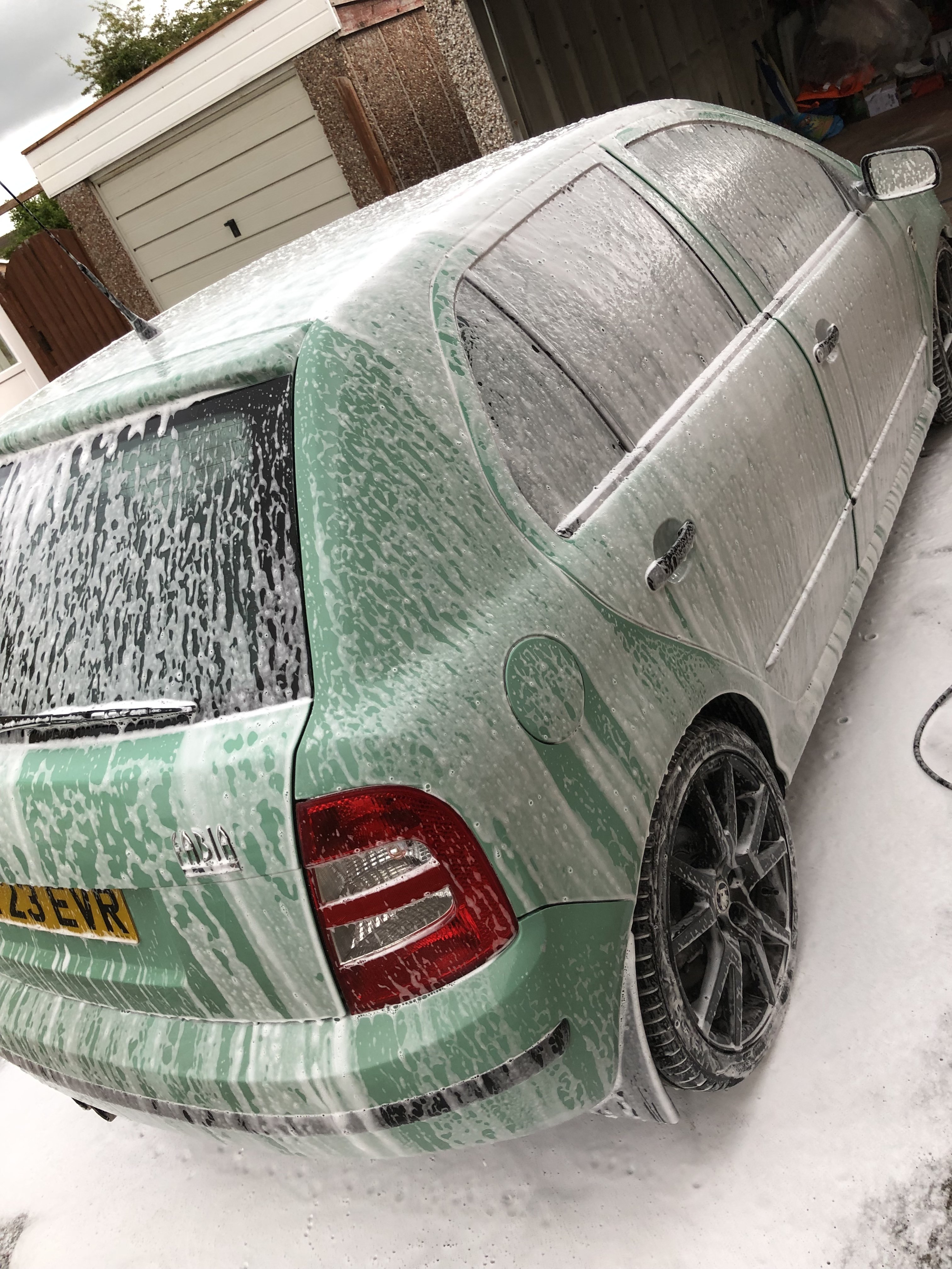

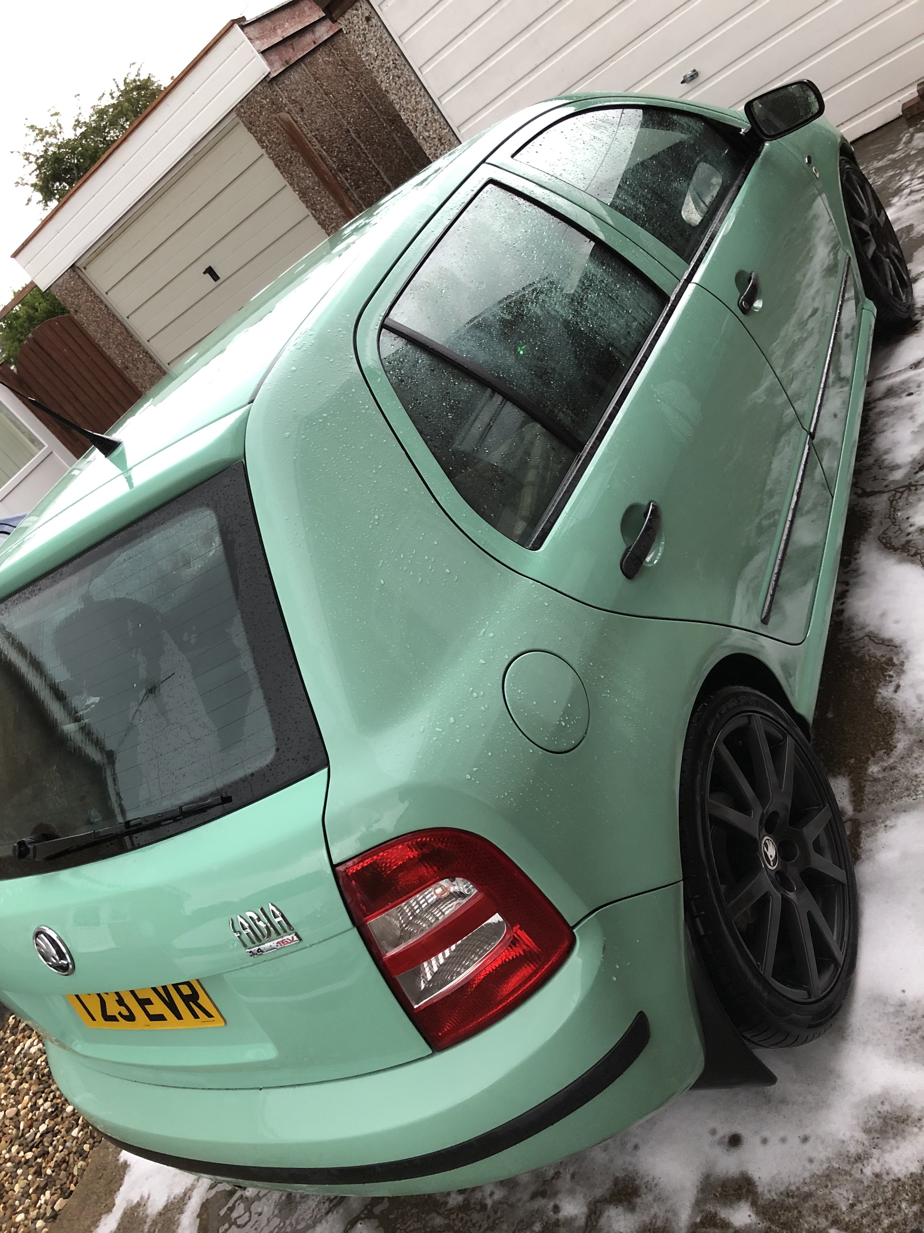

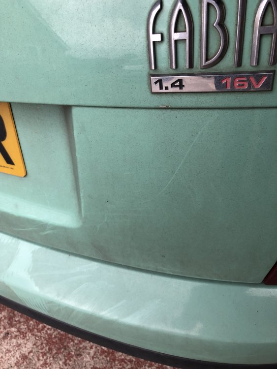

First wash ever since I’ve had her 😂, so many little dints and scratches I should have left it dirty ha. Now it’s raining.
