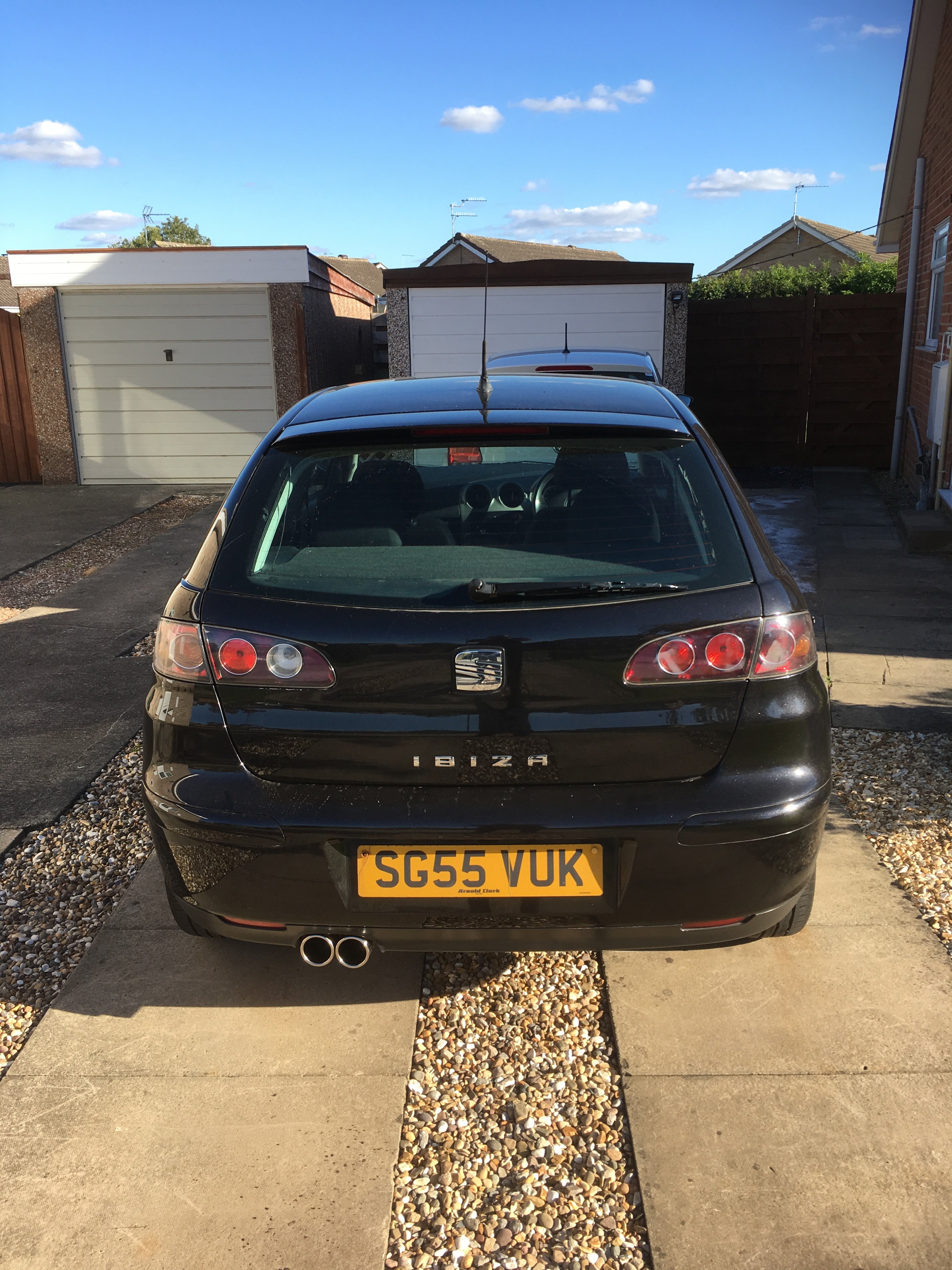

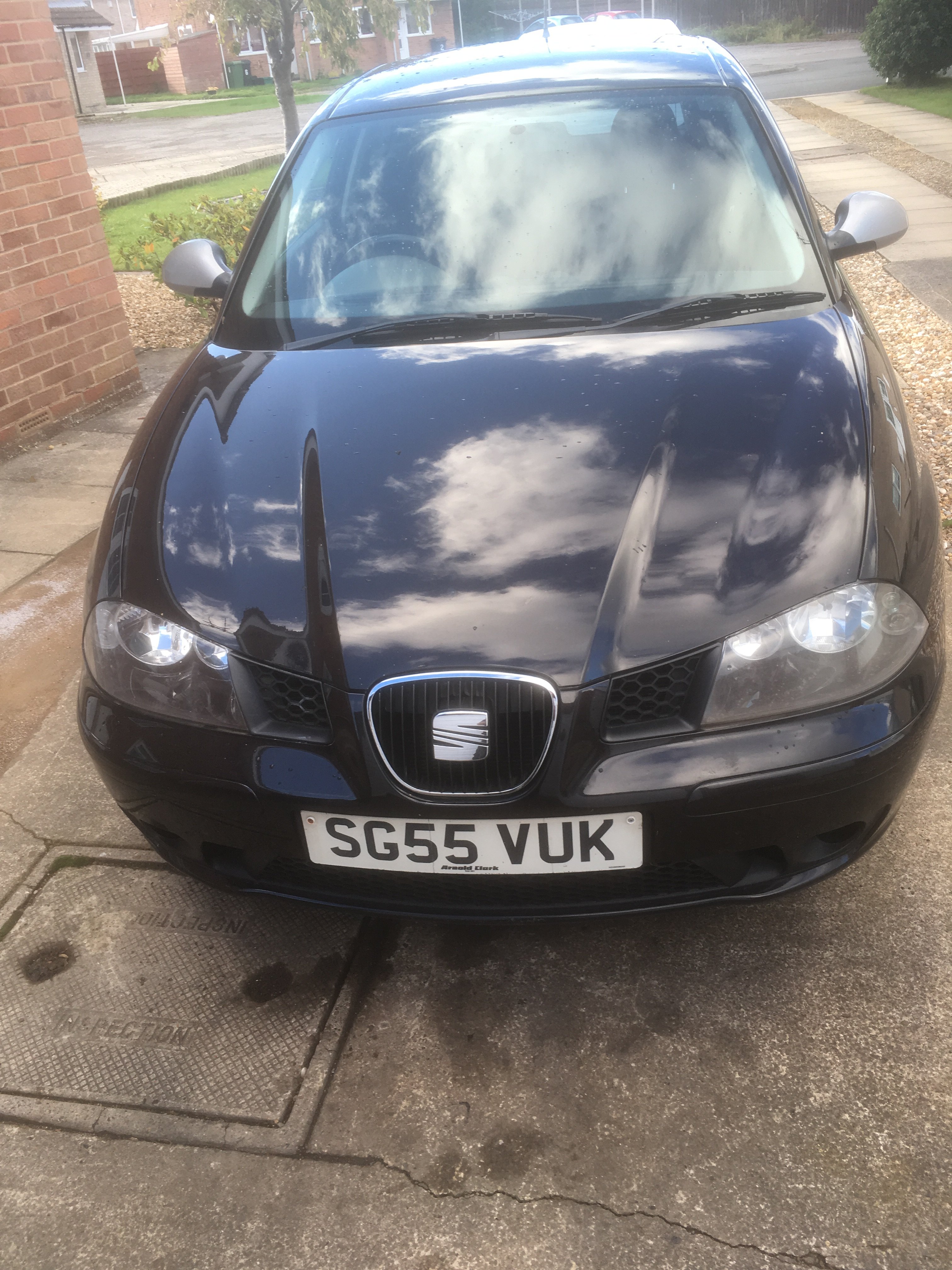

Picked up this yesterday as I’ve been dying to build another Fabia 1.8t after I stupidly sold my fantasy green one a couple of years back, plans are to run this round over winter getting all the little engine bits done and tidied up ready for transplant into another Fabia in the new year. This way I can wait for the perfect Fabia to come up.
specs are at the minute
Green induction kit
Piper 2.5” cat back one silencer
powerflex console bushes
st lowered shocks and springs 30mm,

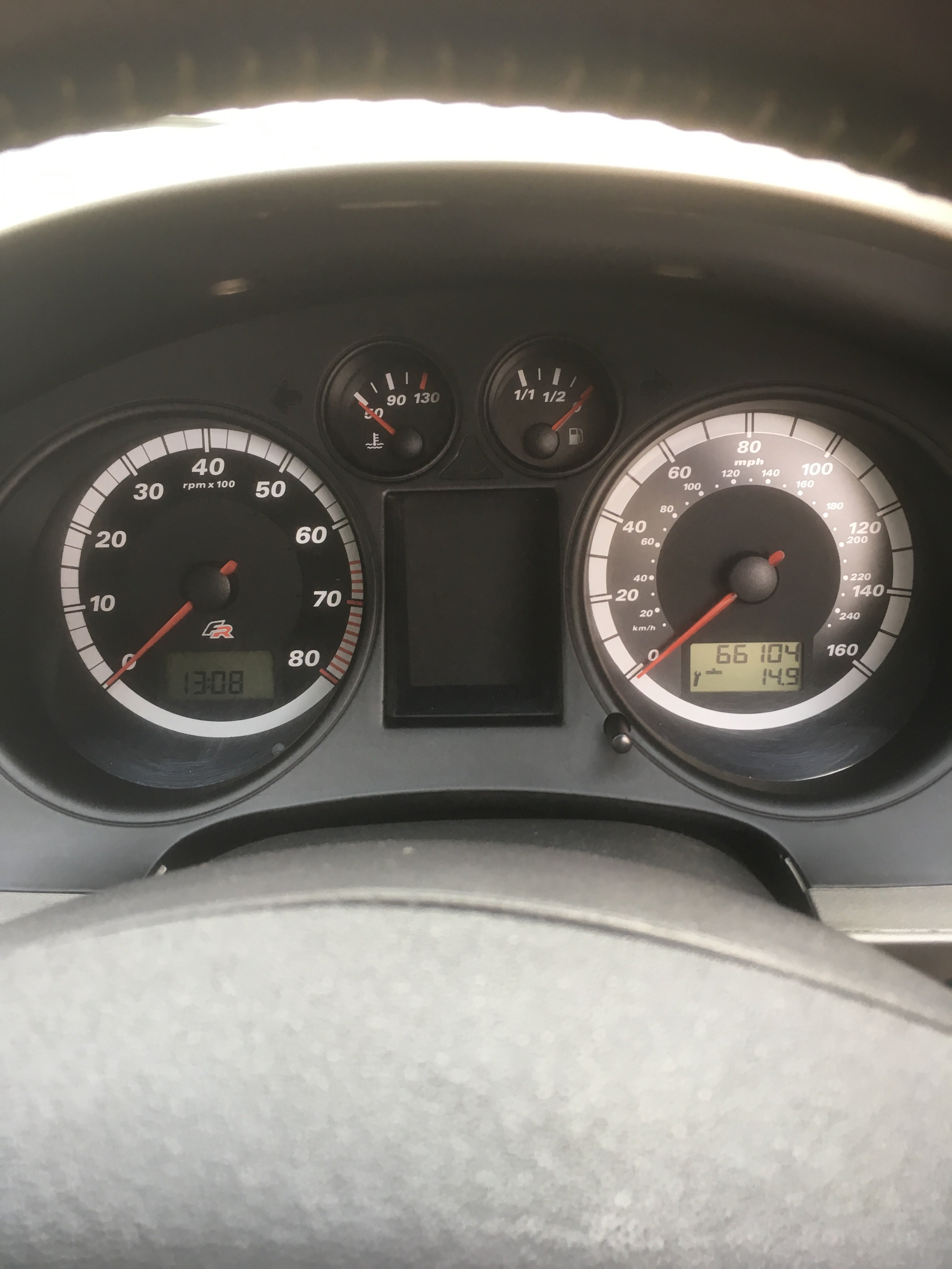

had a new starter motor/battery and alternator in the last year and very low mileage at 66k Cambelt done at 55k
excuse the chavness at the minute as it’s how it came lol

  • Couple of hundred miles in now  did a scrap run this morning too so had her on a weight bridge 1220kg with 1/2tank fuel
  • Finally wired in the speedo, was actually quite straight forward as I’d already had the PIN number and connector I needed to wire it into, used a octy mk1 vrs speedo drive Cheers Ross for that info in

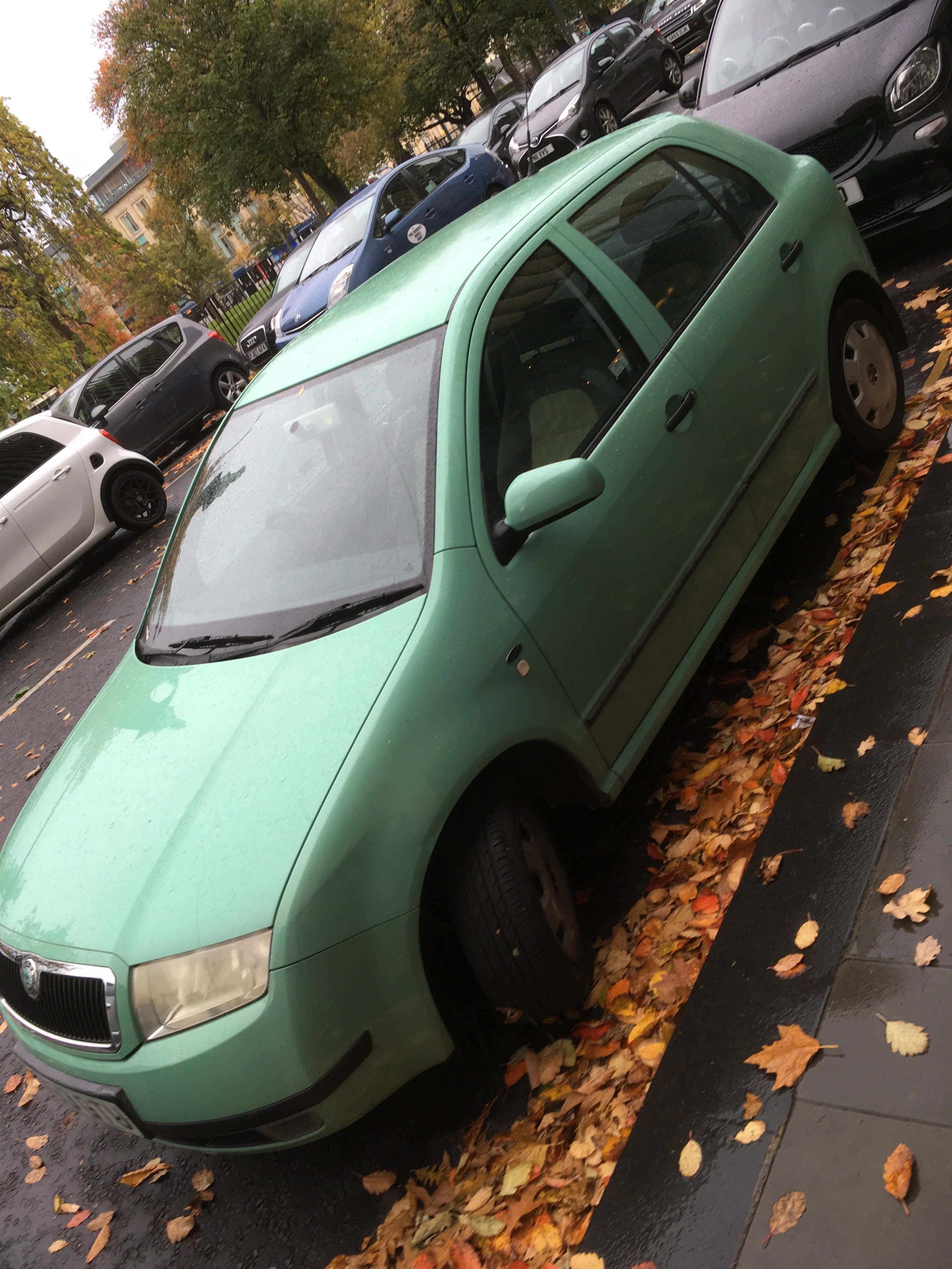

Good luck with the build mate. I only feel a little bad that you sold the green one to me :D
Fantasy green mk2 haha
Fabia has been done. 1.8t Roomster......B)
Cash waiting :rofl:

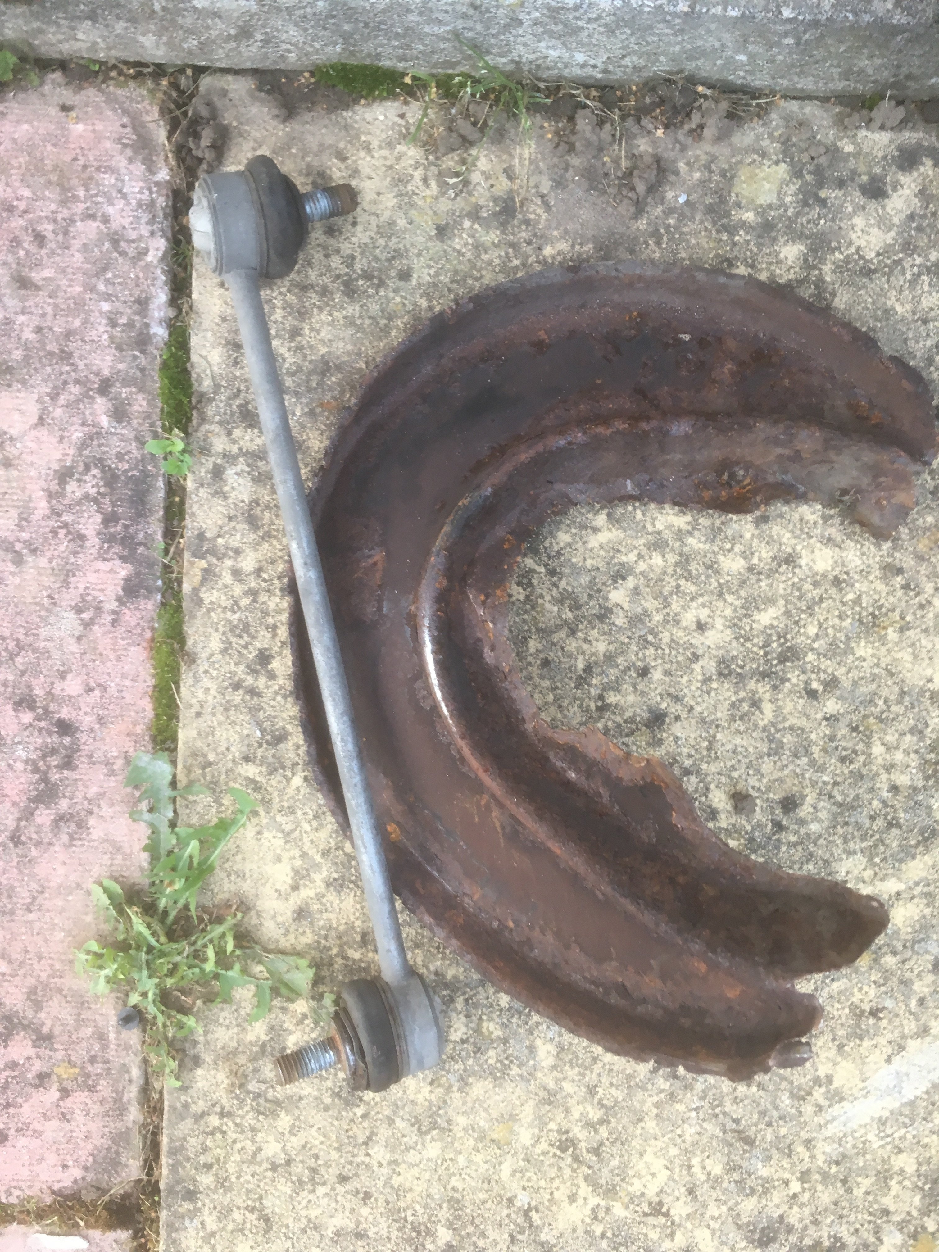

First port of call was sort a couple of noises from suspension, o/f droplink was knackered and found a rear disc backing plate was about to fall off so pulled it off. Changed droplink yesterday, all good no more untoward noises. Handles really well with the ST suspension kit.

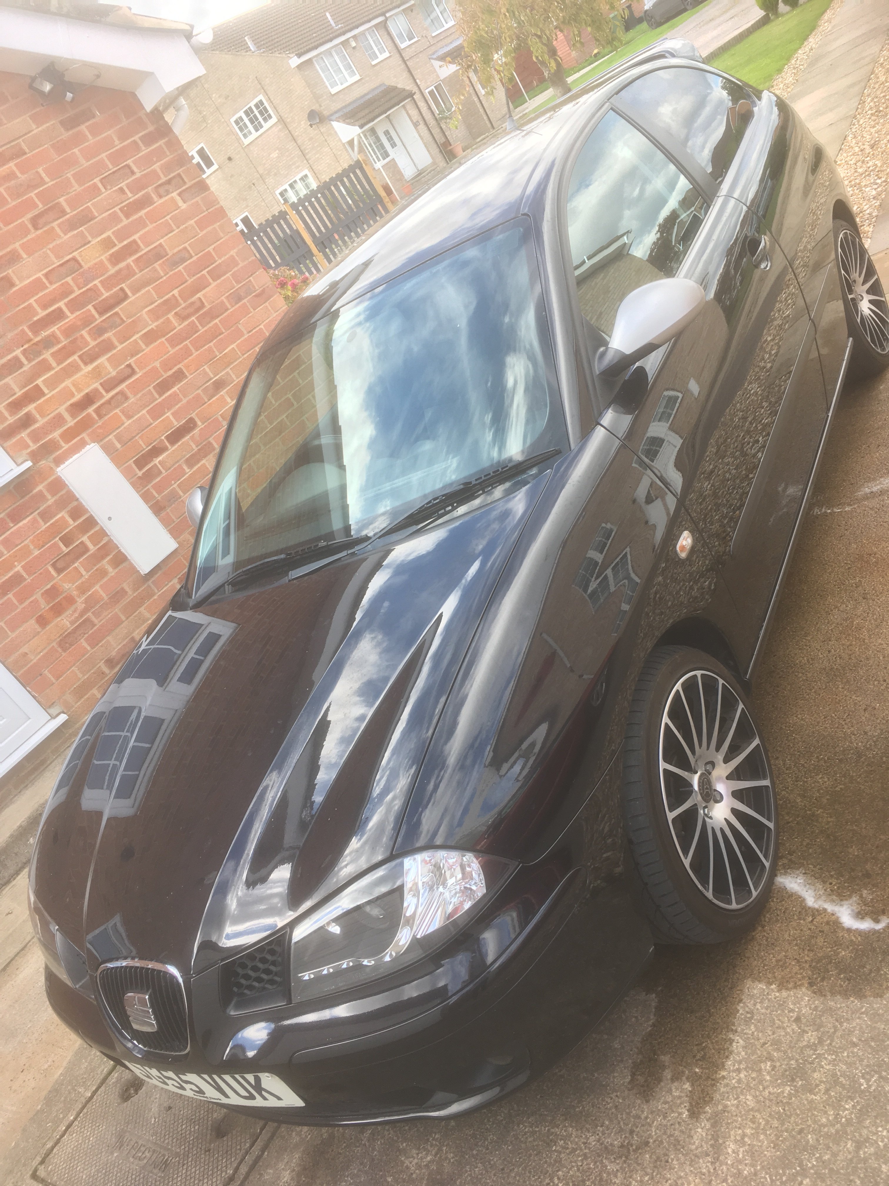

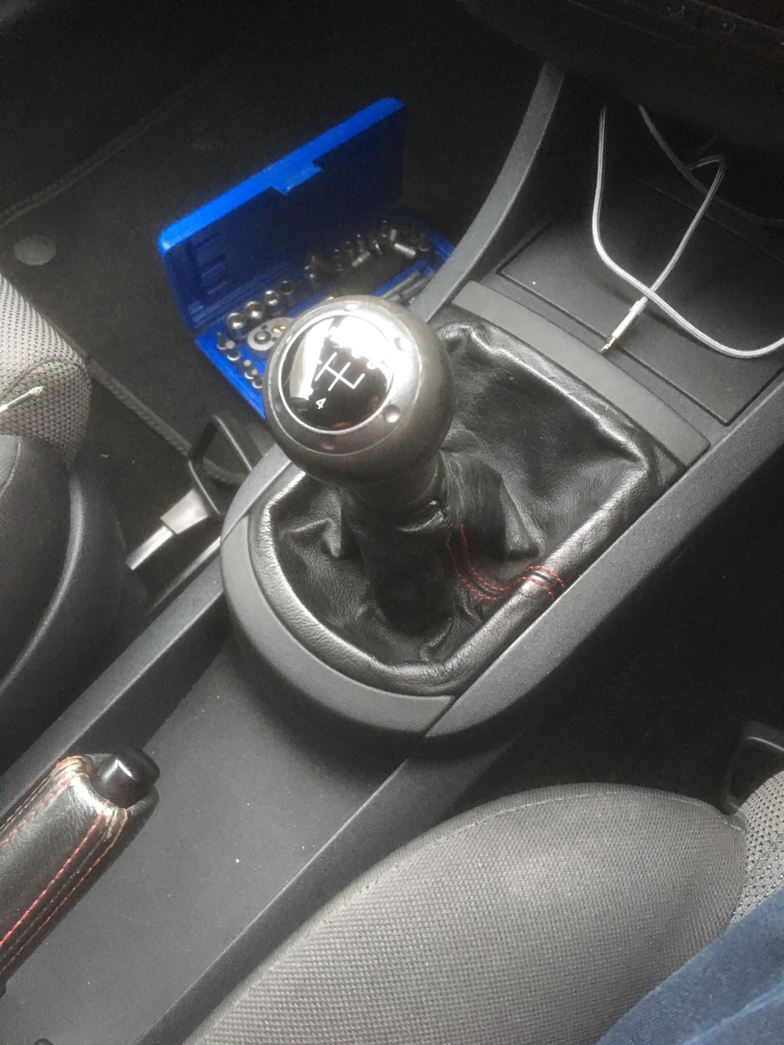

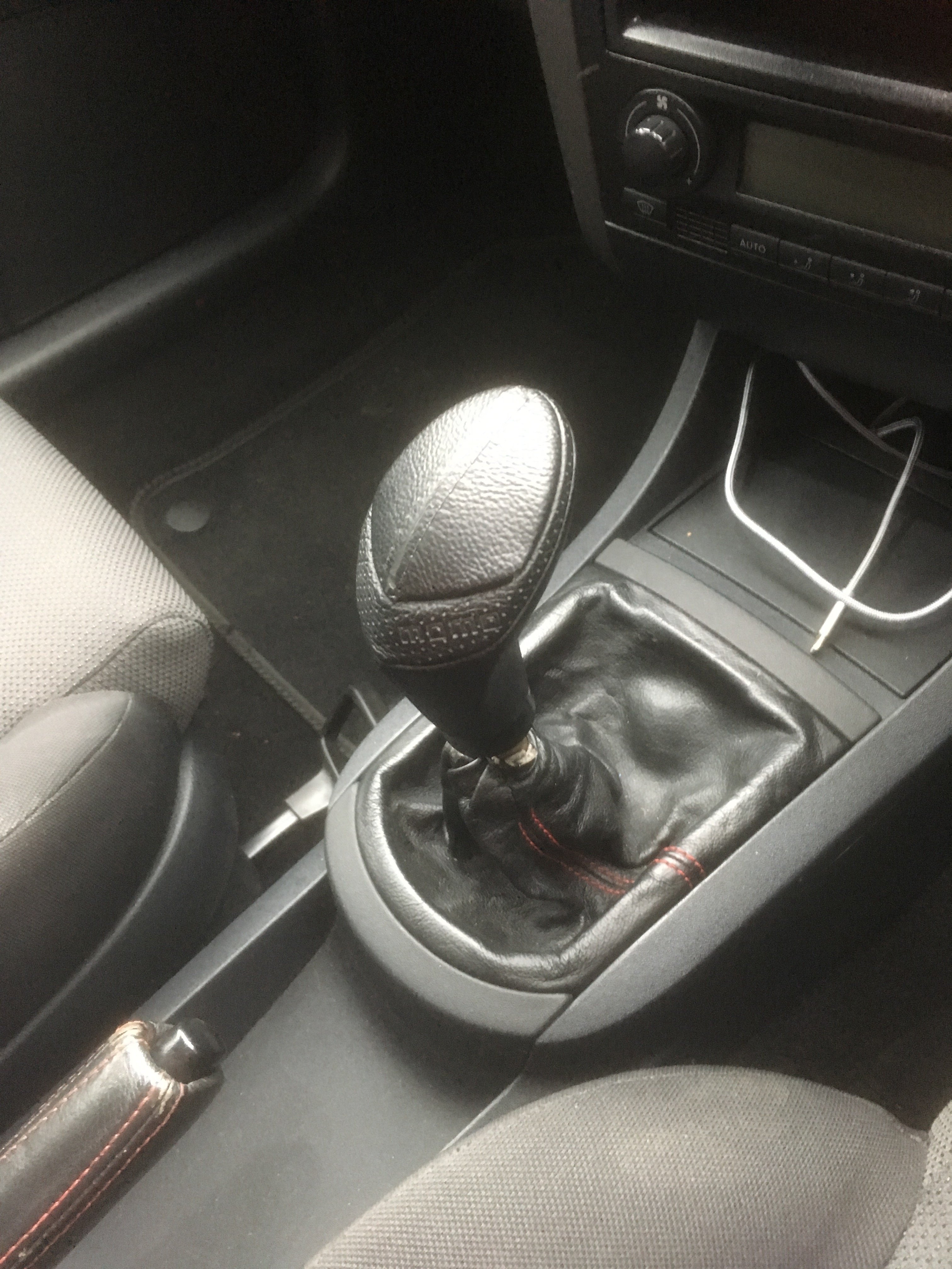

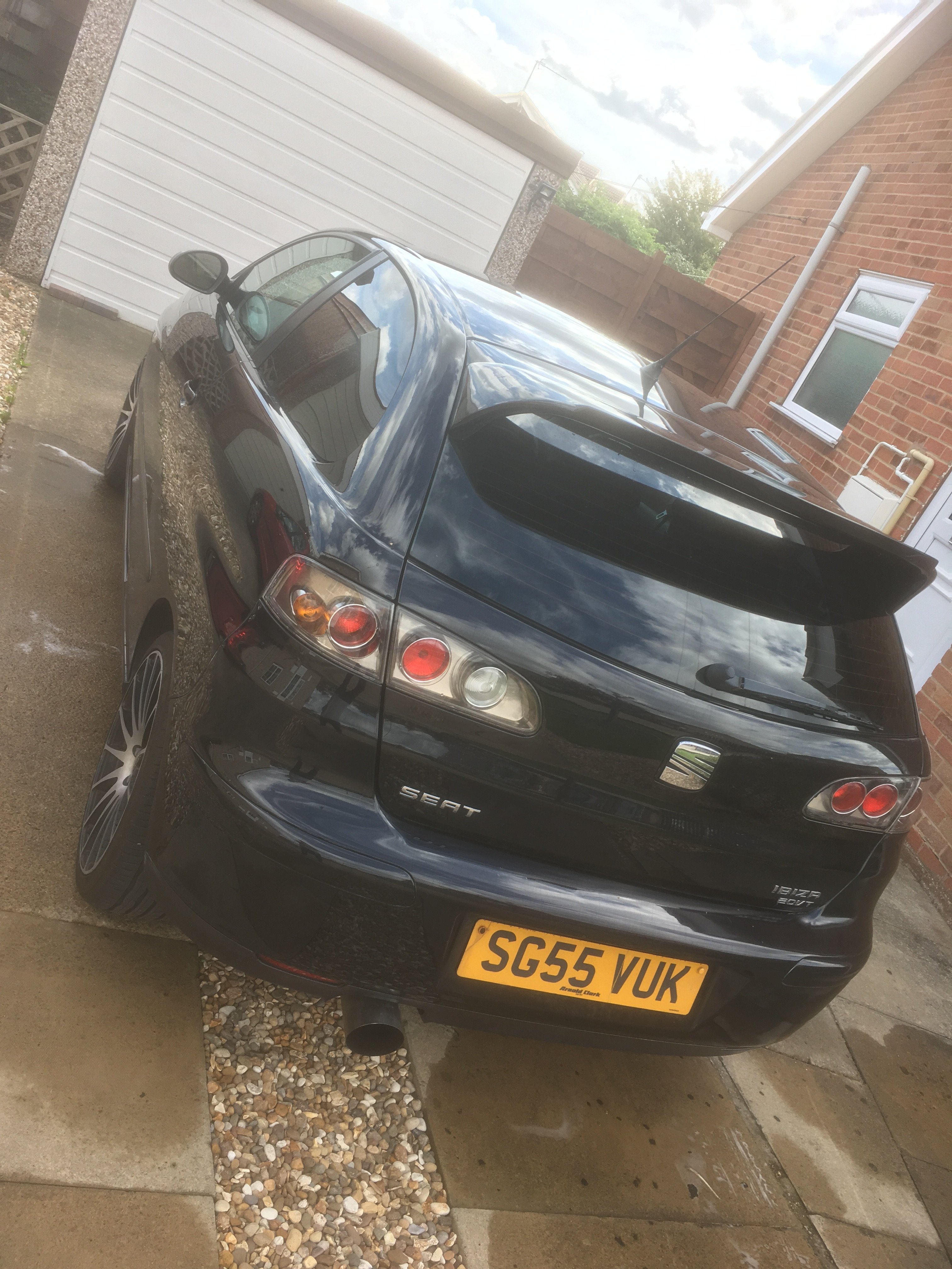

Managed to get a bootlid, headlights and a standard gear knob to get rid of the hideous momo thing all from my local scrappy :), should have a go fitting stuff at weekend if weather gets better. Picking up some alloys sat, and she should be looking fully dechaved. Fitted the knob at least

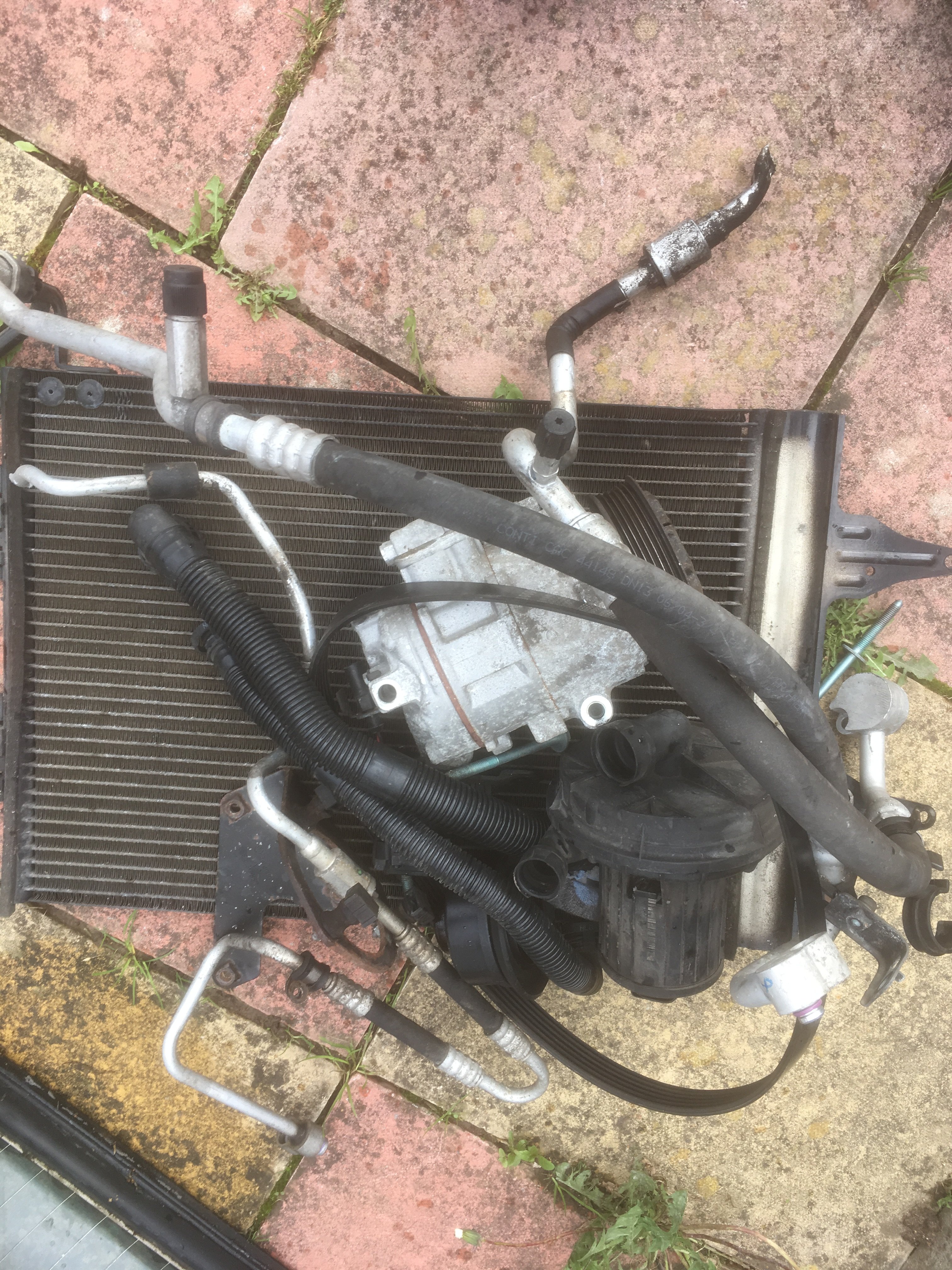

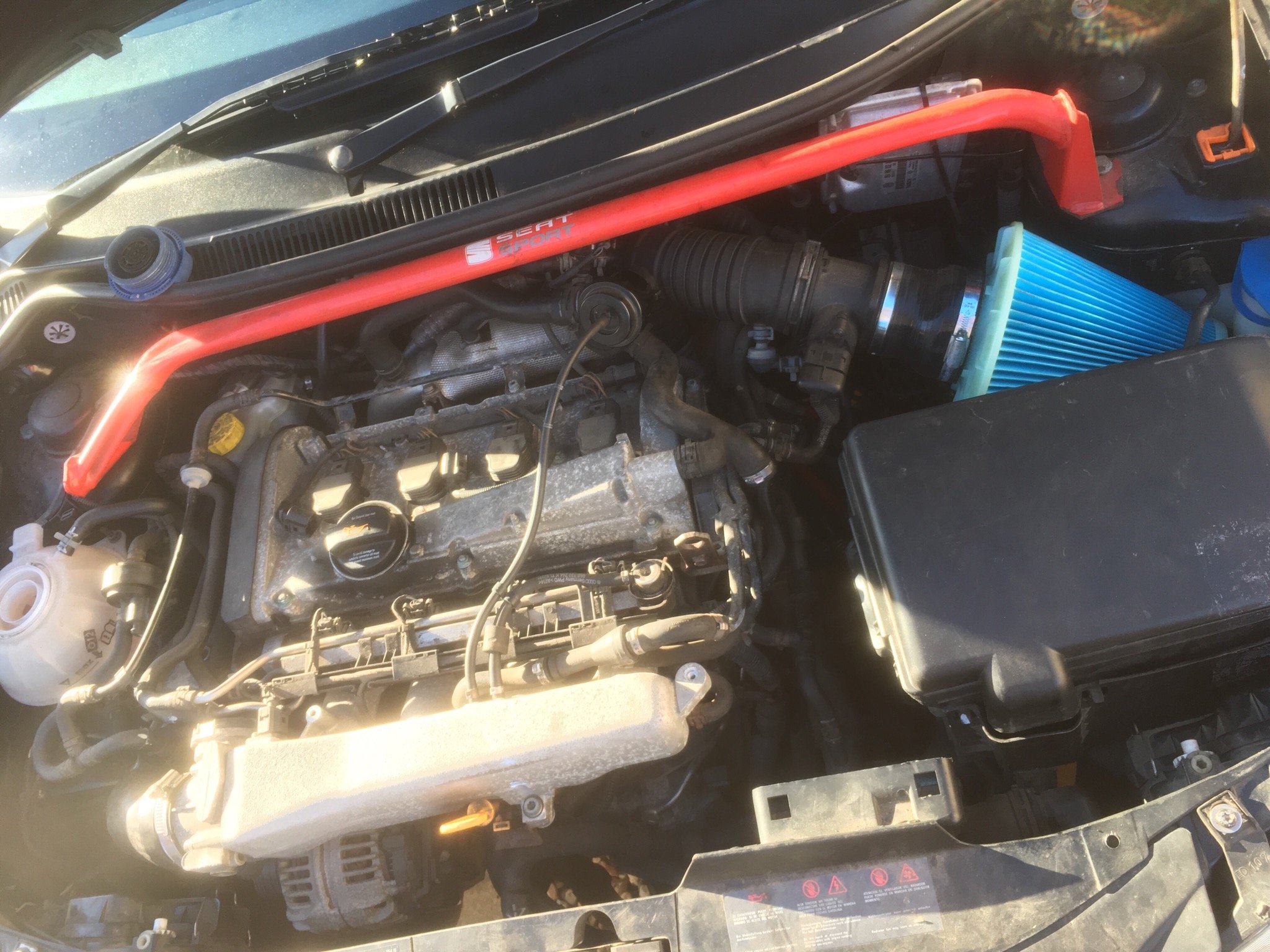

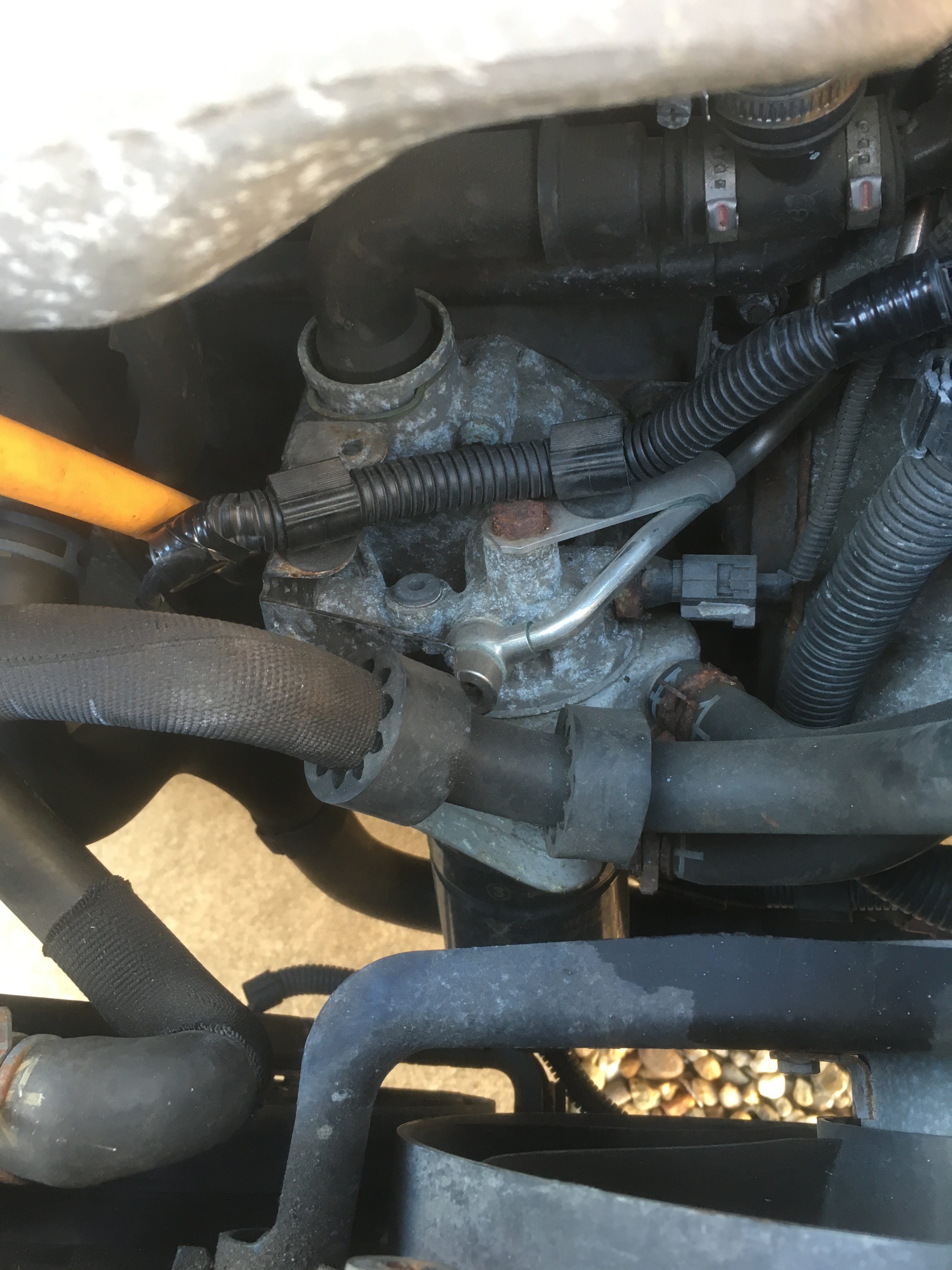

Started binning some bits off today, and changed the headlights while I was at it.

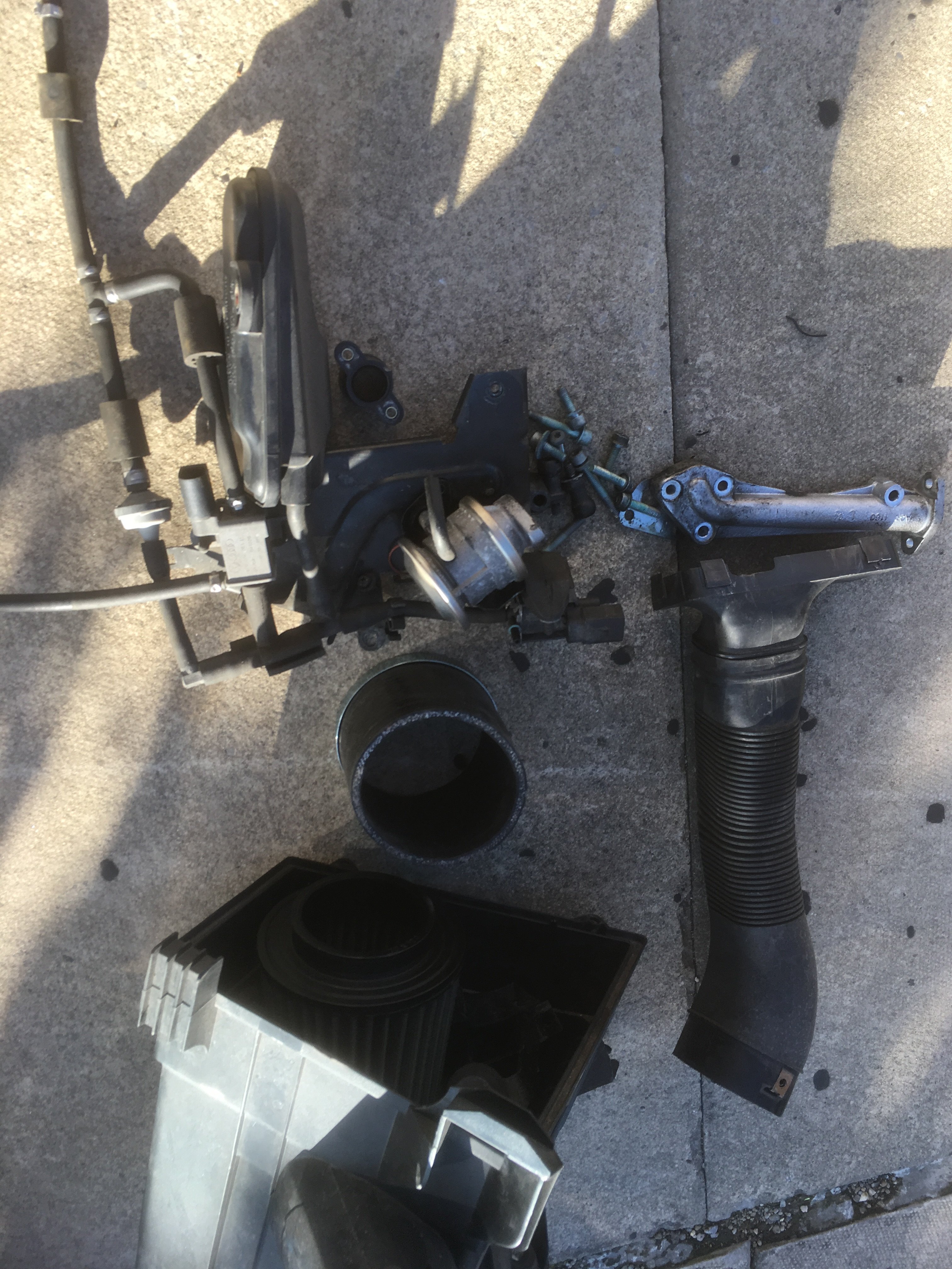

Air con compressor and rad out, secondary air pump and bracket and abit of pipe,  all the easy stuff to get to with front off
All back together between rain storms, much better with standard lights

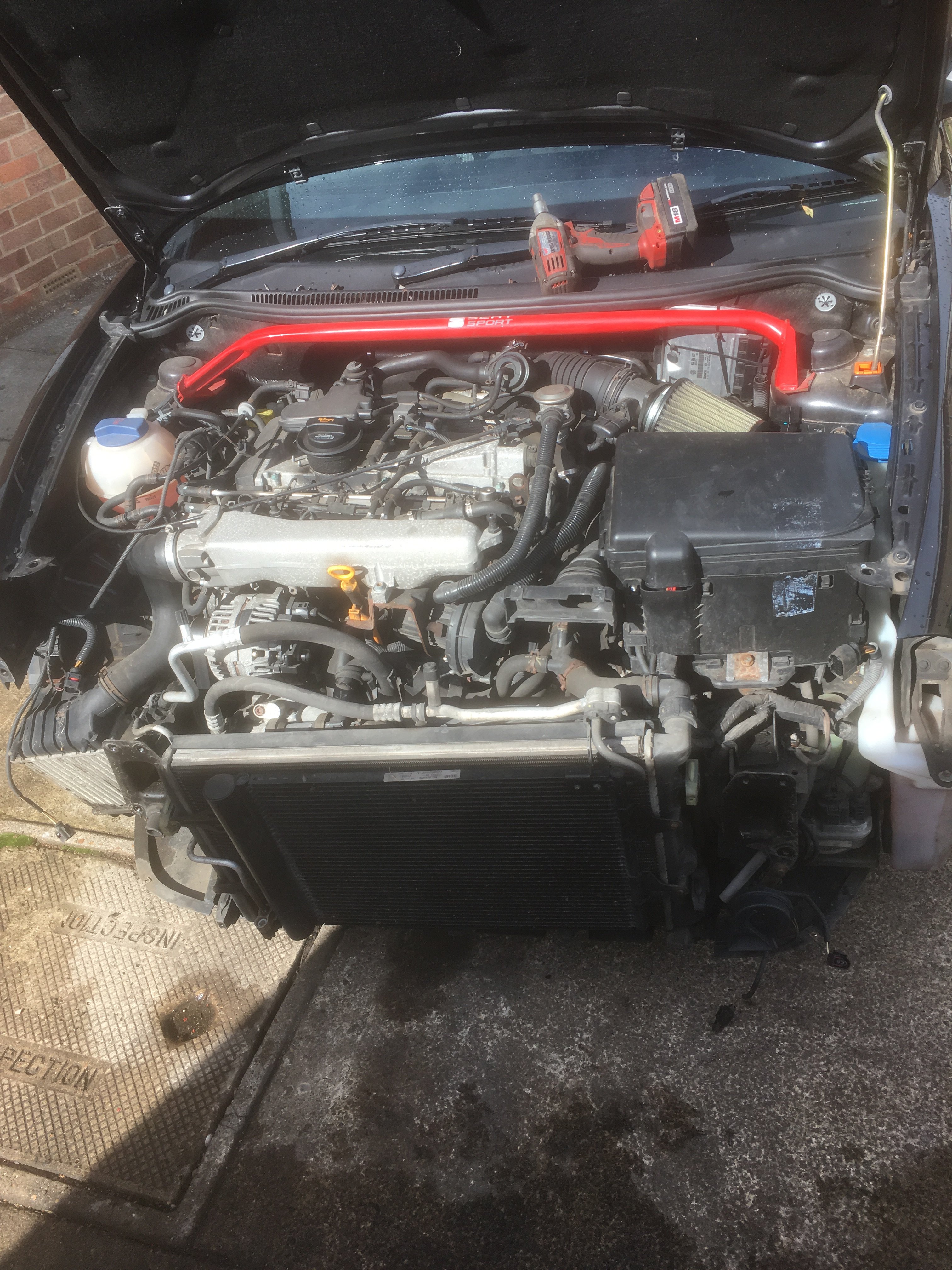

N249/n112 removed and took the combi valve off for Sai, and blanked off, much better. Just connectors to dead end and tidy up wiring.
before in first pic, also fitted a s2000 filter I had laying around
Edited by TrevorB33

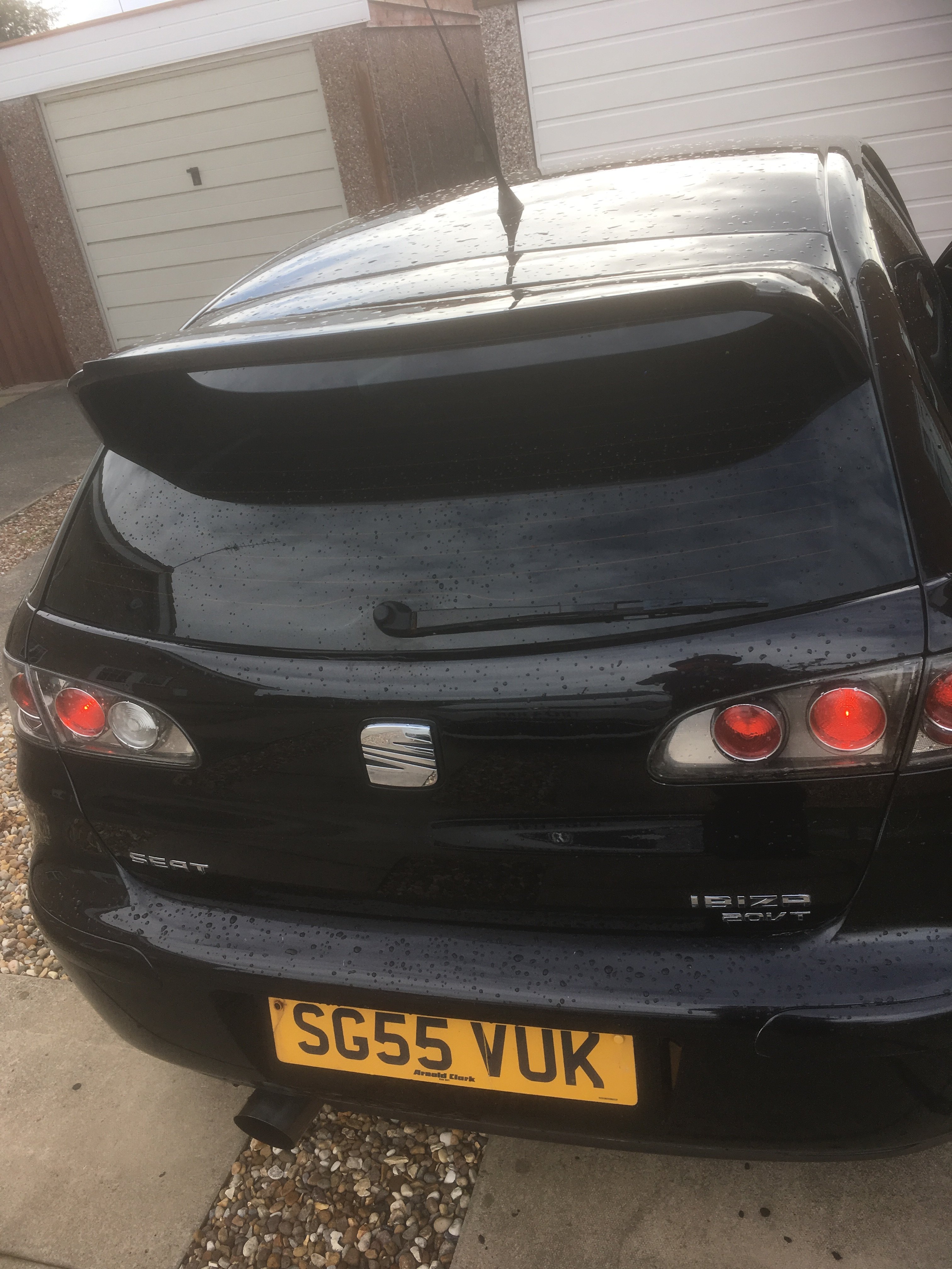

Fitted a facelift bootlid so I can bin off the spoiler, prefer the dark red lights over the Lexus style of the fr, so I’ll grab the matching ones on next visit to the scrappy

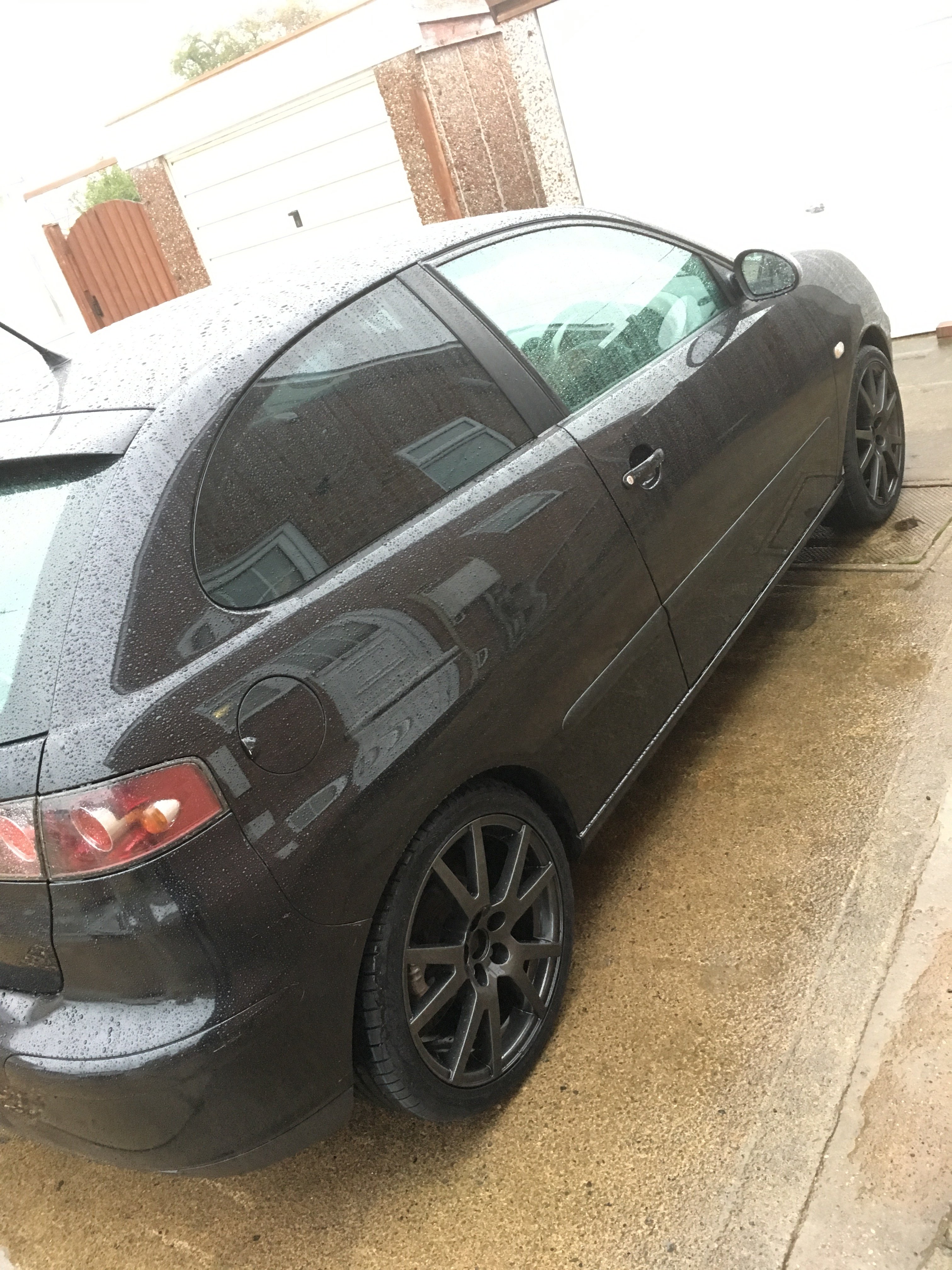

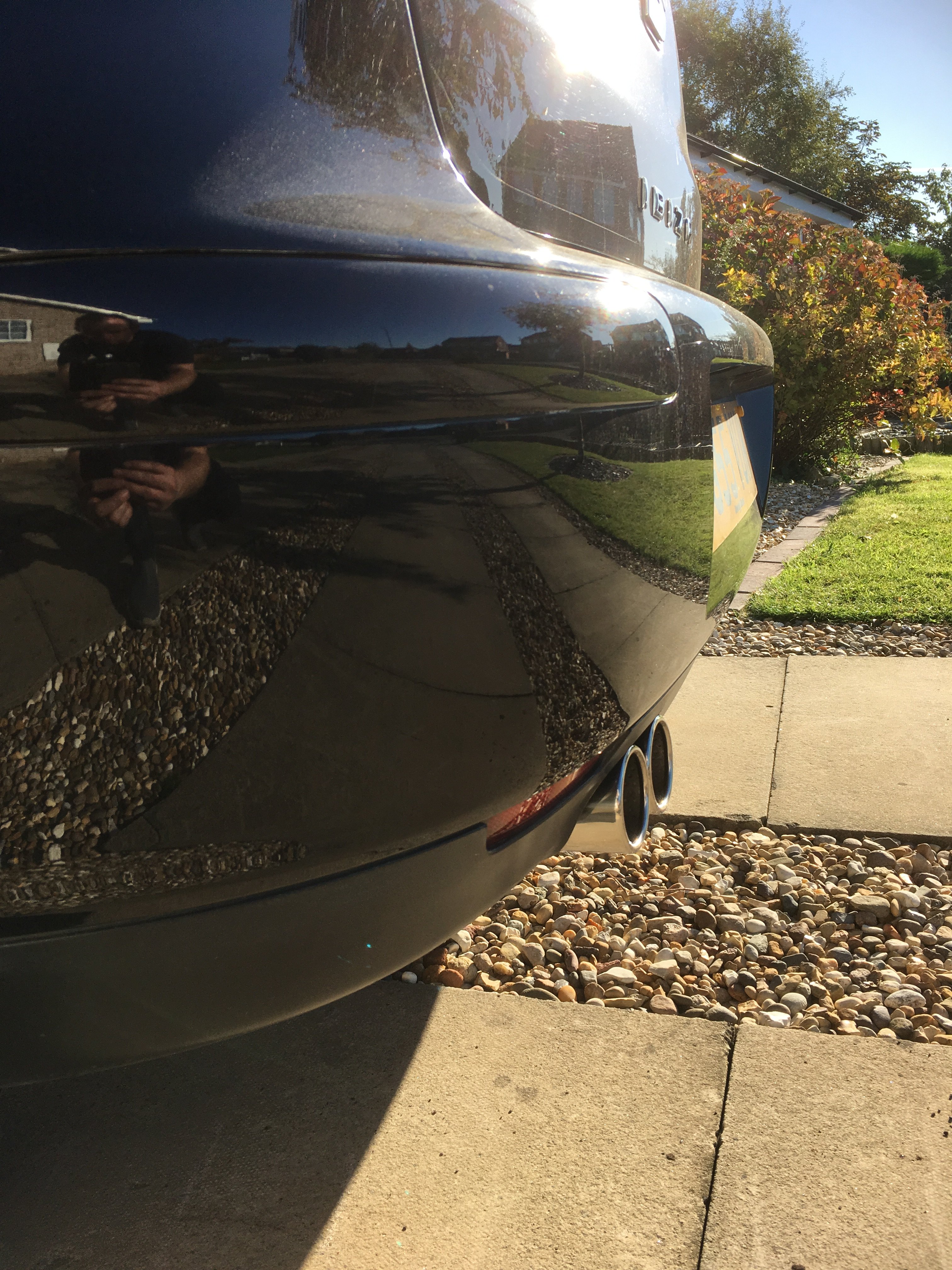

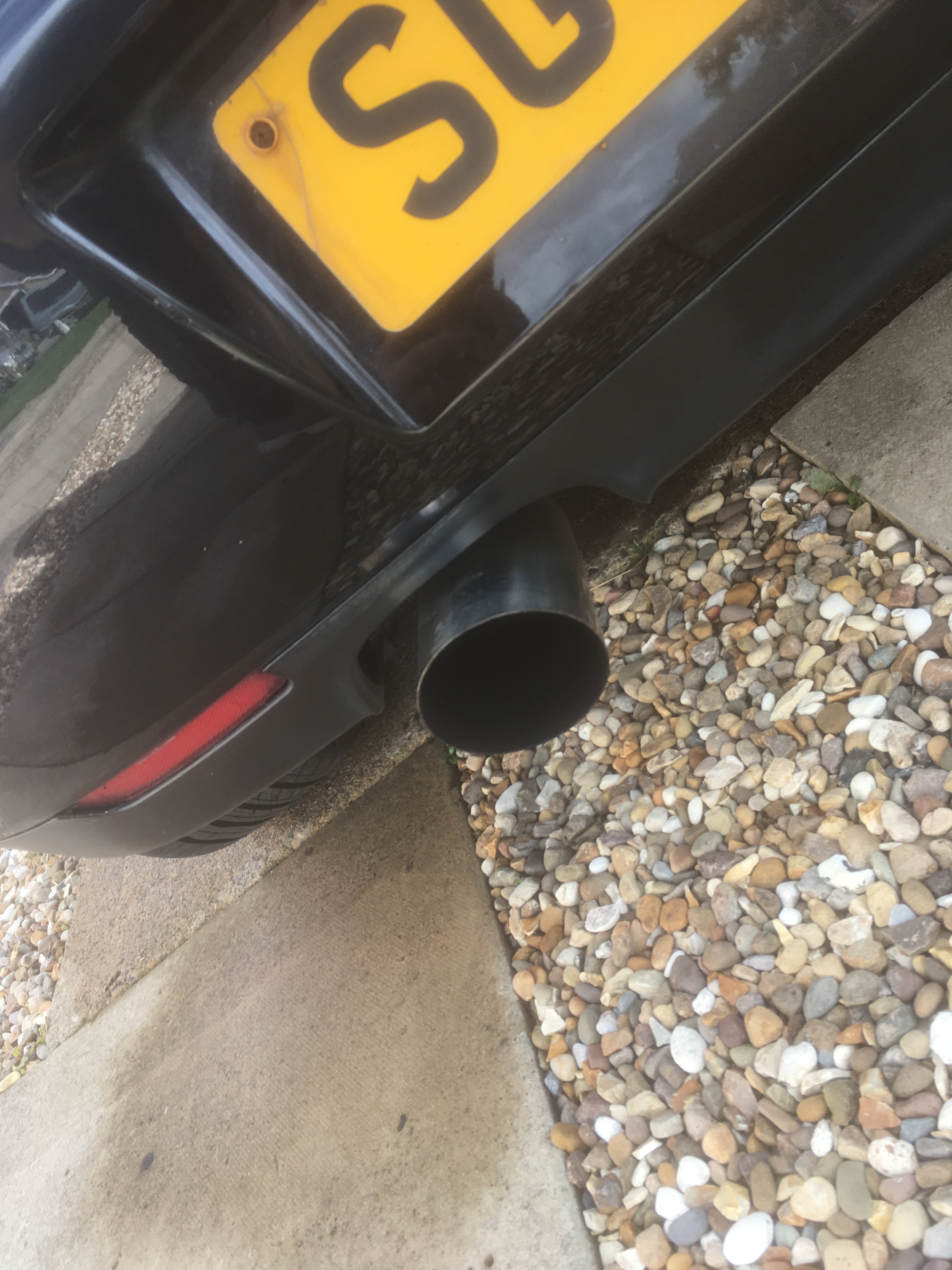

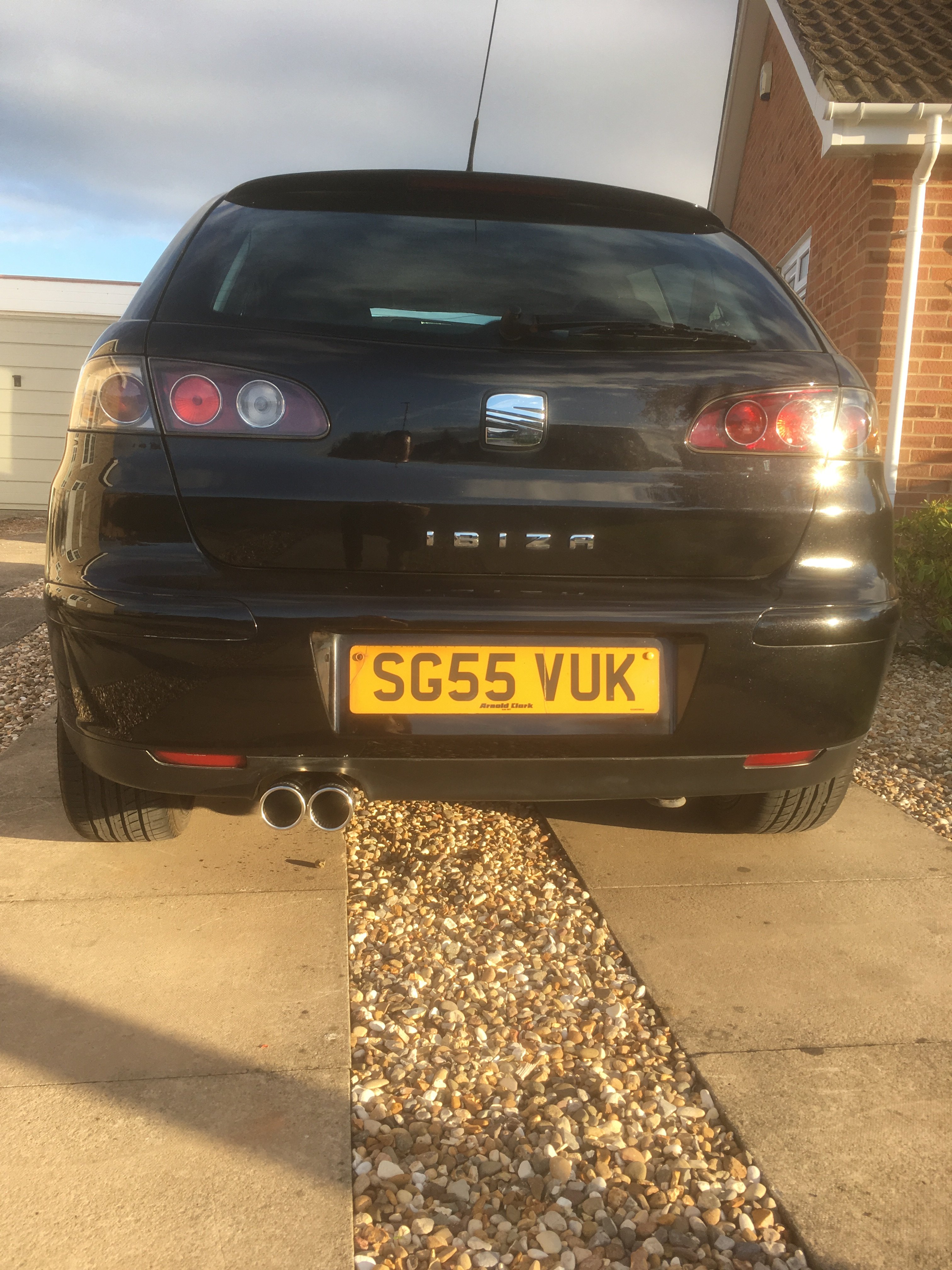

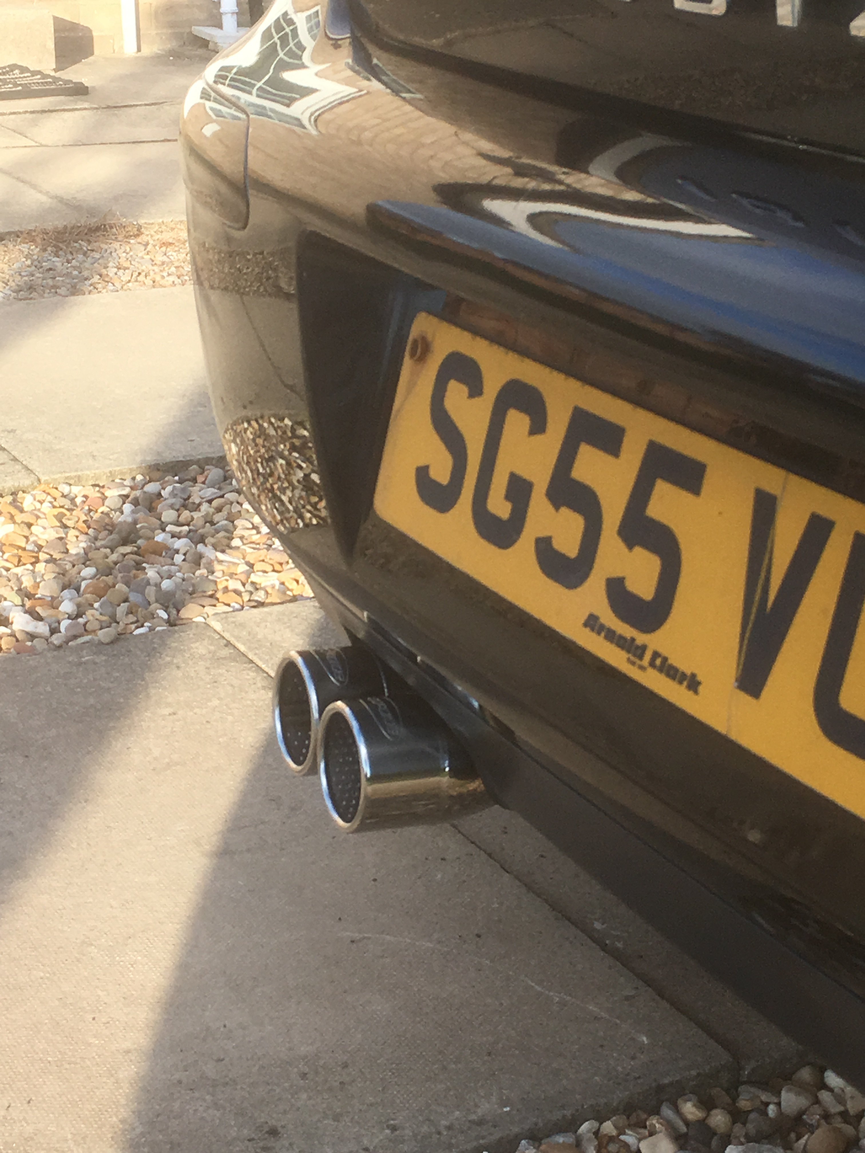

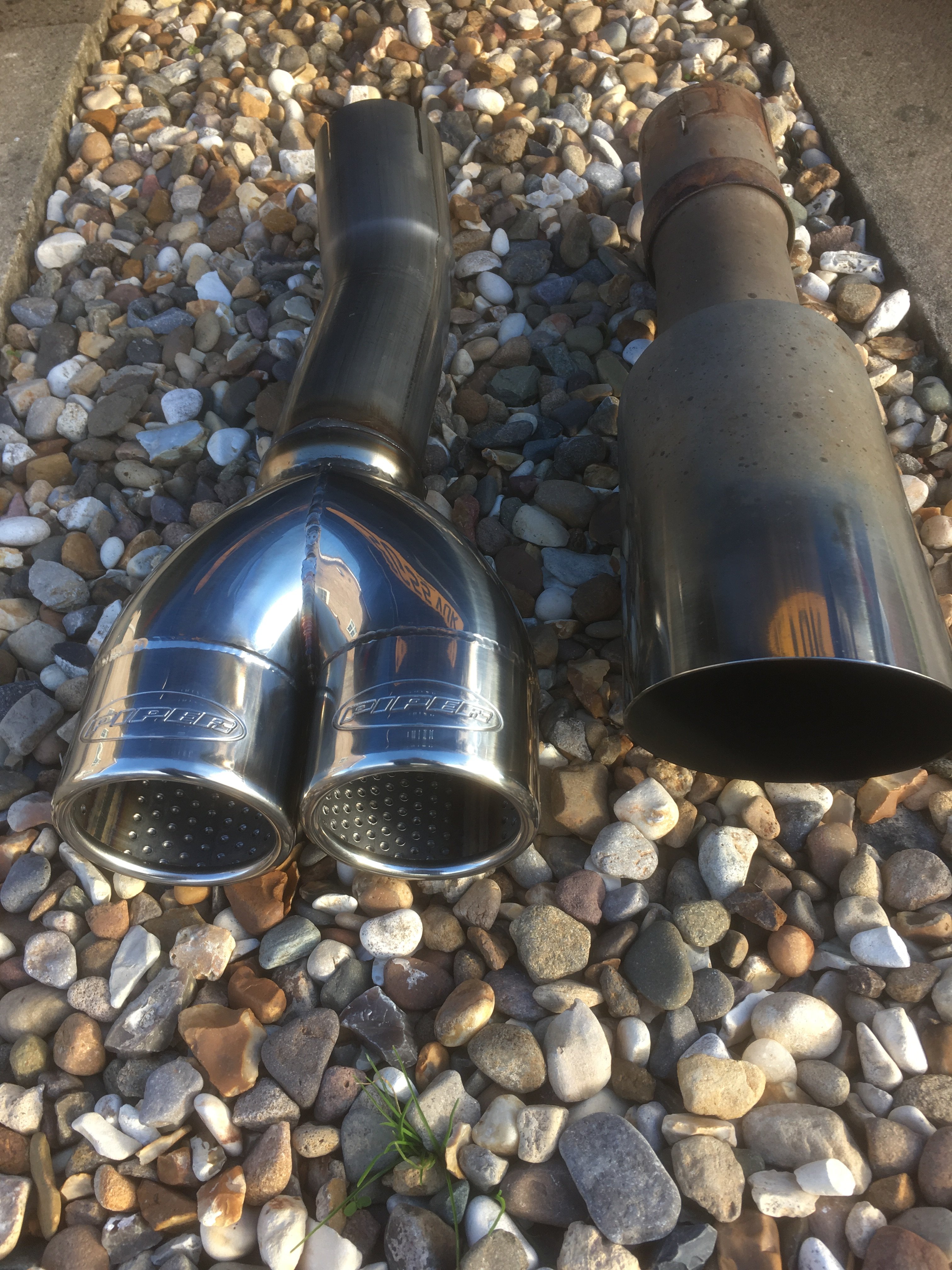

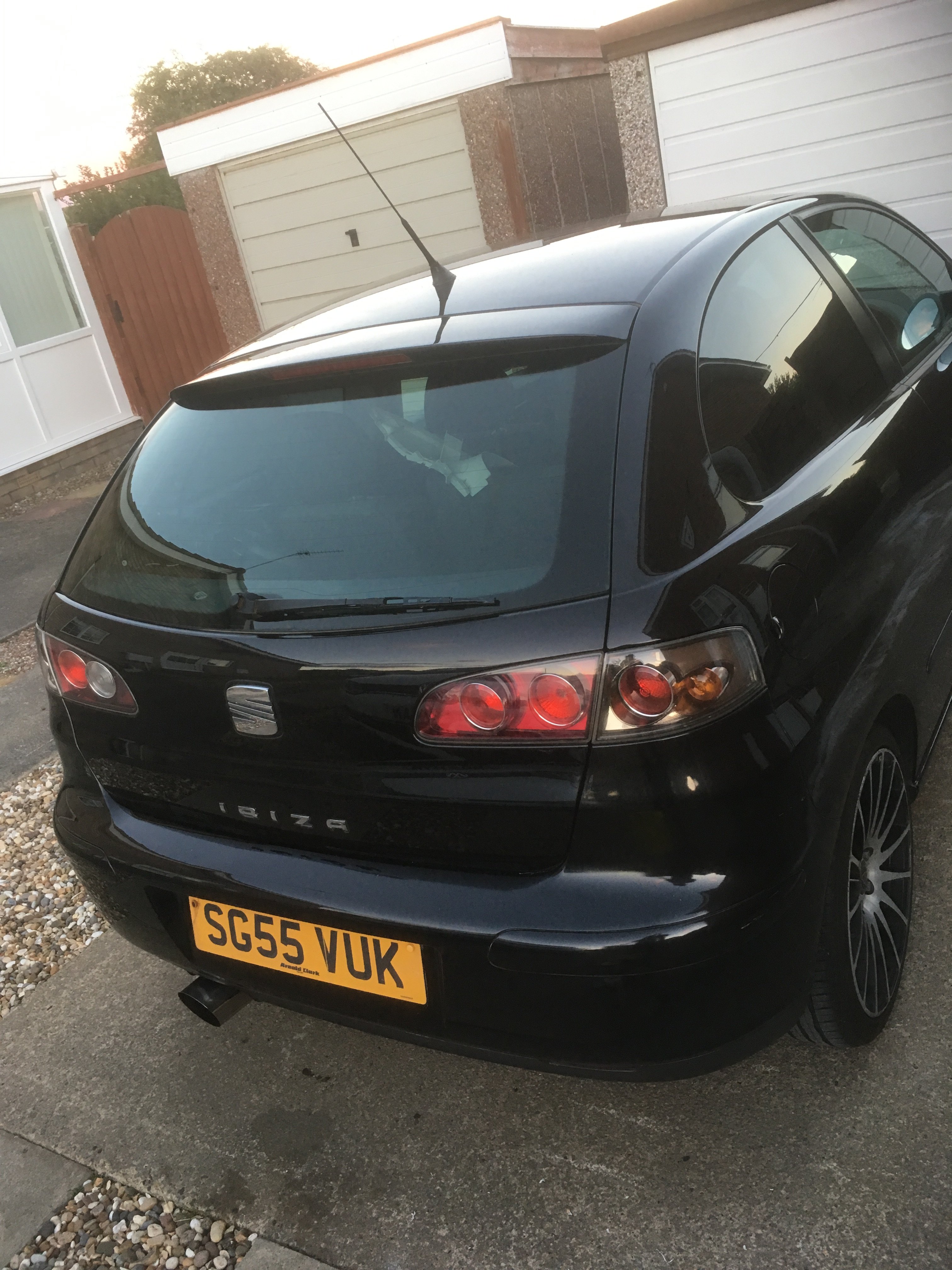

New exhaust tips from piper have arrived, fitted them quickly but I need to trim a inch or so off the pipe so I can get it to sit flush, job for another day. I hate it sticking out of the bumper. Still better then the fart cannon though Lol

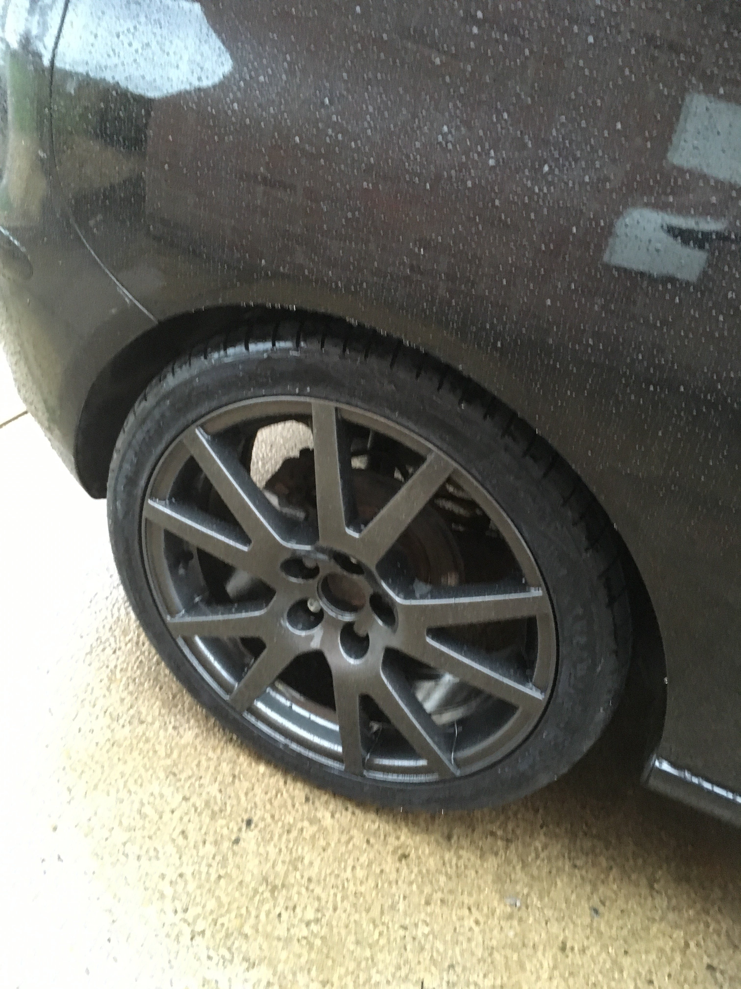

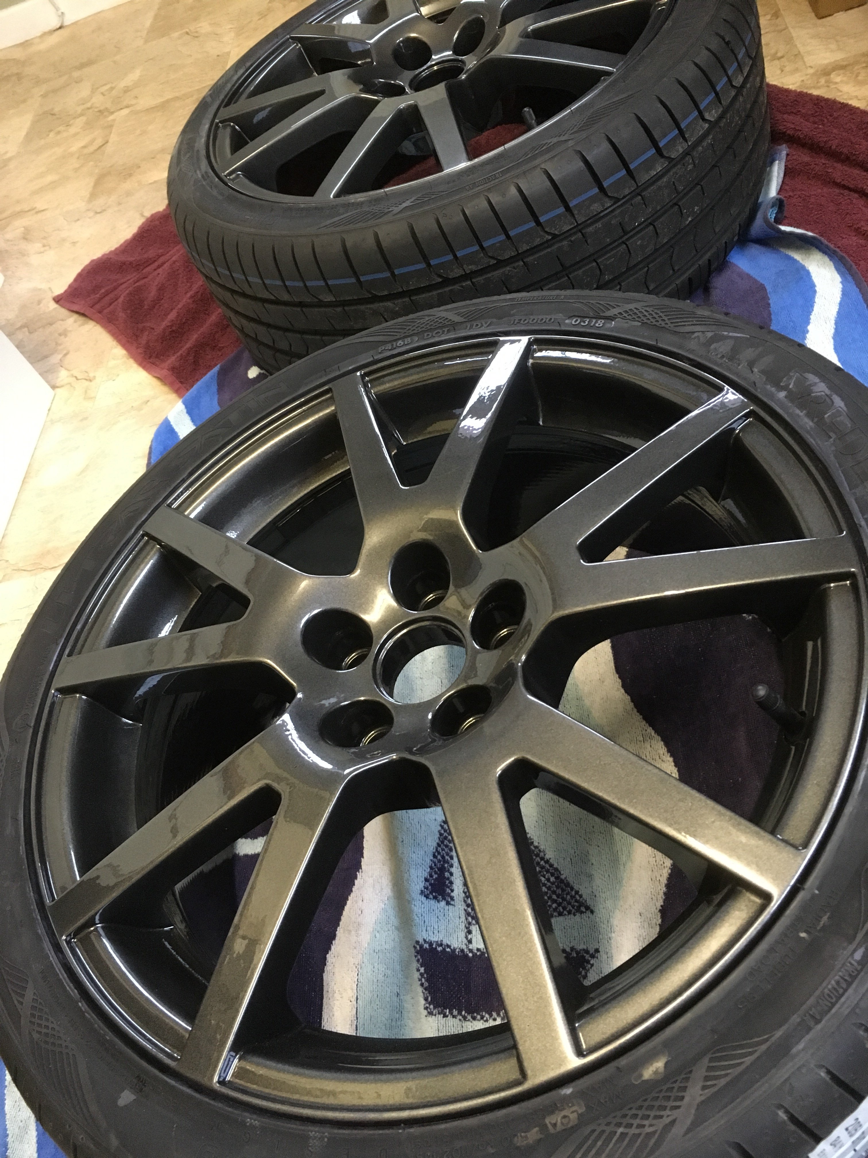

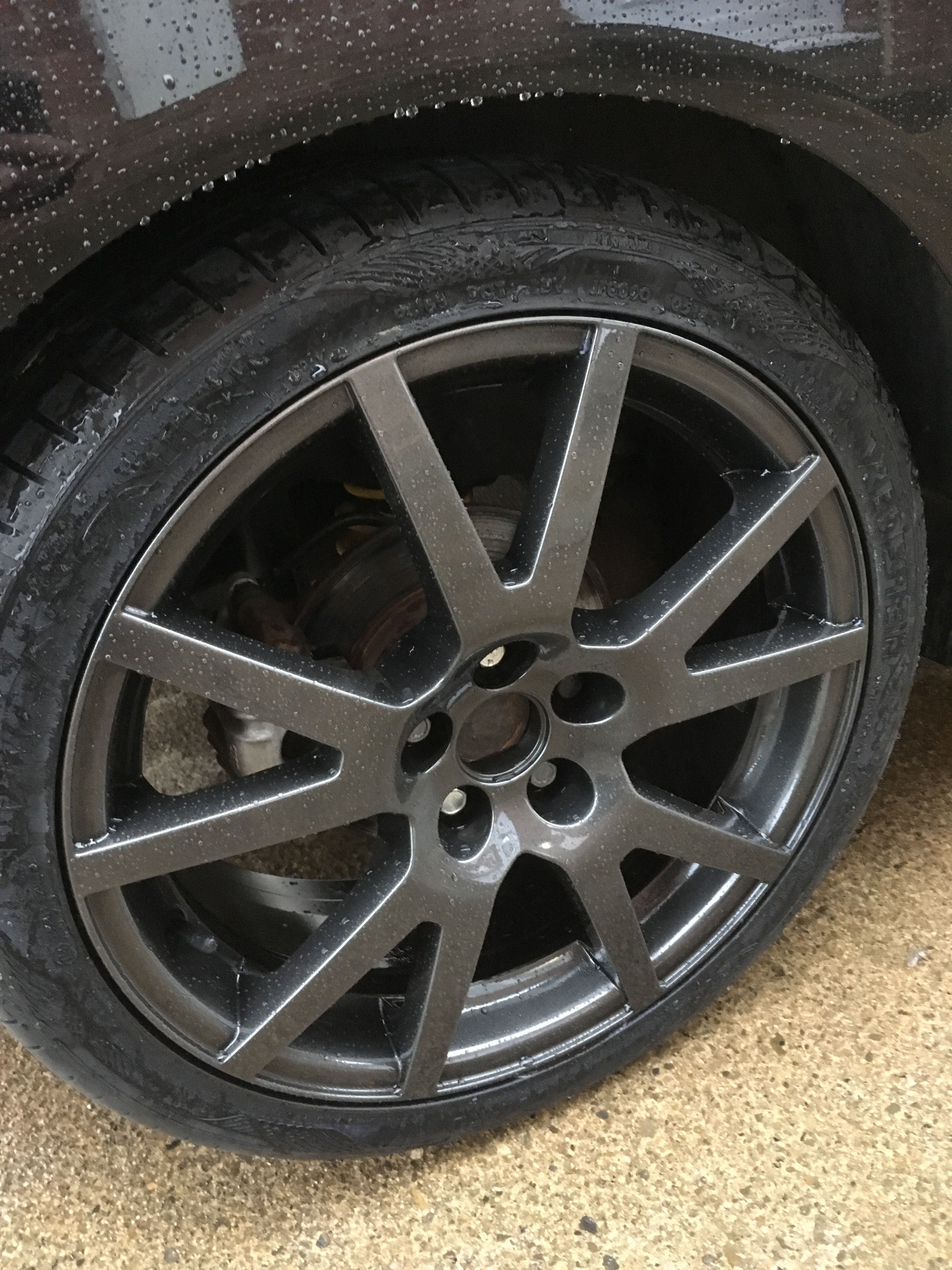

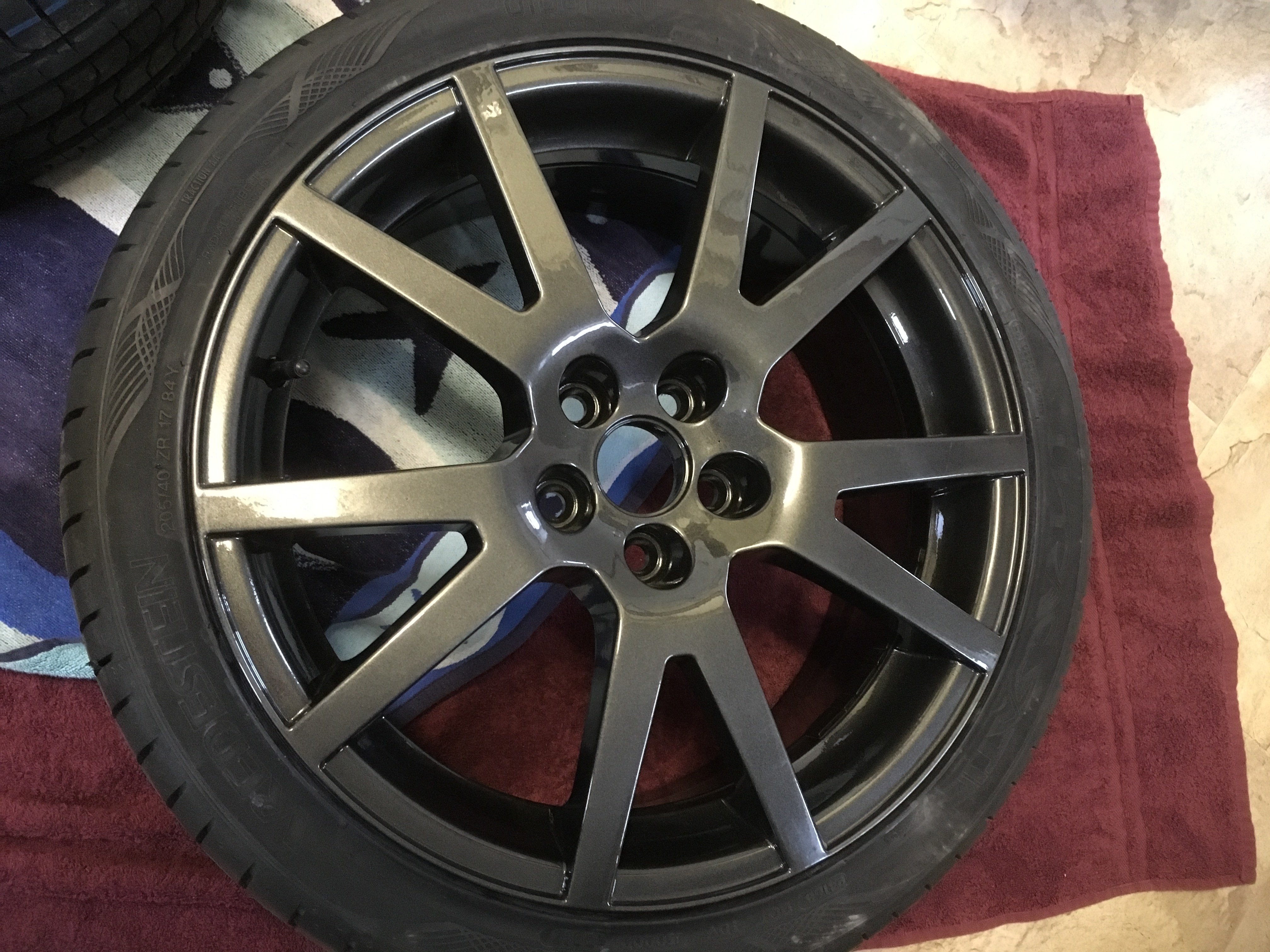

Wheels are back from refurb and looking great, went for gloss anthracite. Sealed with carbon collective platinum wheels before fitment. Nice and discreet look

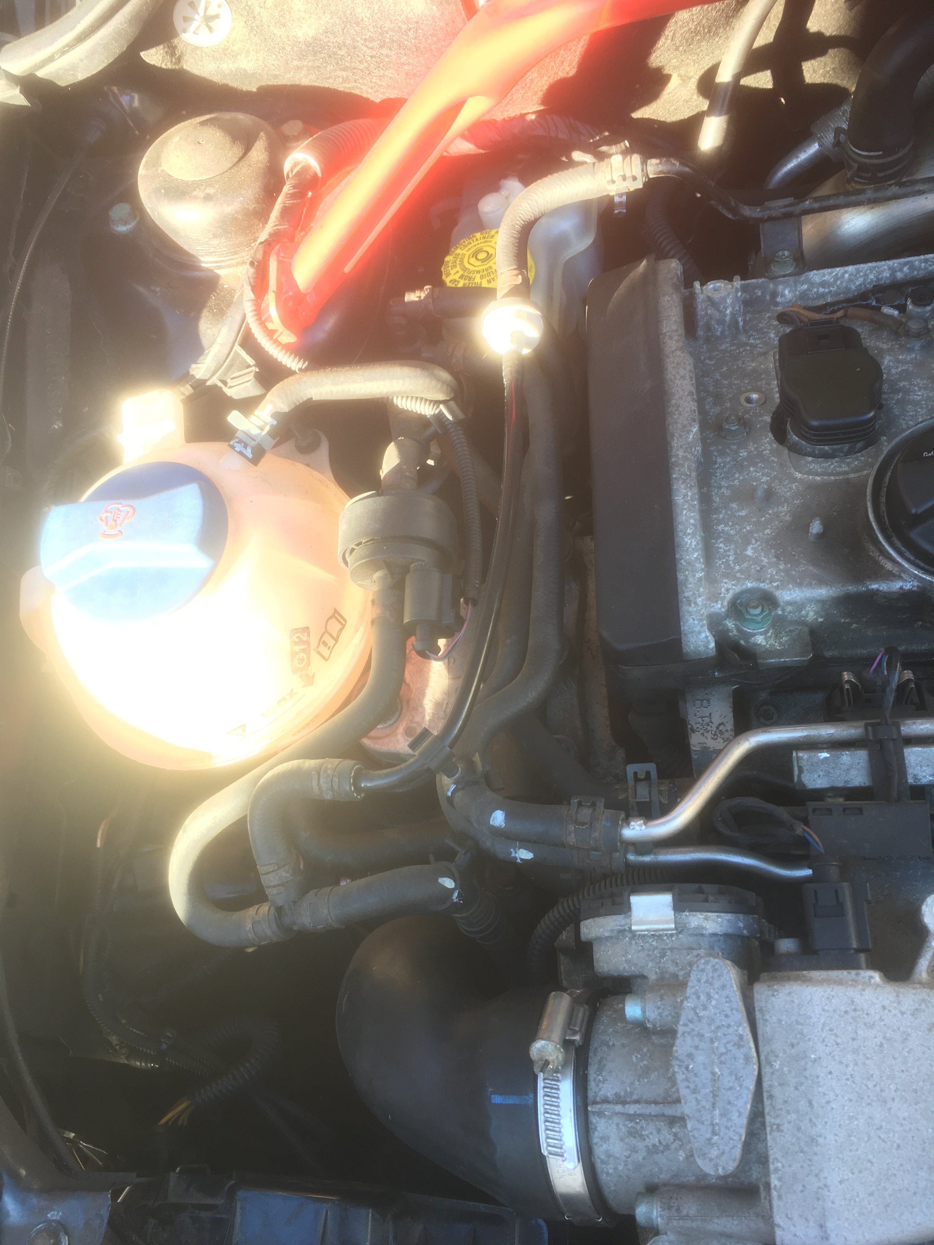

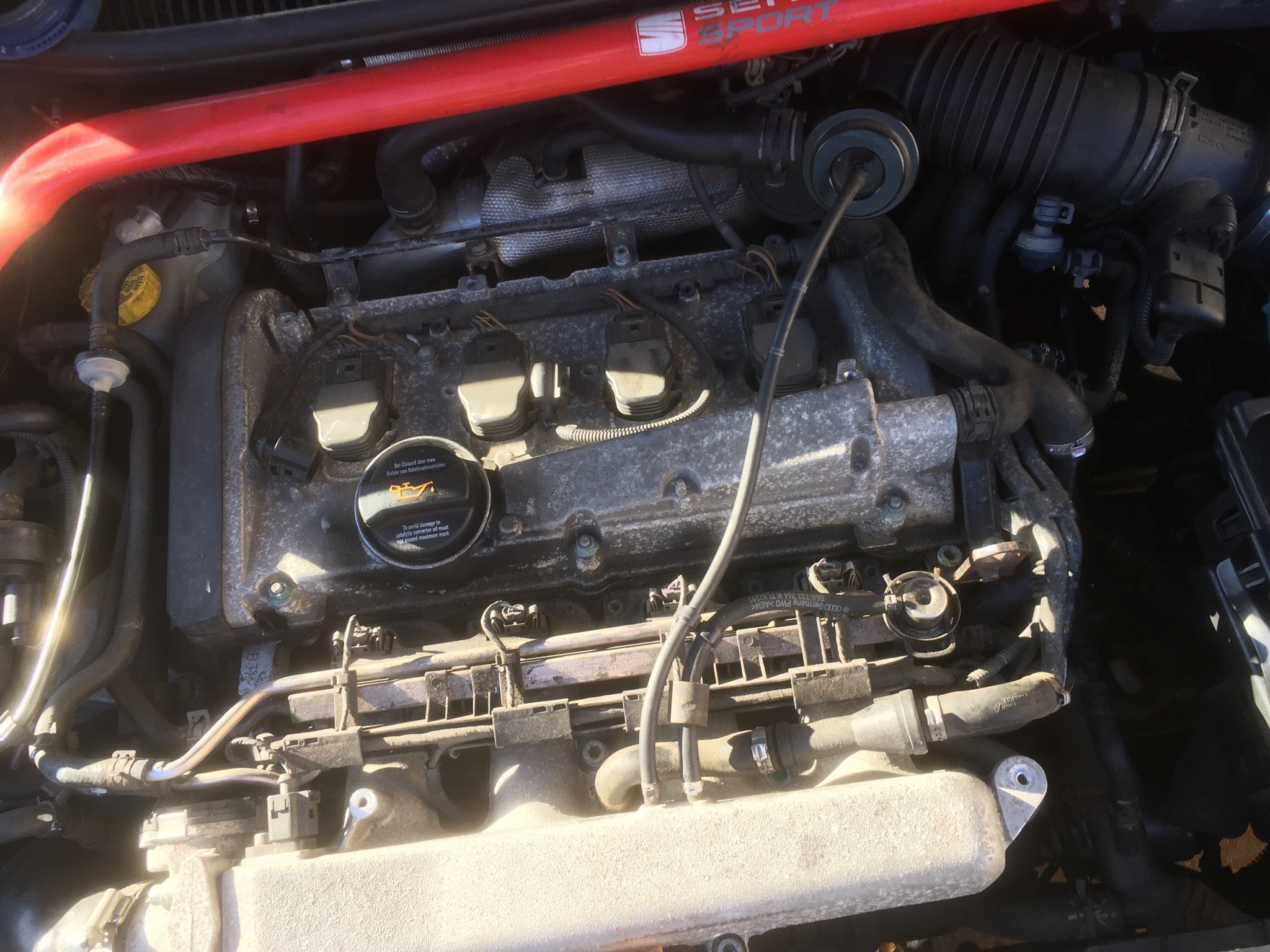

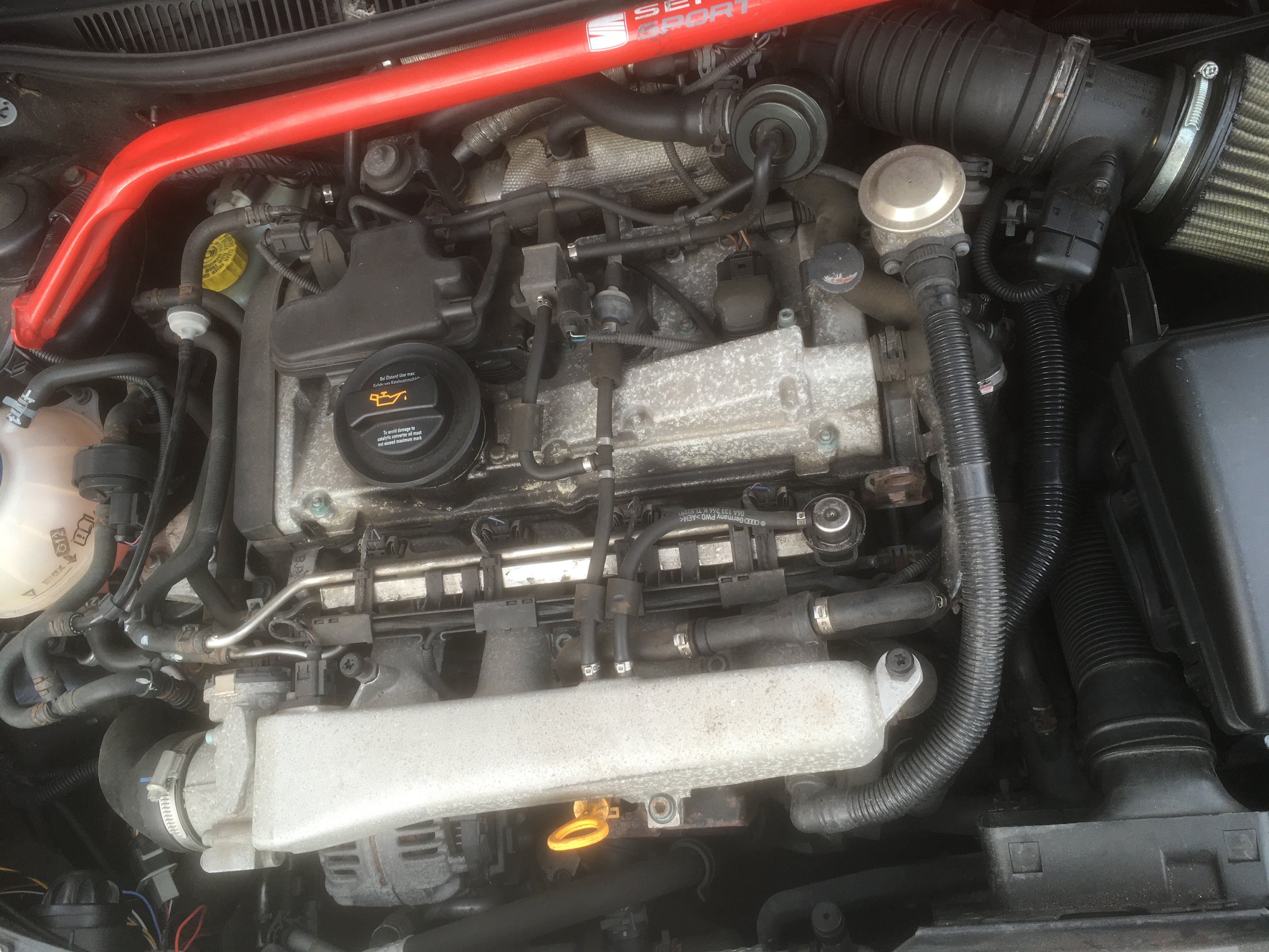

Dead ended some redundant connectors to tidy it up a little, after the sai and n249/112 removed,
before on top

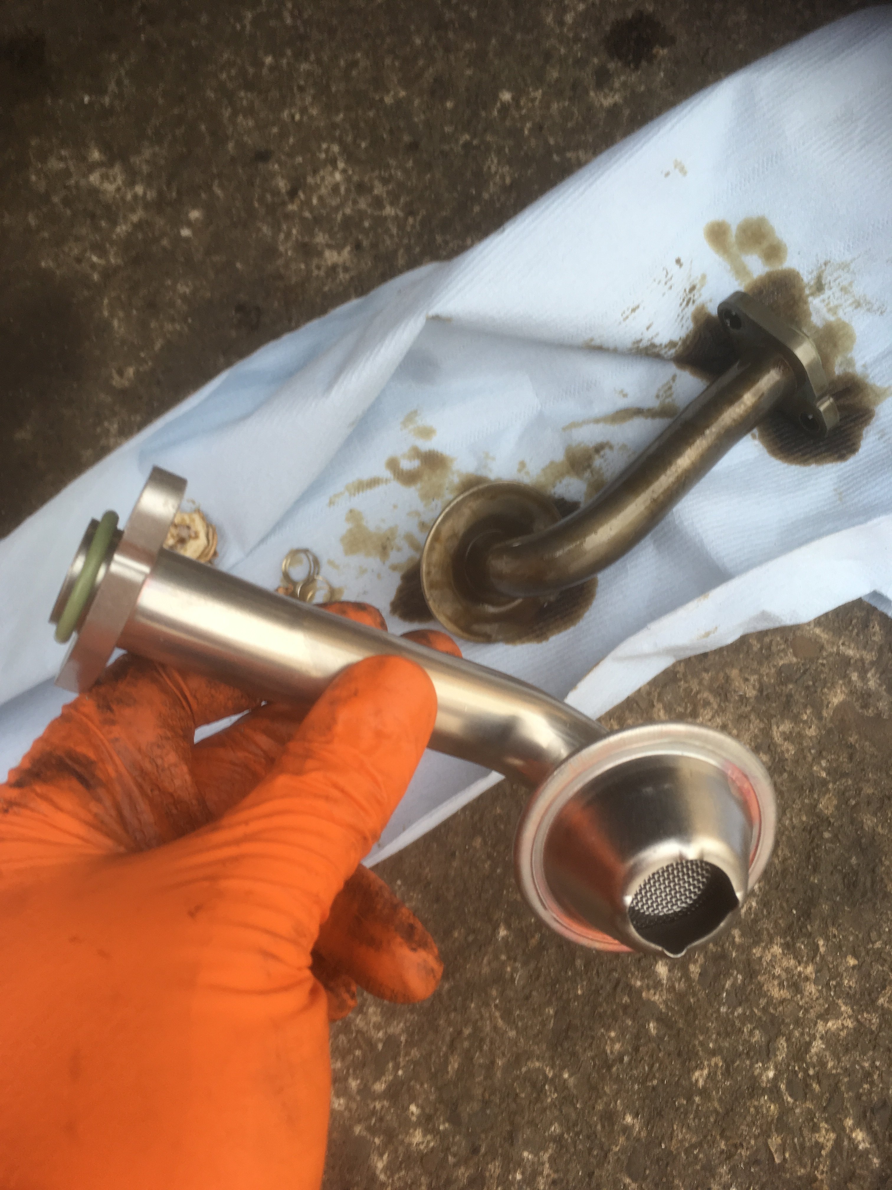

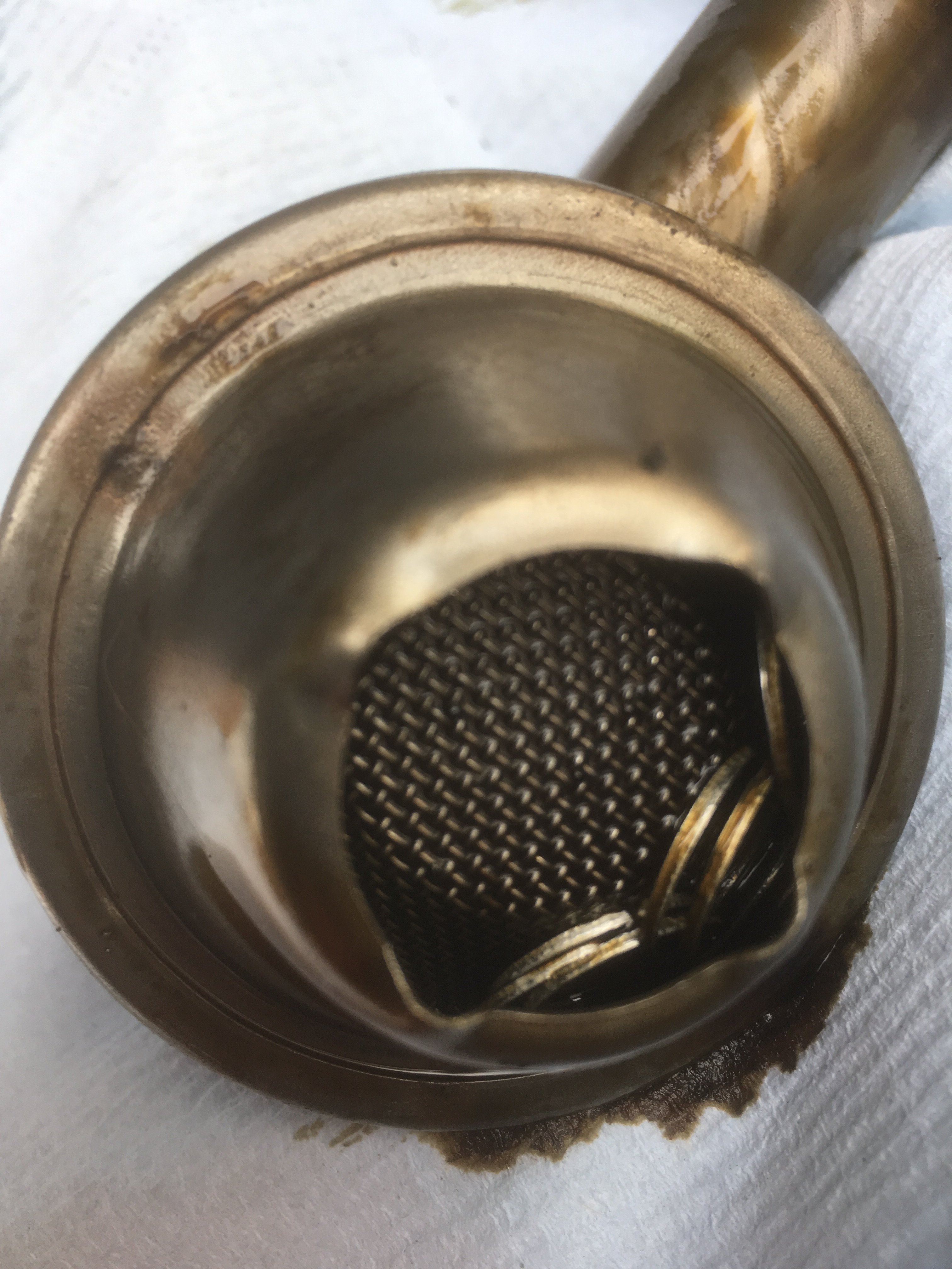

Service today sump dropped and pickup pipe changed, found what looked to be remains of a helicoil insert stuck in the old pickup, which is strange as it has a newish sump on it and that hadn’t been helicoiled, I wonder if the old one had been helicoiled at some point. Pickup itself was surprisingly clear.

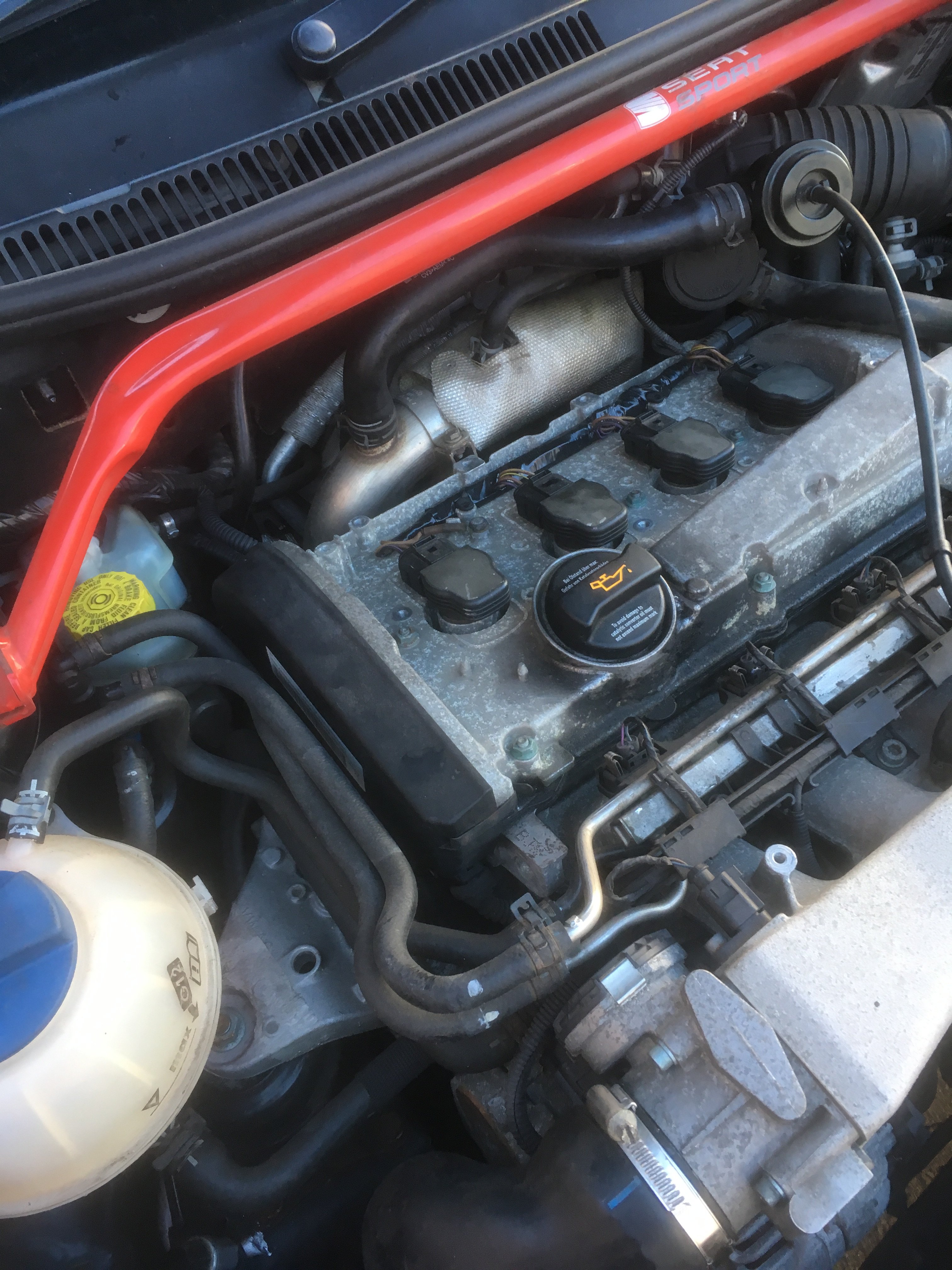

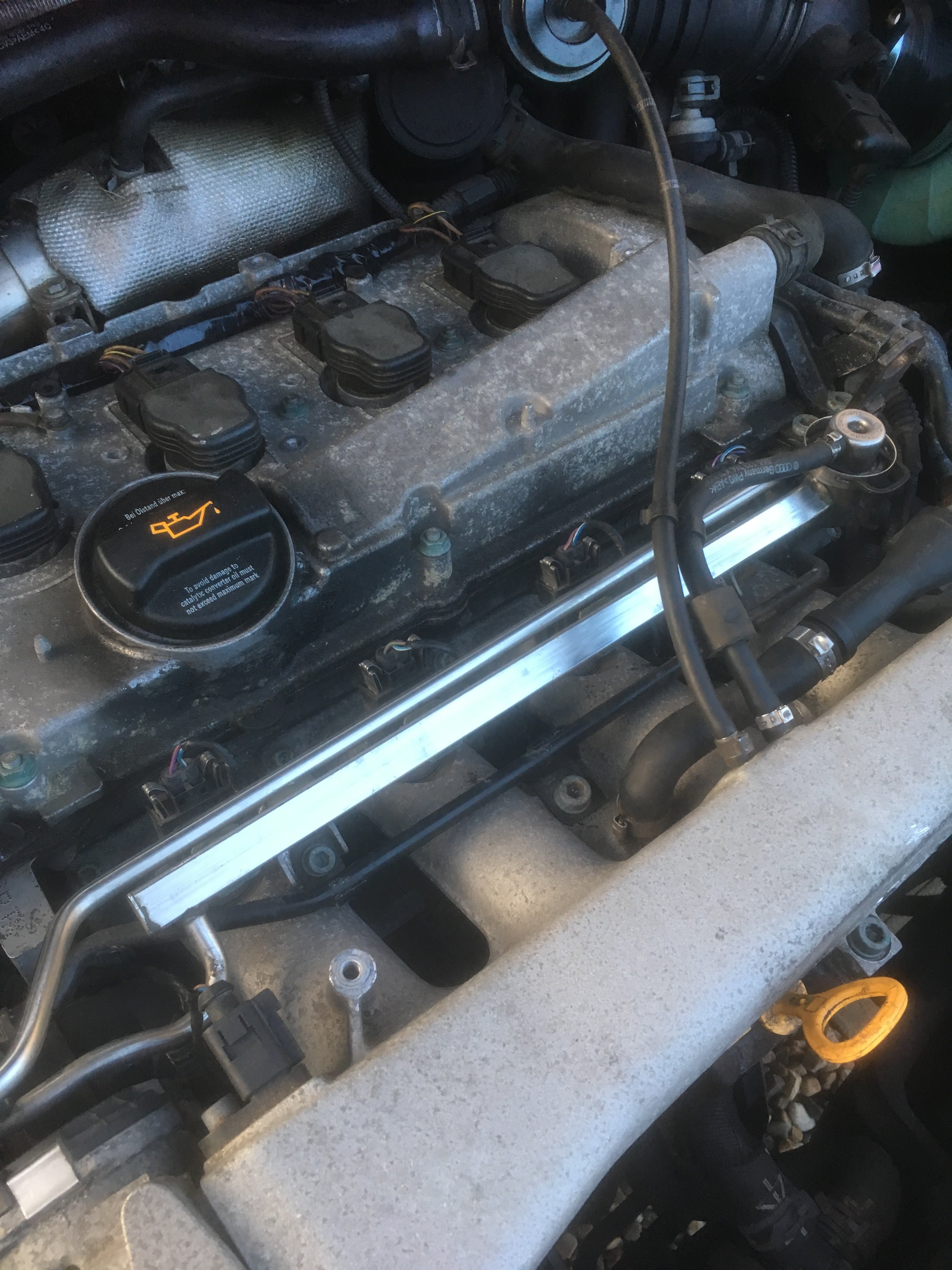

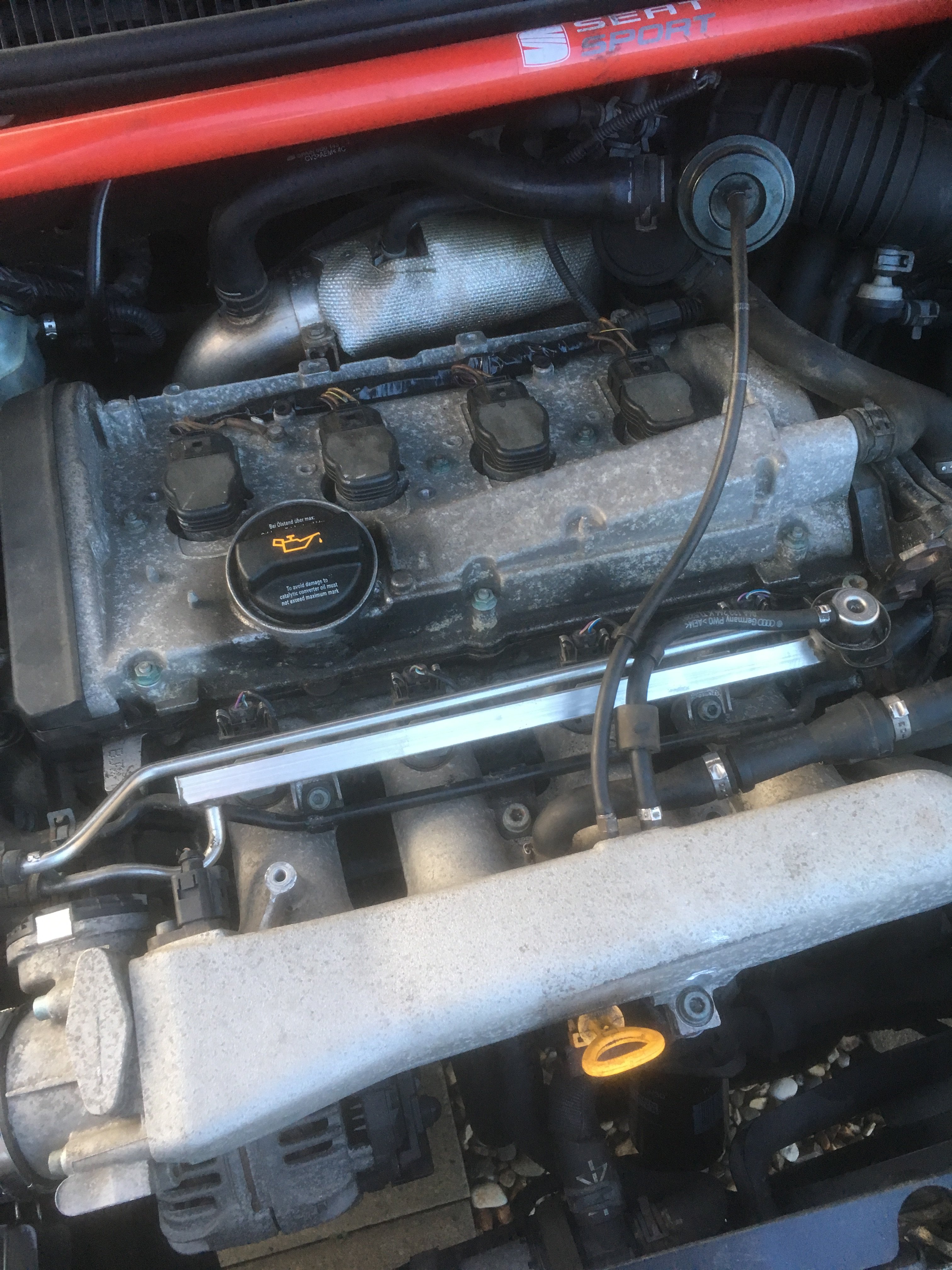

Evap removal today to free up some more space and tidy the bay, hardline across the back of the rocker cover and all the hoses to the throttle body gone, throttle body and tip blanked off, and tank vented to the wheel arch

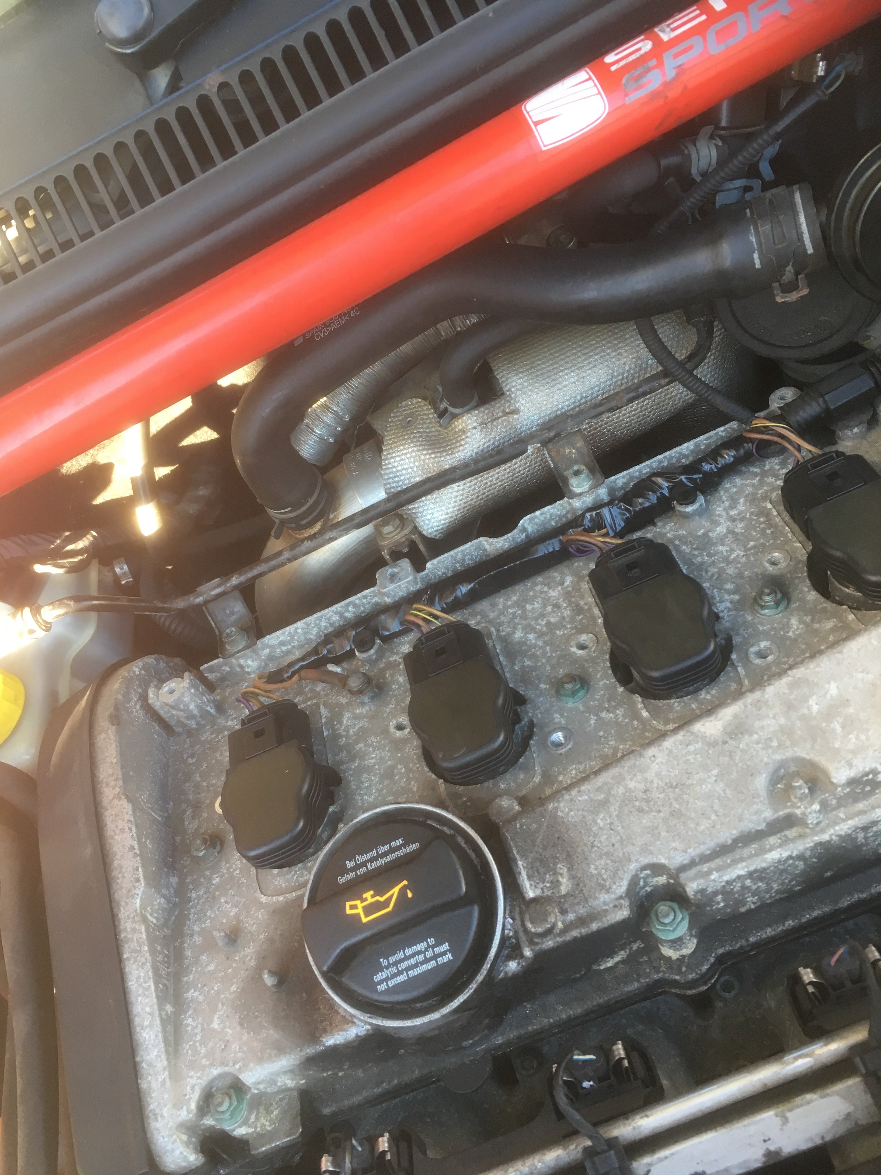

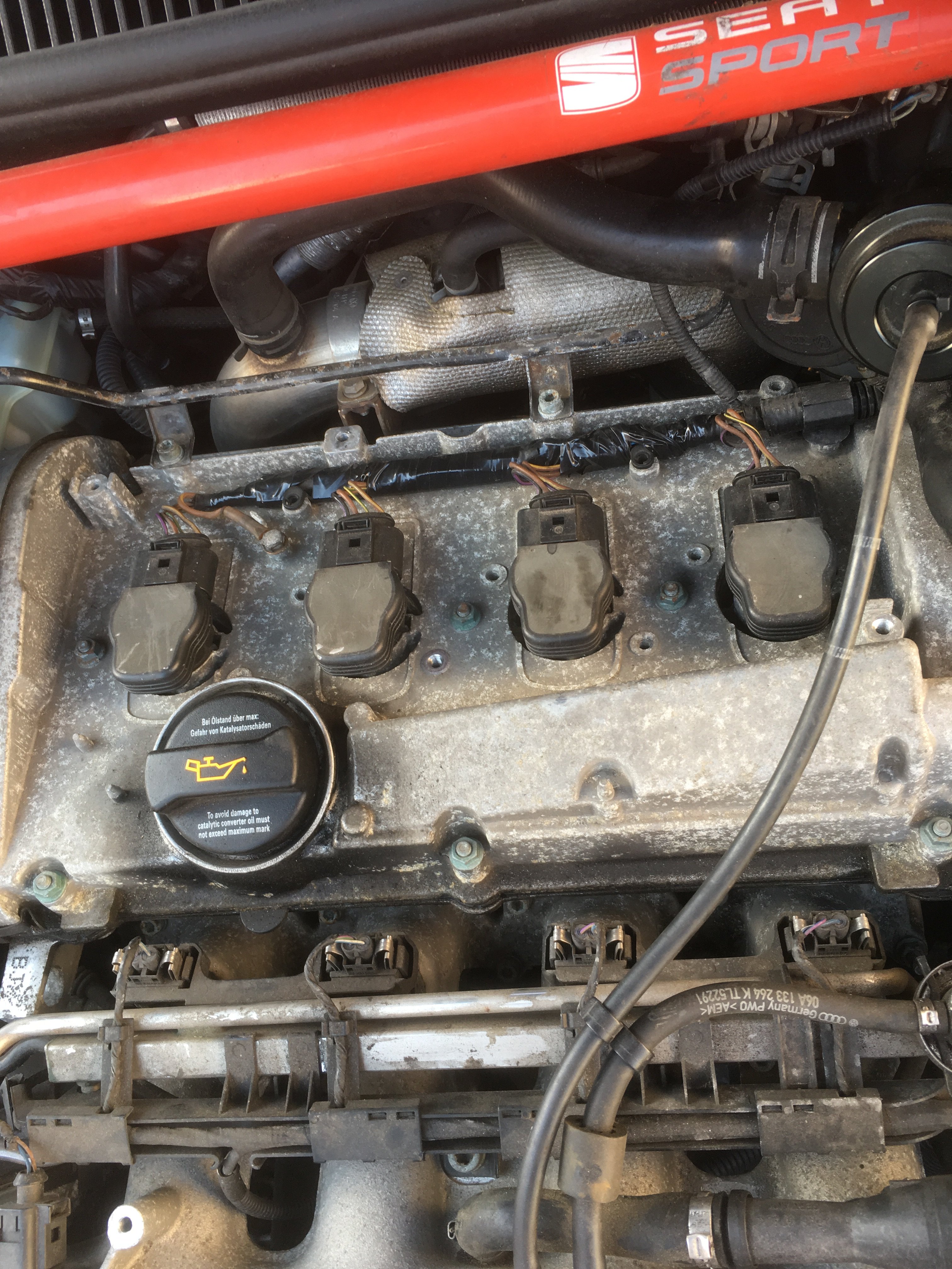

Relocated the injector wiring to under the inlet manifold, makes the fuel rail a lot cleaner :)
