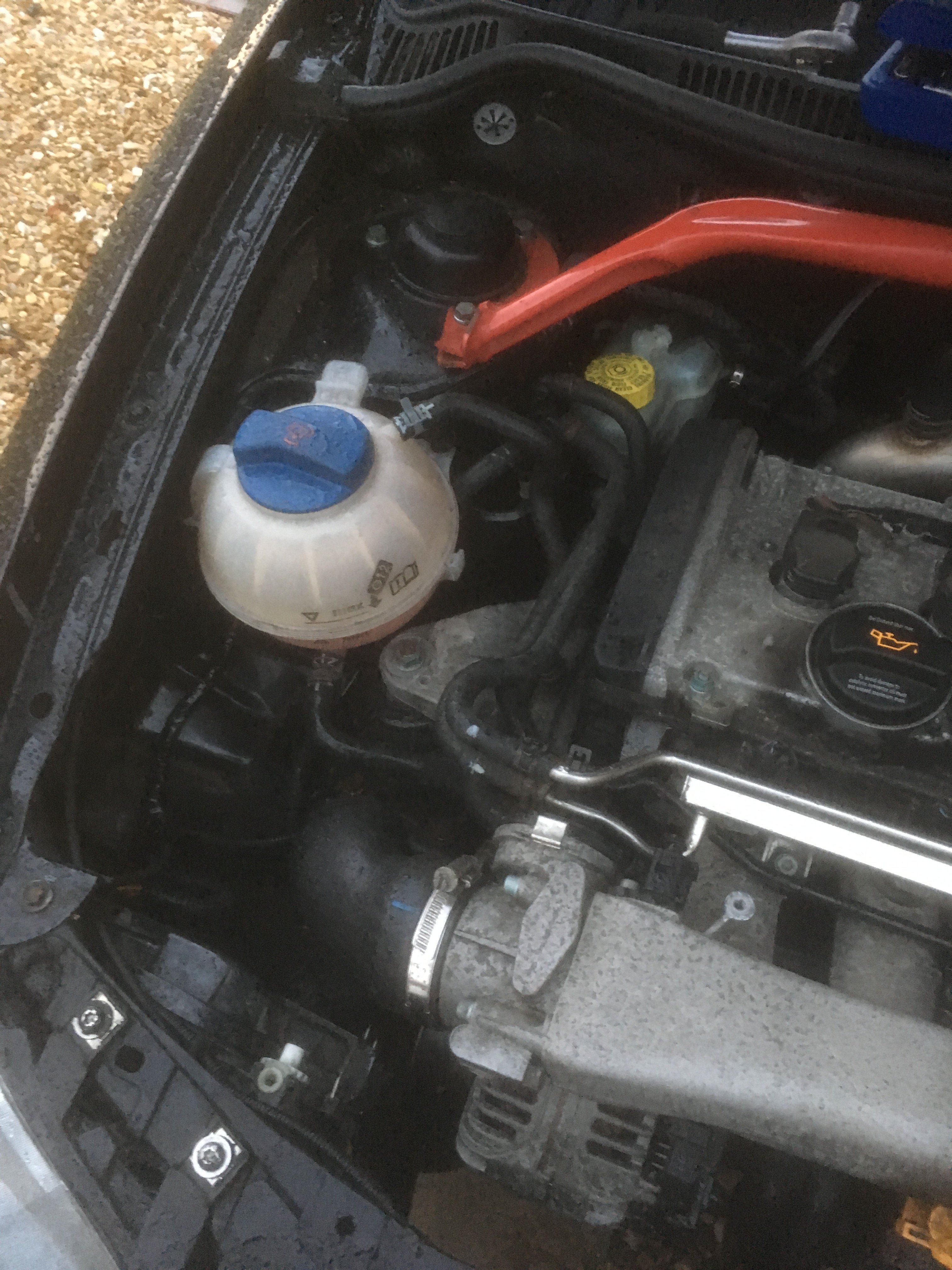

Hope you don't mind me asking but what's the score with removing the n249 valve?
I've just bought a beetle 1.8t and it's suffering with turbo chatter. Fault scanner says that the dump valve isn't working but I'm thinking of bypassing the n249 valve anyway so it's probably a good place to start.
Thanks.
Common mod mate lots of info about about it, but general consensus is it makes part throttle smoother, one less valve to go wrong and a big length of vac pipe to remove as well= less possible leaks. I’ve always removed it and never had any problems

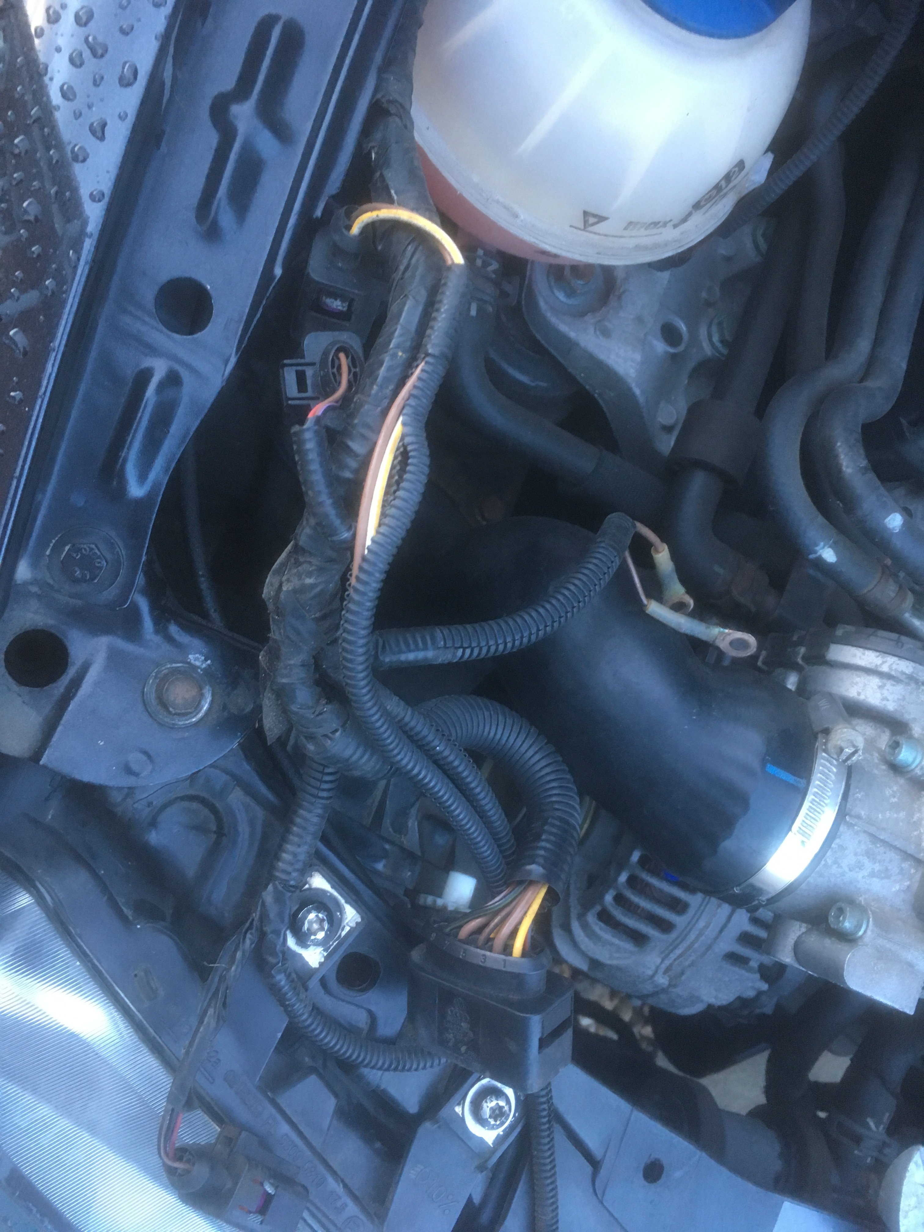

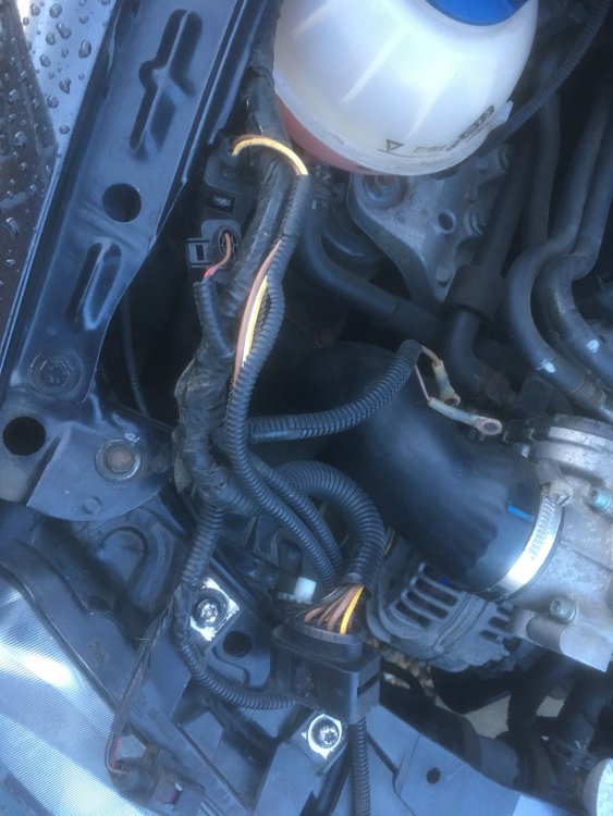

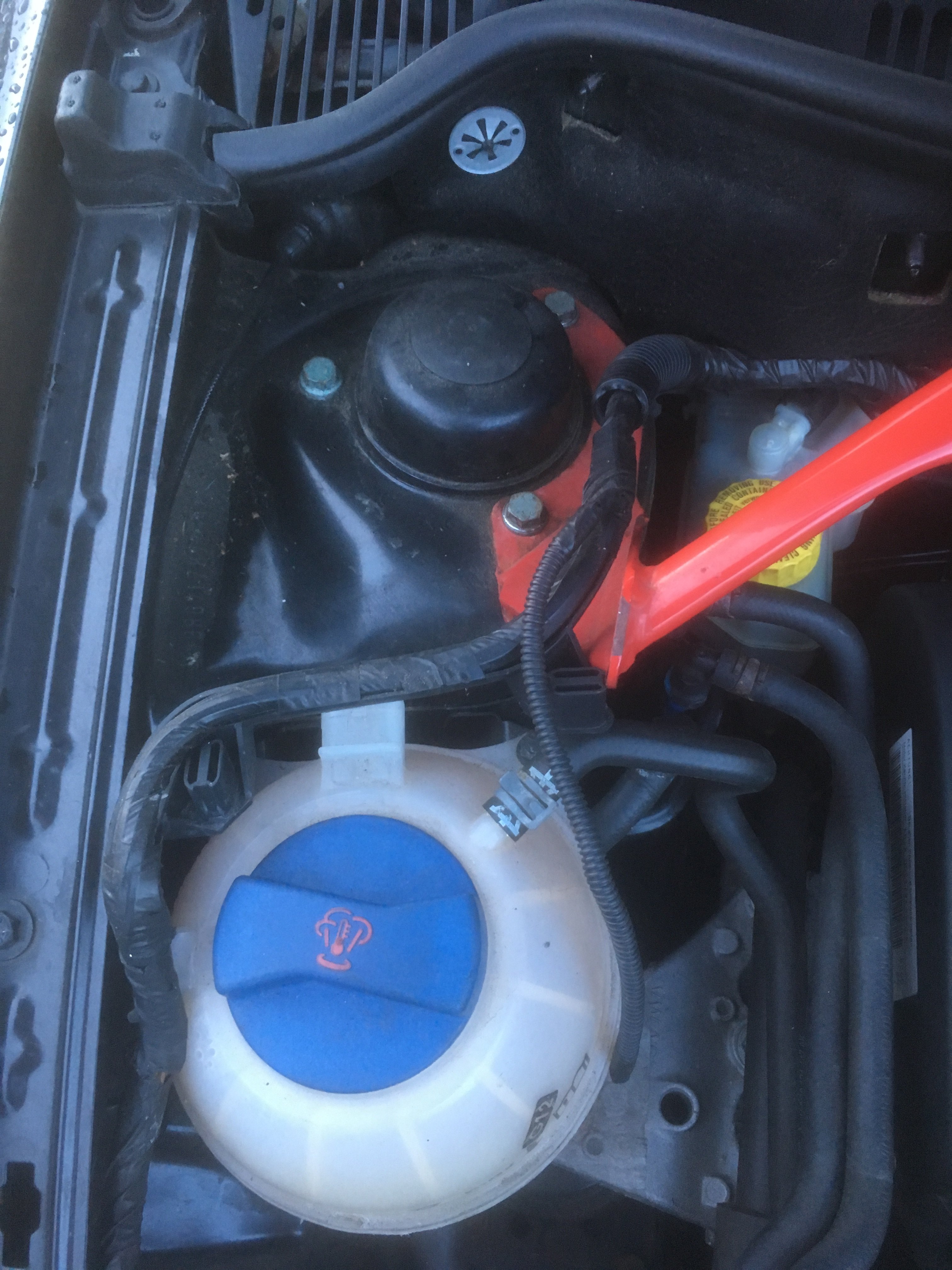

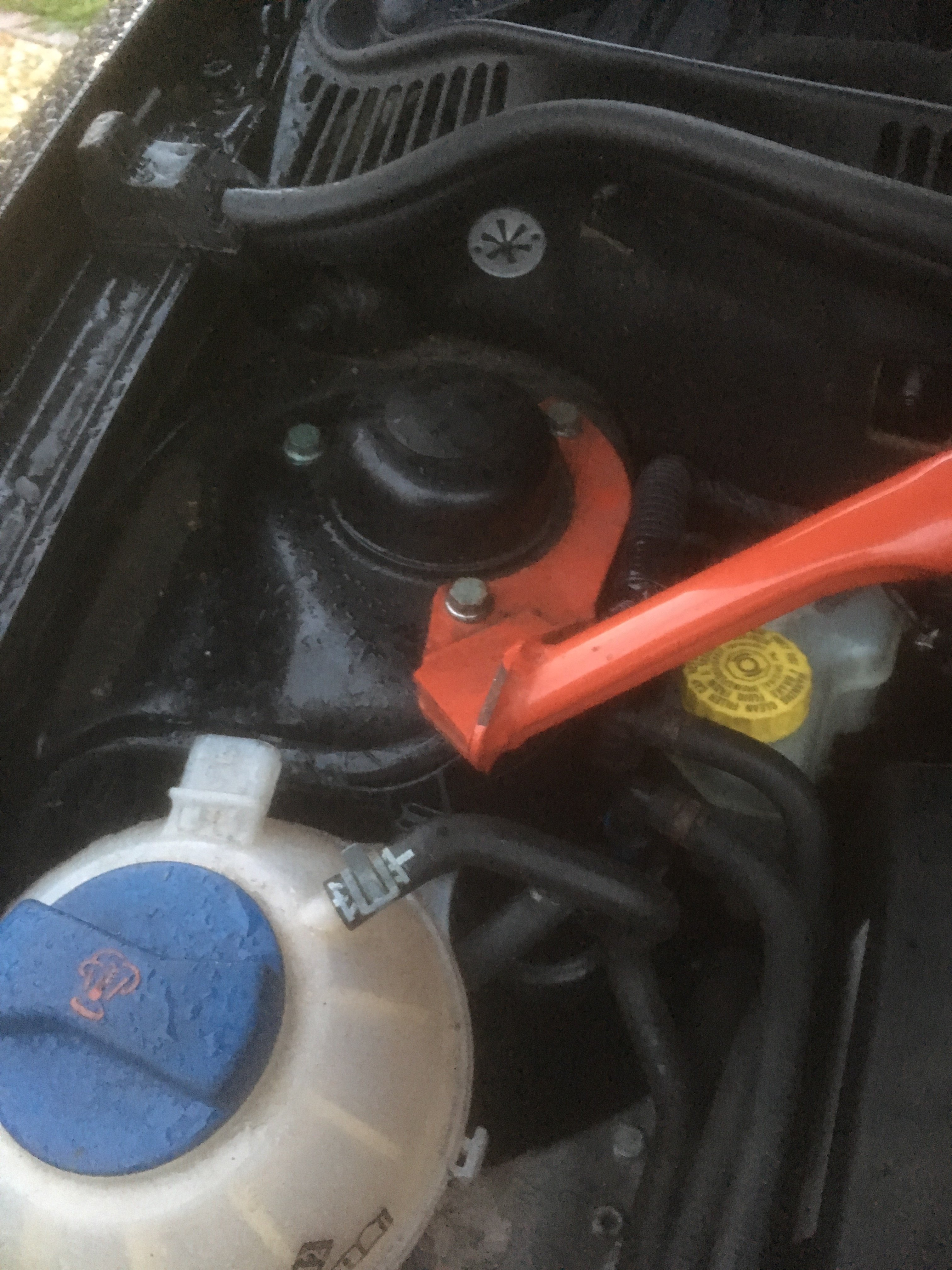

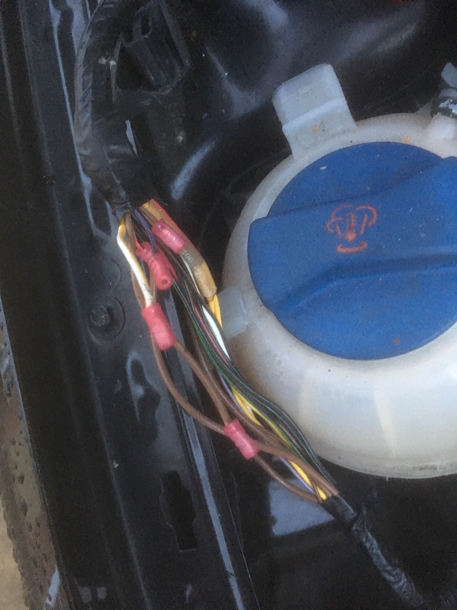

Sorted out some more redundant connectors on the left hand side of the bay, and fitted the loom correctly under the strut brace. God knows why it was fitted over it :)

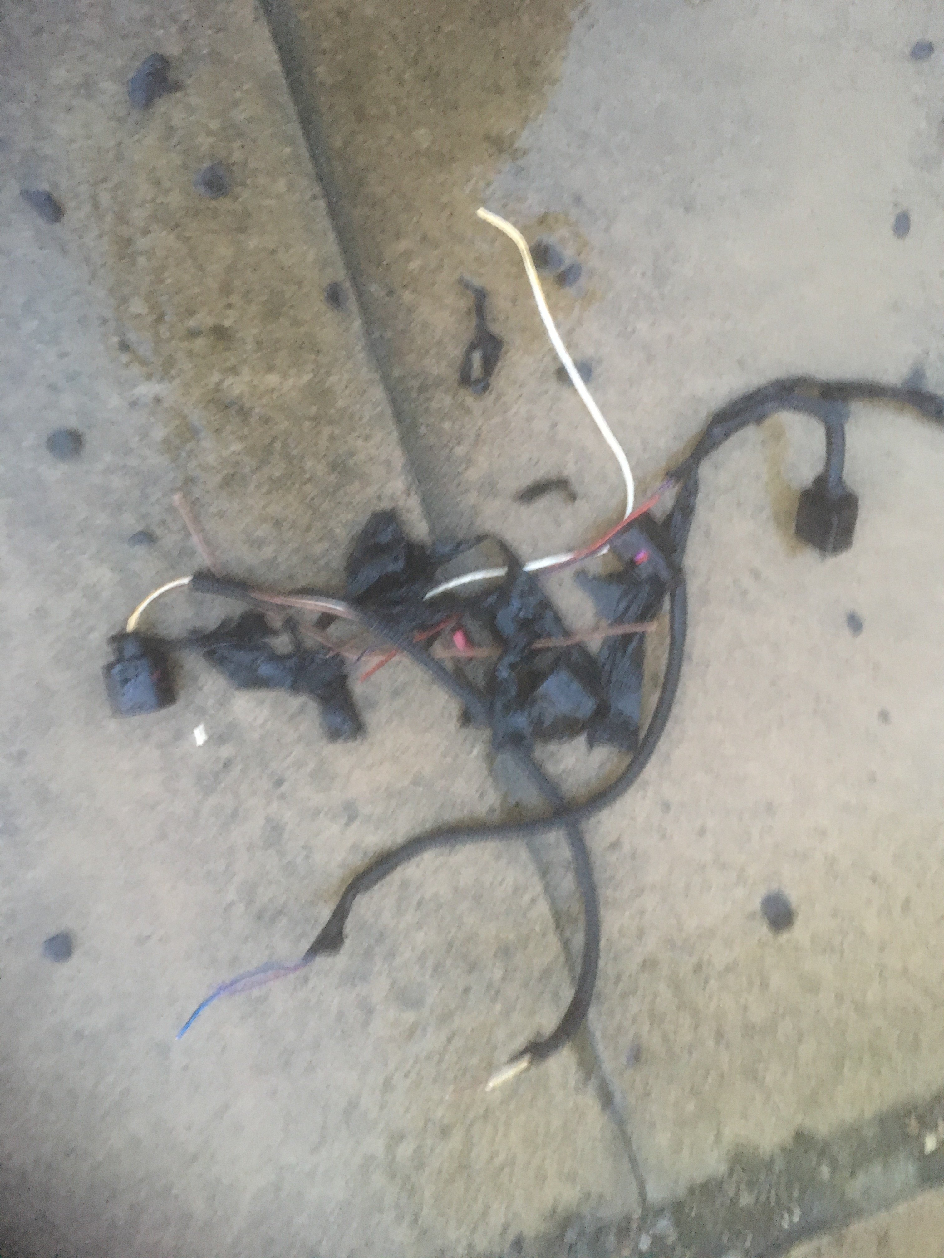

Had a spare hour tonight so been looking at the wiring on elsawin. Now I’ll be able to strip the Ibiza wiring under the dash remove the required relay/wiring to power the ecu, and pre install it in the Fabia so when the engine goes in it’ll be plug and play :).

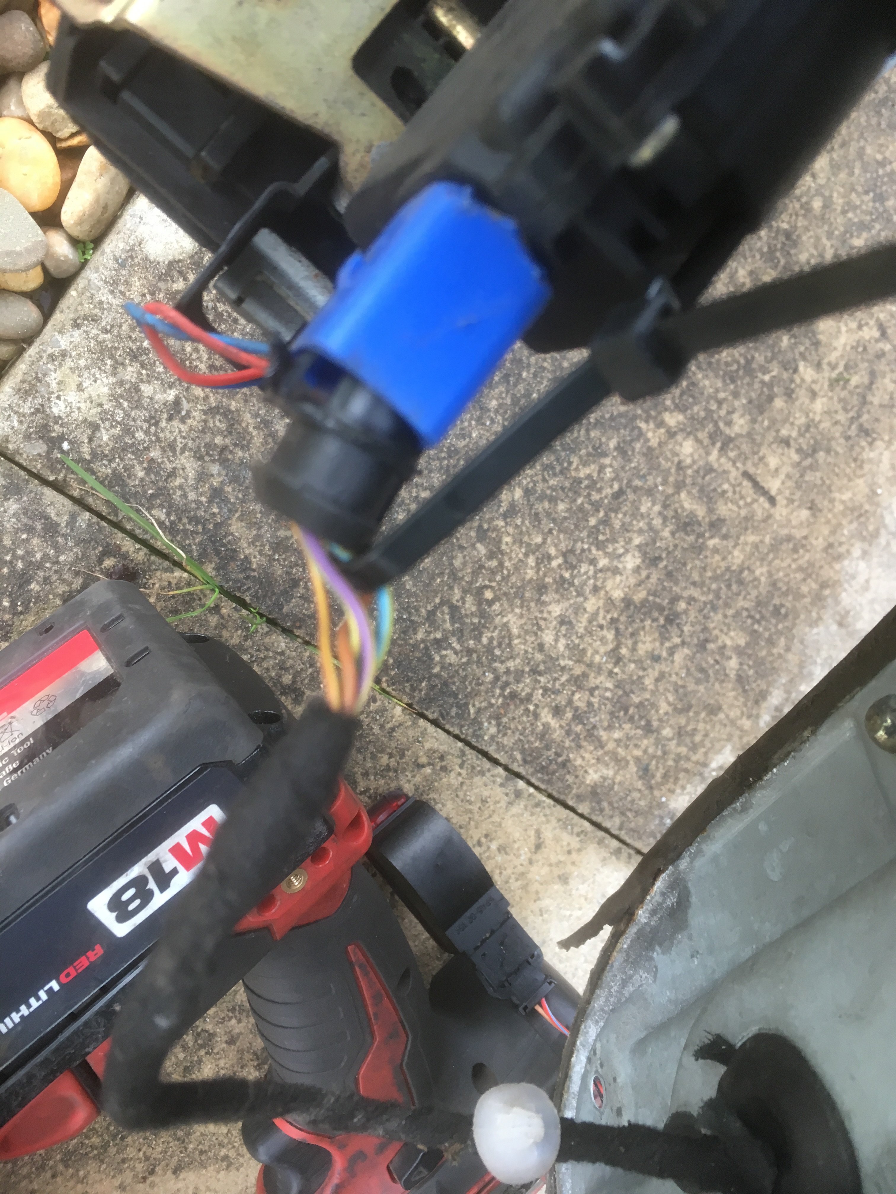

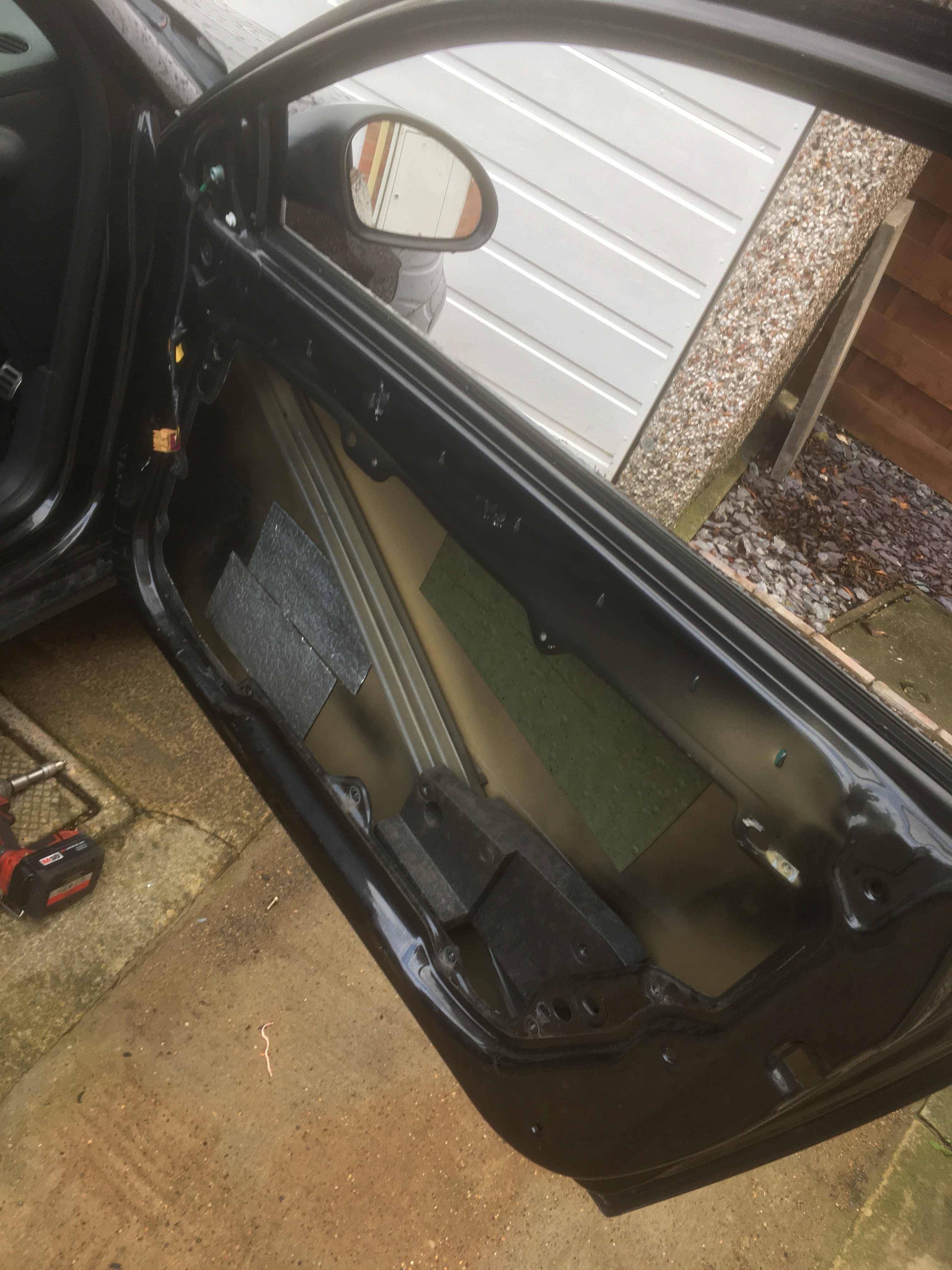

Looked into the central locking fault on the Fabia, drivers door lock would only lock and not unlock. Checked out the wiring on the Ibiza and it’s the same to the lock so they are interchangeable so went about swapping the lock over.

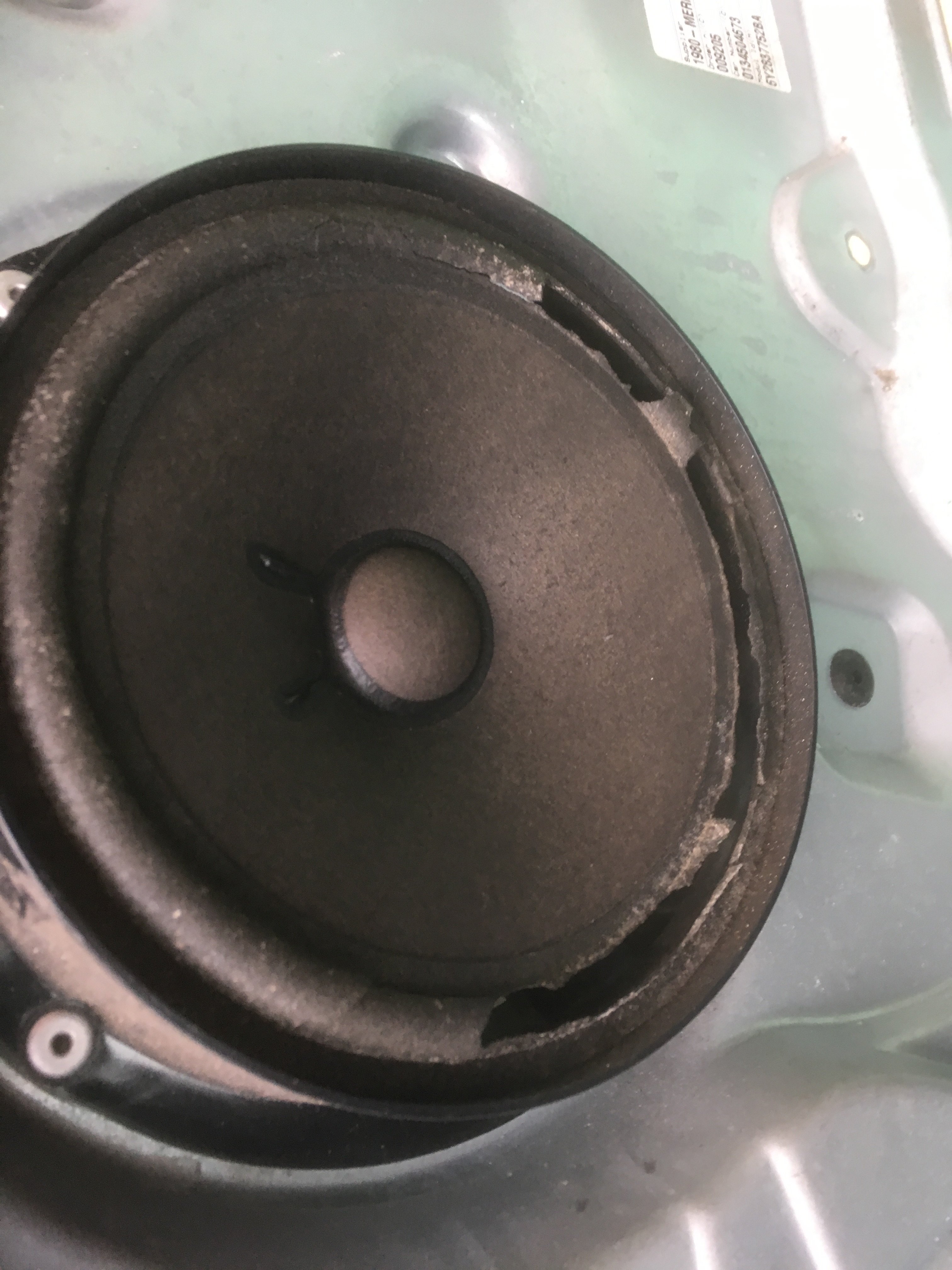

Ibiza front door stripped to take the hertz component speakers off too to swap over, and when stripping the Fabia found the door lock connector was broken and just pushed in, couple of pins were snapped inside. Unfortunately both Ibiza connector lock tabs are both broken too so I’ll have to get a connector from scrappy, I might even get a door loom as the led for alarm has been chopped off too, Fabia speakers have seen better days lol.
Got some sound deadening coming to do the doors when I fit the speakers. Probably stopped play until tues now.

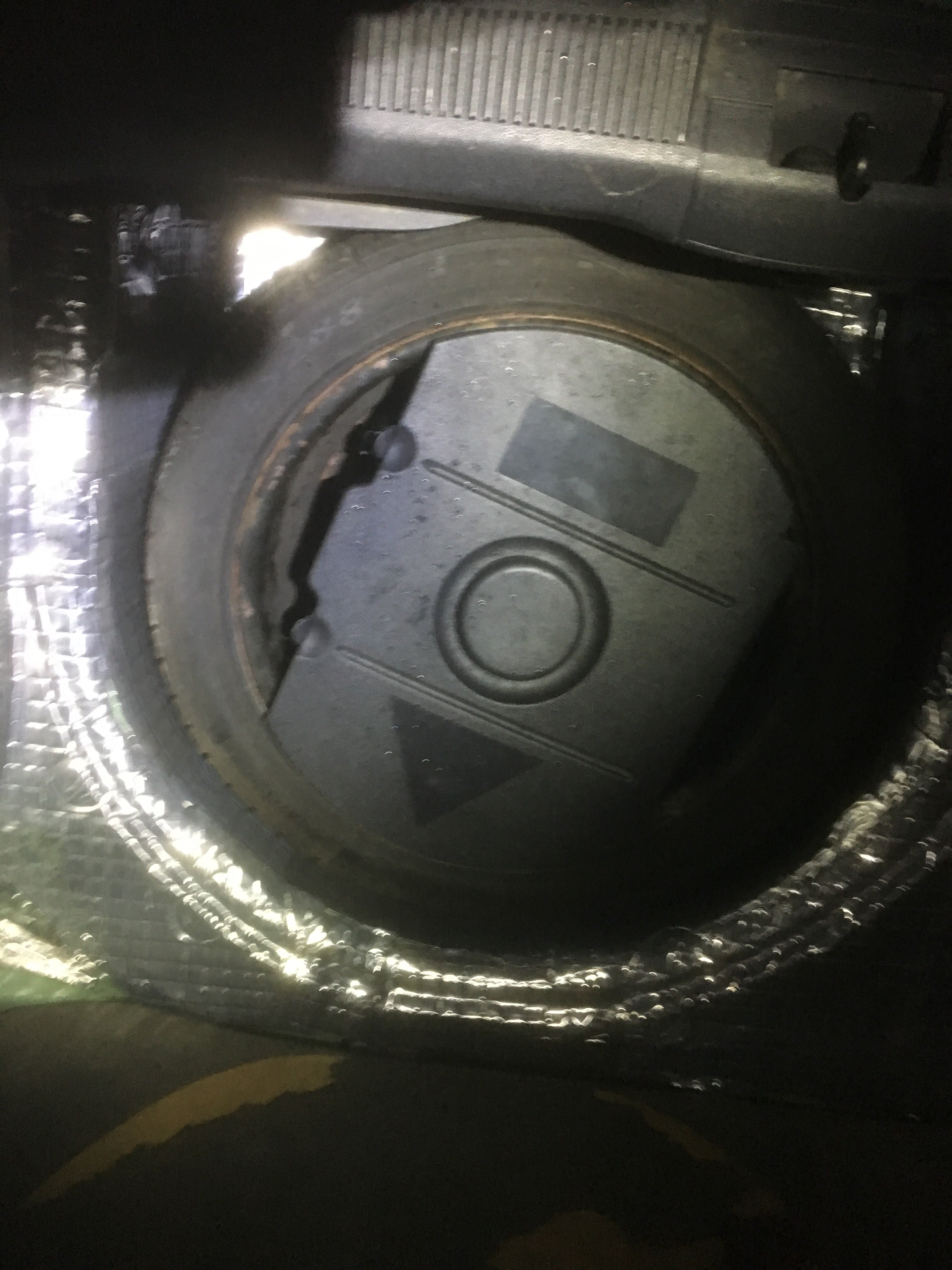

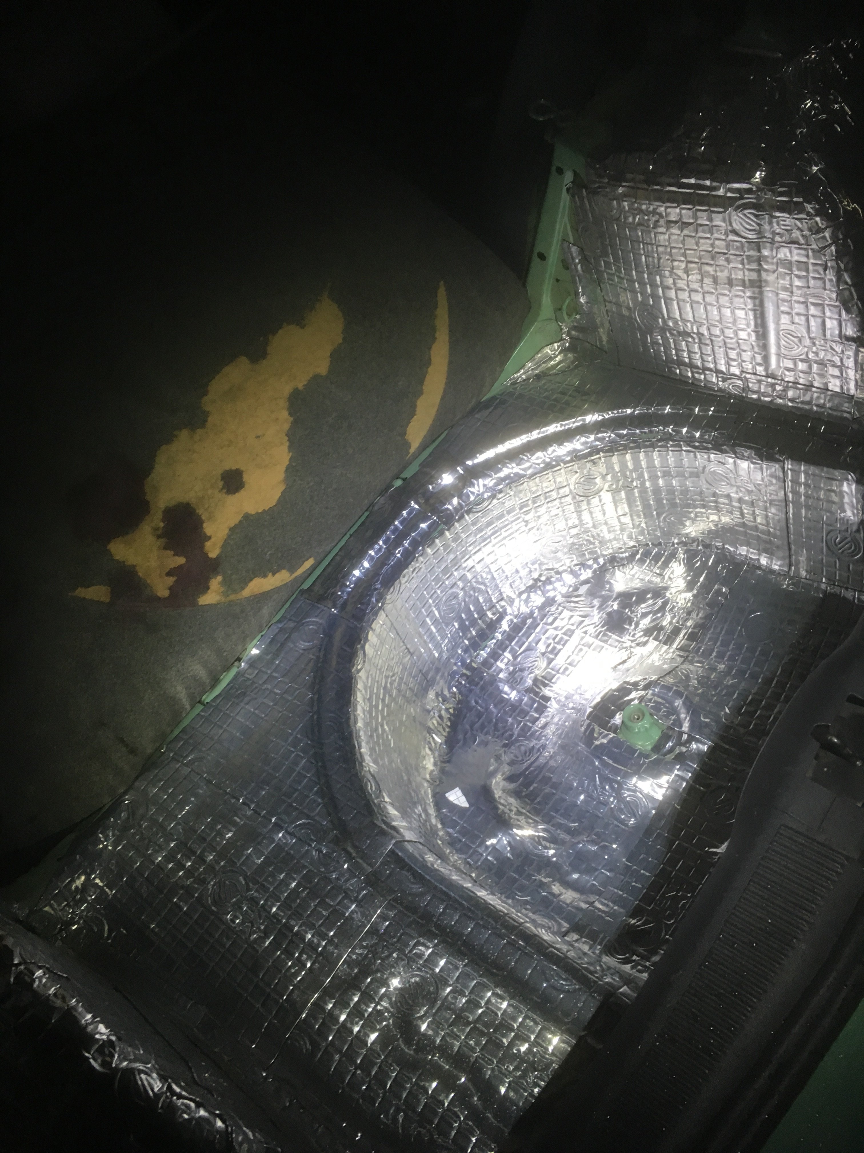

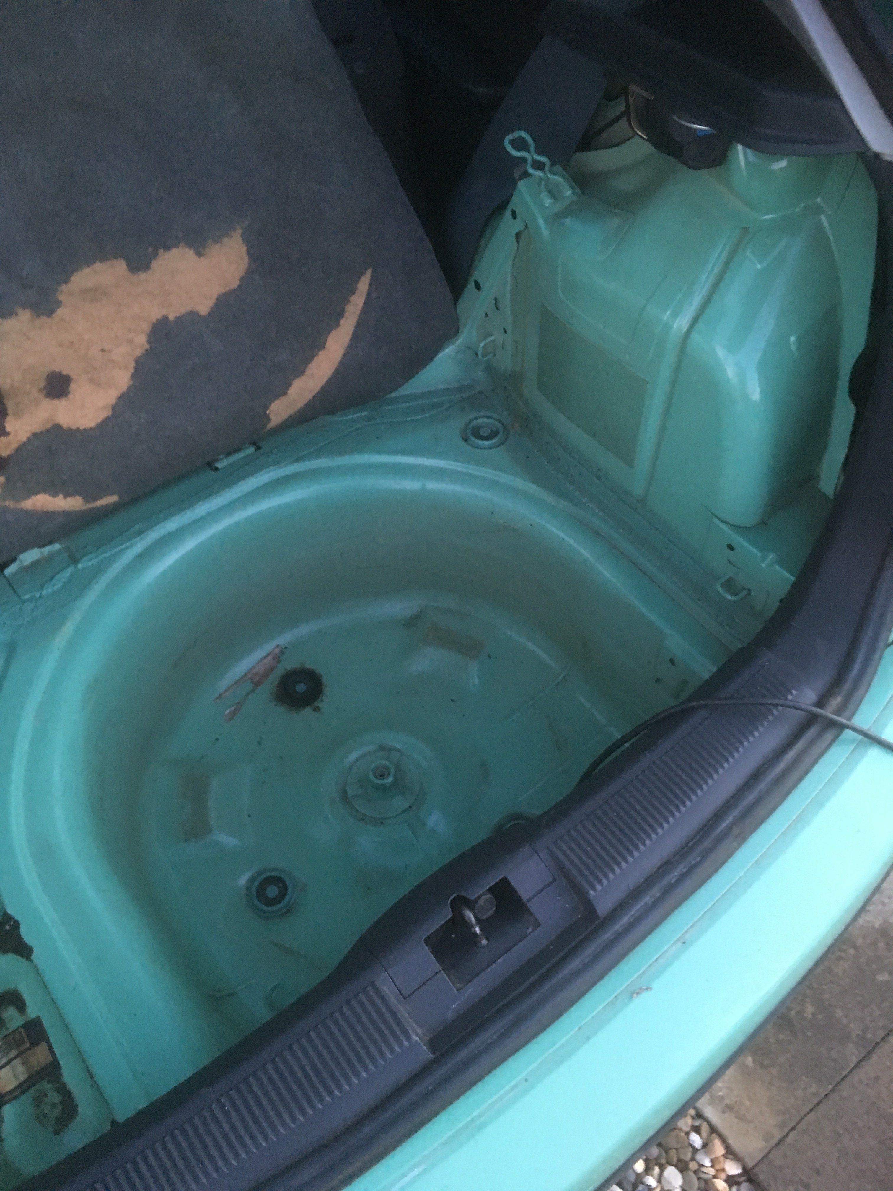

The silent coat sound deadening arrived so made a start on the n/s door and did the boot. Unfortunately the components out of the Ibiza don’t fit as they are too deep :( so I’ll look out for some more.
Also fitted the 16” spare and tool kit out of the Ibiza as it was missing on the fab. I’ll see if I can get another boot carpet as the reinforcement is missing too
