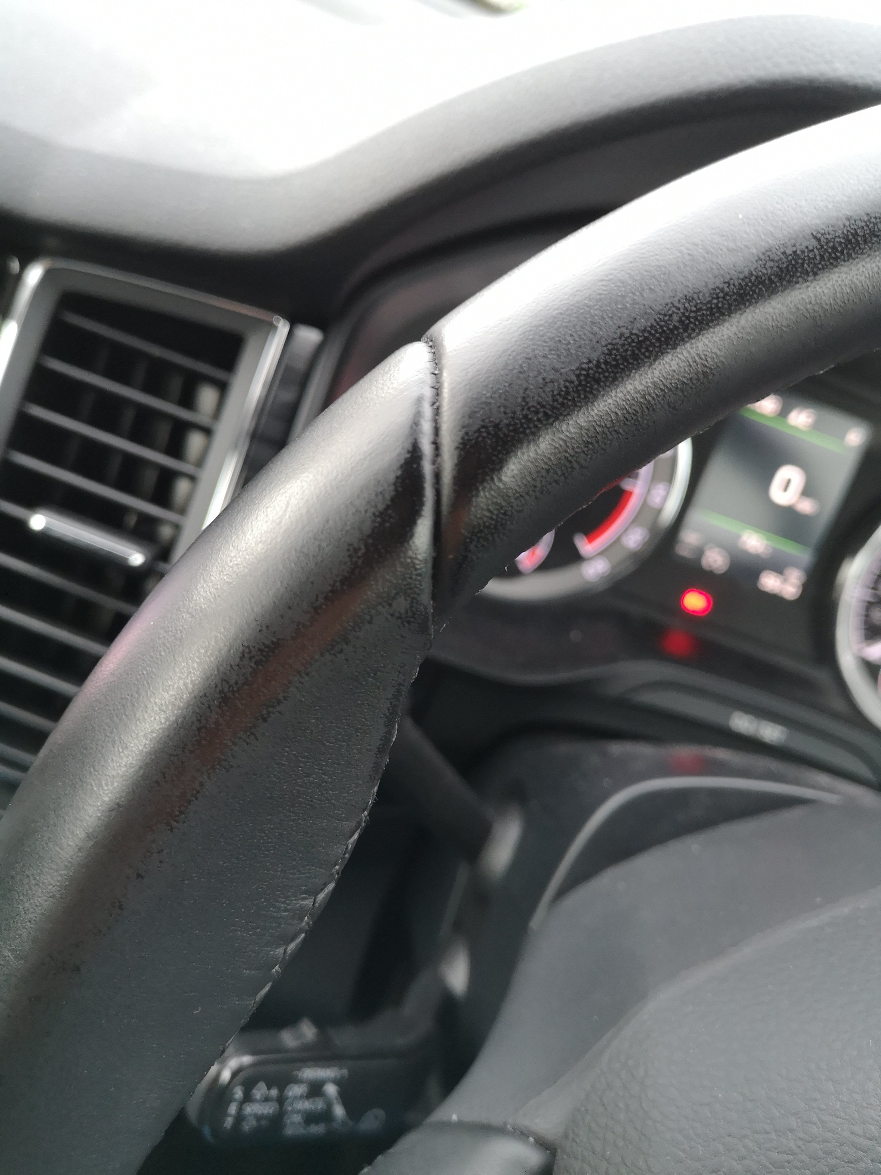

There have been a few complaints around premature wear of the leather steering wheel on a few Kodiaq's.
All have been replaced under warranty, Skoda acknowledging they had a bad batch.
Might be worth keeping an eye on yours...

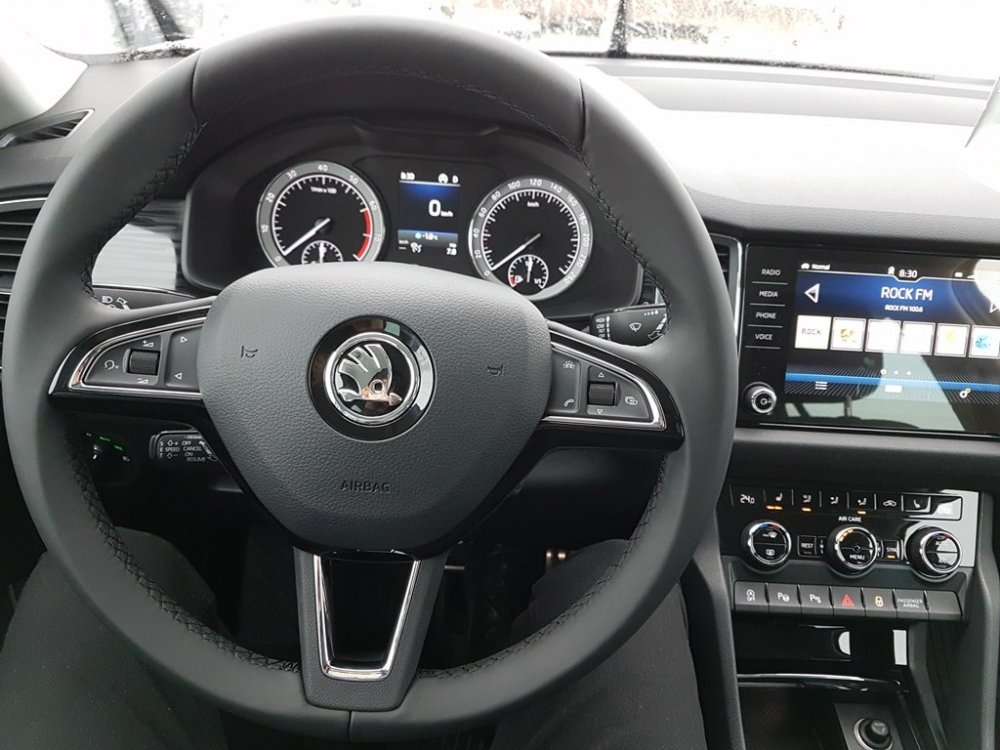

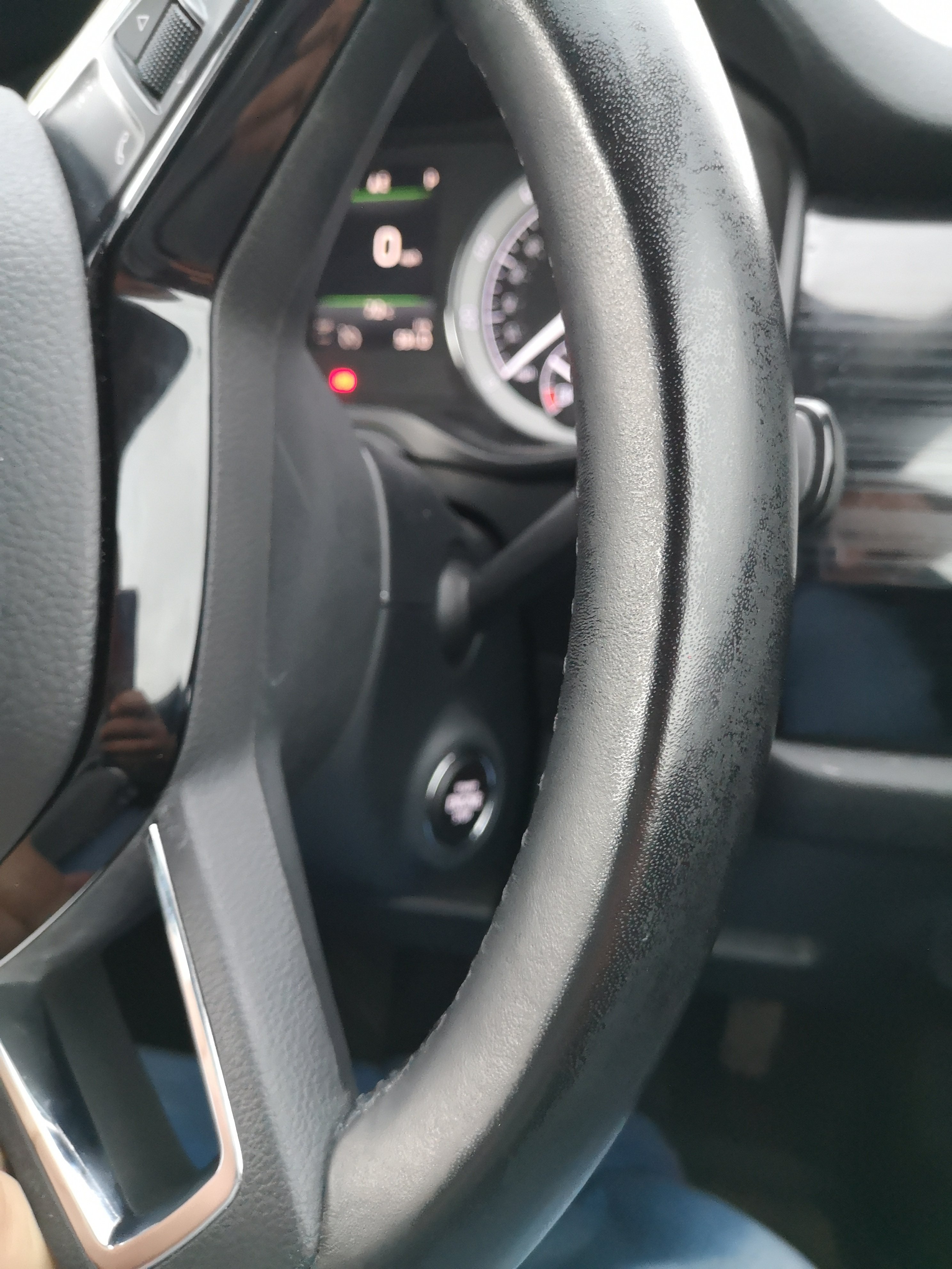

Fixed under warranty...
20180323_082941.jpg.0360c7cc107f997e47786ff55048b953.thumb.jpg.acd6cfffbcf2c087025e79c80a4f21b4.jpg
Excellent, mine has worn badly at the '10 past the hour' wheel position. The matt effect has worn away to reveal shiny, darker leather beneath. My car is in for chrome window trim replacements - under warranty - soon. I'll be sure to highlight the premature wheel wear. Thanks for the heads up.

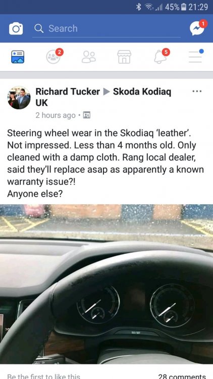

Skoda issued a TPI for this manufacturing defect.
It only covered a certain production run though.
The complaints so far where owners have shared photos show a consistent pattern to the wear, a similar look, feel and location.
If your dealer is rejecting the claim then there must be a reason for it, have you mentioned to them the TPI?
If they know of the TPI and are still knocking back your claim you need to ask them on what grounds.
Take some photos and post them for us to see.

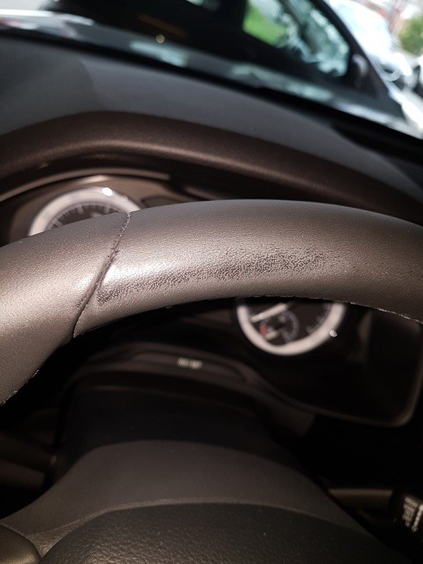

Hi guys this is my steering wheel and Derek slacks on the a66 refuse to change it under warranty. He said if he gives me the new steering wheel and then send the one off my car to the warranty team they will send it back saying it's wear and not warranty leaving him the bill for the steering wheel he would of gave me.
On the other hand getting the chrome around the window changed under warranty for the mottling effect or something like that he called it
That is a clear warranty claim.
Derek slack's response, whilst accurate is a weak excuse. They first need to get approval from Skoda UK. Skoda UK almost always side with the dealer, so this is a classic case of Derek Slack not trying hard enough on your behalf.
Time to involve Skoda UK customer services. I know you've spoken to them already but you need to make clear to them that others are getting this clear manufacturing defect / substandard quality resolved under warranty.
