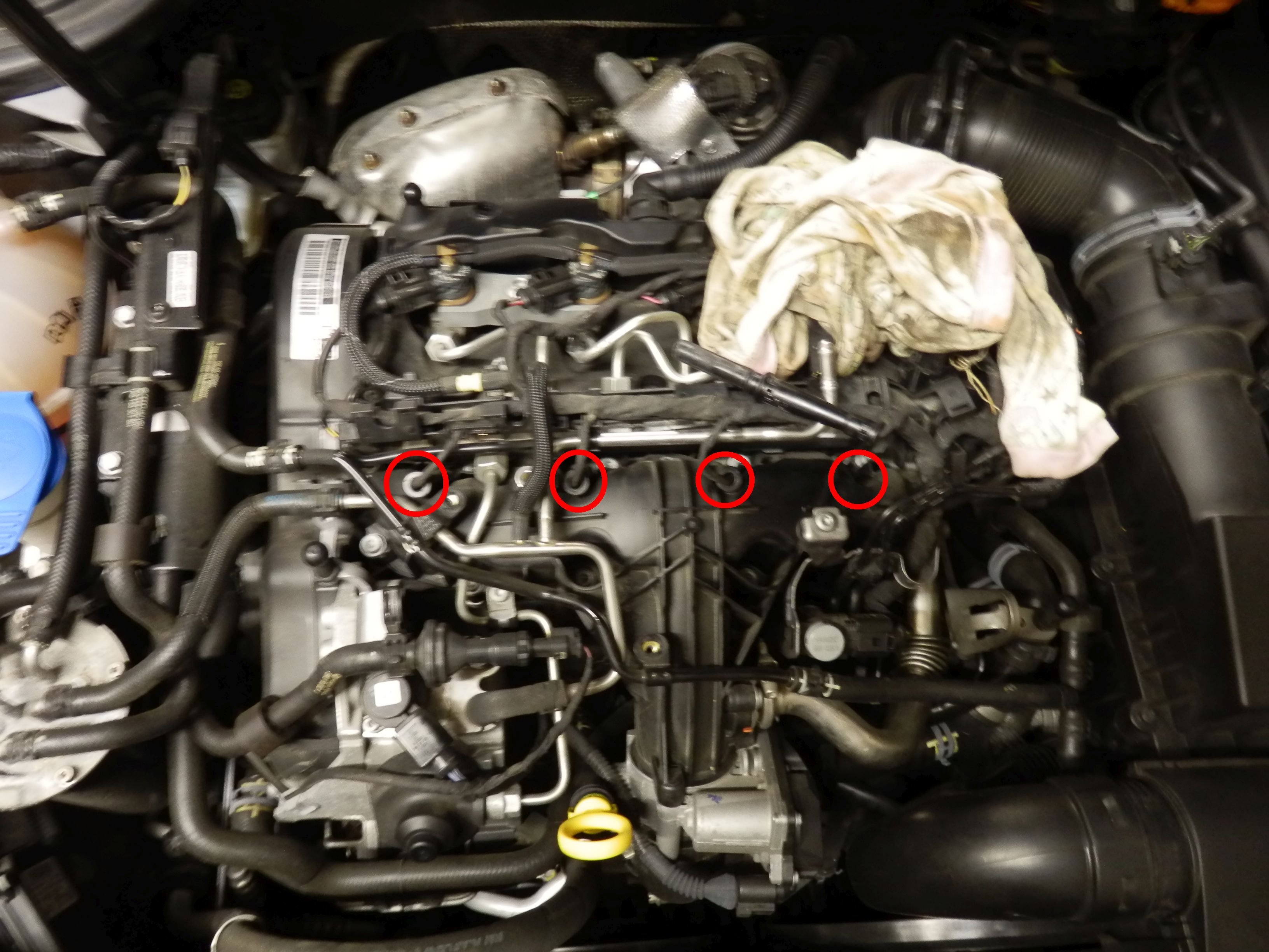

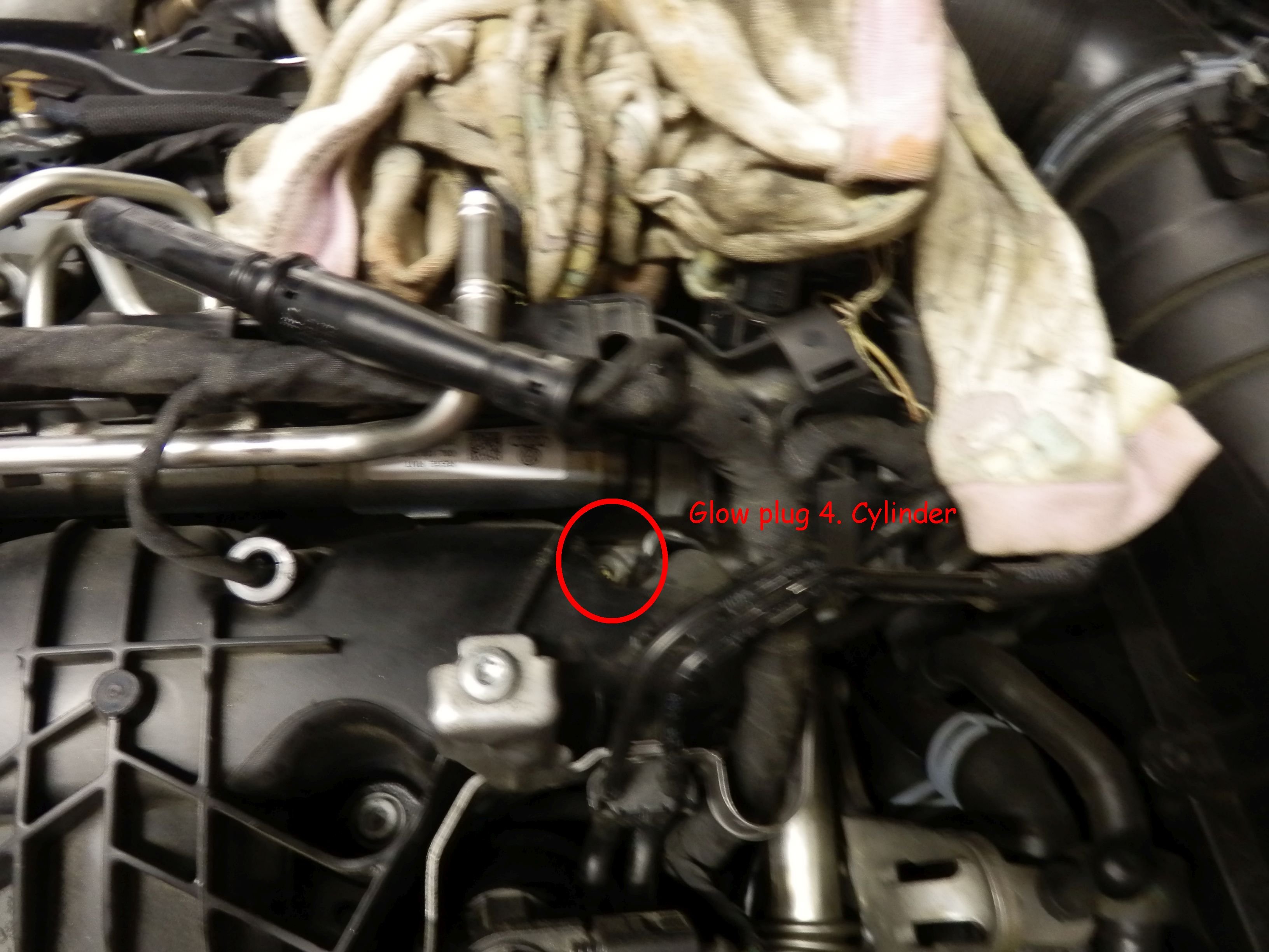

These are the glow plug sites. My faulty one is on the 4. cylinder.PB172999_1.thumb.jpg.d7d27bce4a9675c32698466fa6e696e4.jpg

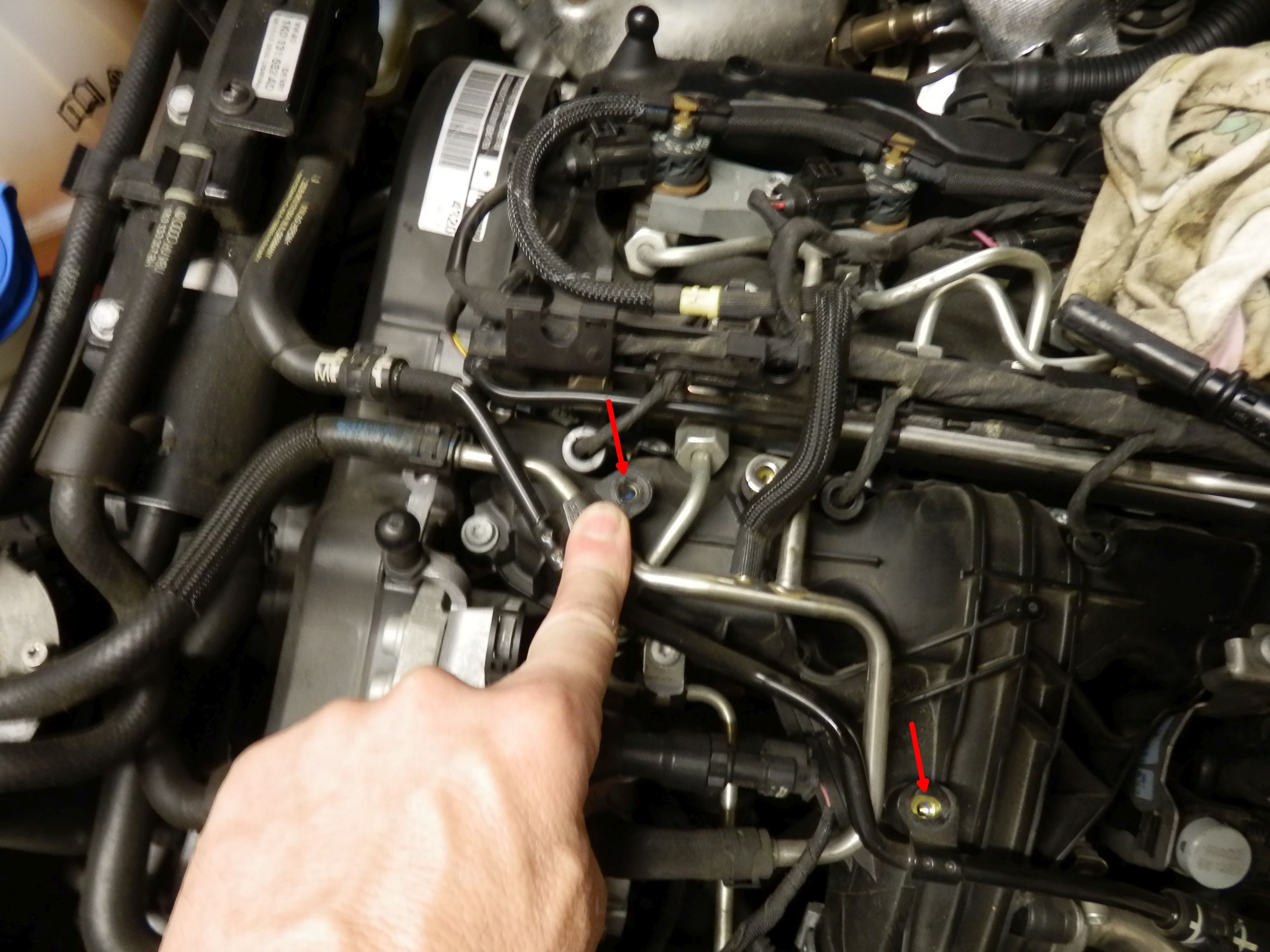

To get to it or any of them you have to remove 4 T25 Torx screws.

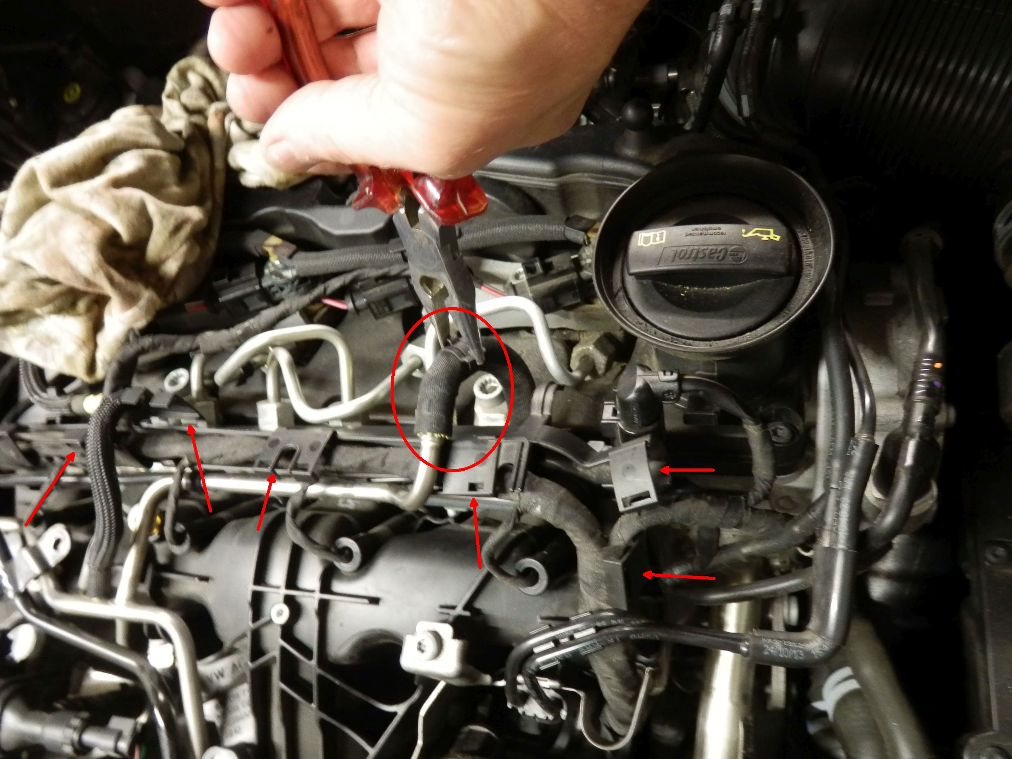

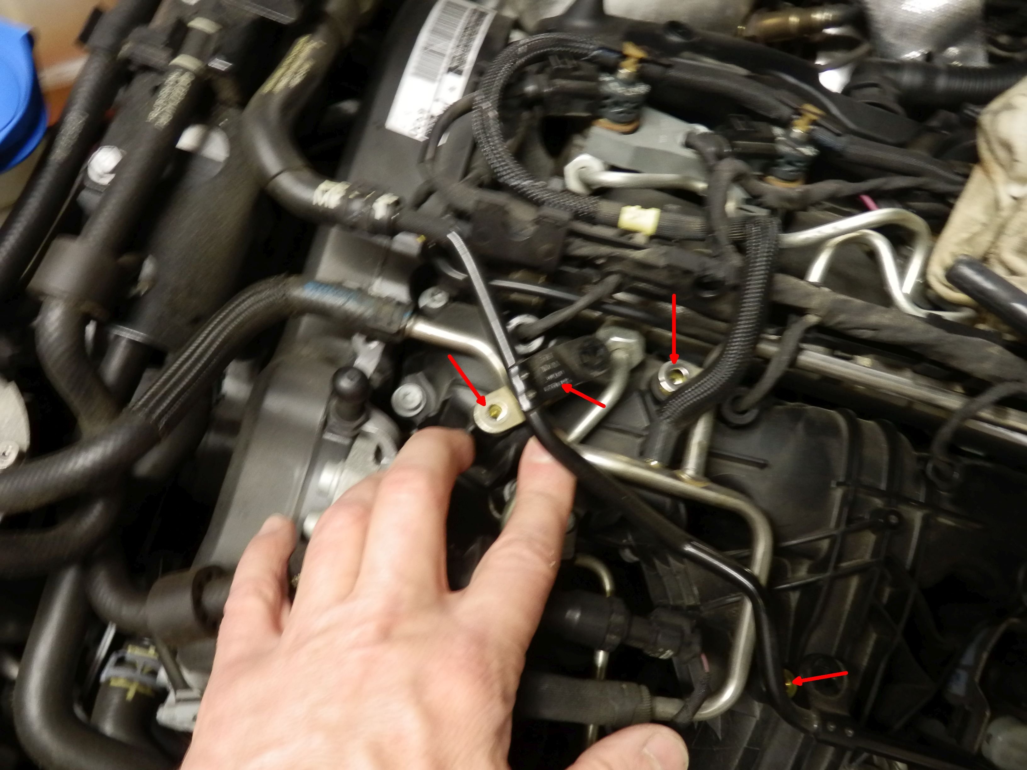

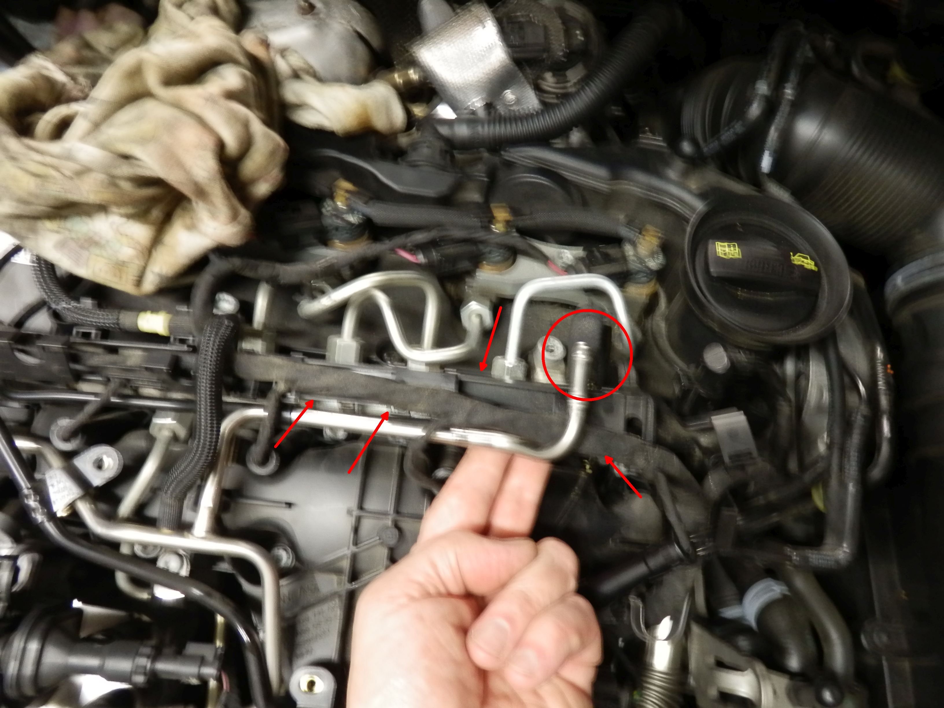

and open clips and disconnect the fuel return pipe in the next picture to be able to lift pipes and wiring to get to the glow plug.

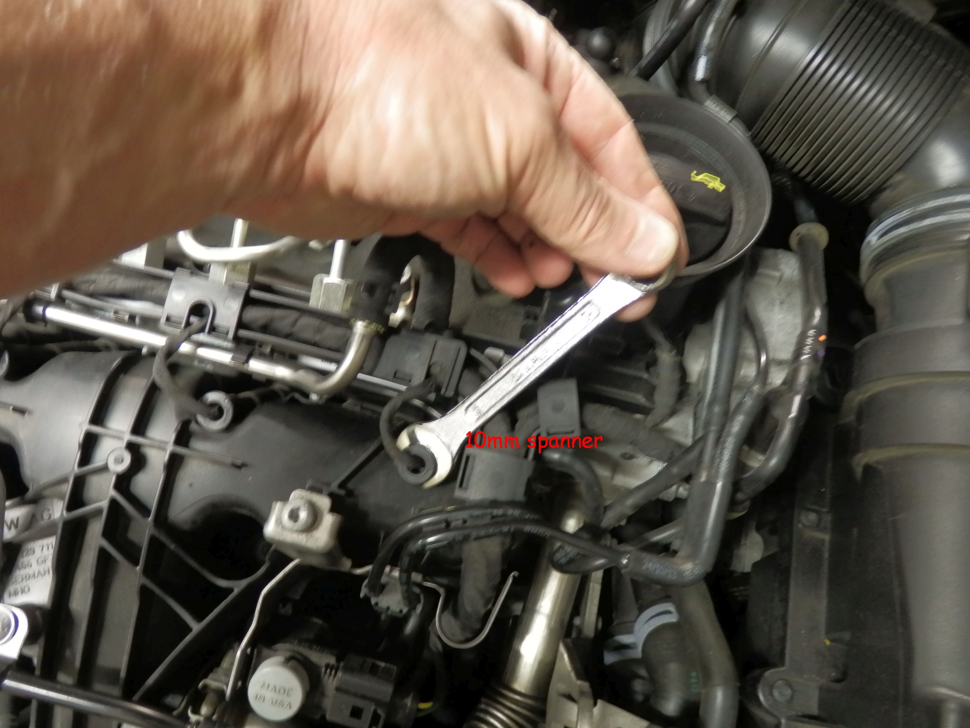

Use a 10 mm spanner to lever the connector off the glow plug.
I wanted to remove the glow plug as shown in the link in the previous post only to then realize that my 1/2" socket set was too big to get into the gap.
I then had to get a 10mm long nut on a 3/8" extension. I measured the old and new glow plug: old way above 5K Ohm, new less than 1Ohm. Fitting is reverse of removal. VCDS reported no errors.
