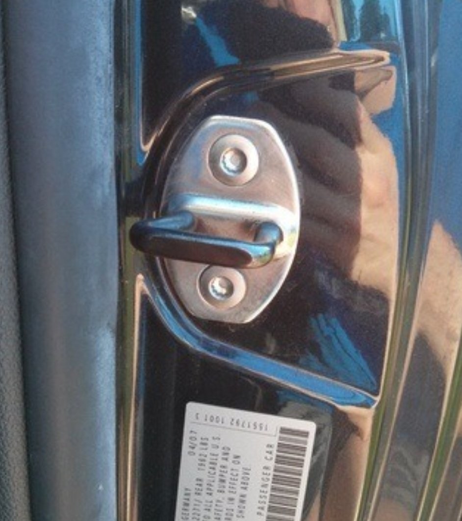

Screenshot_20181017-192334__01.thumb.jpg.6c828dc4f9954ee5786e51a31f96ab29.jpgTry loosening the stricker a turn and tap it in a bit only a few mm with your socket end, retighten and try tikl it sits right

Thanks seems simple enough to do, I’ll give it a go and hopefully avoid a trip to the garage.
Yep 2 torx screws, only loosen ever so slightly, dont want to move it up or down just inwards a couple mm
