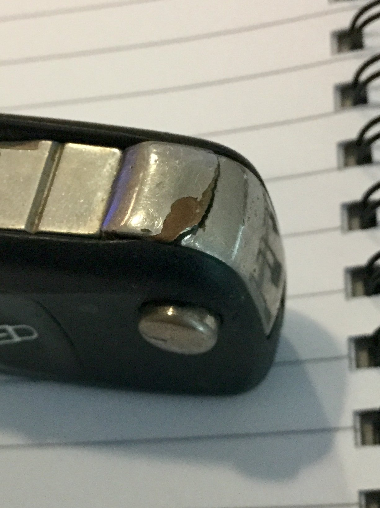

Both of the flip keys for my Fabia have failed in exactly the same spot, meaning I've had to superglue them back together.  They must be made of cheese because the minor repeated stress of flipping the key open causes a crack on the shoulder where it meets the fob and when this breaks away, the key blade falls out.
Is it possible to buy just a new blade & pivot to fit back into the fob?
I'm not keen on paying dealer price of £140.89 for each new key.

I don't think a new blade is required.  I had to get a spare for my Octavia a good few years ago and IIRC the blade is screwed onto the pivoting/sprung part of the fob by a very small screw.
I *think* all that's required is the front part of the fob which has the metal 'elbow'.

So buy this:
https://www.ebay.co.uk/itm/Replacement-3-button-flip-key-case-for-Skoda-Octavia-Superb-Fabia-remote-fob/391926290780?epid=1349371852&hash=item5b40a0995c:g:3m8AAOSw1DtXK8UT
Take your existing key fob apart and retain the blade and back part with the buttons/battery/gubbins/coding then screw the blade onto the front part of the replacement key and then fit the rear part from your original fob.

Thanks for all the replies.  I've found this place near me which can do a replacement blade for £12.50 so I'll give them a try during the week.
http://www.carkeycentre.co.uk
