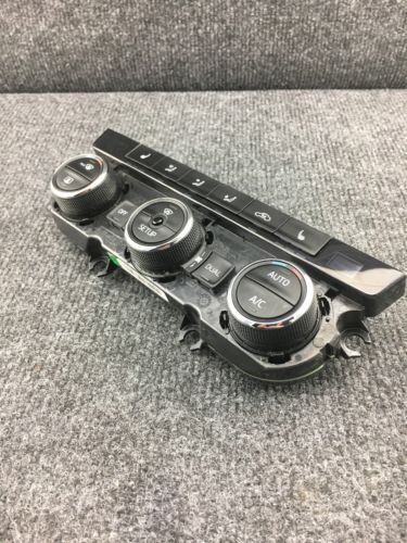

Can anyone help with some advice on retrofitting vRS heated leather seats?
I have purchased a full leather heated seat interior and the climate control heated seat switch (5E0907044N, see image below) but I need some advice on how to connect the seat plugs to the climate control switch. I presume there is a specific loom but I have no idea the part number or how to fit.
Any advice would be greatly appreciated.
Thanks JohnnyType2.
The seats are being delivered tomorrow so I should be able to match up the comnectors to the wiring diagram :)
