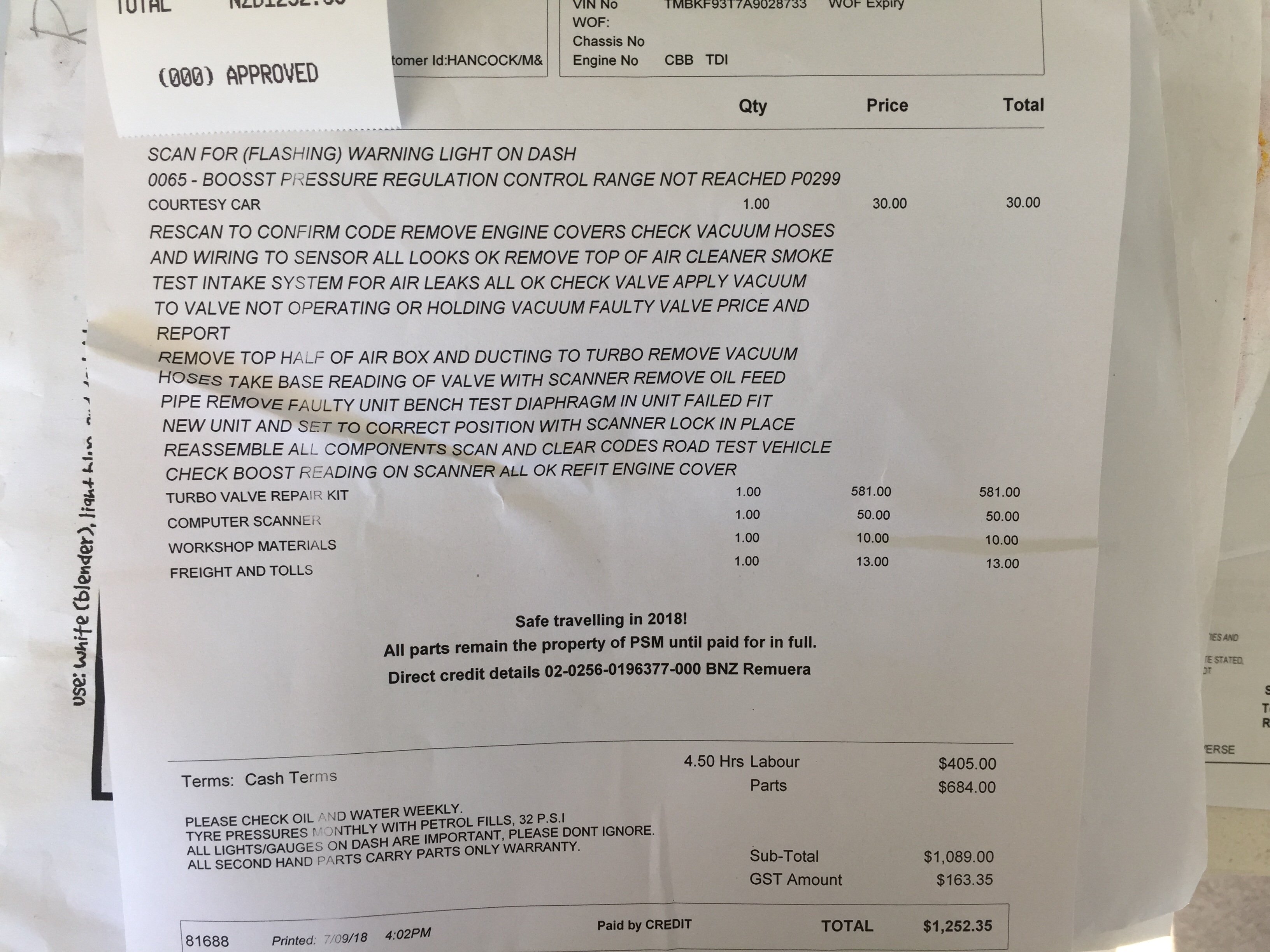

The actuator diaphragm failed in ours last month (same symptoms) .  Good luck!
According to the invoice on the post above yours... $1,300 NZD, or £645 GBP.
