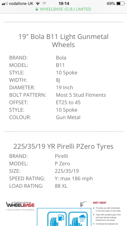

Hey all, I have asked these question separately before but can’t seem to find the thread. After winter I’m planning on lowering my VRS , going 19’s , H&R springs and spacers also.
People Les who have done this before can I get some advice what’s best, how low and what’s size spacers, I have a family of five, well three kids and me and the wife so car is full all the time. Don’t want any issue with arches and scraping.
attached the wheels, offset etc
any helps or pics please, thankyou

Normally 15mm on the front hubs and 20mm on the rear for the spacers. My rims are 8.5J with Michelin PS4 S tyres in 235/35R19 size with ET45 offset. Carrying upto 5 people I wouldn't go lower than 30mm drop to be on the safe side.:)
i have 15/20mm spacers front/back, running 19"s on -40mm H&R springs, I frequently load u the car including the wife and kids and a full boot with no issues
