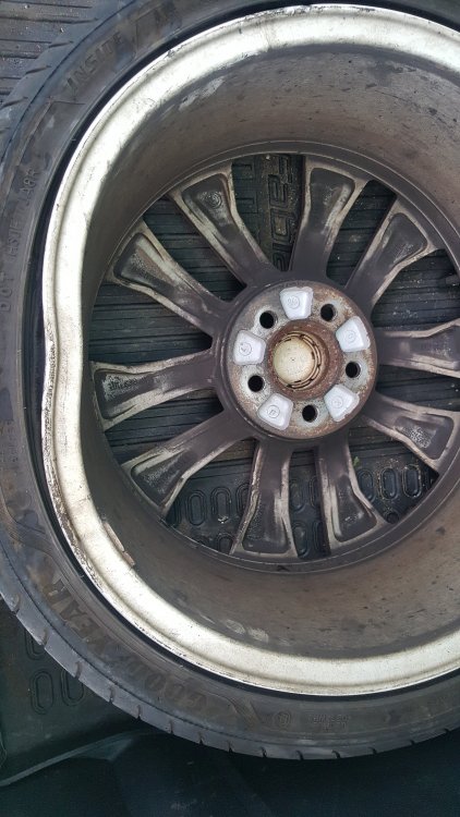

Mrs T was driving home, hit a pothole and this was the result. Car was travelling at about 60mph and the pothole was close to the centre line of the road, probably about 7cm deep. That is one seriously ****ed wheel! Lincolnshire roads are extremely bad and littered with potholes so dodging them is an everyday occurrence. Unfortunately she just didn't see this one coming!

Good news - looks like the tyre is OK!
Bad news - a new wheel from Skoda is £240!
If there's that much damage to the wheel. I would be very doubtful that the tyre is reusable, needs inspecting carefully on the inside.
I'd expect that there will be some associated suspension damage as well, if it was the front, the chances of damage will be greater as the load of the drive train is on these wheels.
I'm not sure if Fabia MK2 got the new "older" design of TCA rear vertical bush to replace the previous voided horizontal bush, but if it has, I'd think that that bush will now be torn.

Having bought a new wheel and 2 new tyres I took the car into the garage today to have them fitted and 4-wheel alignment carried out. Everything was going well until the technician came out to see me and said "I think you need another new wheel". Yes, the rear was ****ed as well. I don't know why I hadn't thought of checking the rear but as it was still holding air it simply didn't occur to me. He took me through to the workshop and underneath the car and as soon as I looked at it you could see it was not round. The wheel had aligned fine (the damage to both wheels is on the inner lip) but had noticed a vibration on the test drive.
So, another new wheel has been ordered and the bill so far is now in excess of £600!
