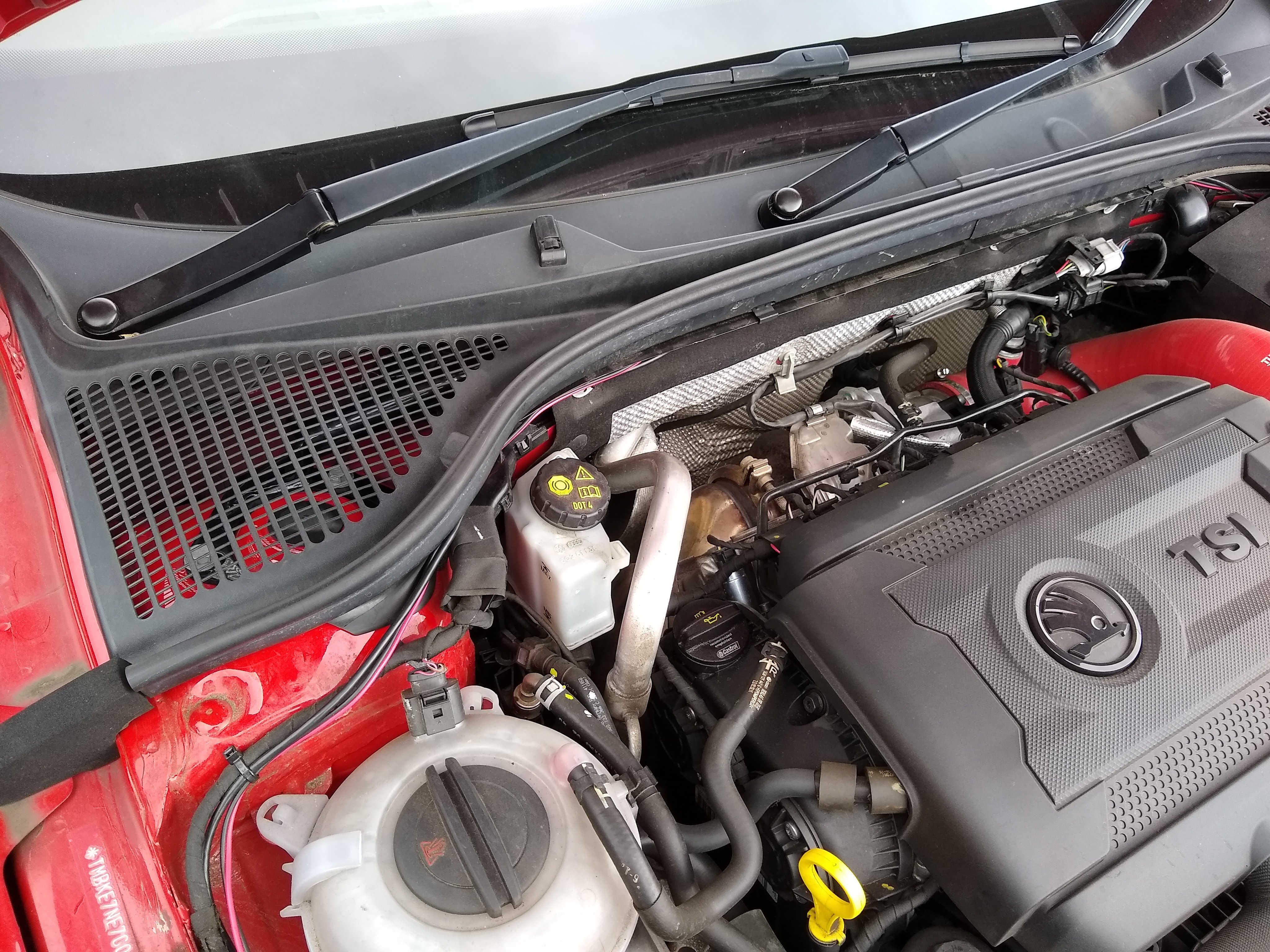

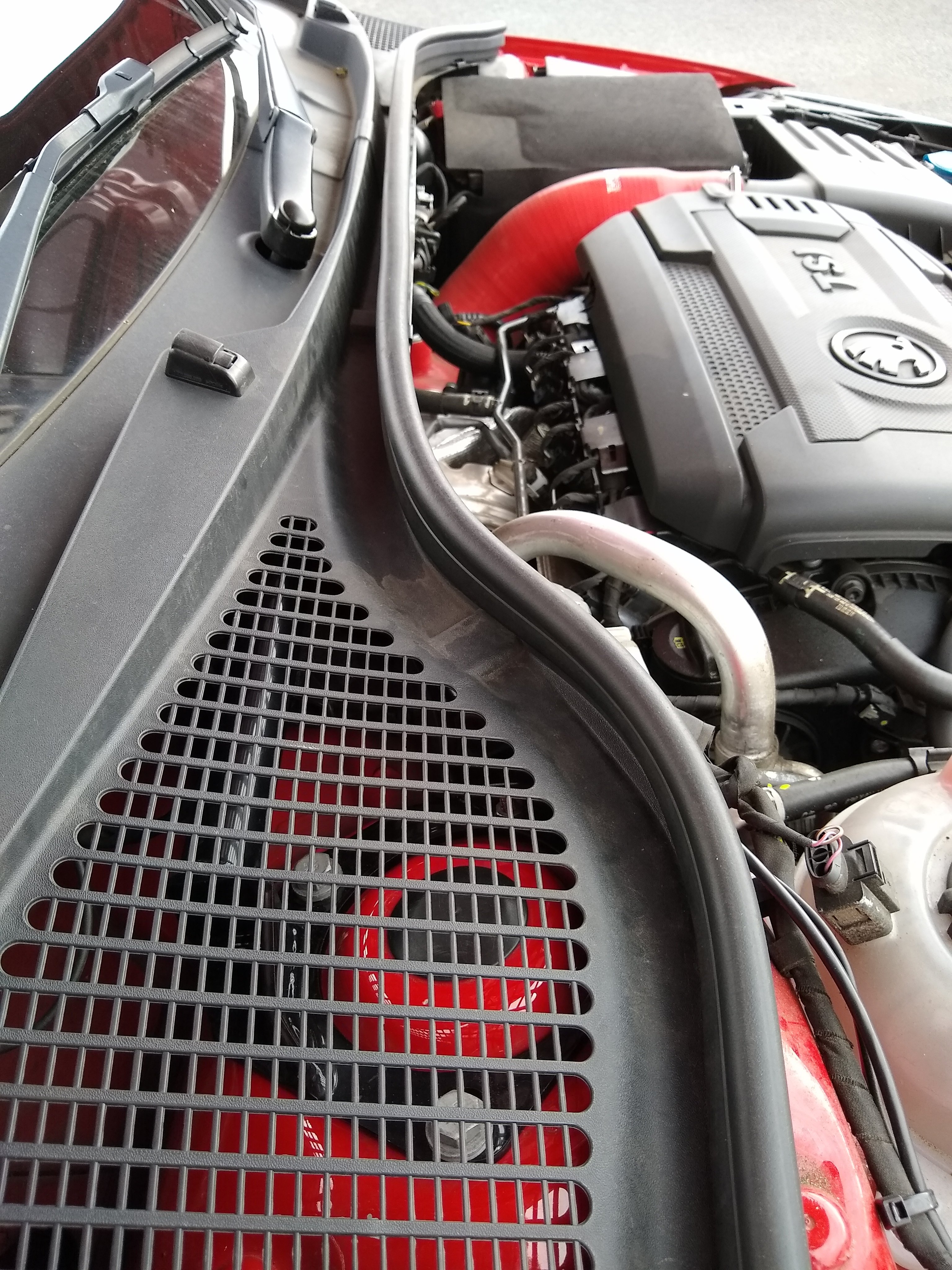

sorry there isn't too much to see - strutbrace is hidden by the plenum cover, i've no ramps for photo'ing the arb kit and i think i have posted the shortshift gearknob already

couldn't work out corresponding corrida red  paint code from the paint codes he uses for powdercoating so got it in black - it's not visible anyways  so not a big deal. fitting was tricky and needed a friend to save me when the suspension shifted out of alignment from the turret holes. ill try and get pic posted tomorrow. i was able to do it without removing the wiper arms (as i couldn't get them off) by removing the rubber bead from the plenum cover and a few clips and just bending the cover upwards

wheels were on level ground. when i removed the 3 bolts on either side from the suspension turret the suspension underneath shifted very slightly and screw holes no longer lined up. when i jacked up the car then the whole wheel spring and shock fell sideways :( I need a spring compressor and another set of hands to line it all up and secure it.
