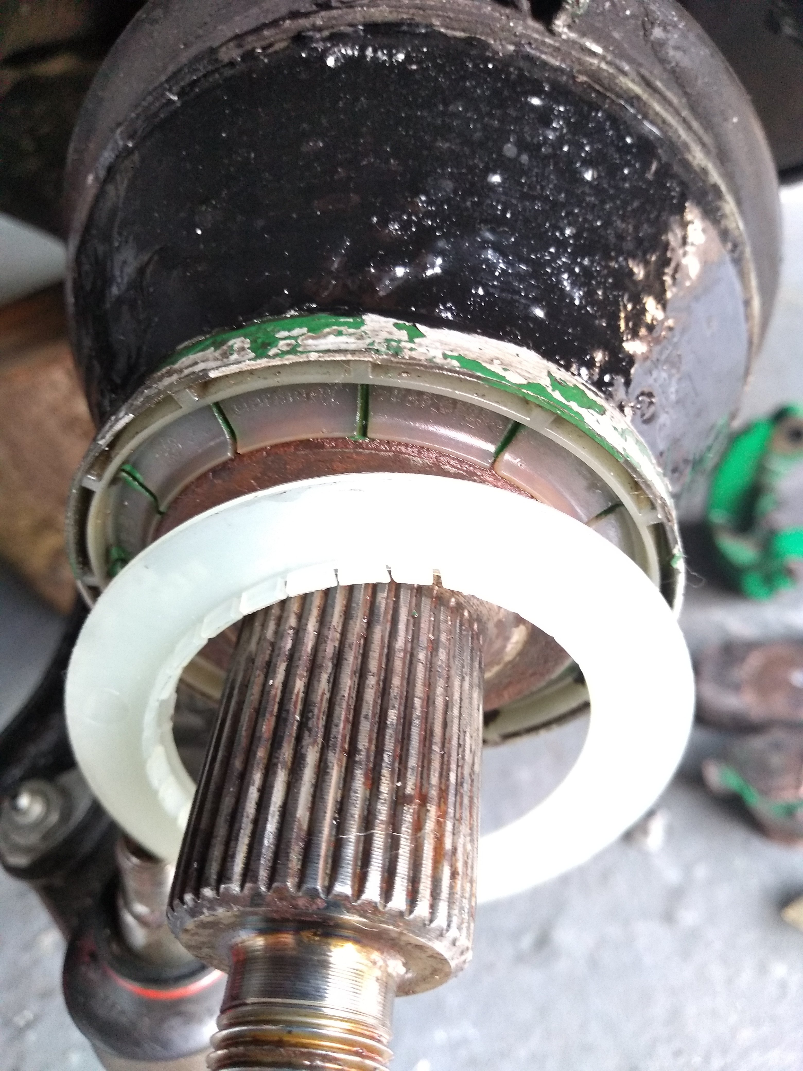

Wino, is this the plastic dust seal? Looks similar and FAG wheel bearing hub kit came with it and new 35 multipoint nut.
Thanks

Yep, that's the seal. The bit it pushes onto will probably need a fair amount of de-rusting, take some photos when you get there please. It's good that it comes with the bearing kit, I didn't know that.

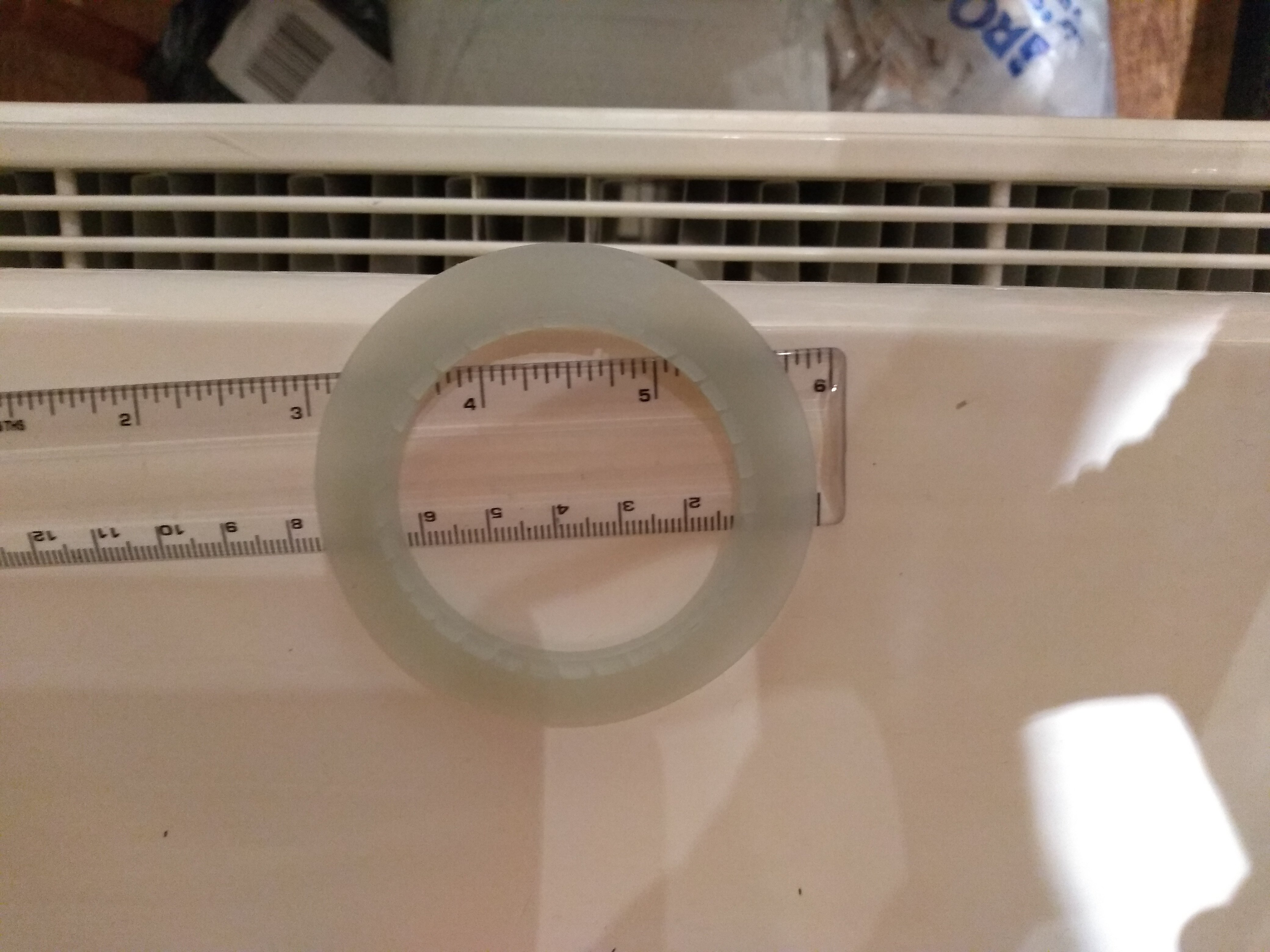

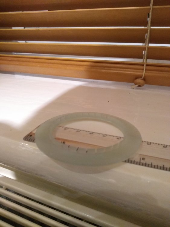

The only surprise was the plastic ring at end of CV joint that could file down abs sensor. It was slighly different design to one supplied with wheel bearing kit. I left old one in place as it was in good condition.
I recommend buying a new one from dealer for anyone replacing hub wheel bearing. Diameter was almost identical, but 2 mm bigger diameter.

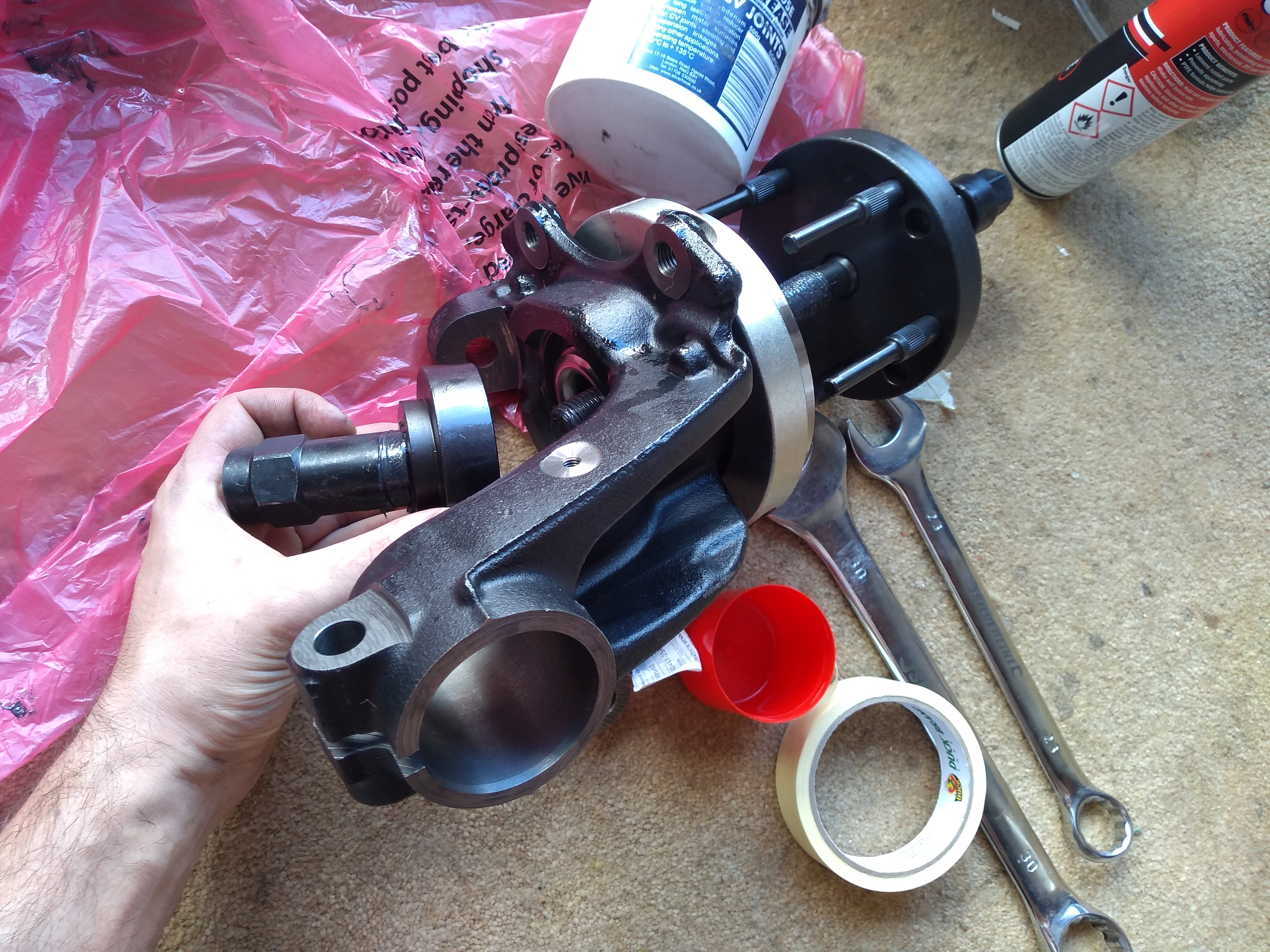

Gen2 wheel bearing kit , non LASER , cost £40 . It is 72mm hub kit. The dealer wanted £50, but I would had to have bought a £125 wheel bearing.
As I bought a new hub housing, all I needed to do was press in the bearing. Far easier job than the rear axle bush I did last year.
I have a set of tools I can use on other wheel bearing if it goes.

Have replaced both bearings (original FAG to aftermarket FAG) few years ago and didn't used that included dust seal.
Maybe, it's mentioned for another car, which uses same bearing  (??)
Just cleaned grooves in old plastic (grey-green item in photo)- and that's it.
For replacement used self-made tool, which looks like half-plates No.3 and big tube No.2 (like VAG original tool).
It's bit different than another execution from Laser, SKF etc, which uses pins (in photo from bmbmdmb).

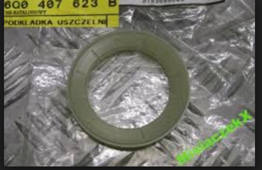

Not sure which models will have the 6q0407623e dust seal versus the one you guys have found, I can't spot another type other than a smaller one in the parts catalogue so far but I have vague memories of having seen reference to a green one.

White=new=thin seal is included in FAG bearing set.
Old=grey/green=fat :-) is original > mine looks same and both drive shafts are still original from 02/2007...but have no idea why to touch original seal if it looks ok.
It could be 6Q0 407 623 B   but in Google can't find exact photo for ID with "B" in the end :-/
  • Sponsor
That part number looks right to me, and was superseded to the E suffix in 2008 after all mk1 Fabias had been made, so that fits with your info. :thumbup:
