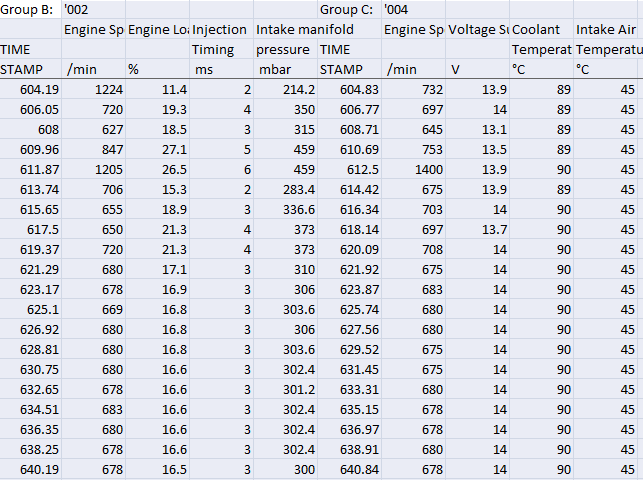

Can you log MAP sensor data (pressure and temperature) with VCDS?
Edited by Wino
  • Sponsor
Intake air temp, not coolant temp. Sensor is combined with MAP in same 4-pin module.
OK
Hmm. I don't know what I'm doing. Log for how long, when driving, idling, reving on the drive or what???
This was on the drive, up to temperature, and a couple of dabs on the accel pedal.
Has this shown anything or should I do some defined routine?
  • Sponsor

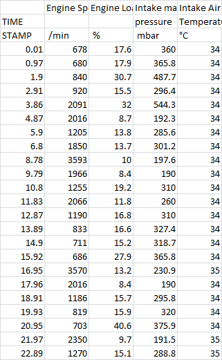

I'll see if I can find something to compare with from my logs. At first glance the pressure reading seems to jump about more than I'd expect.
Did seem to leap around. Snap throttle produced momentary drop to 700+. VCDS gives 200 to 420 as the range but I assume that would be for steady states? Or maybe it should never go outside that range and it does both below and above. Might be time for a new sensor but they are not cheap and I would take your advice on that.
Temp sensor matched CTS when cold and did sensible things so that part is fine.

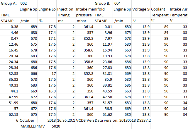

I think that range would be for idle. Mine sits pretty solid at 300mbar at idle when fully warmed up.
Can you get another data set where you just leave it idling for a few minutes?
I didn't look closely before I posted about it jumping around; the rpm is changing a lot at the same time, so you'd expect pressure change, is that all you on the go pedal though, or is the engine speed moving about on its own?
All me. Idles at a steady 680 when hot. I will do an idle log.
  • Sponsor
Here's a snapshot of the last bit of a 10 minute journey in July, looks like I left it idling for a few seconds just before I stopped logging.
I note it did report 459 probably while accelerating so going outside limits briefly is probably OK. Pretty sure mine will look much the same ruling out the MAP sensor.
There's a minute of idle. Did a quick TB & EGR adaptation which didn't make any difference to the figures.
