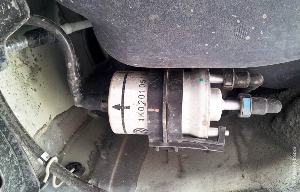

I think the issue is definitely from the back end, there's what looks like a white canister next to the fuel tank which am I right in saying is a filter?
I can actually feel the fuel line coming out resonating in sync with the vibrating sound. Has anyone heard about the before and would a simple filter change sort this problem?

This is an in-line filter am I right in saying? Or is this the Carbon evap can you said about?
46 minutes ago, Offski said:
So check if it is the fuel filter, or is that a Carbon Canister on a 1.2TSI.  I know nothing about those engines.
See pic I just uploaded, is that a filter or evap can?
That is the fuel filter.
Edit:- well it is a petrol filter and fuel pressure regulator all in one, the 3rd pipe is the excess fuel being returned to the tank.
So, if that is making a noise, it will probably be the pressure regulator that is doing that, but why, faulty low pressure delivery pump, faulty fuel filter assembly, or a pipe not clipped into place correctly, or like wise the filter assembly, though it looks like it is fitted as intended.
