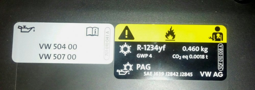

Yes look for QI6 in owner manual spec sticker or boot sticker. My car (1.4 Superb) even has a 504.00 sticker in the engine bay

Afraid nothing so clear apparent in boot or bonnet (nor stuck to manual). I have the yellow and black sticker under the bonnet however, but that doesn't seem to say much?? Certainly nothing with 'Q16' or other Q code apparent.

The boot sticker should be under the false floor stuck to the metal chassis and have a bunch of codes listed on it. Q16 is variable servicing intervals which would confirm the oil should not be 502 spec.
