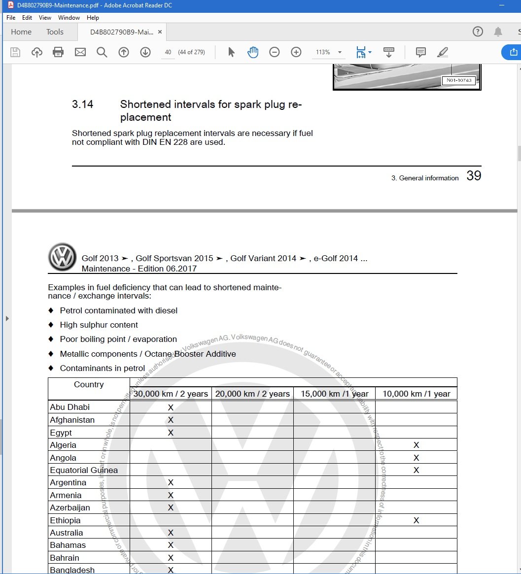

I quoted direct from the Maintenance book..& yes its for the MK7 Golf....However the tables apply to all VAG cars if that service item is on them....whether the dealer does it or not is another matter...
JPEG of the relevant section:-
Edited by fabdavrav
Interesting.
Our fuel certainly has higher sulpher levels with the 95/98 octane max at 40ppm (en228 is 10ppm) but other than that it is not too bad. I wouldn't expect it to near halve the life of a decent set of plugs.
Our 91 octane is a different matter since that minimum is 150ppm but no self respecting vw group vehicle owner would touch it.
You answered your own question.....your lowest spec of fuel available to anybody has high sulphur content...so VAG adjust the service intervals for that.....they cannot be 100% that the cars owners are not going to be "but no self respecting vw group vehicle owner would touch it.".....
