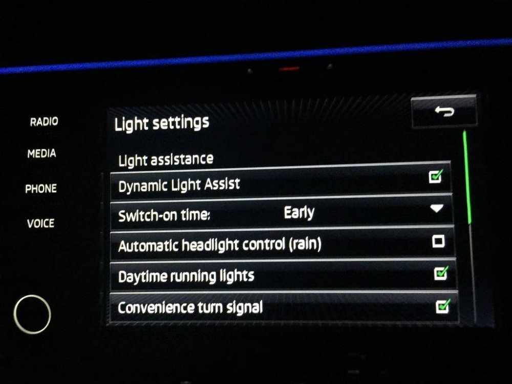

I have a friend with VCDS but he hasn't used it on a Superb (67 plate 1.6tdi DSG) Just looking for advice re procedure , Thanks in advance.
It's among one of the simplest VCDS changes.
https://www.briskoda.net/forums/topic/380829-superb-mkiii-vcds-adaptations-tried-and-tested/?do=findComment&comment=4460928
The VCDS channel numbering has changed since the post but the adaptation is still there (either scroll through the list to find it manually or enter something like 'Tagfahrlicht Aktivierung' in the search field to limit the listings).
You may need to lock the car after changing the adaptation before the DRL option appears in the Lights menu.

As above. Is it not already an option in the car menu?
No the
No, the option of light asistance is not able to be accessed even though it appears on the screen.
9 hours ago, GoneToBeemer said:
Come to think of it, I’m sure my O3 had the option to do it in the infotainment? Can’t remeber though.
as @BillyJim stated earlier - it needs to enabled/coded in the Superb, then you'll get the option in the infotainment.....
It has been available on mine since new.
