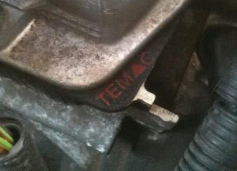

Have a look to see if your engine has the modified head gasket fitted. If it has there will be the letters TEMAC in red on the front right corner of the gasket.

Wondering if you checked if it has the TEMAC gasket? If it hasn't it might help to explain why it's gone. The TEMAC ones can still fail of course but less so.
