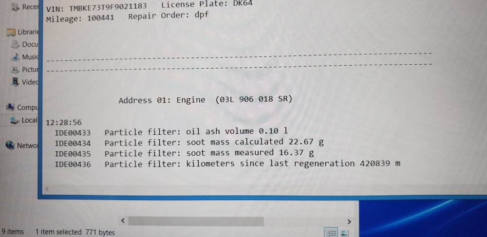

Hi all, playing around with vcds and screen shotted dpf numbers. Are they ok ? They seem low(good i hope), but i have no idea what bad ones are. Thanks again
Dave
Nothing out of the ordinary.
With those soot mass values, it'll probably do a regeneration soon which fits with 420km since the last one.
Oil ash volume is the value that determines the lifetime of the DPF. It's suggested that the max is ~175ml but these is nothing official from VW/Skoda to confirm it. Based on that, the estimated lifespan for your DPF is currently 175k miles which is certainly within normal limits.

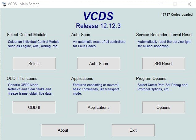

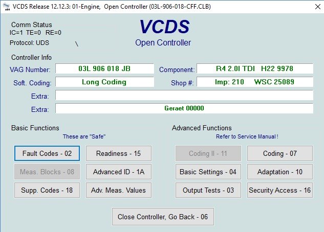

What's the VCDS procedure to view the data?
My 2011 Superb is on 153,000 miles so I'd be interested to see the DPF's oil ash volume on my car.
It's in advanced measuring blocks on the engine controller.
Umm, I'll need a little more direction :tongueout:
From here...
To here...
Then here...
"Meas. Blocks - 08" is greyed out, so I hit "Adv. Meas. Values"?
I'm guessing I took a wrong turn at some point...
Think thats right. Scroll down and youll see the dpf bits, tick them and another box appears with selected ones in.

You're spot on so far: scroll down the list and you'll find a bunch for the DPF. Check the box for the ones you want to read.
