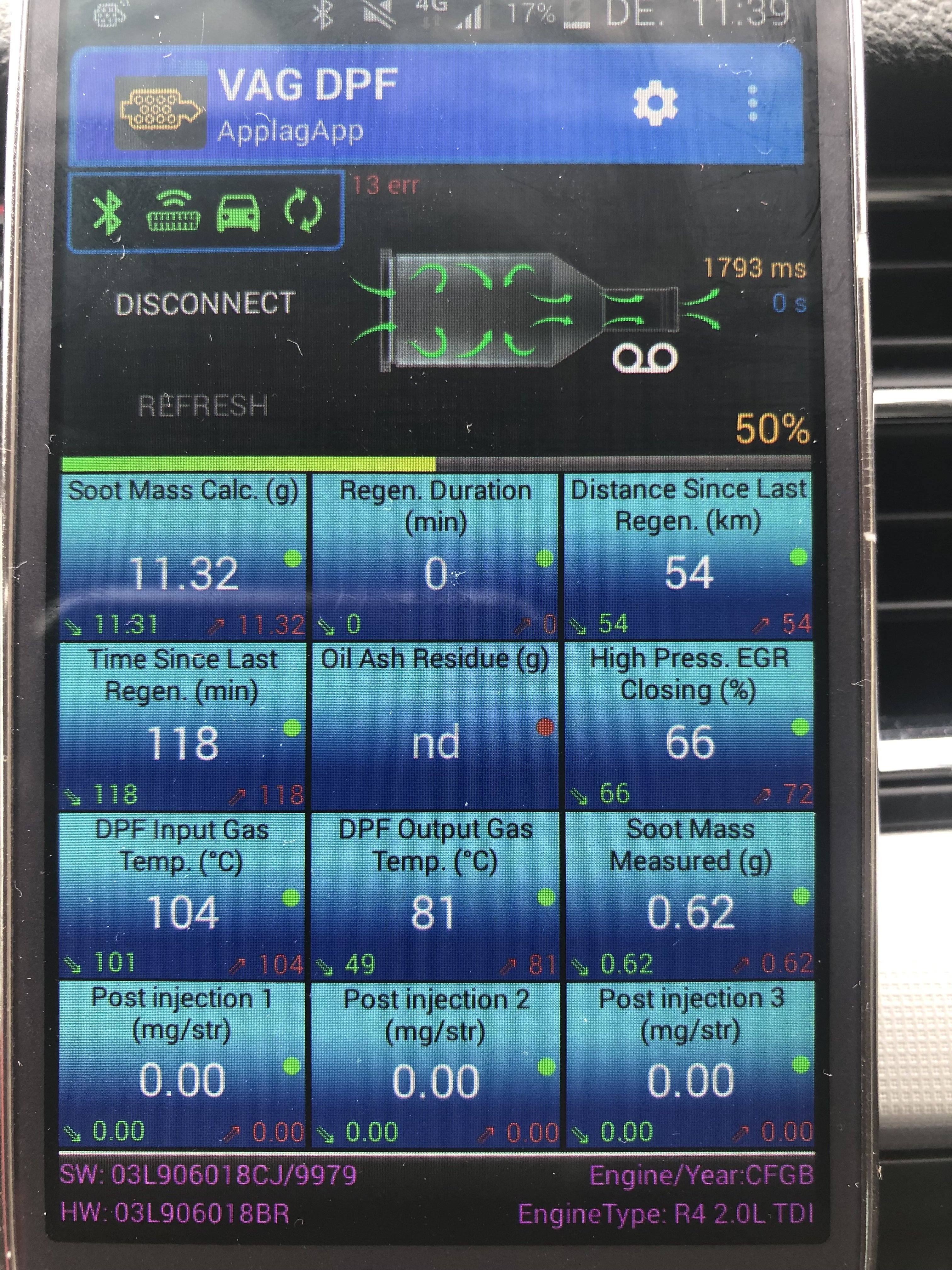

Hello Everyone,
just started to use vag dpf, and its quite cool and useful, however i have some interesting data.
when i used first time, it was at 90%, then i had a regen at 100%. Clearl showing the app what is happening. It was like 120km after the last regen.
But then , after some days and after 50km, i am on already at 50%, means similar like last time i will have soon regen.
Does it mean start to became full the system or is it just simply the fact of city driving each 15km?
and btw, why the oil ash is not shown for me?
i have around 205k km.
"btw, why the oil ash is not shown for me?"
Try touching the "Oil Ash" section on the screen.
HTH.

13 hours ago, Juhagpl said:
Hello Everyone,

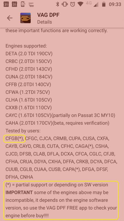

Clicking on the Oil Ash residue display might make it read correctly but on mine, if you have values disabled from displaying they are greyed out and that doesn't appear to be the case here.  The most likely reason why you don't have Oil Ash Residue value shown is that unfortunately the author of VAG DPF has confirmed that the CFGB engine isn't fully supported as per attached screen shot from the app page on Google Play store.
I have the same CFGB engine as you in a MY14 FL car and this correctly displays the Oil Ash Residue but my software version is the original 5357.  You're on software version 9979 which I believe means that you have had the dieselgate fix applied.   I wonder if the software fix has changed the functionality slightly and hence VAG DPF can no longer see all the parameters.  Either way it sounds like you won't unfortunately be able to view the Oil Ash Residue.
Thanks for the feedback and finding about the SW .
That is very strange BTW, because last time, I was declining to do the software upgrade, and signing a paper at the dealer. Basically it was at the time of EGR change paying ~1000EUR. Then after some week, a lady was calling me from the central country dealer, that they would ask my customer feedback regarding the change, but then I told them, it was not done as I declined. Then we stop the conversation.
All in all, looking on this SW level, it seems they did it.
On the other hand, no big changes observed, only the regen is made more often...
Pushing the oil ash button in the middle did not woke up the value but then it sound it wont be available.
Any idea about the shorter regen milage? after each ~120km?

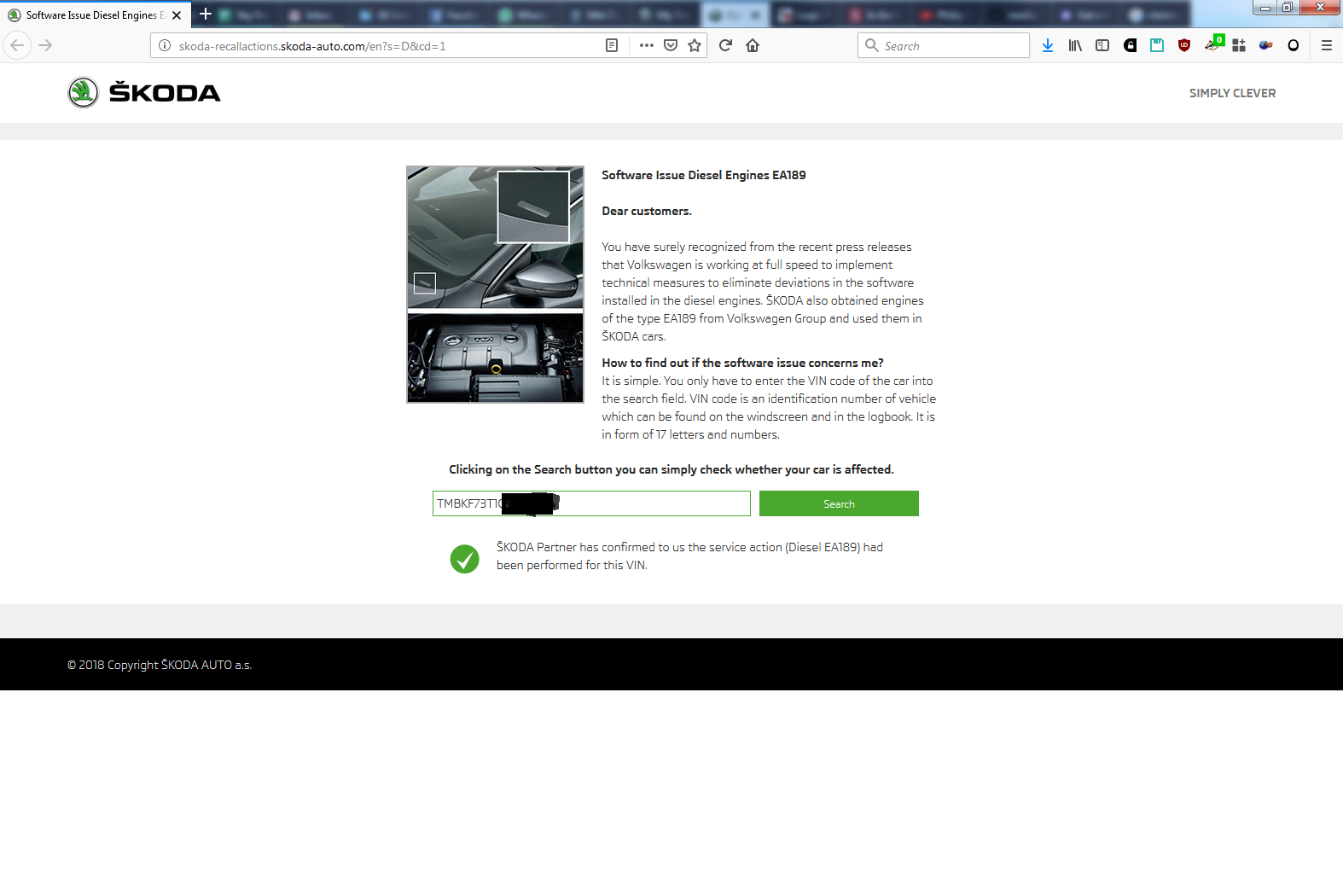

You should be able to enter your VIN on the Skoda website to check if it has had the update or not: that's worth doing as it removes any guesswork.

The Trust Building Measure seems to be EU-wide but you should confirm this locally.
I only know the general site, where I can check if affected or not. But checking if it is performed or not - I do not know. Do You know that site?
http://skoda-recallactions.skoda-auto.com/en?s=D&cd=1
12 minutes ago, Juhagpl said:
Yes, this only shows if affected. It is. Here my concern that they made inspite of my declined statement. But i will check it with the dealer.
It also shows if the update has been performed:
120km for urban cycle is normal after dieselgate software update.
The percentage figure goes down only to 23 - 25% after full regen. So 50% of soot is actually 1/3 (counting from 25 - 100%)
Doing long distance trips it starts regeneration at 650 - 660 km, no matter what percentage figure there is.
Now i monitor the figures for a while, and found some interesting things.
if the 600-700km is not yet gone before burning, and on highway i have around 90% filling, it doesnt go up any %, because there are a kind of soft burning every  f.e. 15 minutes. This means, next time it will start the regen in the city :)

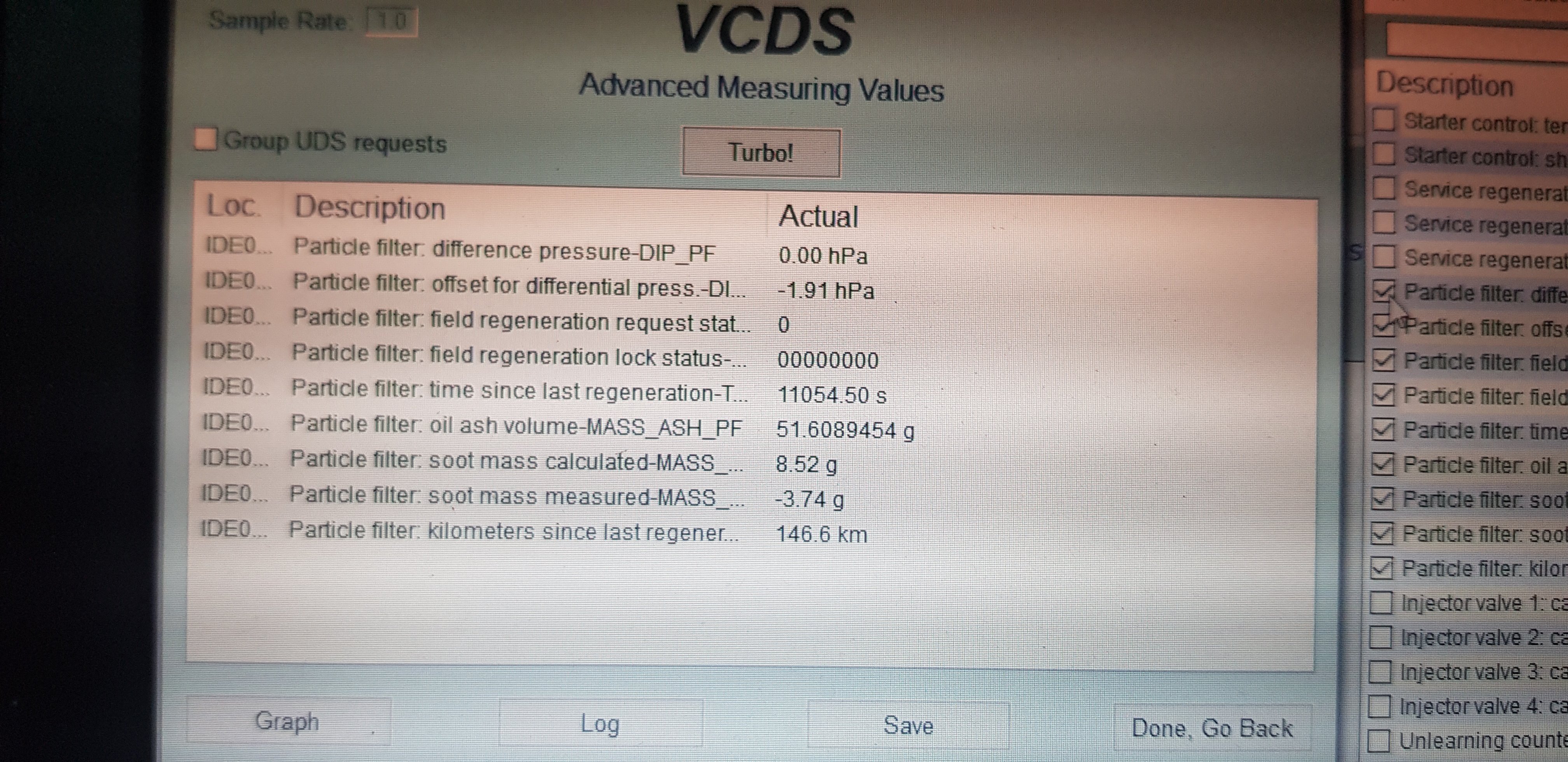

Thread resurrection I'm afraid, I just read my DPF figures and I *think* they are good?! Although everyone elses ash readings are down in litres instead of grams.
So mine is 0.051 litres, correct?
It's a 2014 1.6 greenline 3. 132k miles.
oil ash volume_MASS_ASH_PF is 51.6089454 g
So 51 Grams
Its just that @silver1011 and @langers2k quoted their oil ash in l rather than g.... didn't know if I was missing something
It depends on the engine, some report oil ash in grams whilst others use litres. There are different maximums based on the engine too :)
