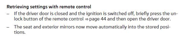

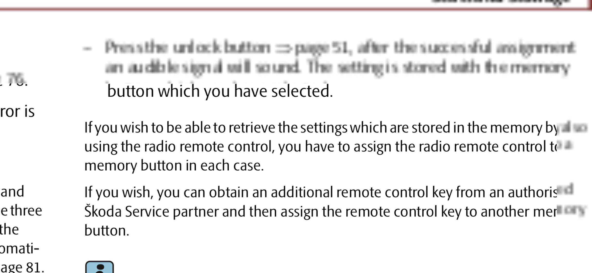

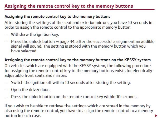

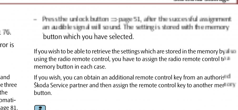

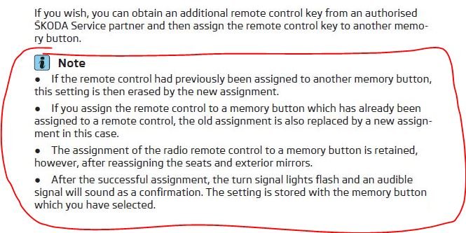

You're on the wrong page of the manual, you need page 74 and 75...
