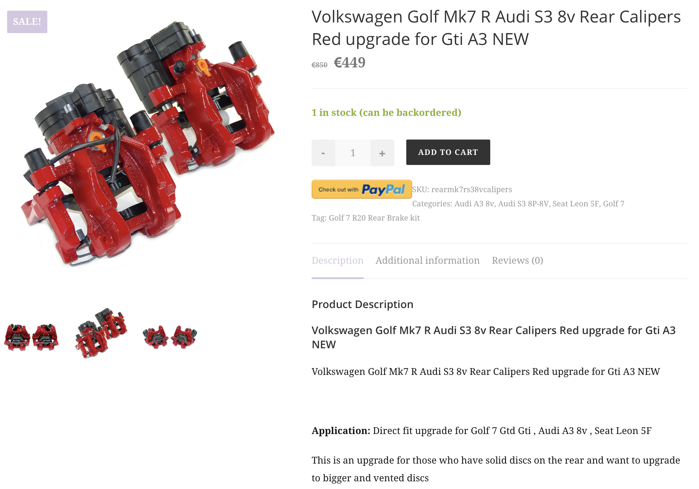

I want to upgrade the rear brake setup from the 272mm solid discs on my 2016 VRS and I've found loads of kits online to upgrade to the 310mmx22mm vented disc setup but they are all with electric handbrake callipers. So what I want to know is can you get the 310mm vented disc setup with a proper manual handbrake?
Below is an example of what I'm finding online.
Any info or input is much appreciated.
Should also mention I can find the mechanical handbrake in the Golf Mk5 and 6 variants but do these fit? As the 2016 VRS is the equivalent of a mk7.
