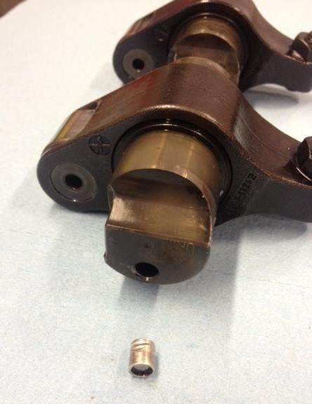

problem solved , all rocker arm plugs were missing ,  ticking has now stopped .
cheers for the help .
Hence no oil pressure in the top end, not good, you need to check the wear on the rocker bushes and make sure the new cam and lifters are still ok.
all is checked ,  all parts fine
