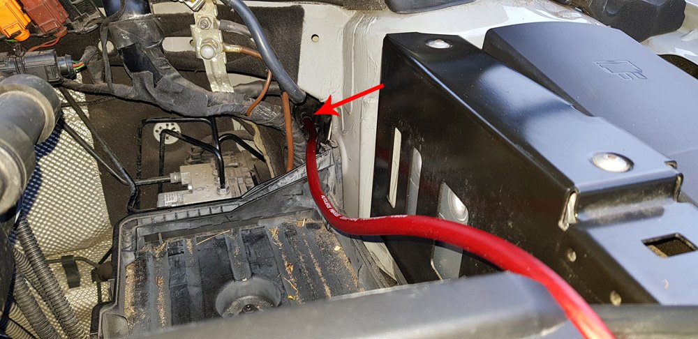

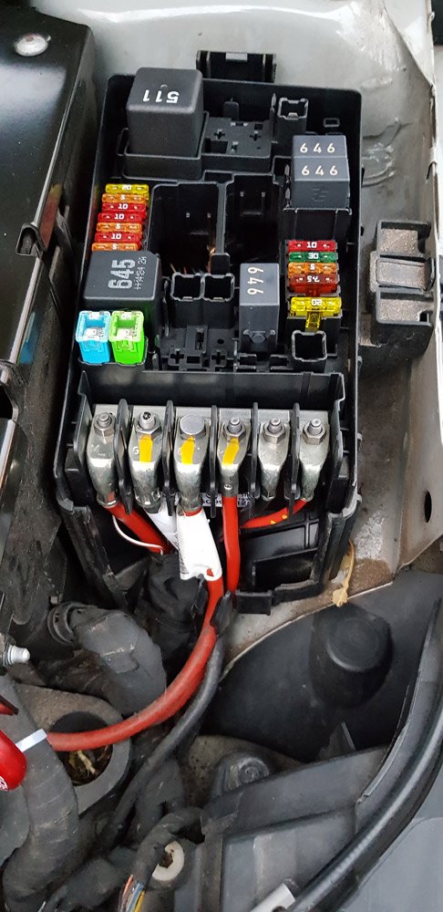

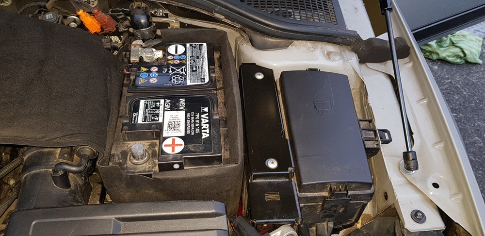

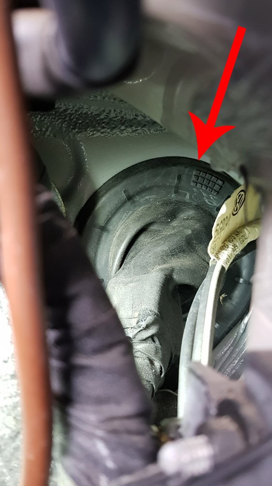

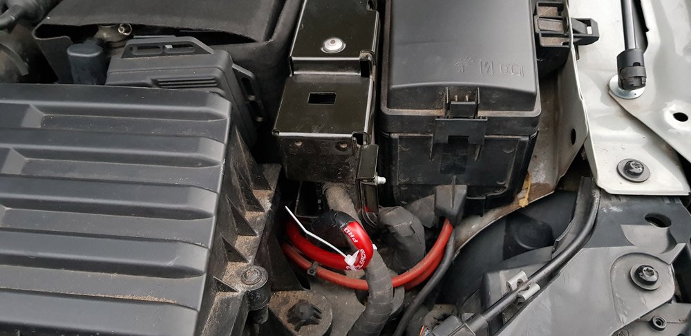

First thing is to route the main power line through the bulk head. (what a PITA this turned into)
Usually i would run 0/1 AWG but its very stiff and over kill for a smaller 10" sub so 4 AWG will be more than adequate. This is a pretty powerful sub for a 10" as it can handle 750w rms and peak at 2700W.

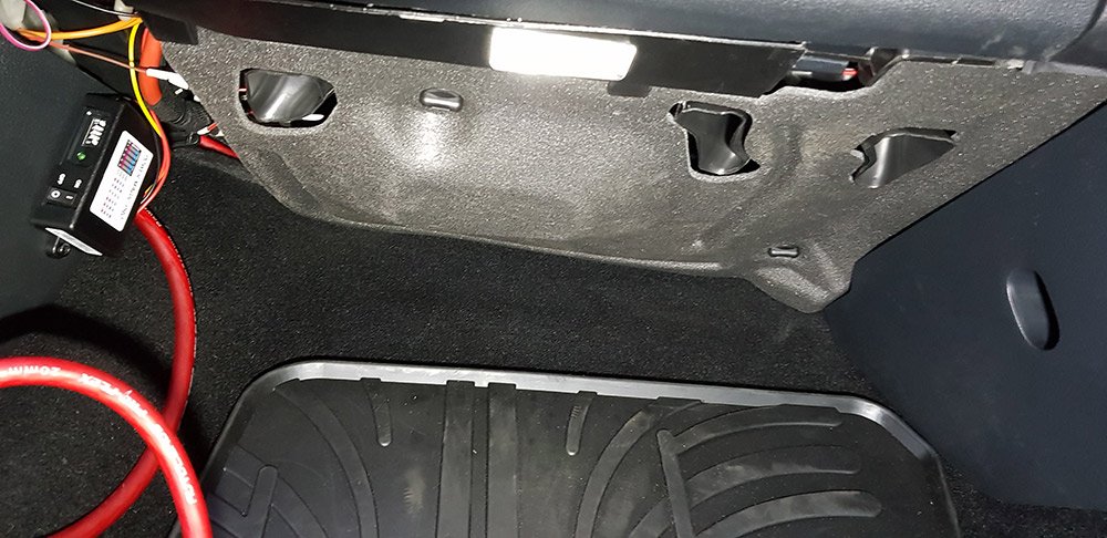

This was a hateful job as there is literally no space behind the fuse box. I took the fuse-box and glove box out which was a waste of an hour as there is still no access to the grommet from the footwell, everything is done by feel. There is one large grommet that passes through the firewall behind the battery so first thing is to take the battery out. Unscrew the holding plate at the front (13mm) after removing the terminals (10mm) put them out of the way so they cant spring back and make contact. Pull the battery towards you and lift up and out.
this is the grommet, its a few inches across and the wiring is wrapped tight with PU tape. You don't want to put another hole in it as there's no way to seal it properly again. You need to gentle cut the PU tape with a Stanley blade until you find the edge of the grommet and use a blunt driver to work it open enough to get an opening. This took me several tries pushing the wiring into the cabin but i had to give up as its way too tight and there's not much space. After an hour or so of head scratching and hand cramps i had to try something else as the fish tape was not strong enough to push through into the foot well either.

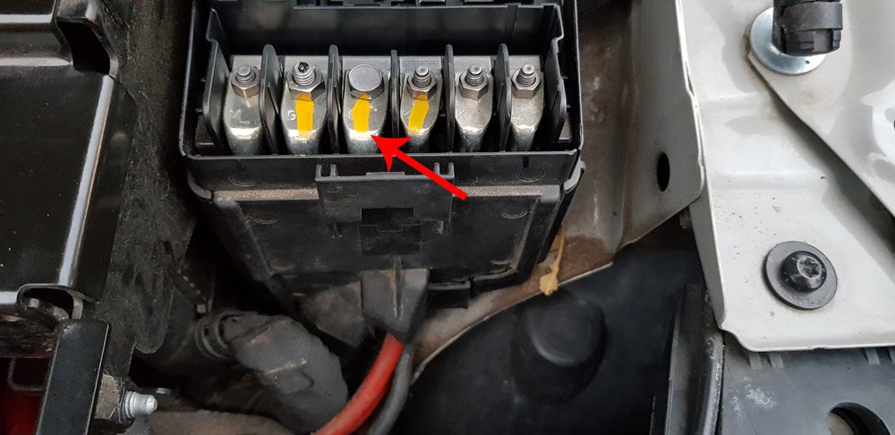

Heres the grommet behind the battery on the right hand side, i wouldn't take it off as you would never have enough room to put it back on.
grommet1.thumb.jpg.1e383acb5a2d37cc04e2a83a7a33acf3.jpggrommet.thumb.jpg.678be5f5ff0c28be2beb25a605004195.jpg

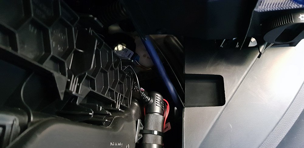

the only thing you need to remove inside is this piece of foam underneath the glove box.

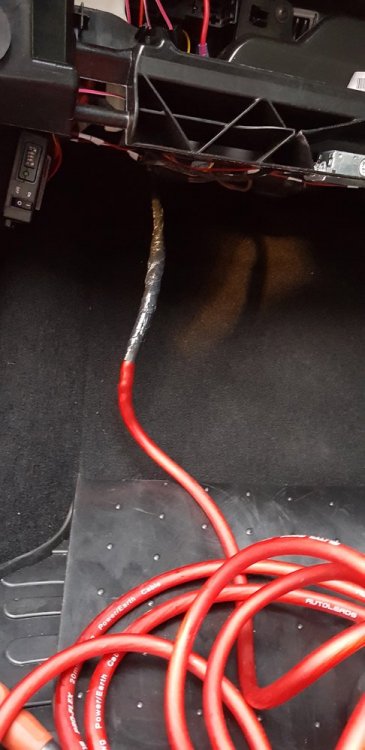

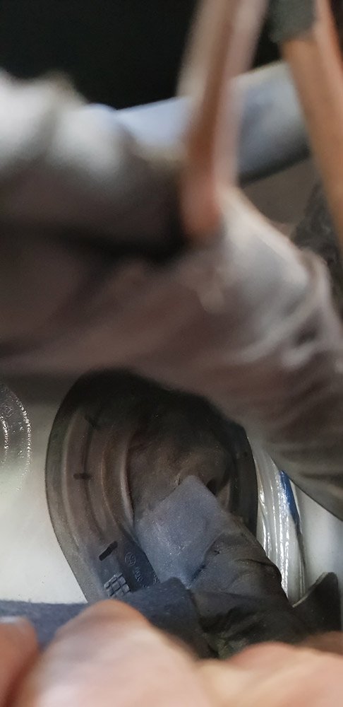

I used an old piece of brake pipe as it was flexible enough to bend but stiff enough to push through the grommet i used a blunt screw driver to lift the rubber boot enough to push the pipe into the foot well. Its a really tight squeeze behind the glove box and it took several tries to get the pipe with one finger and pull it down and through. I greased it to help but even this was difficult. I taped the 4 AWG to the brake pipe with PVC tape and pulled it back though so there would be no break in the original seal through the firewall.
4AWGtapedup.thumb.jpg.491e4997d422b46dca25bfd86db3aa2a.jpgfirewall.jpg.bdfca29154ed1b96f3a28b17a7143cdb.jpg
Battery back in with the cable routed a down and along the side of the battery. I taped it up and cable tied it ready for connecting to a 100 amp fuse and then to the fuse box or battery. The main battery terminal isn't easy to connect to so i'll probably take it from the main power line into the fuse box as it has a nice handy 10mm bolt and hide the fuse under the lid as there seems to be enough space.

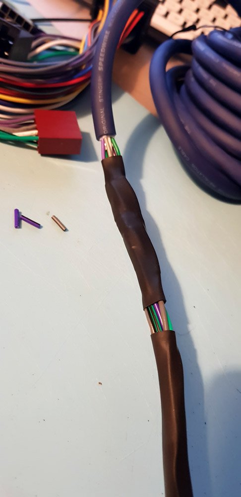

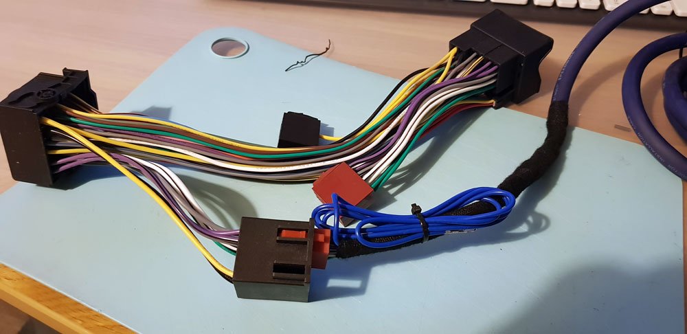

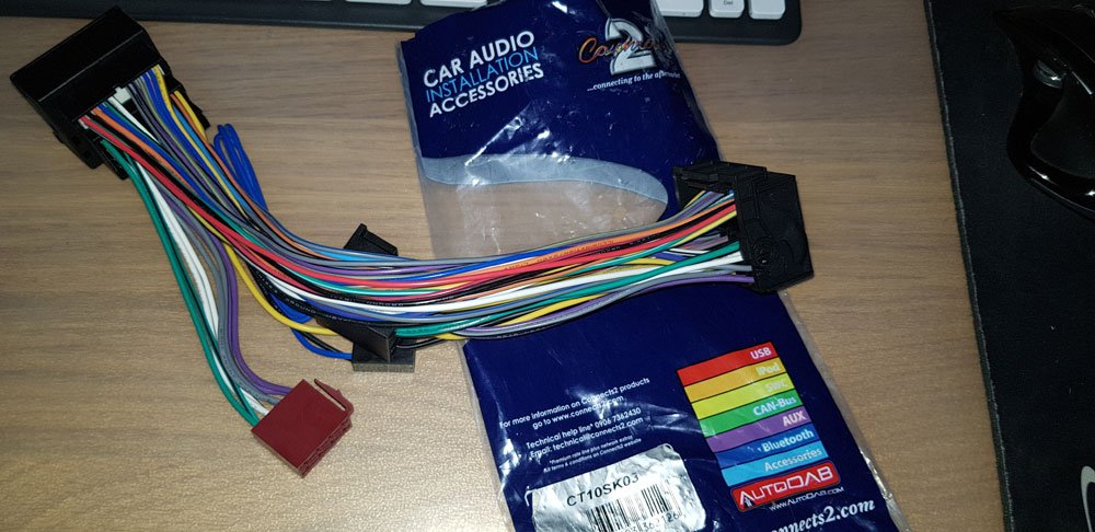

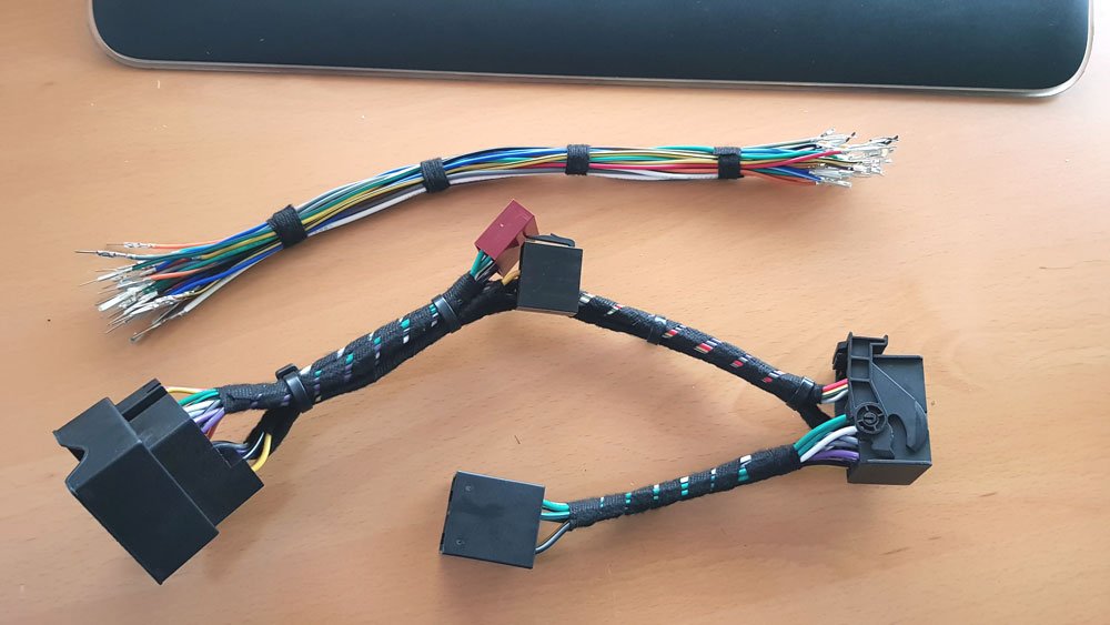

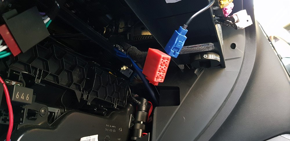

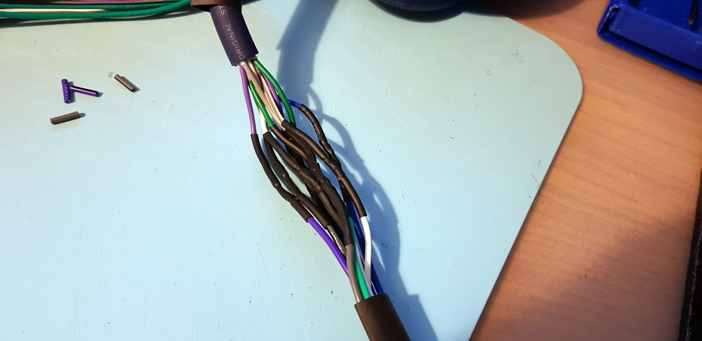

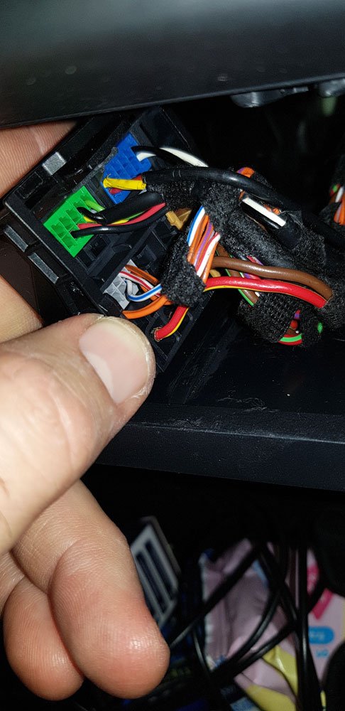

CT10SK03 harness for MK3 MOST connectors. this sits between the headunit and the car harness.
you can see there are a lot less wires in play on the factory side, the colours are also different but its not a big issue.

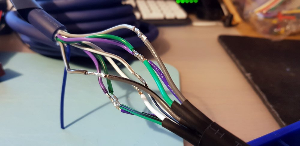

You need to run the speaker outputs from the take offs on this harness to the LC7i which will be in the rear of the car for this installation. The neatest way to do this is to use Stinger Speed wire (18 gauge 9 conductor Audio cable SWG9920). its a really tidy way to run the output at the 9 cores (8 speaker and 1 ignition source) are bundled in a 4AWG sized single wire.

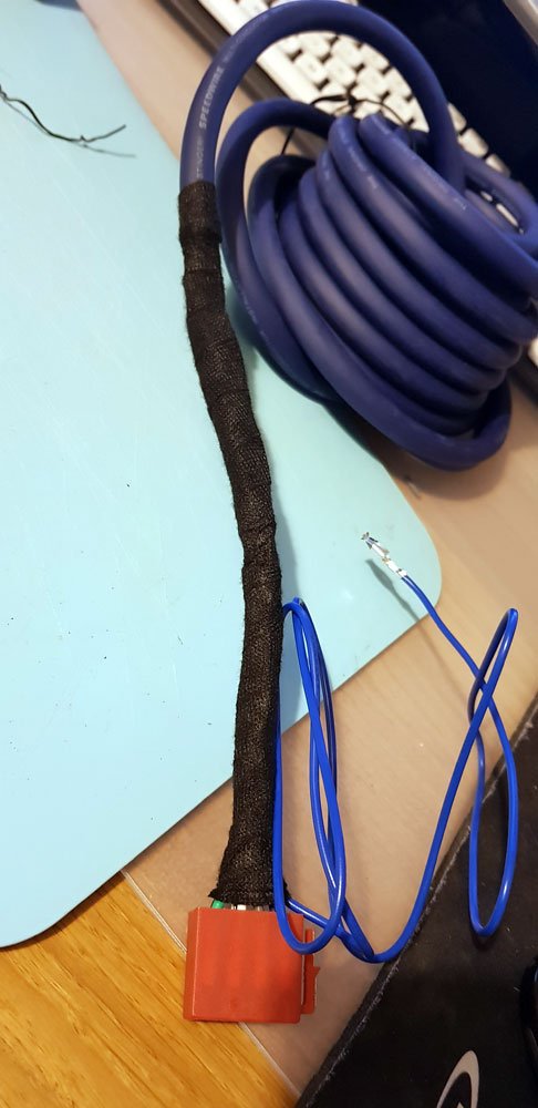

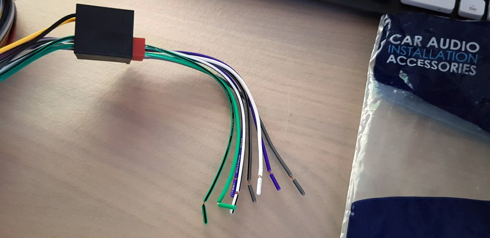

We need to wire this into the ISO plug and attach it to the harness with this...

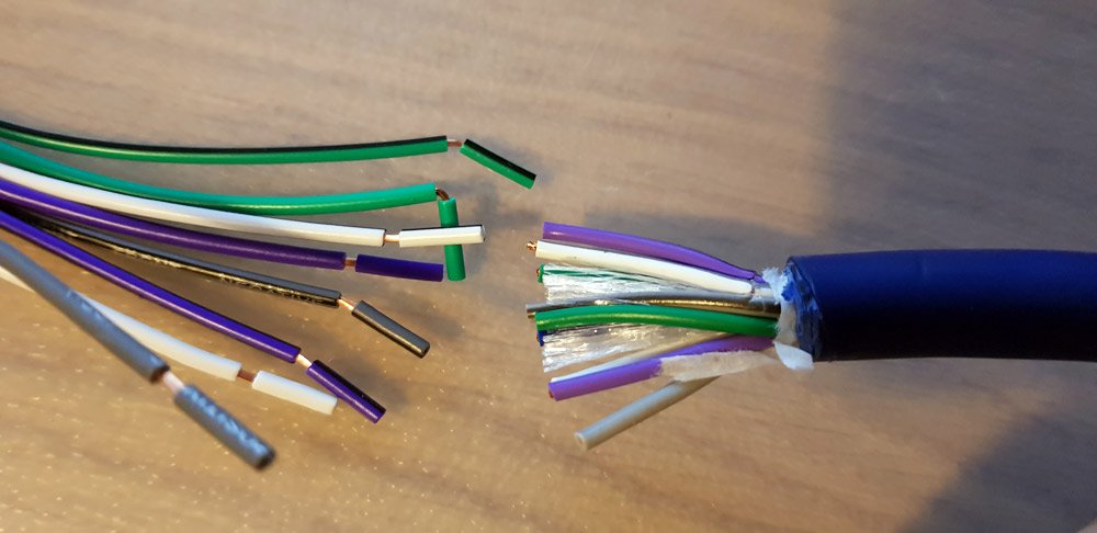

convienently its colour coded so even a dummy like me can manage it. Ive soldered the ISO harnessand the Speed wire together and shrink wrapped for the safest connection.
before soldering the ends make sure you add the shrink wrap on first...
Ive finished off with tesa tape to give that factory look. And... always test for continuity with a multi meter, if you dont know how to do this you would be better getting a pro to do the install.
the blue wire i've left in place just cable tied up, even though its not needed. We will also use a 12v source from the rear of the car rather than the other female take off on the CT10SK03 harness as its less wire to the back as well.
With the connection above the output is going to the aftermarket only, you can unplug and plug the other brown ISO back into the CT10SK03 to reconnect the factory speakers. This will allow me do do all the wiring and amp and sub install first in prep for the speakers and still have sound.
Wiring will follow these lines, the SKODA vag MIB unit doesn't have a subwoofer output, the LC7i will sum the inputs from F+R speaker inputs and output a full frequency pre-amp signal to the sub woofer line out on the LC7i.
Edited by JohnnyType2
I've tidied up the CT10SK03 loom to make it look a bit more factory, there are 26 pins you don't need and can be removed. The harness can be left in place and the ISOs swapped back into the loom to enable the factory speaker wiring if needed.

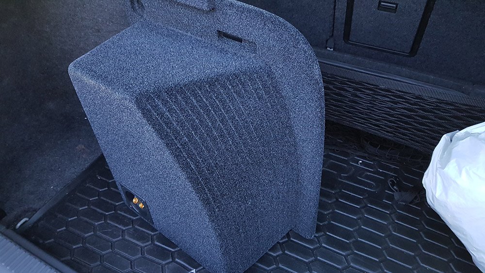

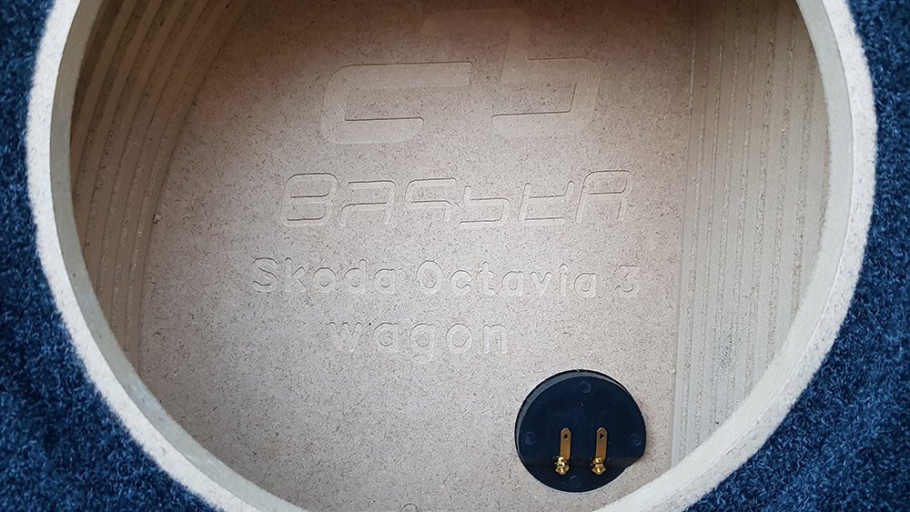

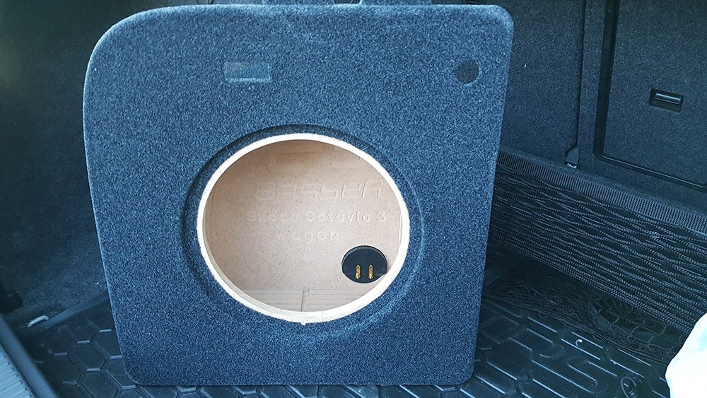

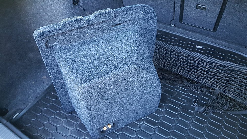

Sub box arrived! very well wrapped and great quality. Well sealed inside and a perfect fit for the side space. I can't believe they can make and post this for £80! its got all the cut outs for the 12V power and lighting as well. Its a shade too dark but i have the correct colour carpet and will most likely recover the front. The Sub is on its way from the USA and I've ordered some cintra blown PVC board to mount the Amps/crossovers/power distribution and signal processor to. I'll mount the amps etc. to RHS wheel arch as there are a few mounting points. The Radio is on its way from Pawel and i should get wiring and testing next week hopefully. I also had the shark-fin for the GPS done in (yes you've guessed it) carbon fibre.
Just test mounting.... still to drill the hole and run the cable forward to the headunit.

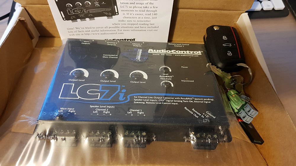

Blown PVC board for mounting the amps arrived and the LC7i!
(key to give an idea of scale) its quite compact but it wont fit behind the screen.

Which Headunit are you using? You mentioned that the Canton sub will have a bass roll off, but if you have Canton the head unit only has an optical output to the amp?
Stock amundsen MIB2,  the processing for the sub is done by the LC7i

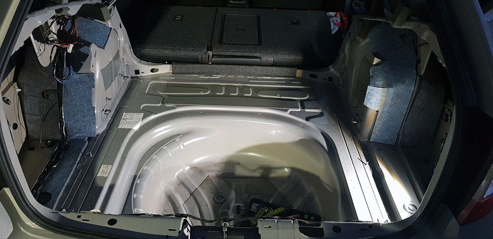

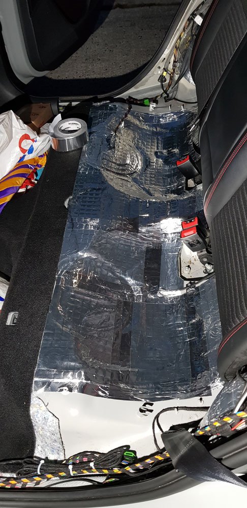

I've been rattling around like this for a week. road noise is awful! deadening tomorrow as soon as monsoon season eases up, i miss my double garage.
some sound proofing...
Where did you get that deadening from? And was it easy to get the back in pieces to get it fitted in?
i bought two types, the precut A4 size sheets of silent coat 40sq (feet £50), and a roll of sound mat 40sq feet (£44). The sheets of Soundmat are better value but the Silent Coat is easier to handle, you can get it from any number of ebay stores.
ive used about 60sq feet to cover the boot and rear seat.
Is it heavy? When I put some deadening in on my Hyundai, it did weigh quite a bit. I'd done what you've done on your car, put it in the boot and the spare wheel well.
It did make a good bit of difference to the noise. I had a non resonated backbox and it droned like mad. But after putting the deadening in, you'd only hear it if you'd put your foot down.

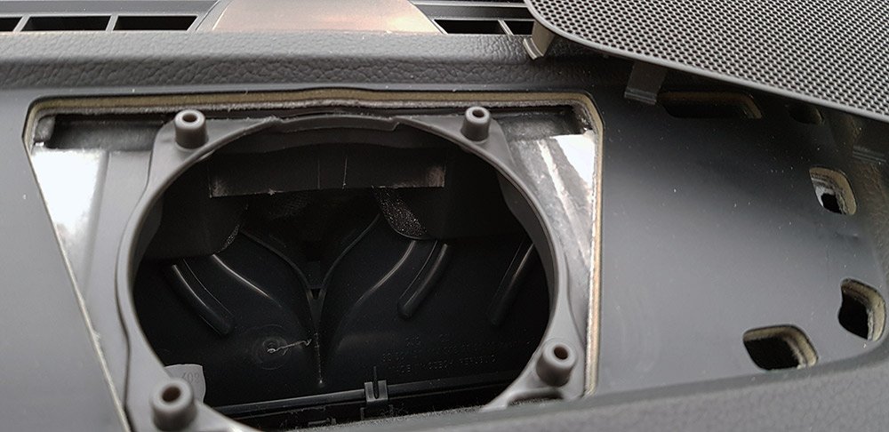

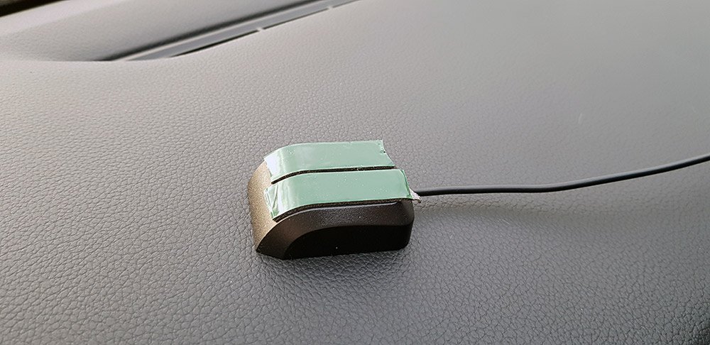

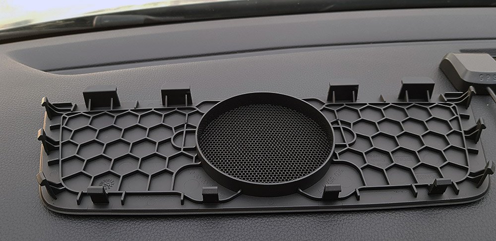

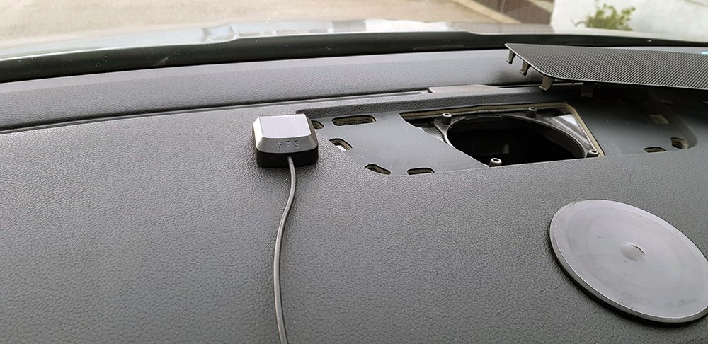

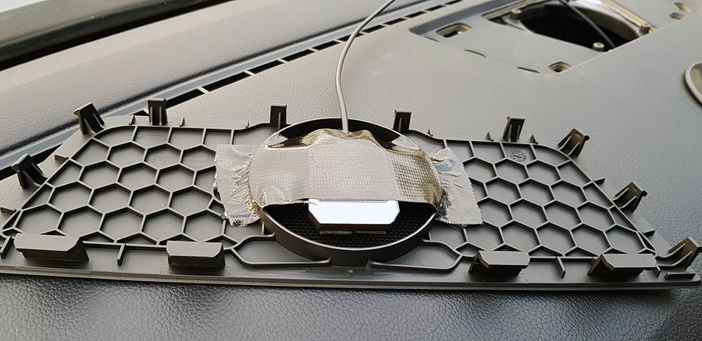

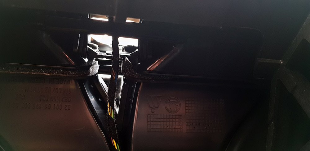

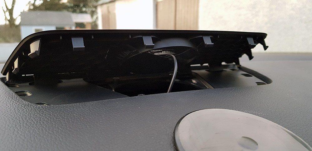

ive fitted a temporary GPS in the centre speaker location.
this is the center speaker location for canton system if you  have that option, im using it as a temporary GPS location.

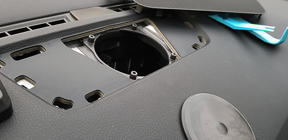

02.jpg.d5bcfadeb94213b446224ef85d4b35e4.jpg03.jpg.50d600c8c1355f72ff00063bebbf2e36.jpg
Its not too hard to pry off and the cover is fairly flexible.
There is a gap through to the back of the screen that cn bbe used to pass the fakra connector.
05.jpg.03f570176748af5040223f268f3c0c68.jpg06.jpg.73254fed7f92d394fb81e3c7c671f0ae.jpg07.jpg.b614afff1b3c0b121f5504c78464f044.jpg
some  number plate tape to hold it on.
and some duct tape just in case
09.jpg.0a36320146a743361eef976905824e78.jpg10.jpg.fd2114920f72df7d6d62b6ac8e7d0972.jpg

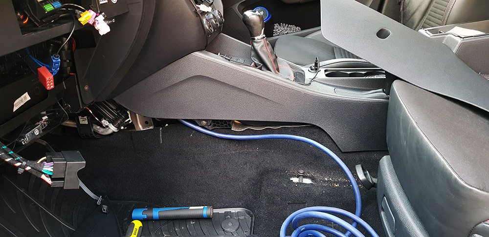

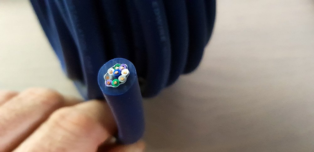

I've routed the speed wire speaker cable down the centre console and added the connect2 harness.
Its a tight fit but it all fits at the back. When ready for the amps and sub its just a matter of switching this orange plug with the OEM one.
Speed cable routed behind the centre console
The cable can be run down the middle without removing the console which is a big job.

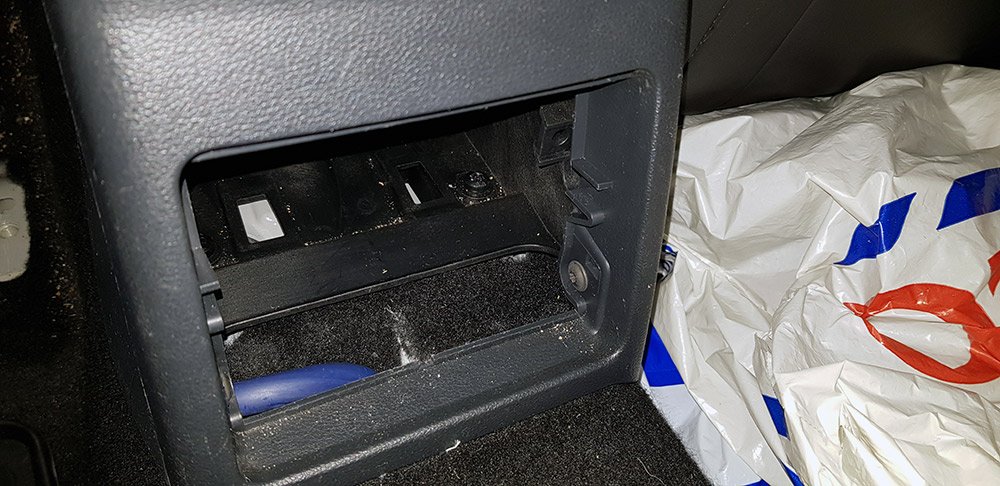

The rear storage has to be removed and the carpet cut to feed the speed wire around the rear seat and into the boot. The power wire will be run down along the door jamb. I didnt have enough time to finish it.
