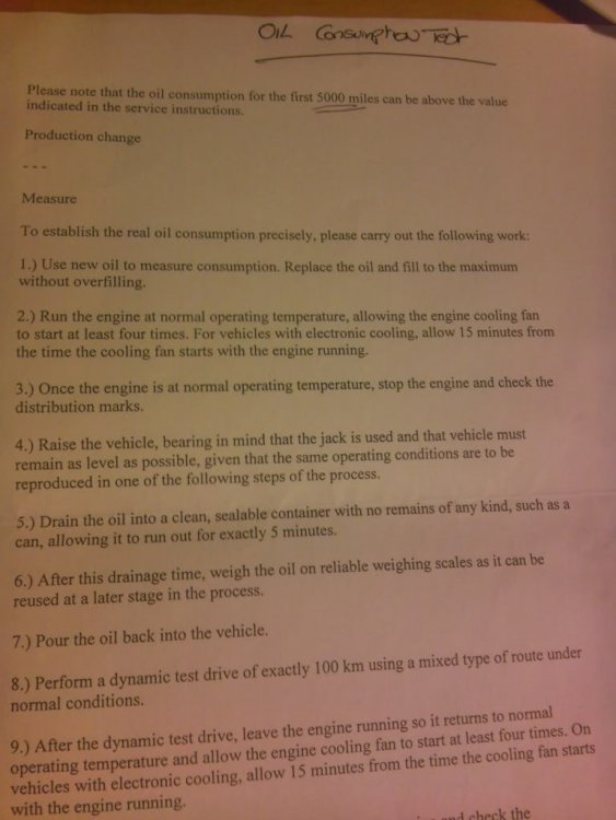

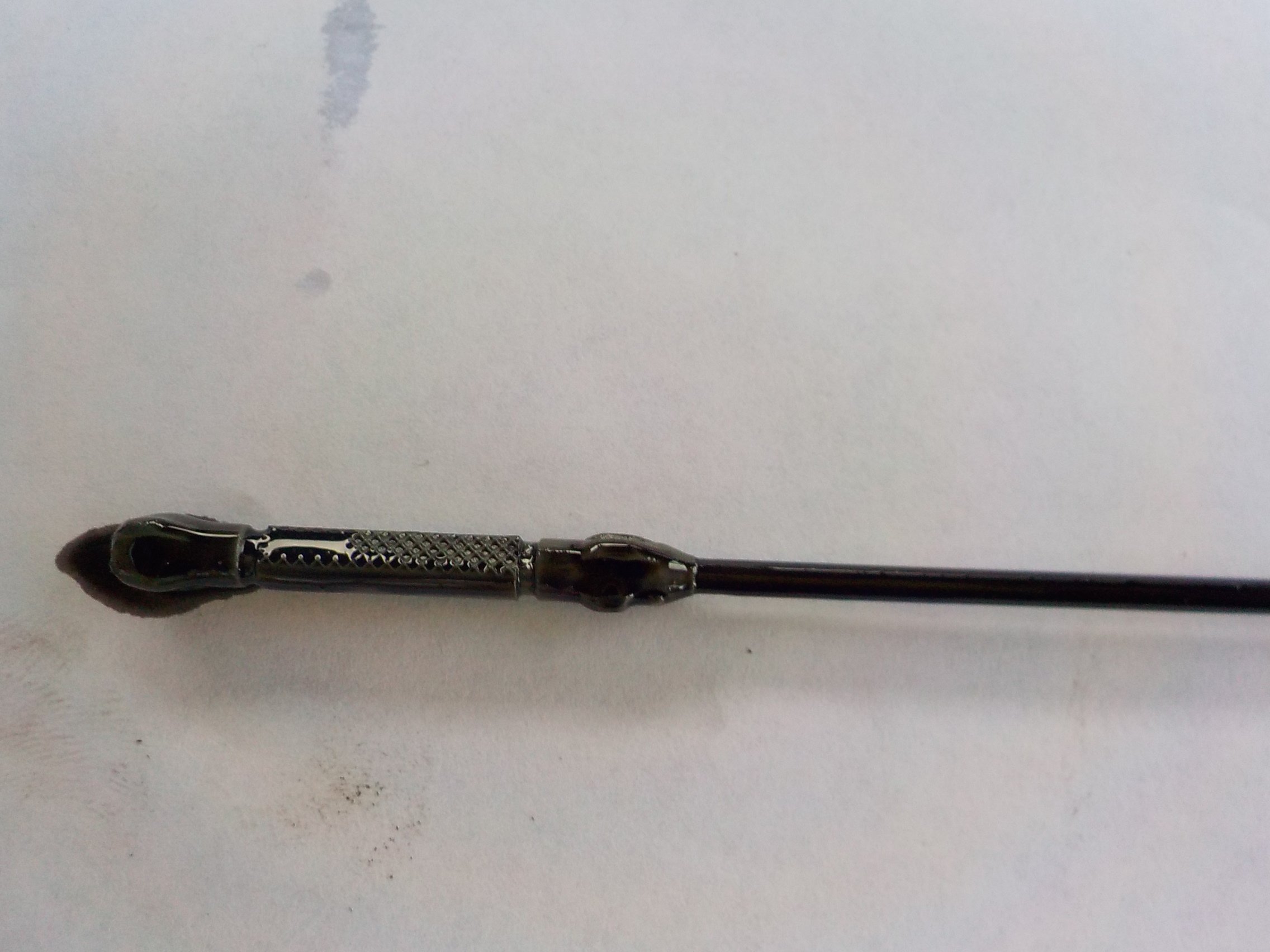

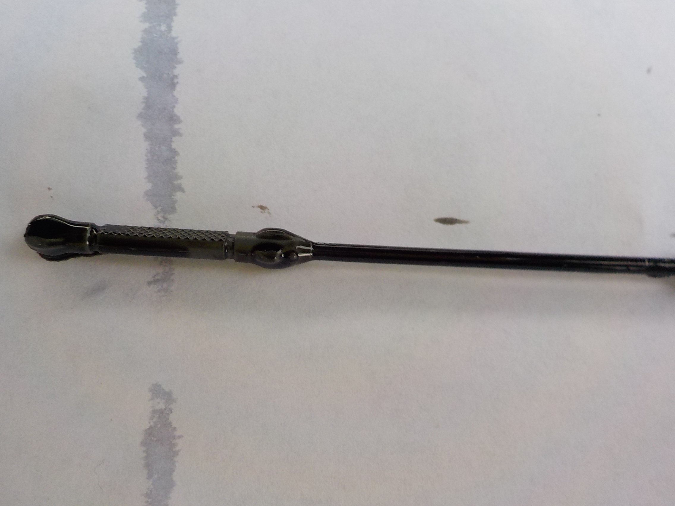

You are the experimenter, i just check oil level and see where it shows on dipsticks and measures how much goes in or comes out.
Pan was a cook pot on  a kitchen electric cooker.  Jam Pot actually. Jam thermometer used.  Just as when jam making.
My Mum got it as a wedding present in the 1940's.
Scales the ones used for weighing berries and sugar usually.  They are in the cupboard beside the jam pan.
Put in 4 litres of engine oil, mark with a freezer marker the level and heat to 90*oC and see the level change in the oil from 15*oC to 90*oc.
Oil weighed at 15*oC and at 90*oC.
Done years ago to check VW Group figures.  Weight of oil.    Nothing that difficult.
