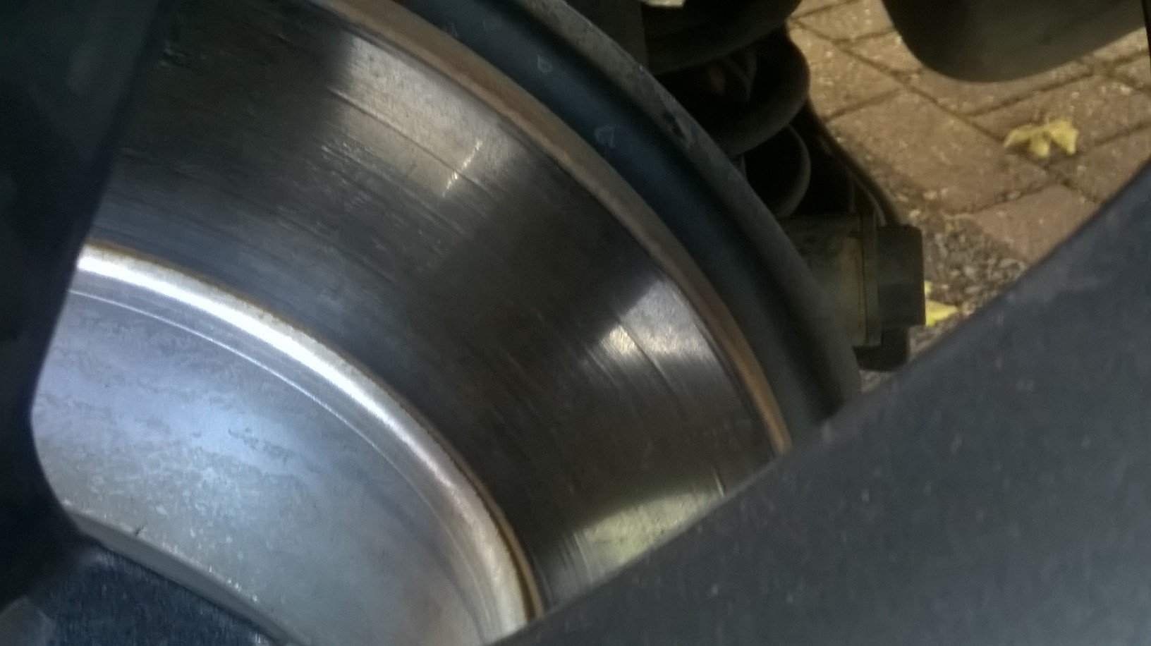

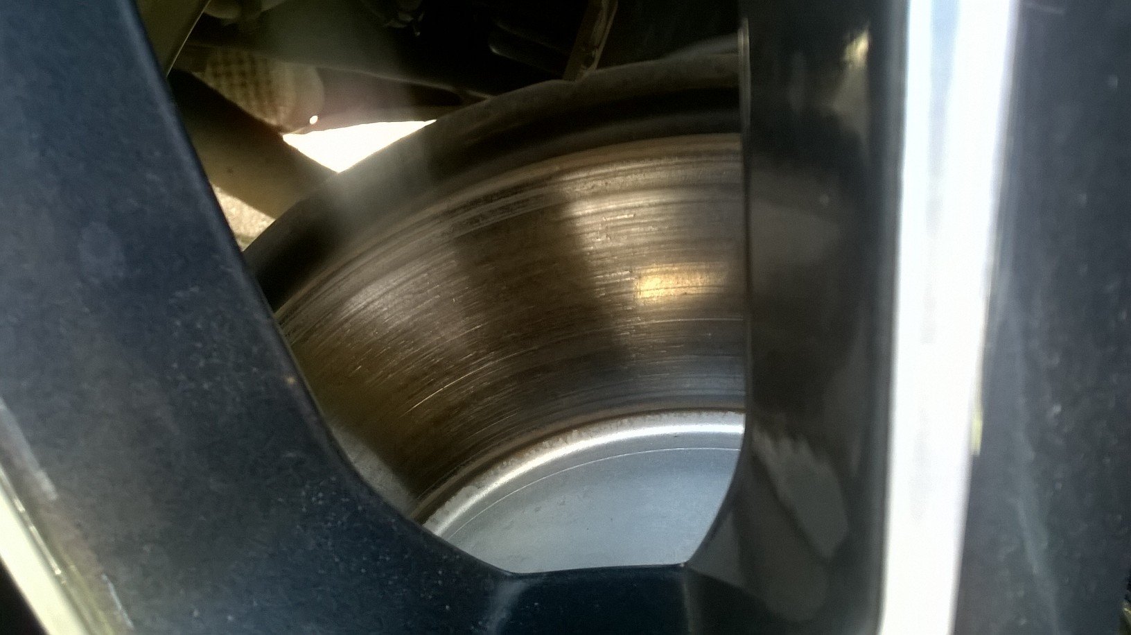

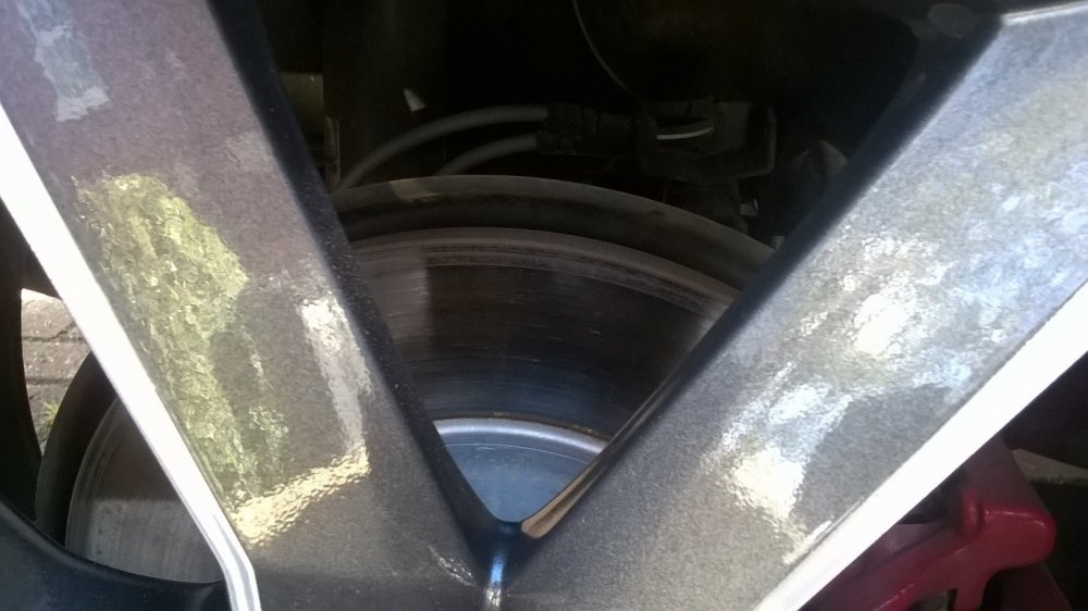

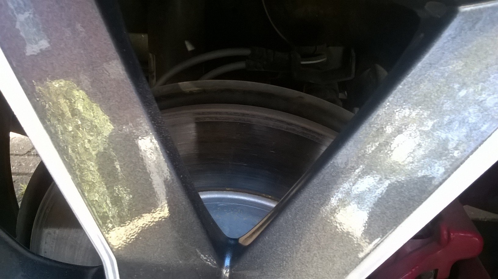

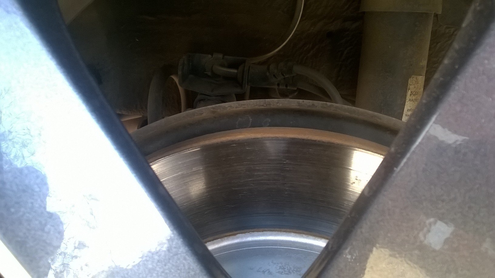

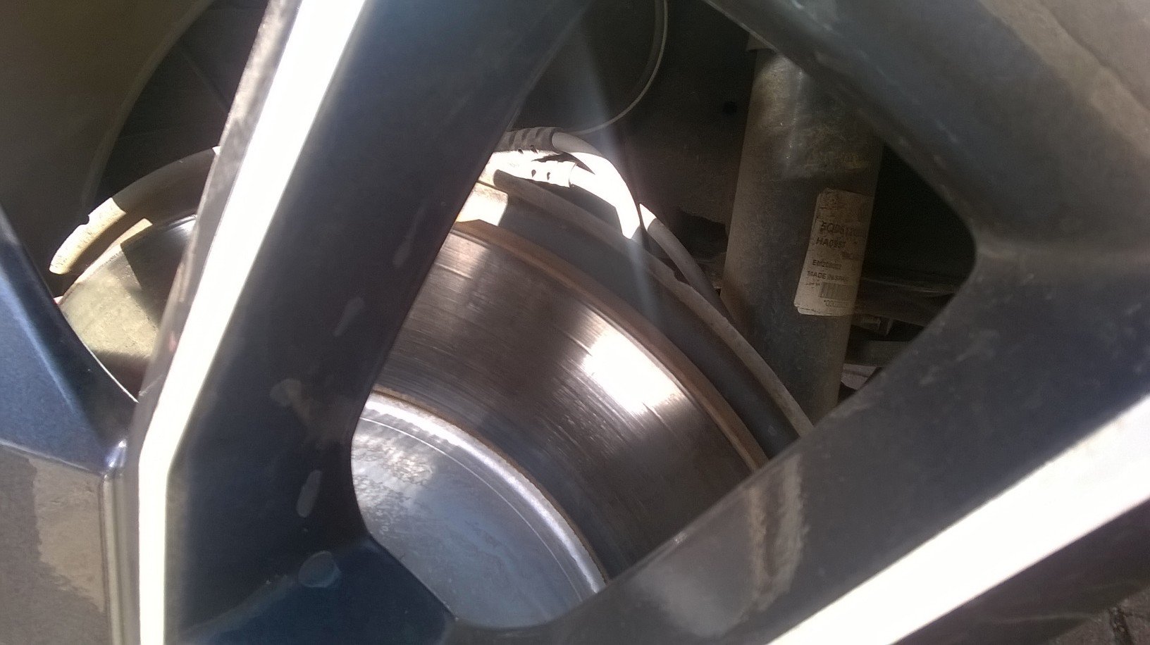

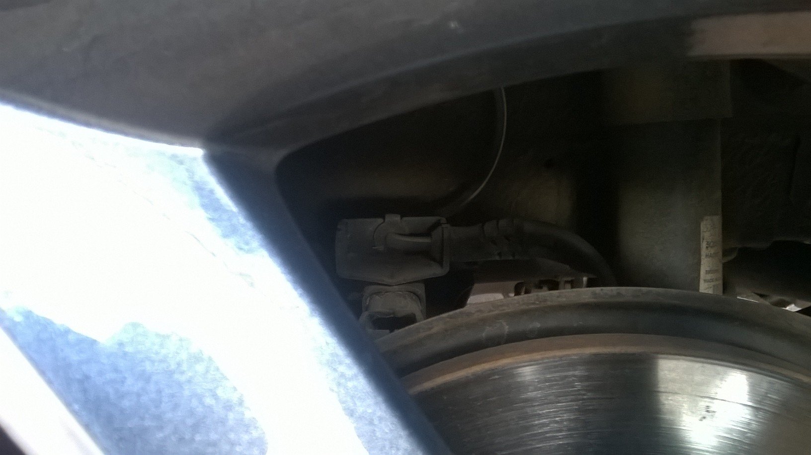

Also, I was advised that the rear brake discs are rusting and should be replaced (after 9,300 miles). I have taken this up with Skoda UK and they've asked me to send in photos, but I don't expect they will agree to pay. Surely, irrespective of the fact that the warranty covers brake discs for only 6 months, under UK consumer law the parts in question are not fit for purpose and should be replaced free of charge by the manufacturer.

Can you put up some photos of the discs?
Sure. These are the photos I've sent to Skoda UK.
Those discs look fine to me
Get those discs checked and measured.
By said Master Tech, then see if someone was Upselling.     Be sure your getting this in writing and Dealer Principal involved.
Lax management maybe.....    People are supposed to trust these employees to be competent.
They look fine too me too no ridge on the outside, no grinding or anything I think that garage is trying it’s luck

As Superb TWM, ntl 123 and Wino have pointed out below, the discs seem OK. Hopefully, Skoda UK will be of the same opinion and will issue a *******ing to the dealer for recommending the replacement of parts which are serviceable. They are going to phone me back. As you say, I will need to ask for a reply in writing.
They are at it.  The members are almost certainly correct.   Stevie Wonder could have felt the discs without the need of a visual inspection.

Look like my Roomster discs. The rear discs are not as shiny as the front as the rear does not take the full braking. Dealers try it on as when I picked up my Roomster after its 3rd service they commented on the lip on the discs. I commented that a lip was starting to form after 2500 miles. Work at the dealers may be in short supply.

Rarely seen photos of discs on here that look less in need of replacement.
The verdict seems to be unanimous. It'll be interesting to see what Skoda UK say.
Those discs are perfectly good.
Rip off or clueless mechanic (quite likely given the oil overfill).
I had our other car - a Zafira - serviced at a Vauxhall “specialist” 2 years ago when I bought it, as it was a due for a cam belt. One of the huge list of advisories for extra work, was front discs excessively worn. 2 years and 20000 miles later they are still on the car and there are no problems with it whatsoever. I measured the discs myself and they were within the tolerance specified.
