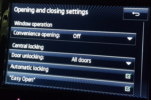

It's in Car - Settings - Opening and Closing. As Sagalout says, it can take a few tries to work out the best way to get it to work. For me it is a slow straight kick, then step back. It can take a second or two to start to open, so be patient with it.
Tried that directory. Nothing I could see other than doors all/single/side opening and windows functions.
Maybe it's not a fitted option?
This is what mine shows, just for comparison. I understand it's the "easy open" that controls the virtual pedal, but happy to be corrected.
I understood the VP is standard on L&K, but I got mine ex-demo so can't confirm. I did have a quick look at the spec sheet, but couldn't find an obvious mention of the VP.
Thanks for that. I see that option too. It is also ticked on my menu.
Oh well, a trip to the local dealer...
