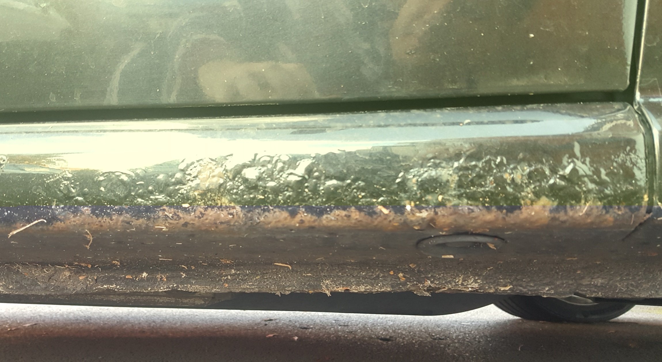

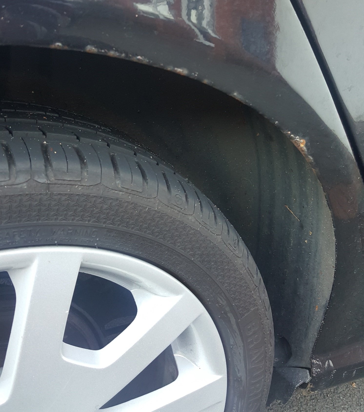

My 15 year old Black MK1 Fabia VRS past its MOT today and I'm a very happy bunny. However, I was advised that the corrosion around one part of the sill and the offside rear wheel arch needing addressing soon.
So, has anyone got any tips on how to make a DIY spray job look good. Do places like halfords sell a good paint that matches well?

I don't have a problem with rubbing down, treating and filling the rusted areas. It hasn't eaten all the way through and a lot is just paint bubbling away. My concern is, as sepulchrave pointed out, a can spray will look rubbish.
Because of the age of the car and not having a lot of cash, I can't afford hundreds of pounds to get it sorted, I'm guessing it's going to cost a lot.
Smart repair is really not that expensive, certainly a body shop respray will be hundreds, but I doubt a smart repair would be much more than one hundred, especially if you you've already killed the rust and filled and primed it ready for paint.

Trust me NOBODY is looking at your sills from underneath. I had mine similar recently and only noticed by looking from practically ground level ( and mine is yellow, so should stand out easier than black).
Form over function, more important to deal with the rust - look how bad that looks ! Anything is better than that rust to look at, even smooth black hammerite !
Although actually, yours is perhaps worse as its crept to top end of cill, I think mine was more underneath. I just masked it off and grinded it down clean.
Took a surprising amount of work with grinding wheel drill bit ( followed by wet and dry) to get to a cleaner metal before treating and then painting, so you will have similar, most important to get it as clean to metal as possible before painting ( on a good day).
The arches yes have to be done more sympathetically on matching paint. Although I think I could DIY it to a reasonable undetectable level myself, going through several stage of rust protection, filling where necessary, priming, coating, etc.

@Chris Berry My car, as with many Fabia's, has the same issue as yours with rust on the sills, arches and a slight amount forming on the bottom of front doors. The arches and doors are going to be done at a bodyshop but the sills I going to do myself, probably this weekend. They're going to be ground back, have several coats of Bilt Hamber Deox-Gel applied on any rusty areas, then be coated in BH Electrox Zinc coating and finally stone chipped in black. Probably a bit over the top but I'll post some picture when its done!
