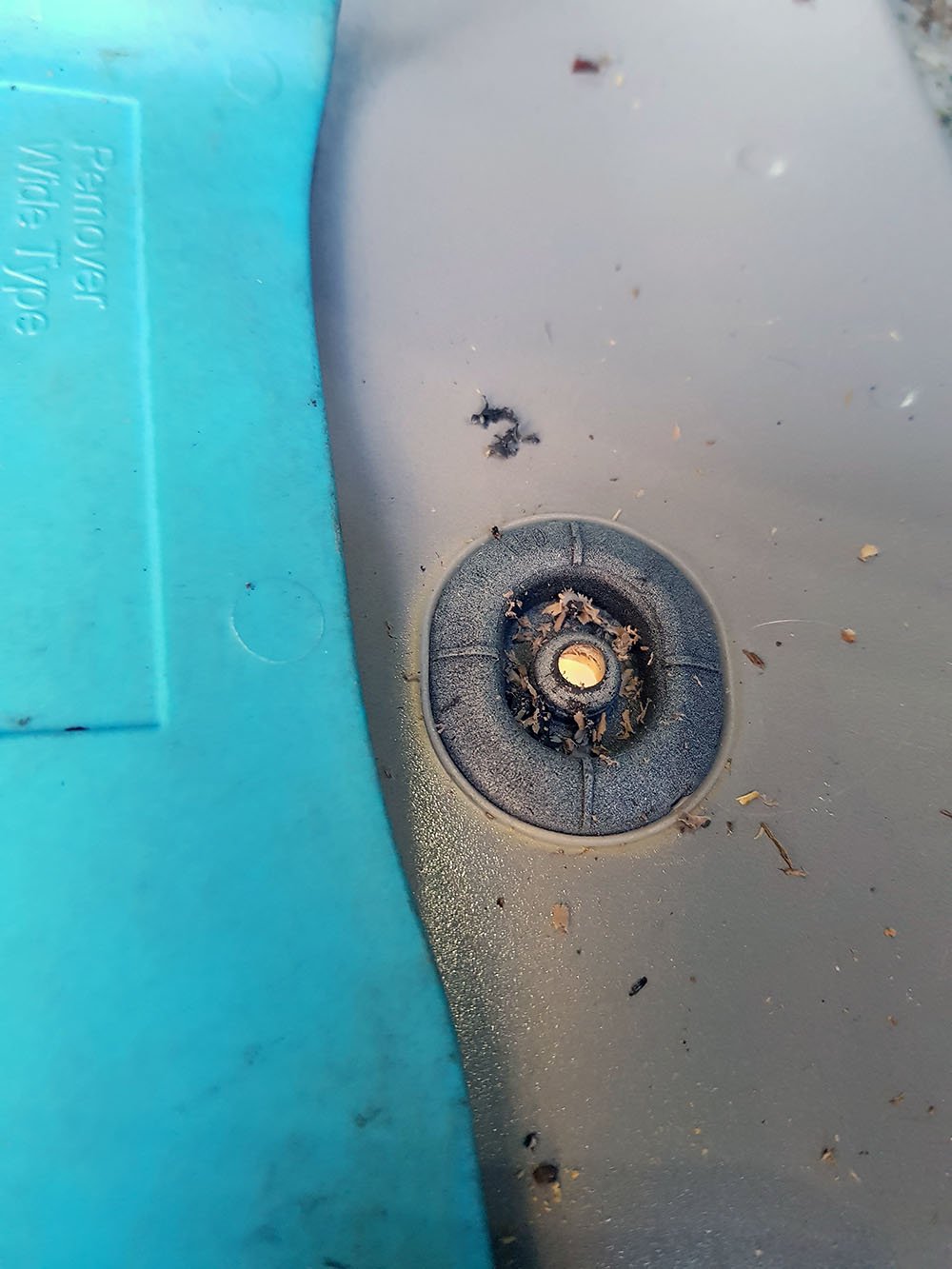

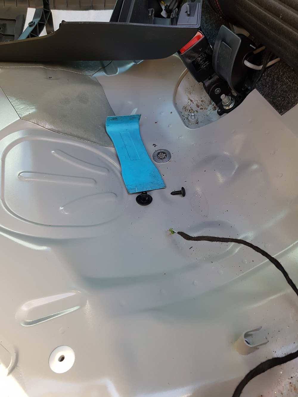

I've run lots of these with VW camping Zig units. i wouldn't advise going down through any seal, there are grommets under the rear seat that i have used for my active sound unit which would work as you can attach the external socket to a rail under the car and remain completely water proof. You would plug in just beside the rear wheel.
this is where I've run the external wiring for my active sound unit from and there is a large void on the passenger side (UK) to the side of the exhaust. There is a large cover which can be removed for access.
Edited by JohnnyType2

The rear seat method is interesting...... but I'm not keen to have any connector exposed to the elements. Underside of the car as well!

Thanks. I see how this can come together. Route it through the bit posted by JohnnyType2 and have the weatherproof socket somewhere. Then plug in via the green cable. This would be the proper way to get power into the cabin.
