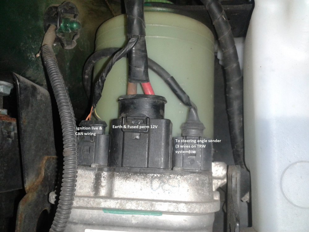

No communication points towards a problem with the ignition 12V feed or the CAN wiring, I think; both on the left hand 4-way connector in this picture. I guess the first thing to see is if the ignition 12V is present, on the black/yellow wire when ignition is switched on.  I'll just check what fuse that ignition 12V comes off, as I think it's shared with one or two other things.
