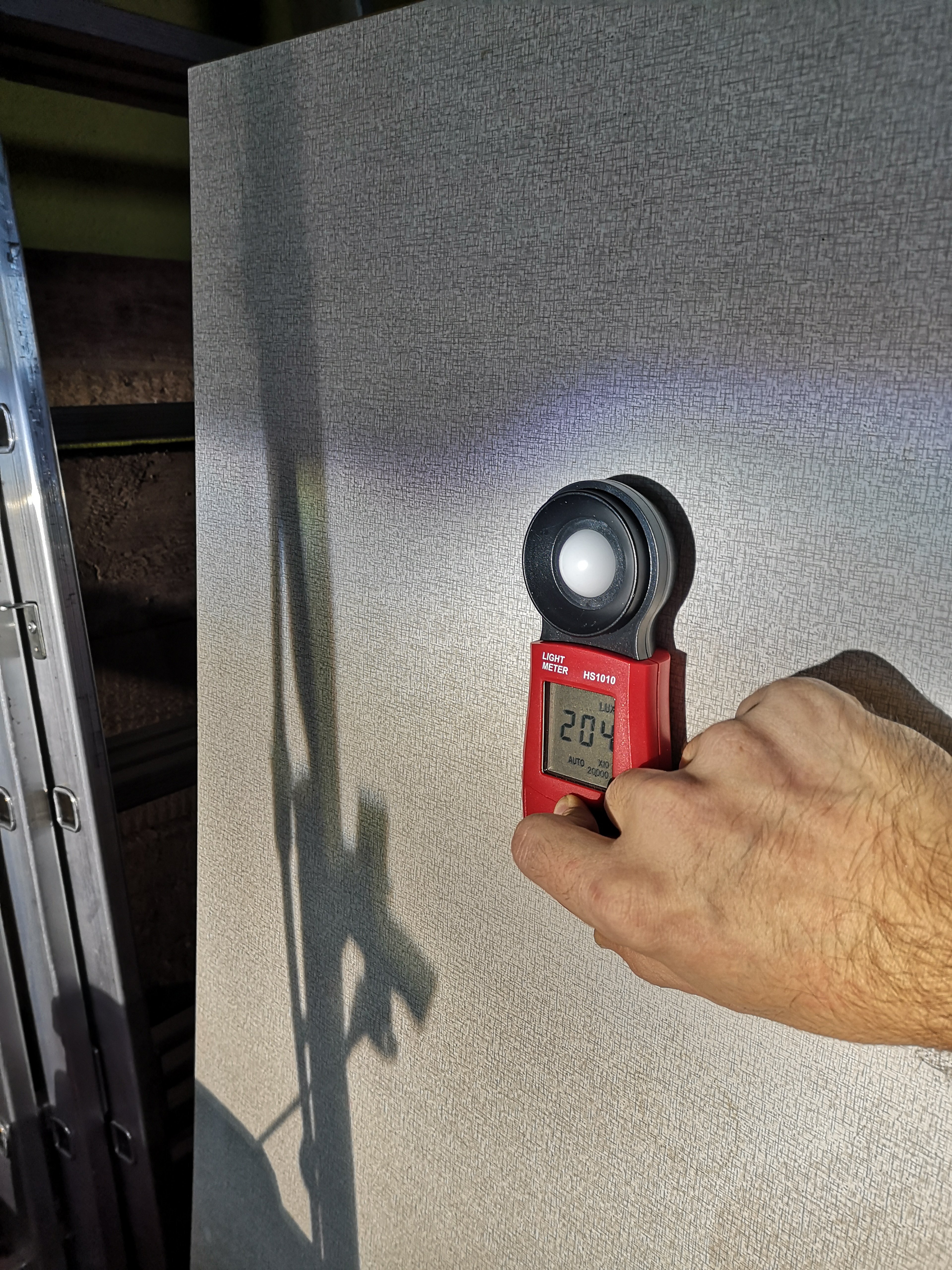

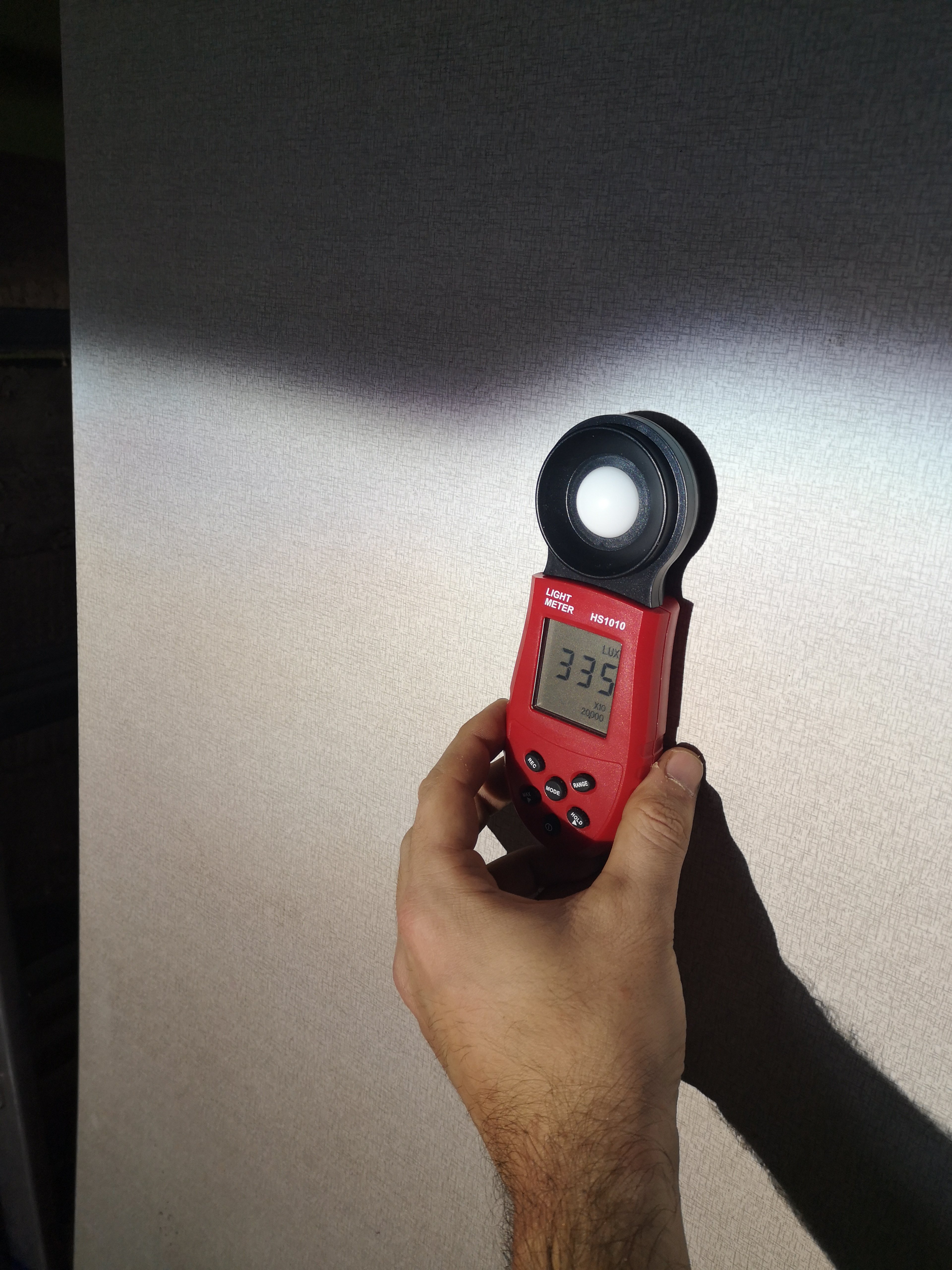

Today I also replaced the Xenon bulbs. OEM were 66340HBI, Osram Xenarc standard bulb. And my new ones are Osram D3S Laser Next Generation.
I did some readings with a lux meter before and after the switch. When I first replaced the bulbs I got poor readings from one side. Even though everything looked like it was fitted correctly I took the bulbs out again and re-fitted them. It seems like the bulbs need to be clicked in place when they are fitted correctly. When it was fitted the right way, the bulb stayed in place even if the metal brackets weren't locked. Then I locked the brackets and connected it and got even results.
NOTE: The lux readings are not actual light output of the bulbs because it was not dark in the garage. The lux readings are just to show the difference between the different type of bulbs under the same conditions.
So here are the results:
Standard bulb: 204
Osram next gen: 335
The lux in the hotspot increased by 64%. And I believe that the difference will increase as the new bulbs burn in.
As a matter of fact it was really visible with only looking at the hotspot that the new bulbs were a lot better.

Standard bulb:

Osram D3S next gen:

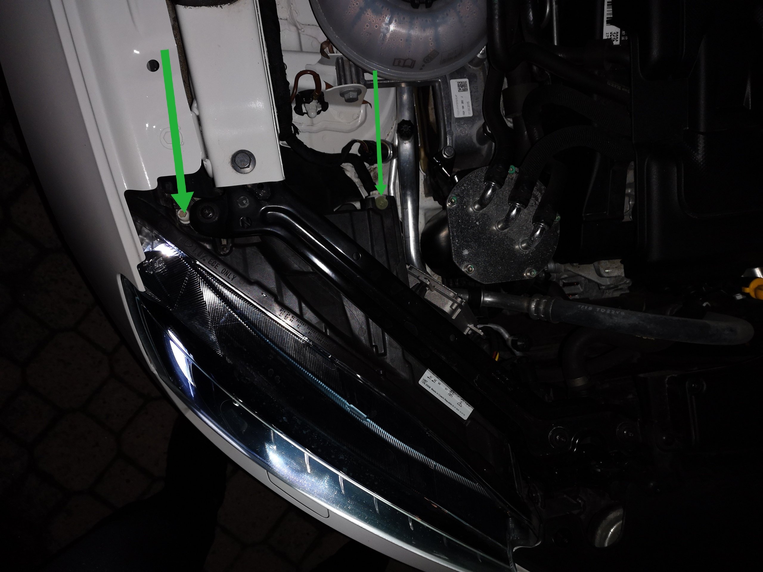

Have adjusted the height now. Works just fine without having VCDS. There are 2 adjustment screws. One for the length and one for the width :)
Any chance of a pic showing screws and which one is which?
And which way to turn?
I'll try to get a picture later. Wifey is out driving at the moment :D

And here are the adjustment screws. The right one, in the middle of the headlight, is for up and down and the one to the left is for adjusting left to right :)
Thanks for that, I adjusted mine last night and it’s made quite a difference
