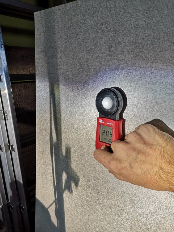

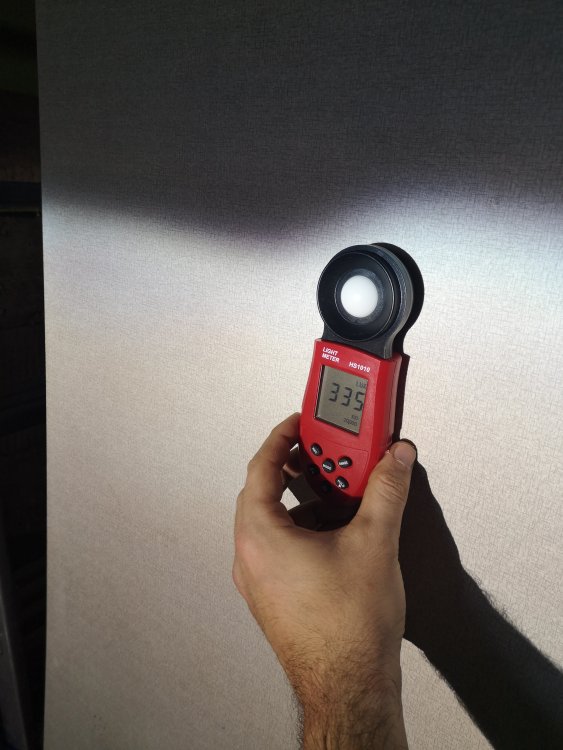

Changed the main beam xenon lamps in a different and measured with "lux meter" app - this is really important as the readings aren't to take seriously!
But the difference in light output as stated by @Bob-thebuilder is huge!
Philips Xenstart (4years old warmup 4 minutes)- 5200lux at 1.3meter (center of beam)
Osram Laser unlimited (fresh from box warmup 2 minutes) - a whooping 19 300lux at the exact same spot as I measured the old lamp. Now these figures doesn't tell the truth but I would say that a new quality lamp at the same wattage will easily outperform the standard xenon lamps that our cars is delivered with.

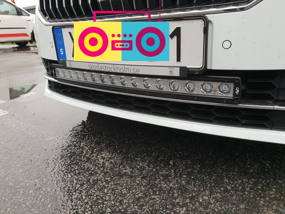

Don't know if you are serious...
But here is a picture from @Baverhanne and how he did.
The Picture is not mine. They can be found here:
I'm thinking of getting a Strands NUUK or Osrams new Osrams FX500. The first original LED bar from Osram. Not the strongest ones but definitely good value.
For installation there is a swedish patented invention called XBB lightswitch. You simply connect the XBB plus and minus to the car and then the LED bar to the XBB. From the XBB then there is a electromagnetic switch that you fit on the cable that gives the Xenon solenoid power when you switch on the high beam. And voila! No harm to any cables in the car and the power gets directly from the battery.
I was pretty serious, that thing is insane! I looked at the pictures and then realised that in the LED picture, he'd covered up the headlights!
The only downside I guess is that it could make the car look a bit ugly from the front.
