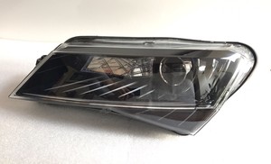

I think the issue isn't unique to you, or India, it seems the problem is quite widespread on the MkIII Superb...
Image result for mkIII skoda superb headlight

Xenon / HID headlights run much cooler than halogen bulbs. They don't generate the same amount of heat that would help to eliminate the condensation.
My 2018 Skoda Kodiaq has LED headlights which run even cooler than than the xenon's on the MkIII Superb, and my headlights mist-up too.
As mentioned there can only be two reasons the condensation is only appearing when you turn the headlights on...
1) The headlights are letting in water / holding excess moisture. The heat from the bulbs is evaporating the moisture and it is condensating on the lens.
2) The heat from the bulbs is drawing in moist air which is cooling on the surface of the lens and condensating.
So, your lights have excess moisture in them and need drying out.
The million dollar question, "why do they have excess moisture in them?"
1) The climate in India is particularly humid?
2) The roads you drive on are full of deep puddles, regularly wet?
3) The car is regularly washed using a high pressure jet wash?
4) The engine bay has been washed or steam cleaned?
5) A wheelarch liner, engine under tray is missing / damaged?
6) The car is used infrequently and stood in a cold or damp environment
7) The headlights are damaged, cracked, or one of the access panels is loose or missing.
8) A design fault, their design is inherently flawed.
9) The headlights are rarely used and never get warm / hot to dry themselves out?
You could be experiencing a perfect storm of a lot or all of the possible causes?
If you have exhausted all options with your local dealer and Skoda India then you'll need to try and fix the issue yourself, if there is indeed an issue or fault.
Knowing the headlights are completely dry would be a good start.

As for the longer term effects, if the excess moisture is prolonged, then yes it is possible the inside of the lens can discolour over time, see here...
2 hours ago, Mickey43 said:
Happens in the winter to my car.  Goes away in the summer.
Seen it on other cars, most notably Audis .... and once on a Tesla!
It is happening every night in my case irrespective of the weather which is really very frustrating.
12 minutes ago, silver1011 said:
Given what you've said I'd really look to dry out your current headlights yourself. It you really are unhappy with the situation, and are sure Skoda in India aren't going to support you any more, then this has to be your only option?
The alternative? Buy new headlights. The light clusters themselves aren't overly expensive. Assuming they're xenon's and not LED's then the high cost is all in the bulbs, igniter, ballasts and AFS module, which will all unbolt and fix back onto a new (watertight) headlight.
Thanks. From where should I start to dry them out? I mean which part should I take a look at first?
Can't install new headlights because that would void the warranty, yes warranty related terms and conditions suck here.
Yes that discoloration+when I see the other condensed free Skoda's is what's bugging me. I am pretty sure they won't cover the discoloration here too in warranty.
You need to remove the front bumper before the headlights can be removed.
That would be frustrating.
I know and I need to make some calls to friends to help me with that. After that part is done, where should I start the proceedings.
It is. The icing on the cake is the behavior of the dealer who is like the ****tiest dealer in the world.
  • 3 months later...
Dril somewhere hole, and inject CO2 from compressed spray con?
e.g.Dust-off DPSXL4 Compressed Computer Gas
After injection, seal the hole.
Edited by ppejic
I had this in my headlights when I bought the car - I picked it up in February 2017 and it took a couple of months to clear fully
I think it'd built up from sitting on a forecourt in cold weather. It still does it now and again in horrid weather, but soon clears.
The headlights have vents in them because of the bi-xenon needing ventilation, so they are not sealed up from the elements.
I notice slight misting on mine along the bottom edge where there is an angle. Disappears when I drive or when weather warms up.
I thought I got a bad one...But seems like it's not the case.
