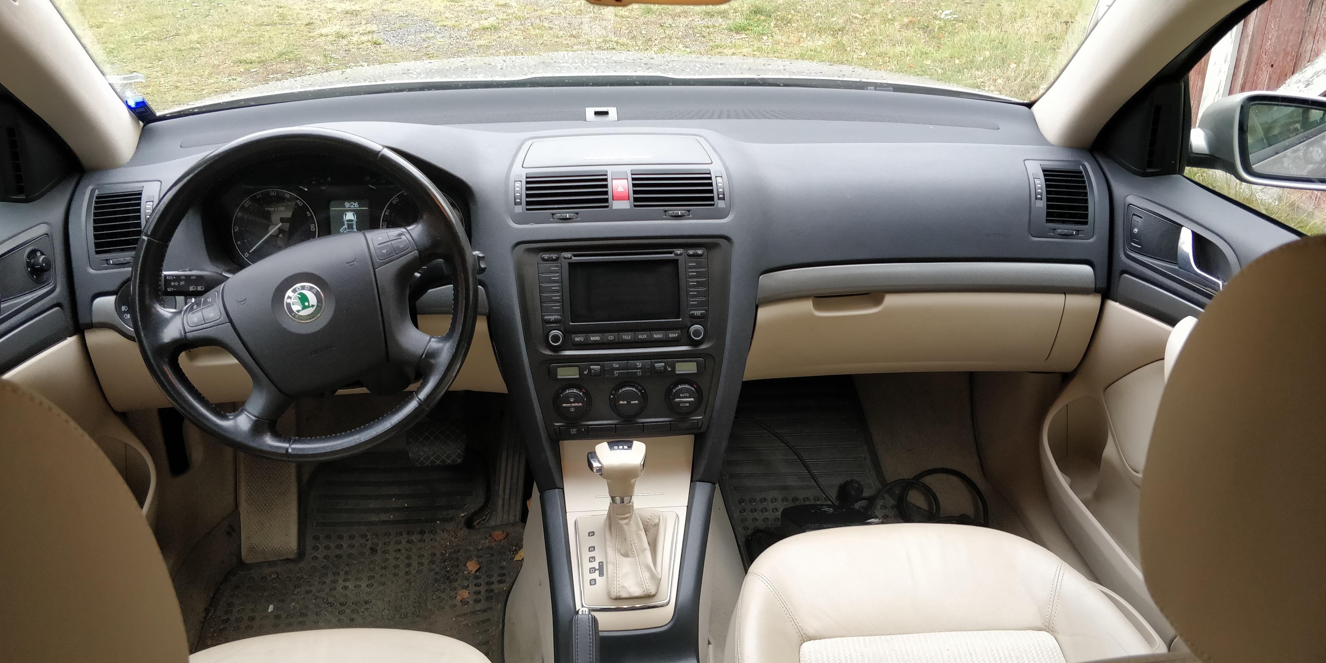

Okay! I know we've been over this already, but when did the interior change to the one I have? I can show the picture again :D Ive tried looking at earlier models and noted that the Climatronic is different, the logo under the center vents are different, theres a box in the center etc etc.
1U is a MK1, much like this: https://en.wikipedia.org/wiki/Škoda_Octavia#First_generation_(Typ_1U;_1996–2010)
1Z covers all MK2's including both the pre-facelift and facelift models.
pre-FL: https://en.wikipedia.org/wiki/Škoda_Octavia#Second_generation_(Typ_1Z;_2004–2013)
FL: https://en.wikipedia.org/wiki/Škoda_Octavia#Facelift
There are a few different heating panels depending on what's fitted. Examples include manual AC, single zone or dual zone heating. Not sure which logo you mean?
Your car is definitely a pre-FL MK2 ;)

Theres a logo under the "warning triangle" saying Octavia I think! Thanks for clearing this up a 100%!
