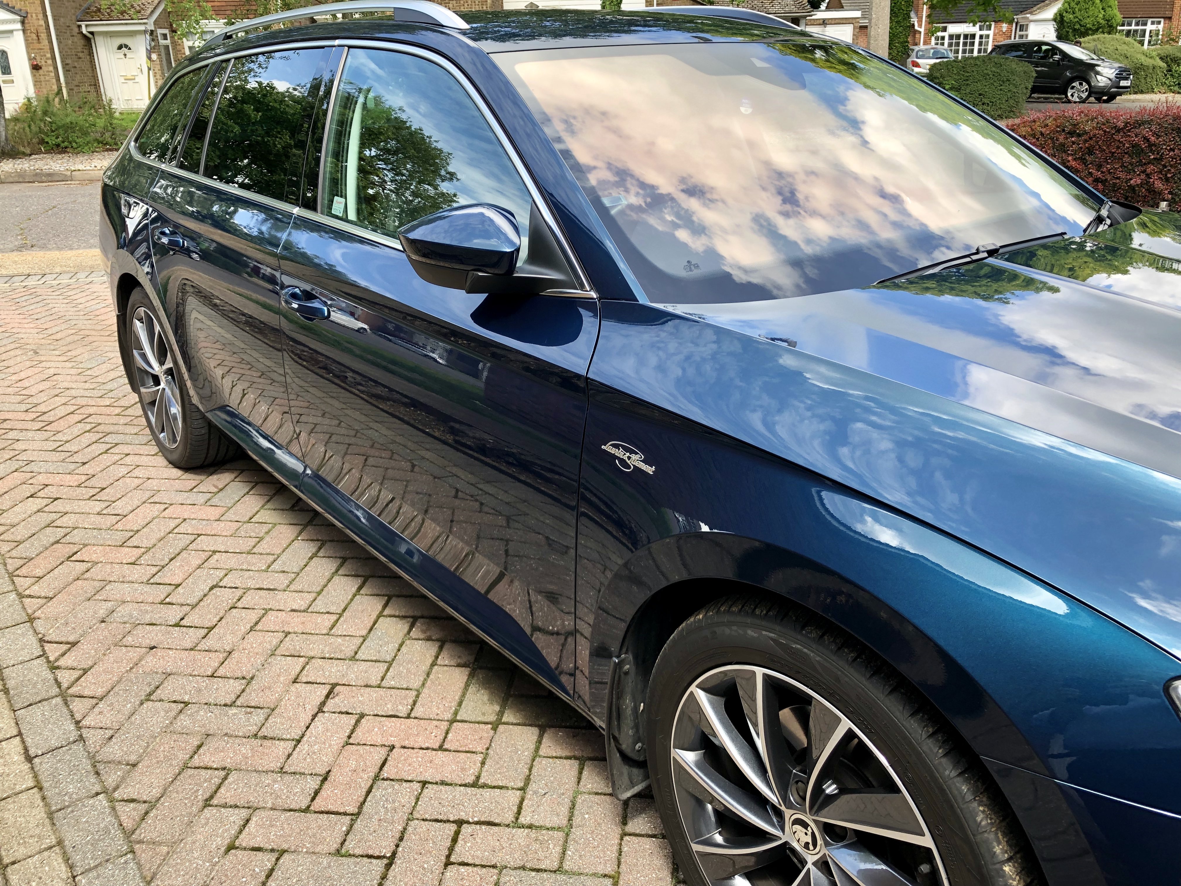

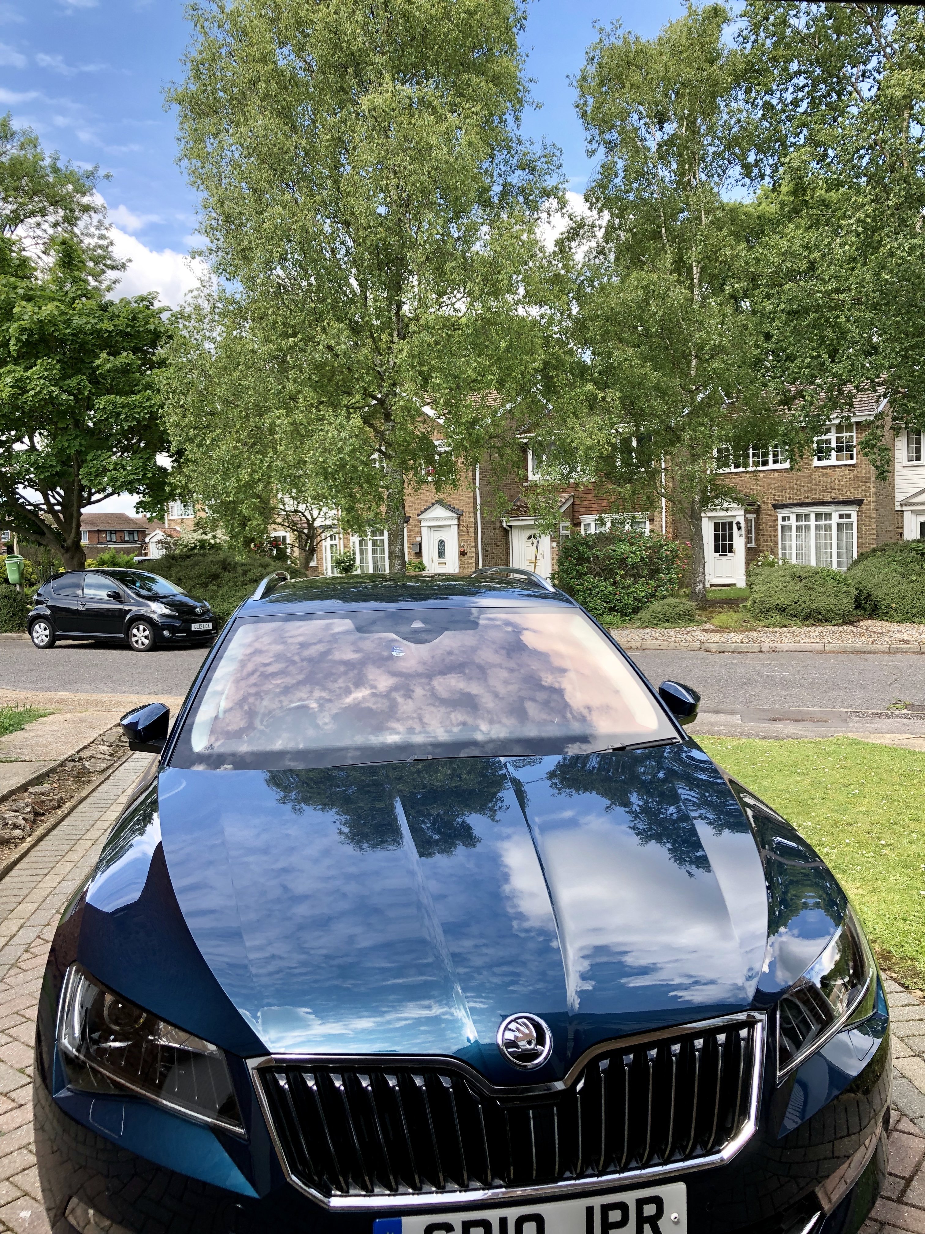

Had new Screen fitted today I just couldn't put up with the scratches anymore.. will be taking more care in the future.
Genuine Skoda screen and please with it...  :thumbup:

Hi mfm959,         I did first of all go to the  dealership but they told me that they only deal with Autoglass so I got them do the screen, but did insist that they only put the skoda screen in.... everything went fine and very pleased with the work carried out.    It's had a good clean now but I've now learn my lesson and will be taking my watch off every time I clean the dash.
Thinking of a good dash cam now any recommendations.
