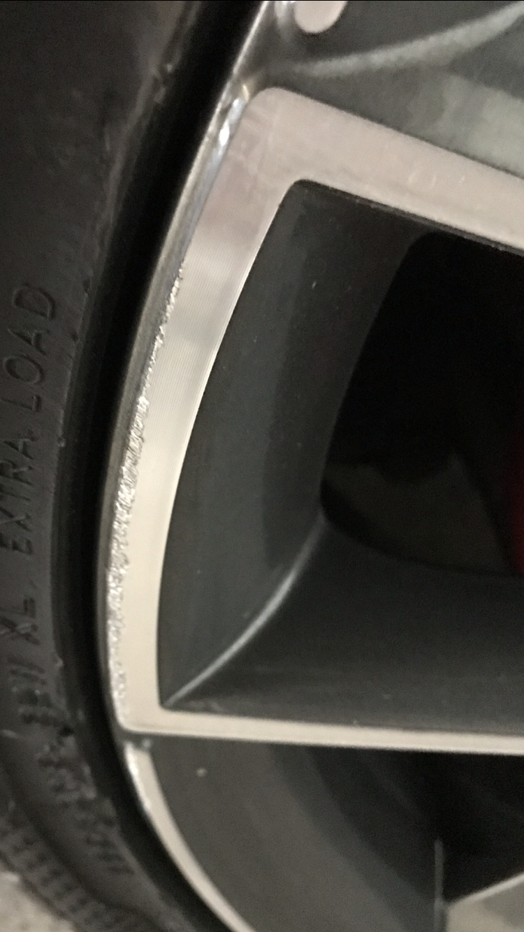

I really like my alloys I think they stand out but already I have a scratch on them (the bloody wife’s fault)
Can anyone tell me what they’re called. I’ve heard they’re Lazer Cut alloys?
How do I find out the colour of them? I know you can pay to get them repaired/polished to remove
scuffs etc but i was wondering if there was a touch up brush/kit to improve the look
Any info or advice most welcome thank you
diamond cut is the phrasing you're looking for.
You'd be better just getting them repaired properly rather than trying to bodge a repair yourself. Once the lacquer is breached, it'll invite water in and more lacquer will come off, leaving you with a manky looking wheel.
they are 18" Geminis, Standard fayre on the vRS, they are anthracite 9153 / F8J / 9J9J
Typically refurb on a diamond cut (Skoda call it 'brushed') wheel is more expensive than a normal wheel. As tunedude says, once the lacquer is breached on the cut part of the wheel, it's pretty much certain you'll end up with water ingress and a manky looking wheel.
Best bet IMO would be to ask around a few refurb places and see if they can do a local repair. If it's looking like a full repair is needed, bear in mind a new wheel from Skoda would be about £165, less for second hand somewhere no doubt.

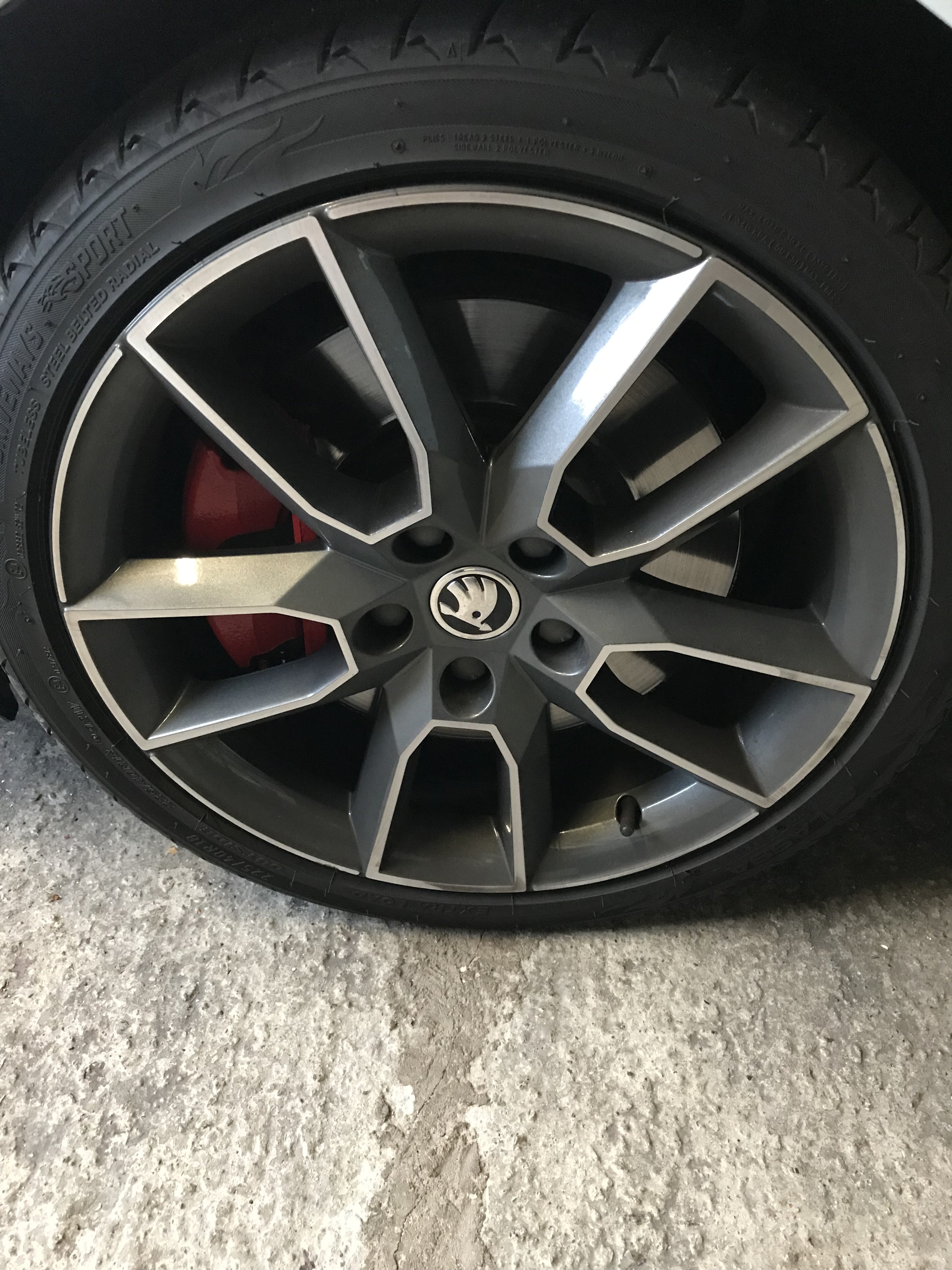

Not quite sure what is meant by the cut part of the wheel? Are you saying the scuff in the 2nd photo could/will invite water in and over time could affect the general appearance of the wheel?
Are repairs charged per scuffed area or flat charge per wheel?
Thanks again
ive costed a repair on my winter set of geminis and it was £300, blasted diamond cut and resprayed.
the lighter area is diamond cut. usually bare metal lacquered, water gets underneath and you get white corrosion called flowering.

By cut part, I mean the area that is diamond cut (the bright silver bits). If you'd just scraped paint it would be an easy fix but being the diamond cut area it's harder to do a good repair. Until it is repaired it will invite water in and start to corrode and gradually begin to look horrible, much like Johnny's picture just above, though it would take a while to get that bad.
I had 18s on my old car and a decent local refurb place were charging around £90 per wheel to completely refurbish them, this included shot blasting, acid dip, defect repair and re-painting.  Off the top of my head diamond cutting was another £10-£15 per wheel.
