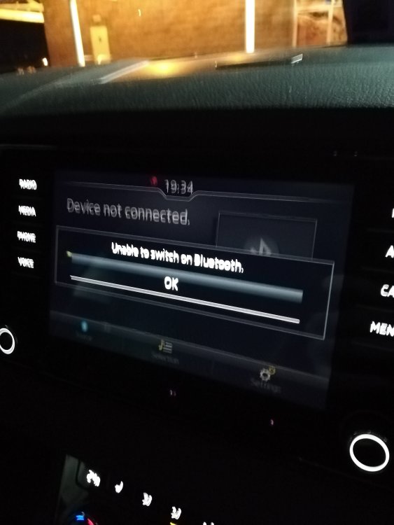

So my Karoq is only 4 months old and I'm having issues with the Bluetooth on the car and android Auto, its an intermittent fault but every once in a while the car comes up with "Unable to switch on Bluetooth" and then no matter what I try it won't work for the rest of that day. I've tried factory resetting the head unit but to no avail. Has anyone had the same issues?

Well they couldn't find a fault again today after diagnostic checks but the workshop guy has sent a tech inquiry to Skoda UK and will call me as soon as they have an answer, he did say that if all else fails then they'll have to take out the dash and fit a new head unit (luckily I wouldn't have to pay) although hopefully it won't  need to come to that.
